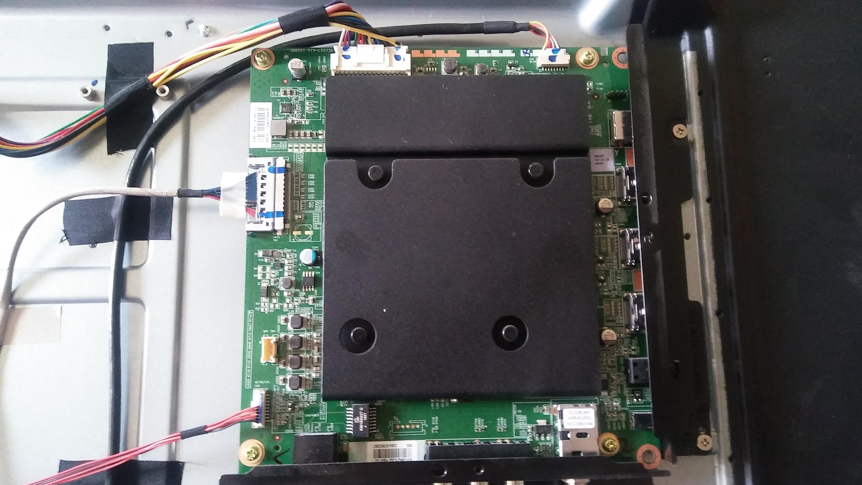

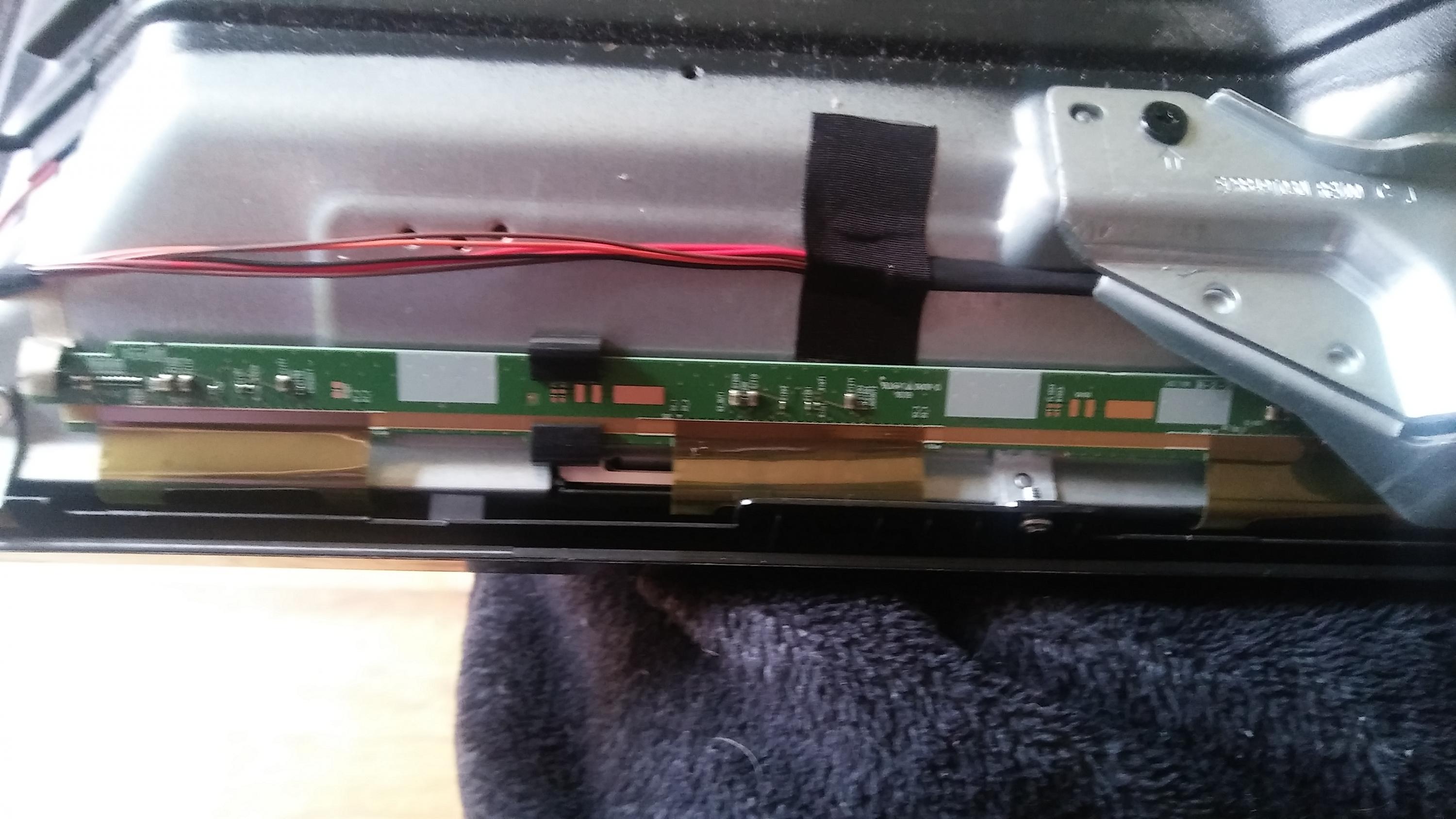

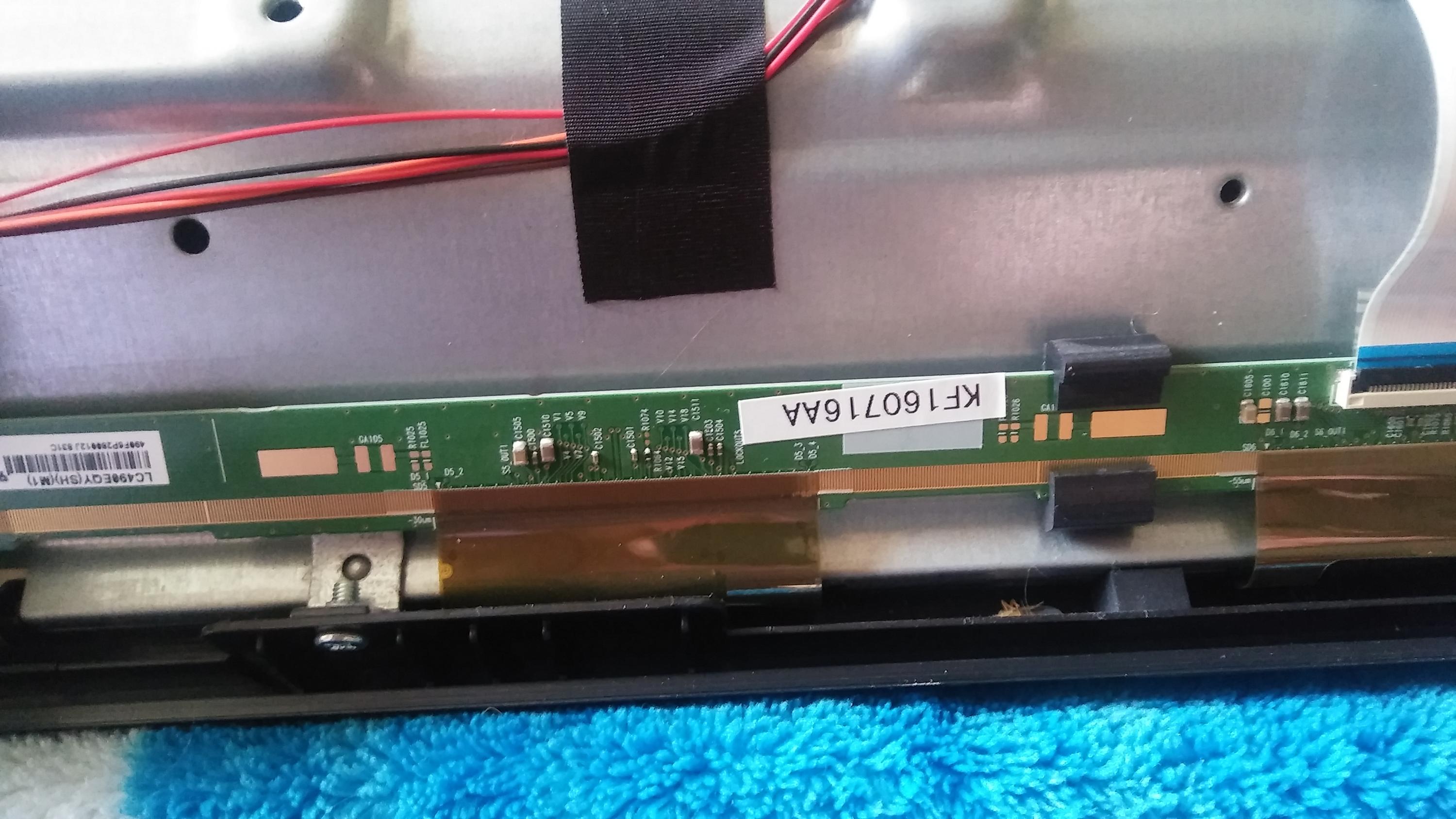

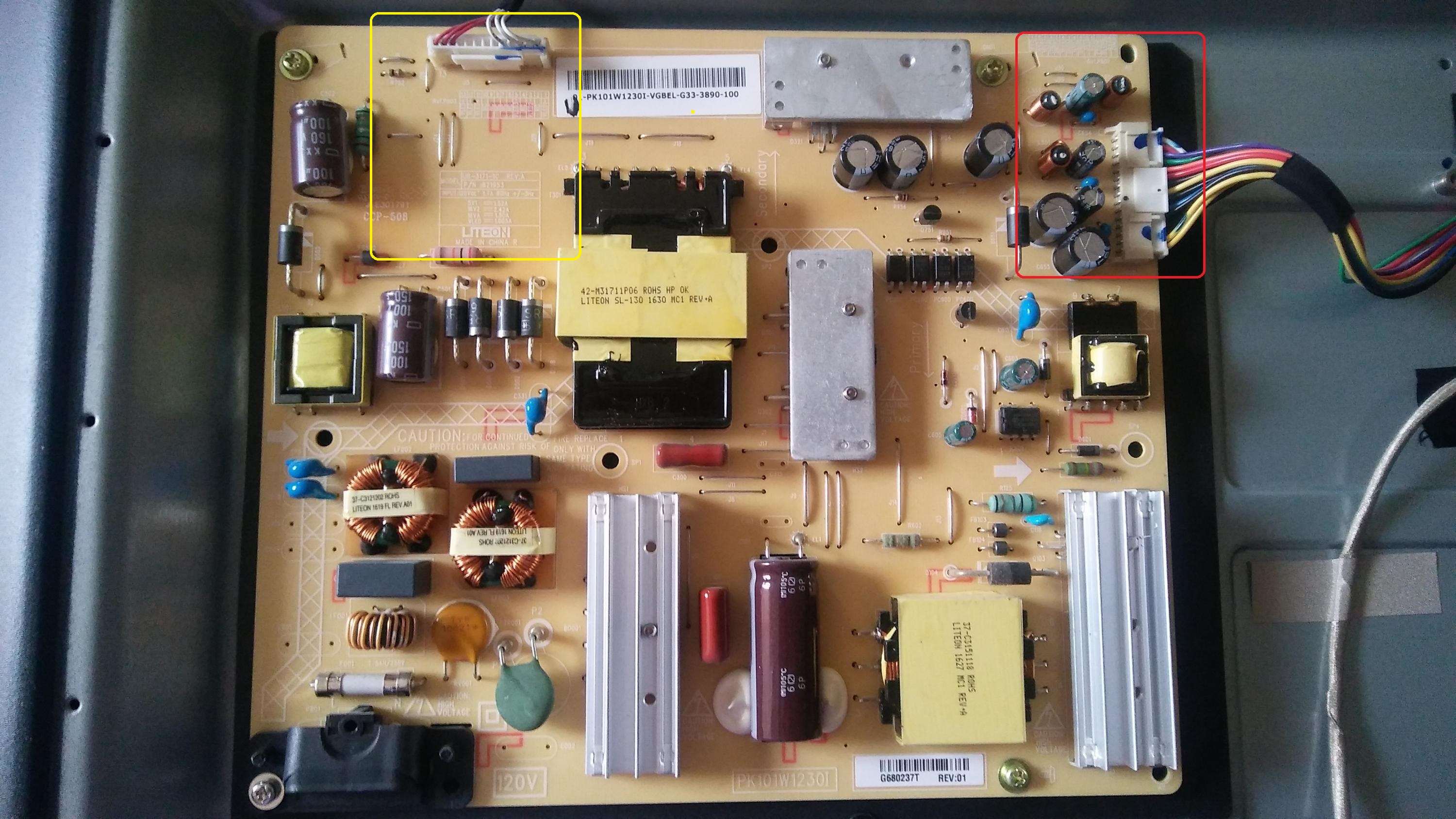

        I was finally able to take the back off... Here is what I have....
        Any help would be appreciated.
        • dick_barton
          • Aug 2015
          • 6643
          • Wales
          Re: Toshiba 49L621U
          As a 4K TV I would have thought an attempt to fix it would be worth while. Post some photos of the circuit boards and their interconnections.
          Edit,
          I see that you have posted pics while I was typing.

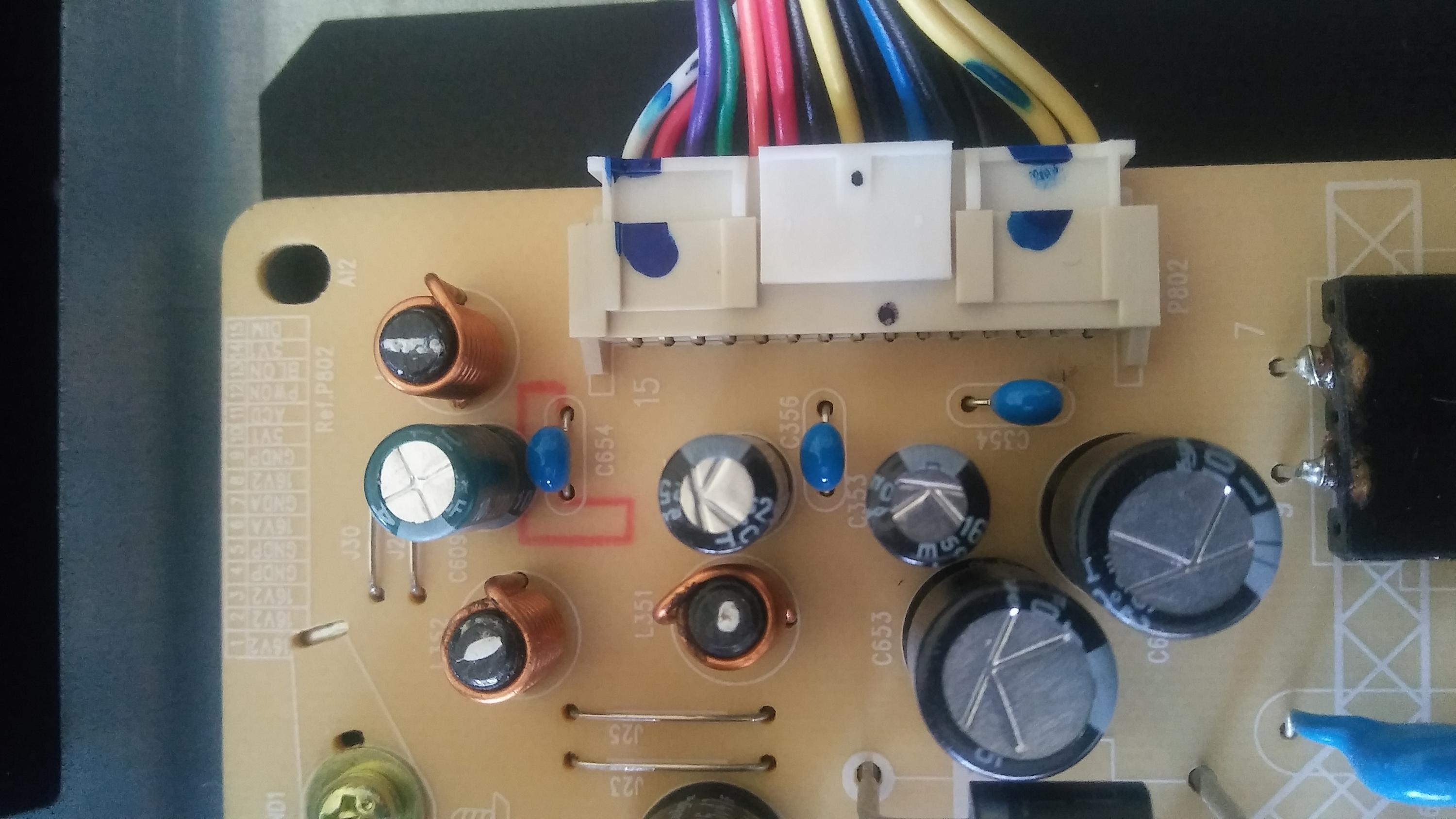

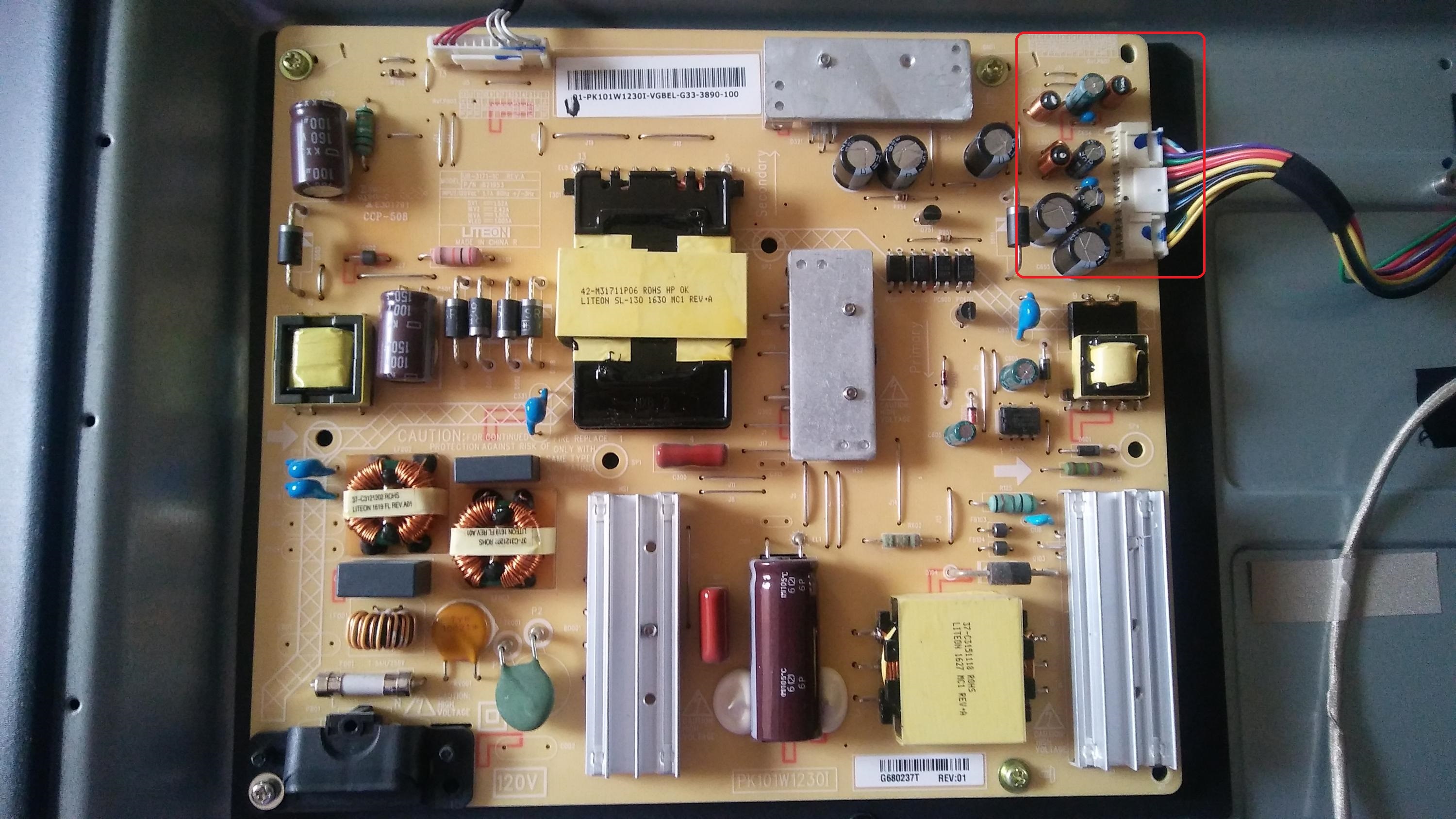

            Can you post a clearer image of the section shown in the red box.
            • kristapMA
              • Apr 2018
              • 20
              Re: Toshiba 49L621U
              I put it back on the wall. I will see if my husband will help me take it back down when he gets out of work so I can get a better pic of the area you have the red box on.
              Thank you for your help
                    Here is an image of what you had in the red box....

                      • nomoresonys
                        • Jan 2013
                        • 12331
                        • U.S.
                        Re: Toshiba 49L621U
                        https://www.youtube.com/watch?v=4v8DcqCNG4A testing video, test the connector in post #10 P802, test with tv plugged in that's standby, then turn on tv see if readings change, report readings for both states back here, for example pin one on standby 16 volts, tv on 16 volts or whatever reading you get.
                        • nomoresonys
                          • Jan 2013
                          • 12331
                          • U.S.
                          Re: Toshiba 49L621U
                          Test all 15 pins, the legend/map is to the left, see it?
                            Re: Toshiba 49L621U
                            Also please make sure to put down the pin names so we can easily see what each pin is and what Voltage it has in two conditions.
                              Standby
                              1 - 0 - 16v2
                              2 - 0 - 16v2
                              3 - 0 - 16v2
                              4 - 0 - gndp
                              5 - 0 - gndp
                              6 -0 - 16va
                              7 - 0 -gnda
                              8 - 0 - 16v2
                              9 - 0 - gndp
                              10 - 5 - 5v1
                              11 - 0 - acd
                              12 - 0 -pwon
                              13 - 0 -blon
                              14 - 5 - 5v1
                              15 - 0 - dim
                              POWER ON
                              1 - all the way - 16v2
                              2 - all the way - 16v2
                              3 - all the way - 16v2
                              4 - 0 -gndp
                              5 - 0 - gndp
                              6 - 0 - 16va
                              7 - 0 - gnda
                              8 - 0 - 16v2
                              9 - 0 -gndp
                              10 - 5 - 5v1
                              11 - 3 acd
                              12 - just under 4 -pwon
                              13 - just under 4 - blon
                              14 - 5 -5v1
                              15 - 3 - dim
                              When I tested 10 when the tv was on, the lights (LED) flickered on then off..
                              is this what you were talking about?

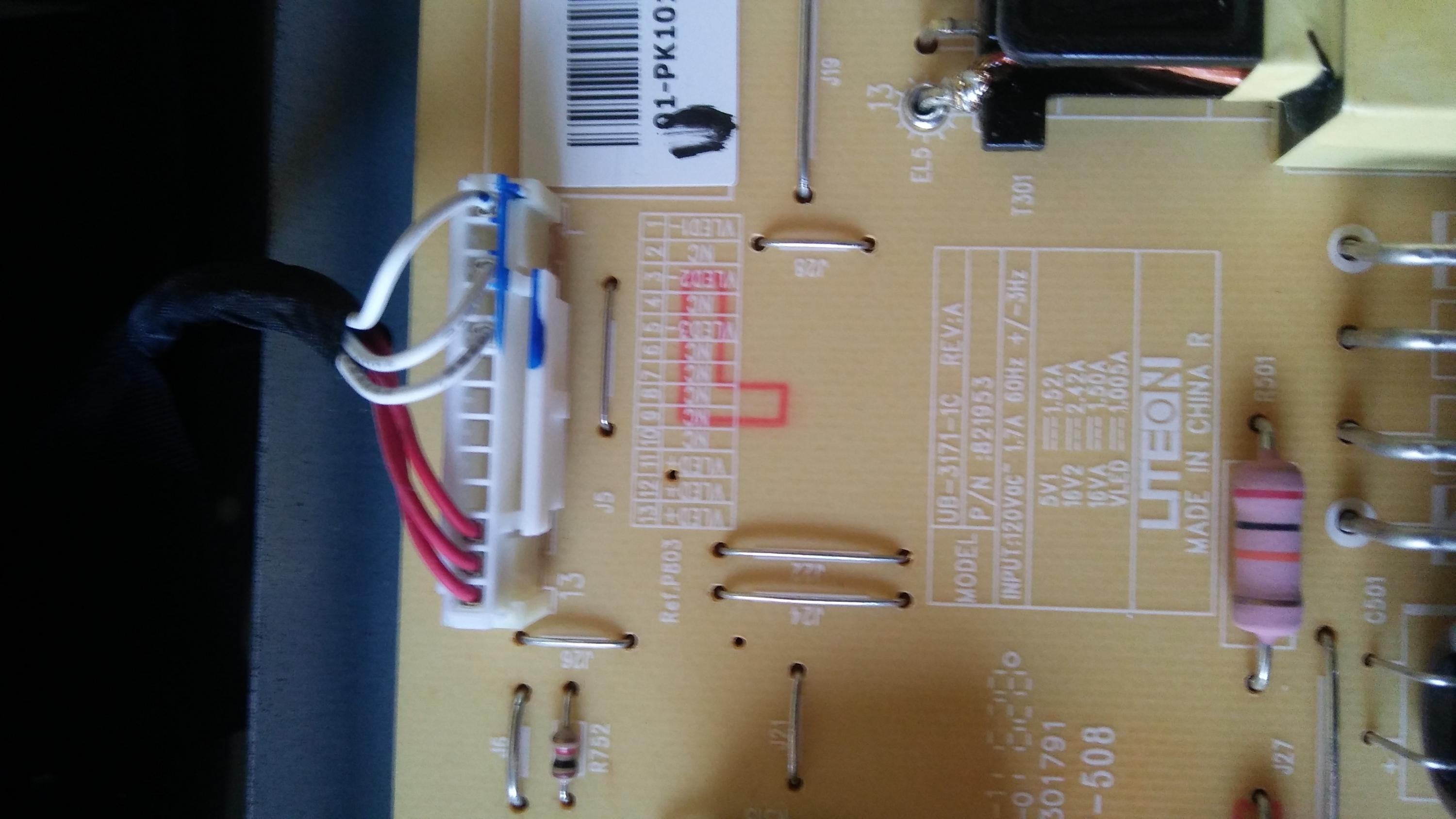

                                I think you have a led problem. Can you measure the voltages on the connector in the yellow box and note the voltages on each pin at switch on. It may rise quickly and then drop just as quickly.
                                The legend in the yellow box also says what the led voltage should be but I cannot read it.
                                  should i measure it with the tv on, off or both like before?

                                    Place your probe, black to chassis and red to connector pin with meter set to 200V DC range and then switch on the set and note the maximum voltage read by your meter and what it may drop to. Switch off the set and move the red probe to next pin and repeat. There should be a legend giving the pin names of the connector alongside or close by.
                                      1 - 4 down to 3 = VLED1-
                                      2 - 4 to 3 = NC
                                      3 - 4 to 3 = VLED2-
                                      4 empty = NC
                                      5 empty = VLED3-
                                      6 empty = NC
                                      7 empty = NC
                                      8 empty = NC
                                      9 - 1 to 0 = NC
                                      10 empty = NC
                                      11- 1 to 0 = VLED+
                                      12 empty = VLED+
                                      13 - 1 to 0 =VLED+
                                      Other Legend says -
                                      5v1=1.52A
                                      16v2=2.42A
                                      16VA=1.50A
                                      vled=1.005A
                                      Started with 1 being the red wire to the left and moved to the right

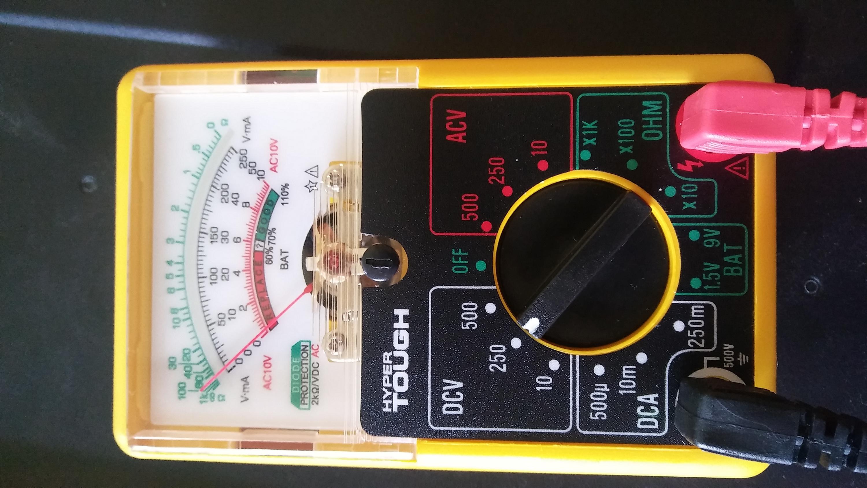

                                      Also attached the pic of my meter to make sure i have it set right and am reading it right?

                                        Can pick up a digital meter for 10 bucks or so, don't have to have one but they are easier to work with for new operators.
