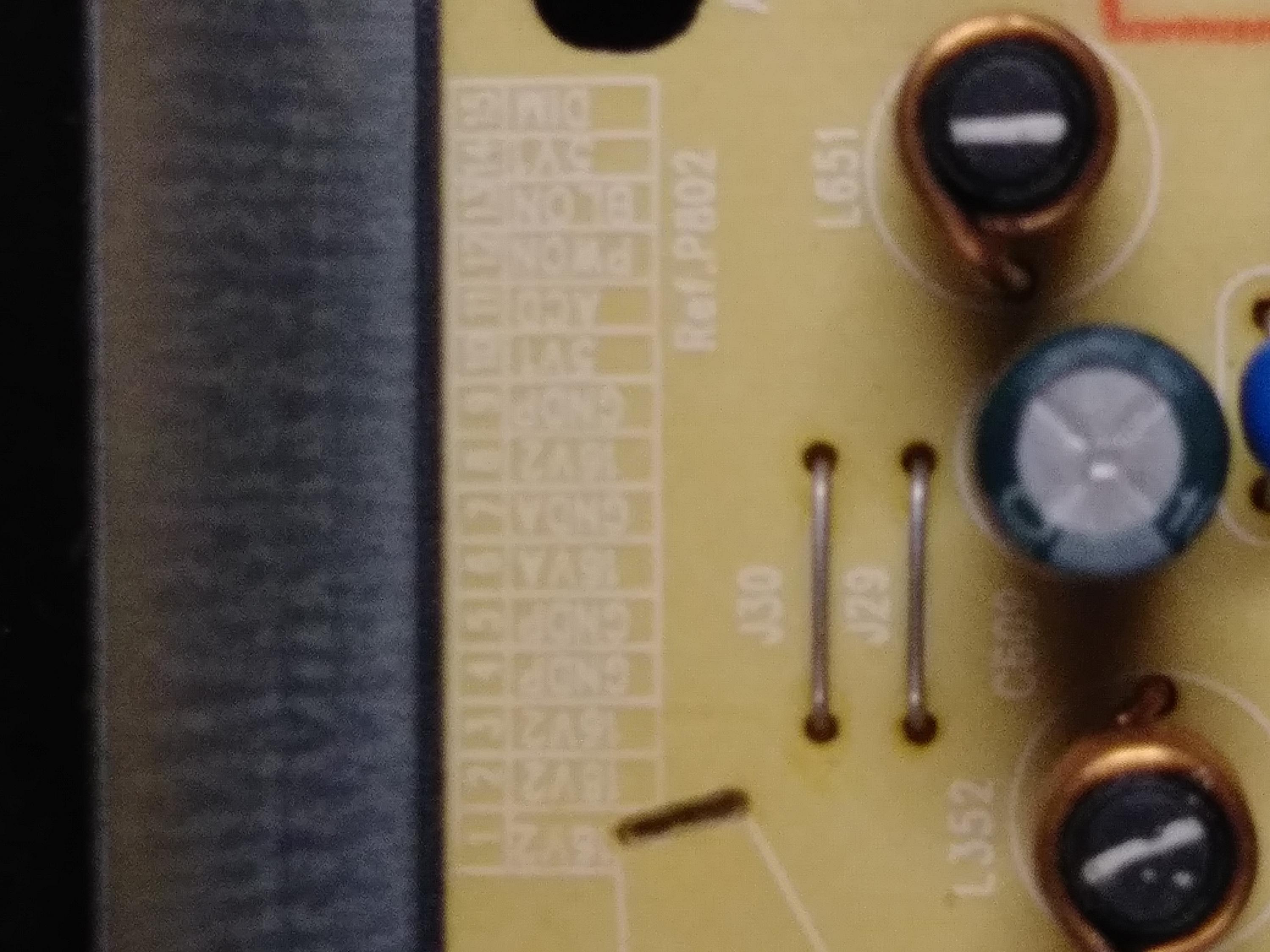

      Re: Toshiba 49L621U

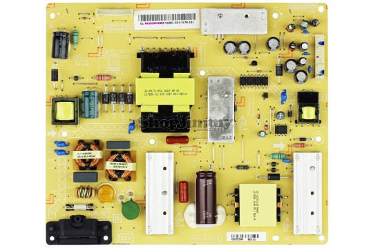

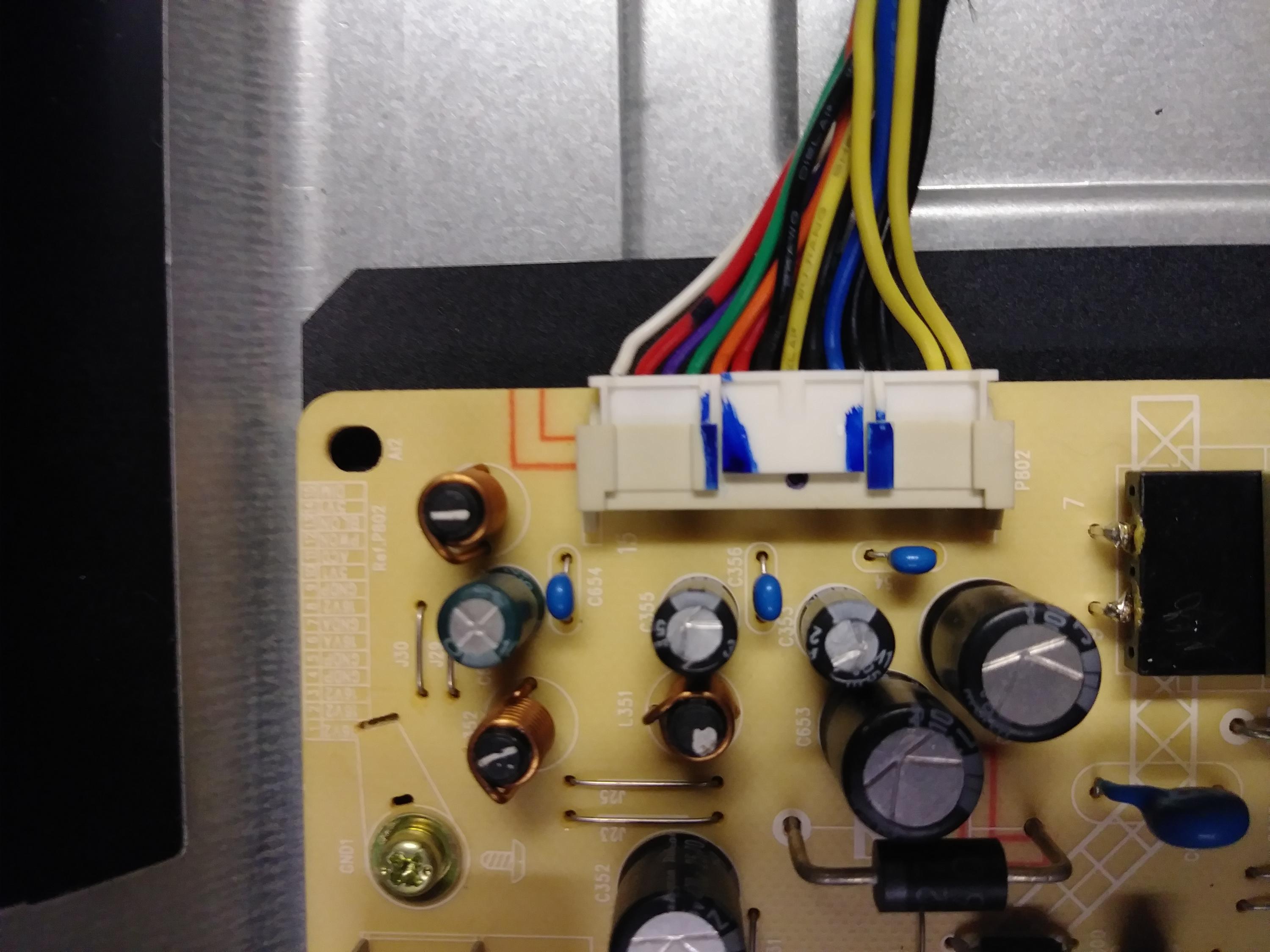

      to preface: after reconnecting pin 15 (dim) the set still continues to function properly. any reason? reset, something short close or open? did continuity between the wire at connector insert and the backside of the connector adapter itself to verify its actually back installed.
      1) So what do you have on DIM pin if all cables are put back in place?
      when the unit is off it jumps between 0v and -.1mv
      2) What DCV do yo have on the LED connector of EACH pins when you first turn on the TV (you will need to leave the meter probes in place, black probe on chassis, red probe on each LED connector) and then after 10 seconds then turn the TV off, so you have to repeat this test on each pin of the connector that has the wire connected to it, you also need to provide the pin name so we can easily see what it has or does not have..
      placed in min/max mode: p803 on power board (connector going to led strips)
      with led load:
      pin 1 vled1- = 15.6v
      pin 2 nc
      pin 3 vled2- = 17.1v
      pin 4 nc
      pin 5 vled3- = 15.3v
      pin 6 nc
      pin 7 nc
      pin 8 nc
      pin 9 nc
      pin 10 nc
      pin 11 vled+ = 97.4v
      pin 12 vled+ = 97.1v
      pin 13 vled+ = 97.3v
      without led load:
      pin 1 vled1- = 0v
      pin 2 nc
      pin 3 vled2- = 0v
      pin 4 nc
      pin 5 vled3- = 0v
      pin 6 nc
      pin 7 nc
      pin 8 nc
      pin 9 nc
      pin 10 nc
      pin 11 vled+ = 133.9v
      pin 12 vled+ = 134.3v
      pin 13 vled+ = 131.1v

        i first used my backlight tester to test voltages on all 3 strip circuits. they seemed within range of eachother and not off enough to indicate one of the leds went out. i opened it up to visually check each strip after replacing the power board, main board and tcon board without it resolving the issue.

            It is PWM Dimming control. not variable resistor. You do know what PWM is, correct?
            You should check the dimming DCV reading when backlights stay on, it will be average reading since it is PWM not steady DC.
            BTW, LED tester only puts out about 30 mA instead of 200 ~ 300mA of operating current, so using tester will tell you if you have open circuit or not without having to disassemble the LCD panel, not for verify that the LED is good since bad LED will fail at operating current.

                "with the unit on pin 15 (dim) is jumping between 3.005v and 3.024v" that is fine.
                What is your TV LCD panel model number?

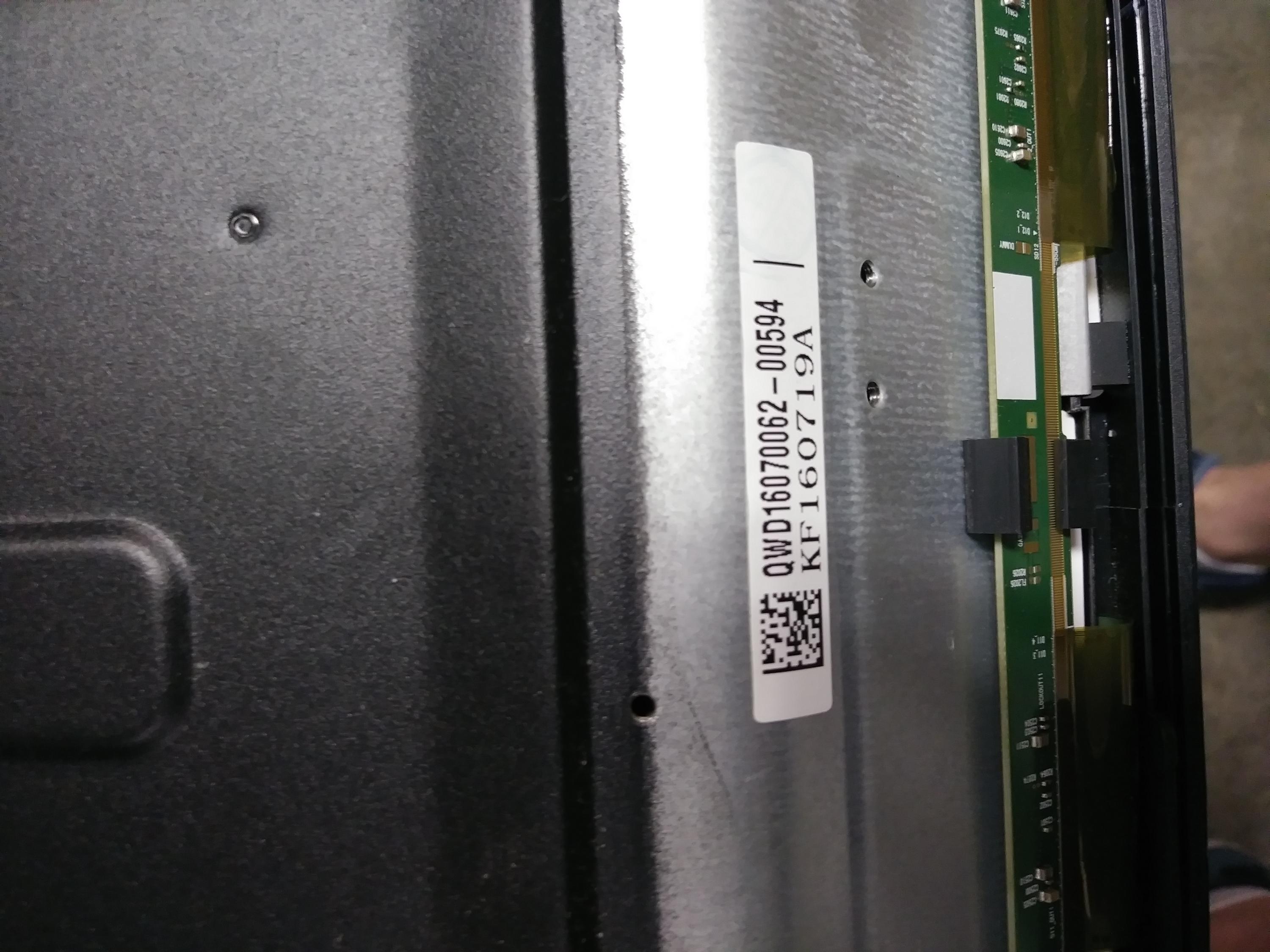

                    #69
                    Re: Toshiba 49L621U
                    is this the display unit part number itself? if not then the prefixes...(this may be what youre talking about) is: LTM7UCAR
                      #70
                      Re: Toshiba 49L621U
                      There should be a sticker right on the back of the LCD panel.

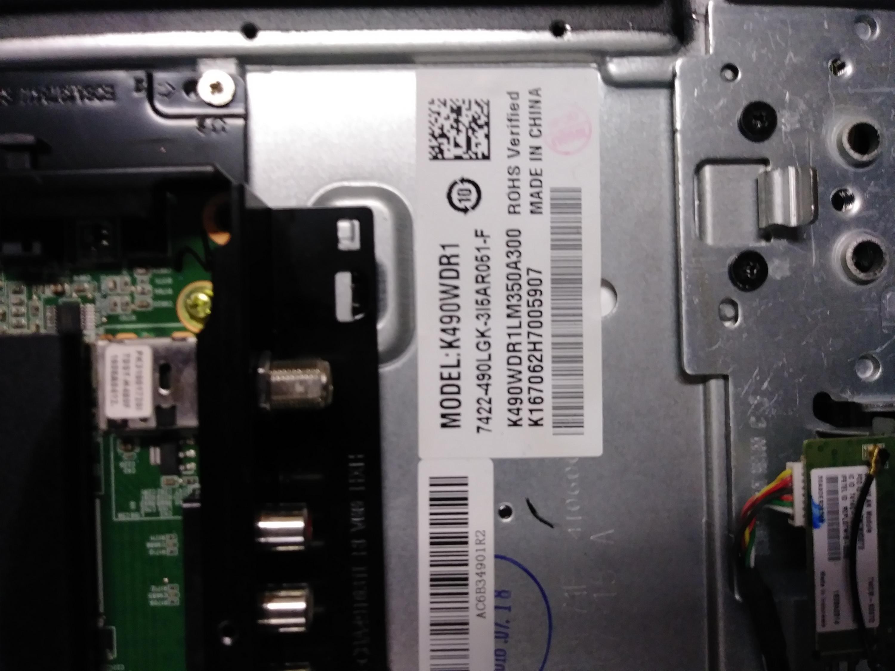

                        #71
                        Re: Toshiba 49L621U
                        Post # 4 show the LCD panel sticker, since there are more than on revision of this TV we do not know what LCD panel is used in your TV.
                        • jostewcrew
                          • Mar 2020
                          • 79
                          #72
                          Re: Toshiba 49L621U
                          one sec...going to take a pic it is rev A
                            #73
                            Re: Toshiba 49L621U
                            You have the same LCD panel as the OP, K490WDR1.
                            I cannot find the spec sheet for this model, the spec sheet will explain what the control signals requirement will be.
                            But at this point you do have reference Voltages of the working condition so just have to make measurement when it stops working.
                            Also try turning down the backlights level (not brightness) to as low as possible in the USER OSD to see if the TV will stay working longer.

                                        I've experienced this model to have a common problem with backlight failure. LEDS come on for between 5 seconds and 5 minutes then BL shuts off but image remains on screen. LED strips test OK with LED tester, but fail under normal load. The way to find the one strip that is failing under load is to test each strip one at a time by plugging in a good know strip in the place of the one being tested. Once you find the failed strip, the BL stay on. (This can be a challenging diagnosis because sometimes two strips are drawing too much current and are causing the BL shutdown!)
                                        Only a matter of time until the next strip fails... I suggest starting with a whole new set.
