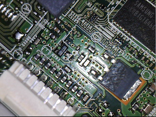

    Samsung LCD TV UN60EH6003F power it on and you just get the standby light, no back light, no data with flashlight test. However, when you disconnect the cable from power supply to the main board. The back light comes on immediately. This tells me it's a main board problem. The main board is BN94-06143A
    I know most would just replace it, but I love to repair one. I don't know much about SMD components. Is this a transistor? I have attached a picture. It fails a diode test, and it looks burned. In the picture the leads look burned, but I don't see that looking with my eyes. Need to be educated on this part. Any common component failures on this board? Please help. If this is the bad part, I can't read the number. Sure could use a part number.
    Taft

    Is this your board?
    http://www.shopjimmy.com/samsung-bn9...eh6003fxza.htm
    It looks like Voltage regulator IC.
    Which one in your pictures, IC601 or 602? P/N as printed on the body? You may be able to clean up the body with Alcohol.
    Can you zoom out?

      Yes that is my board. I have tried to clean it off but it seems like heat damage, and it will not clean off. It is very close to the white connector going to the power supply. I can't read anything on the chip, and i don't see a location number for the chip. I have zoomed out a bit here is the attachment. Shows the white connector and the regulator.

        The picture in SJ shows IC601 right above the metal tab of that device, that print should be on the same location as your board if your board is the same as the one shown at SJ.
          Re: Samsung lcd tv no power
          What Voltages do you on each pin with ref to the chassis GND when power switch is activated (do not worry about if the TV comes on or not)?

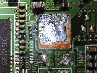

                    Can you post a clear picture of your main board with the sticker removed? I'd like to see this in its entirely.
                    Instead of using a diode test, measure the impedance (in ohms). The component that you took pictures of looks to be a LDO (linear voltage regulator) in a DPAK based on the layout.

                          I used acetone, alcohol, goop off. I don't think it was glue. When i removed that transistor, it just crumbled apart.

                              First question. How did I know the device was shorted? I thought is was a transistor, but I didn't know. You guys confirmed it was a regulator transistor. SO checked it several ways. First with diode test of my meter. Test bad. Then with ohm test, I read resistance both ways, and i got 0.54 and 0.56 I removed the part. It just crumbled as if it had got very hot. Not being able to read any of the numbers on it, also points to heat damage.
                              You stated the voltages are not being pulled down. This confuses me because when the cable is disconnected, and the back light is on. I have several voltages on the power supply. 12 volts and 5 volts. Then when the cable is attached to the main board, those voltages got o milivolts, every pin is nothing but milivolts or zero. So my question to you before. Doesn't that mean there is a short? How can they be getting a command signal to come on, if the main board is detached? When the cable is re-attached to the main board, following that 12 volt line to the main board, then I get only 0.25 milivolt reading. That is using black lead to chassis, and red lead to that 12 volt wire. You stated the 12 volts and the five volts don't come on until the power on command is given from the main board. How come I am reading them on the power supply with the main board detached?
                              I have repaired switch mode power supplies for over 30 years. It this smd technology and eeproms that i don't get. I do understand that the command signal turns on the eeprom,and that is suppose to turn on the tv. On power supplies I could find the shorted components from reading resistance to ground. Maybe my meter isn't good enough for these smd components. I am self taught. I have a lot to learn. I hate just replacing aboard. I get more satisfaction in repairing the board. I know this is a complex board, but it's still fun to try. Just wish it were as easy as lifting a shorted component off the board and having all my resistances returning to normal. Or voltages. I removed that part, because you guys told me what it was, SO i knew it was bad.

                                  OK, Using the tuner for ground. I get 197.9 ohms on the bottom left pad. That is with my meter on ohms On the right pad I get 0.2 ohms. ON continuity check on the right pad I get a steady beep. On the top pad I get 0.522 k ohms So that is way different from when the part was on the board. That means there is a short somewhere on that trace. Right?

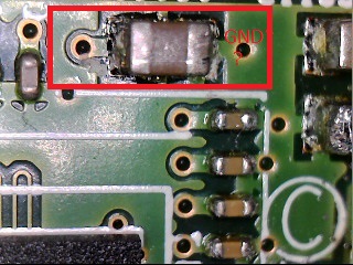

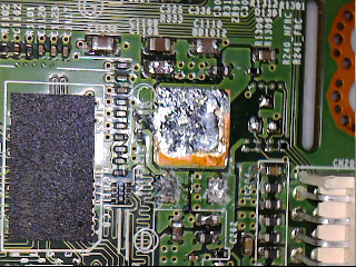

                                    I took two more pictures. Just to the left of that transistor pad is a row of capacitors. At the very top of that row I have zoomed in one the top capacitor. From ground, and on the beep function of my meter I get a beep on both sides of that capacitor. In comparison to the others, which only beep on the negative side which is ground. SO is that capacitor shorted?
                                      I would not using Beep function for testing for shorted circuit since the meter will beep with resistance as high as 50 Ohms or more depends on your meter, you can try checking with various resistor value to find out at what the resistance the meter will stop beeping.
                                      Beeping function will tell you that you have electrical connection between point 'A' and point 'B'. Resistance result is the one you need to look for.
                                      You should use low Ohm mode for looking for shorted circuit (something thing that has <1 or 2 Ohms reading). Ohm reading is the way to go for looking to see if you have shorted circuit/shorted parts or not.

                                        It would help if you are able to mark up the photos in MSPaint or some other photo editor to clearly indicate which paragraph aligns with which pic.
                                        In any case, the beep function isn't what you want to use. Budm mentioned the same thing. Use the low ohm measurement function of your meter to measure the resistance.
                                        For the zoomed in picture (attached), the right hand side appears to be GND. Look at the copper pour (shape) on the board. By inspection, the majority of the 0402 and 0603 sized caps that you have here share the same net.
                                        Since you say the the left hand side is also measuring low impedance to GND, it indicates the left hand net is shorted, but not necessarily across this cap.
                                        What RESISTANCE value are you getting across this capacitor?
