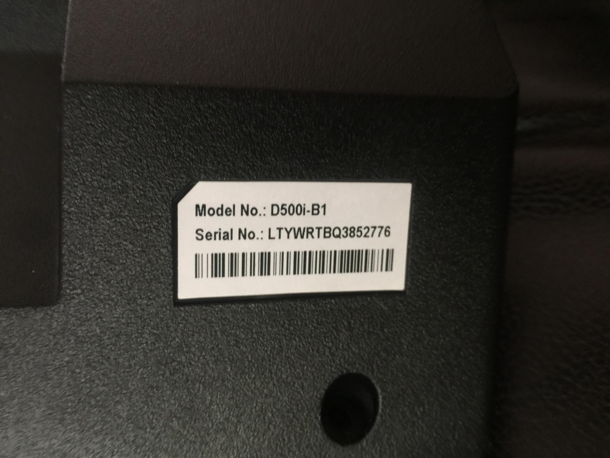

          PS- it appears I got the model wrong in the title if someone can edit.. It should be a B500i-B1
