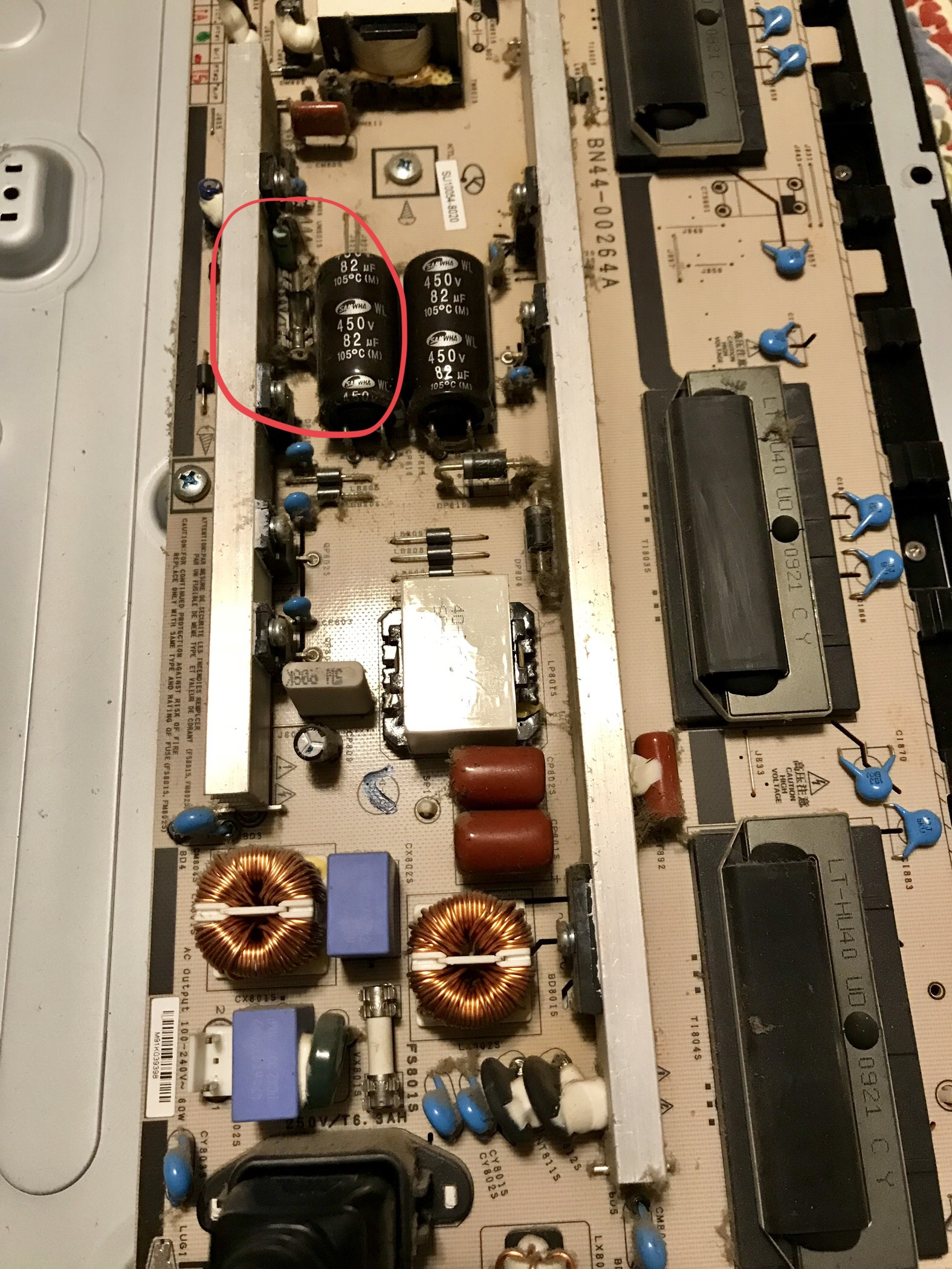

    I acquired this tv with out any knowledge of what the problem was. I plugged in and had no power. Opened it up checked the caps and fuses. Caps looked good. First fuse closes to power plug was good. Second fuse was blown. I swapped it and it plugged the set in and it immediately blew. Where do i look next?? attached is a picture of the board with the fuse that is blown circled in red.

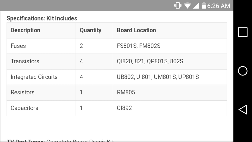

      Check these parts first. I like the Rod Farva icon. Only 9 days till supertroopers 2!

        Well i am going to print the circuit diagram and start circling the part numbers that were recommended to check. Then find them on the board and check.

          Most likely QP801 and 802S shorted. Shoddy soldering casused this most likely. Thanks ROHS lead free solder!
