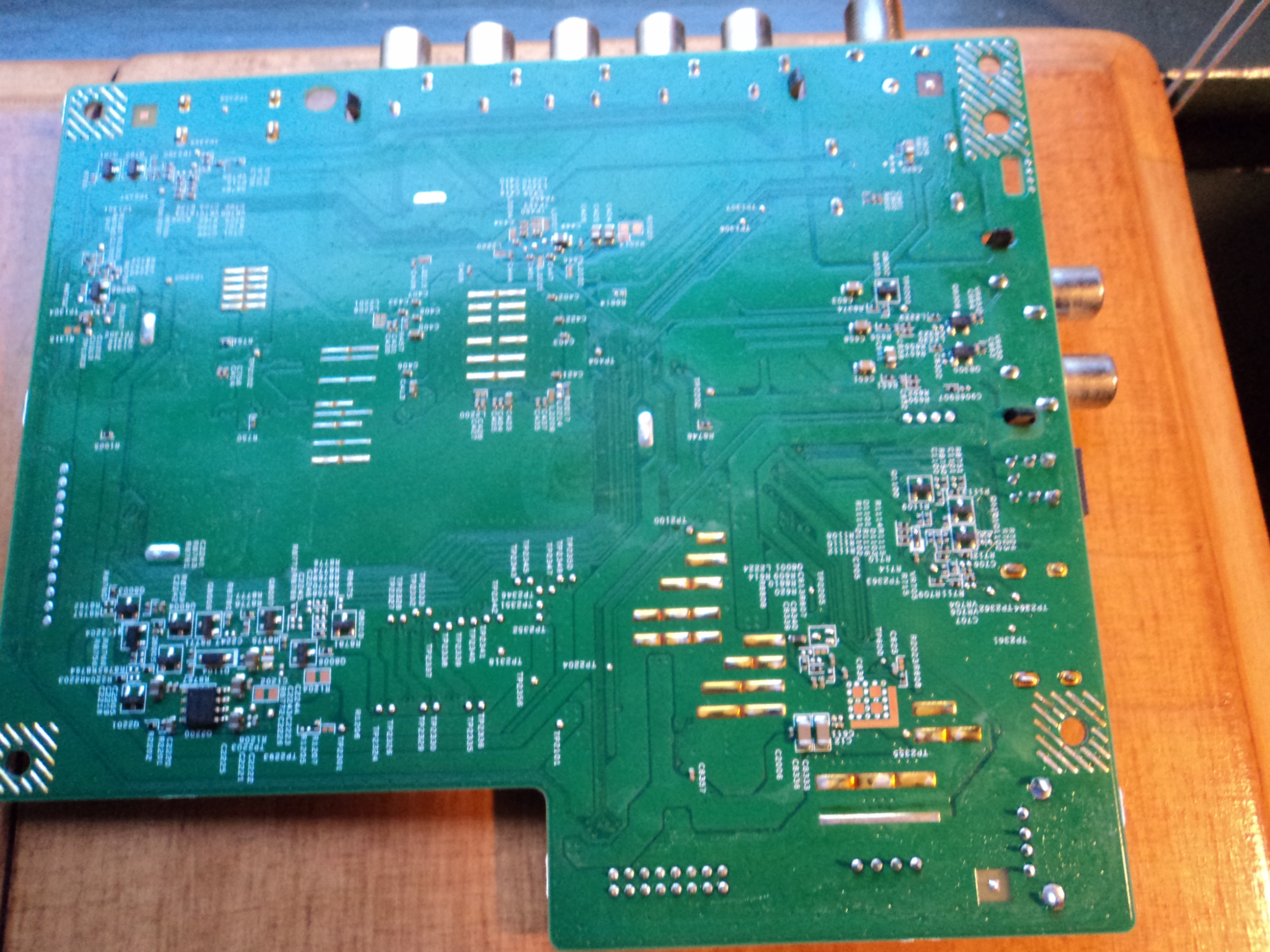

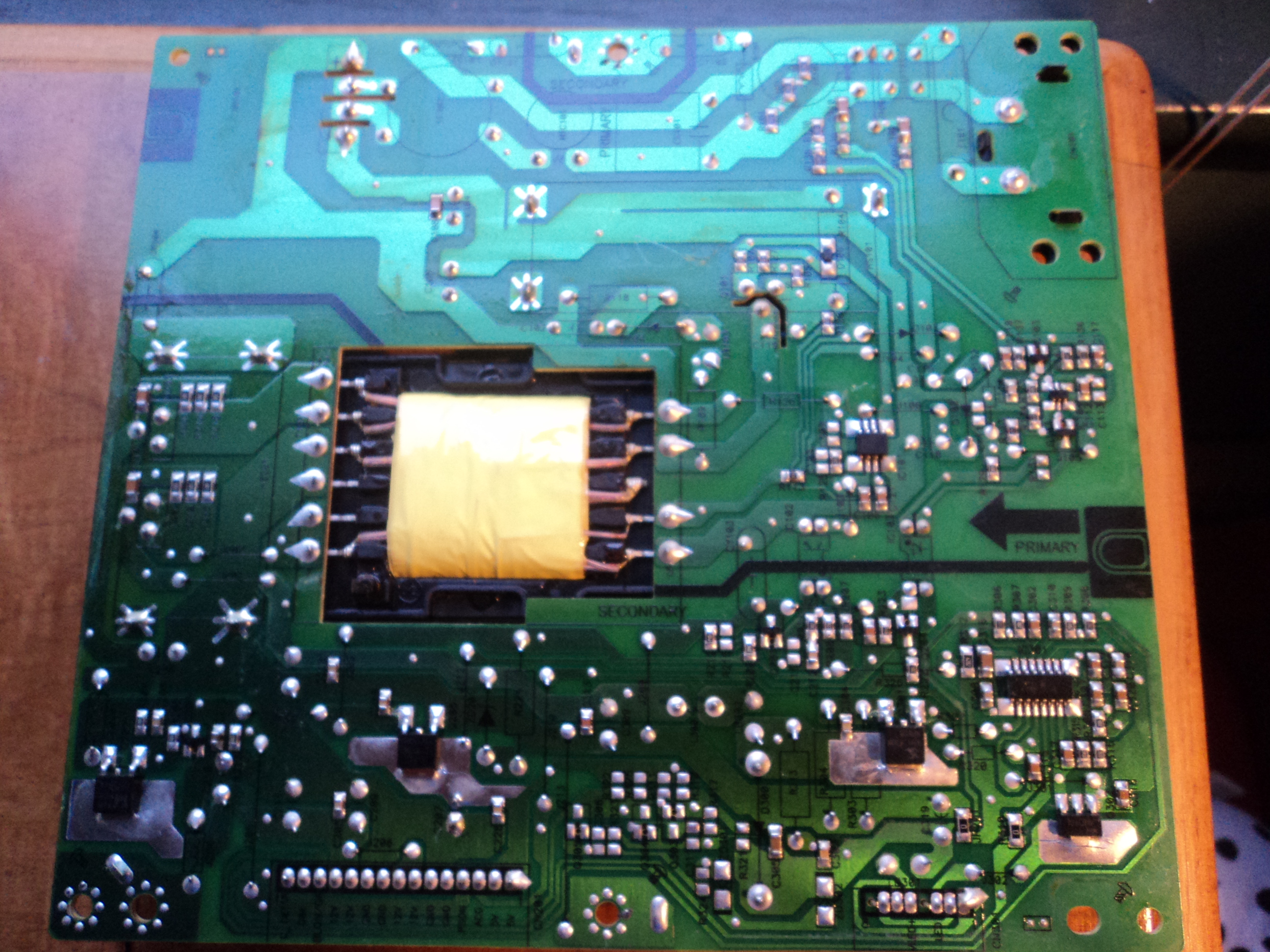

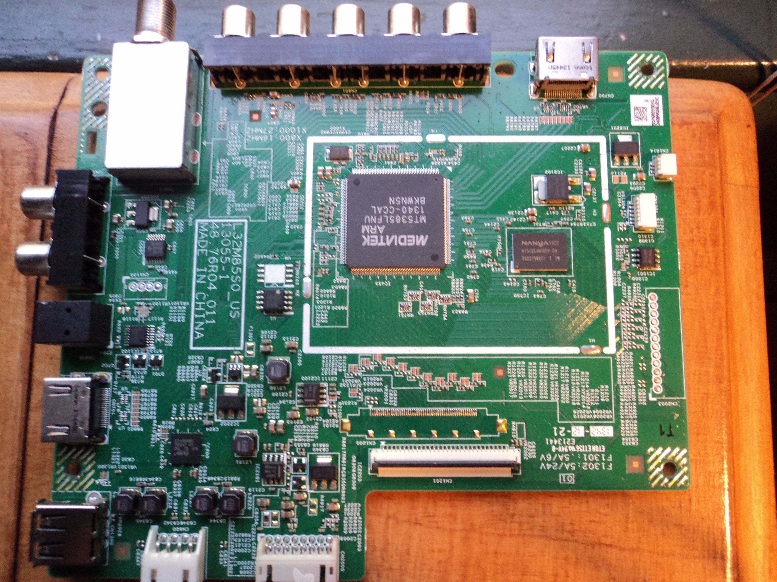

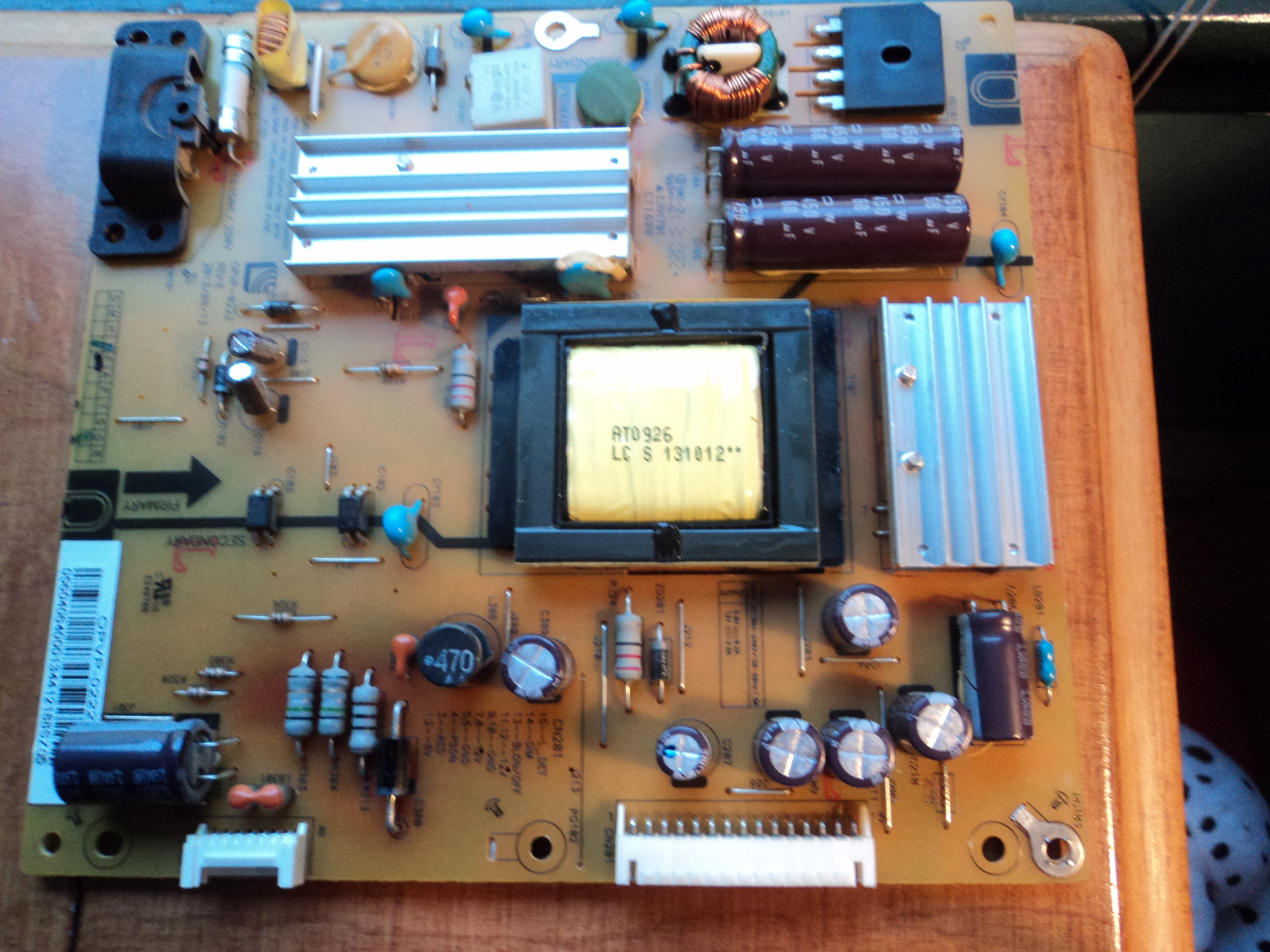

    Hi good people long time no see hope everybody's fine ;I'm trying to save this Vizio E320-B2 from land filed; I plug the tv push power switch or remote control the white light lights up for a second then goes out and stays out no back light,These 2 boards,Power and main boards that's all i see,don't see any Tcon.

    May be bad EEPROM: http://www.shopjimmy.com/vizio-e320i...eprom-only.htm
    You should at least test the Voltages on the power supply connector that goes to the main board to see what Voltages you for the power supply and the control signals.

      Thanks budm for the tip,i'm going to check the main board since caps, resistos, fet, reg, diodes, on power supply test good.
      This Vizio it's not same modle but was fixed by a eprom replacement,but the only difference between my vizio it starts up with pic and logo,mine doesn't show anything no logo nothing
