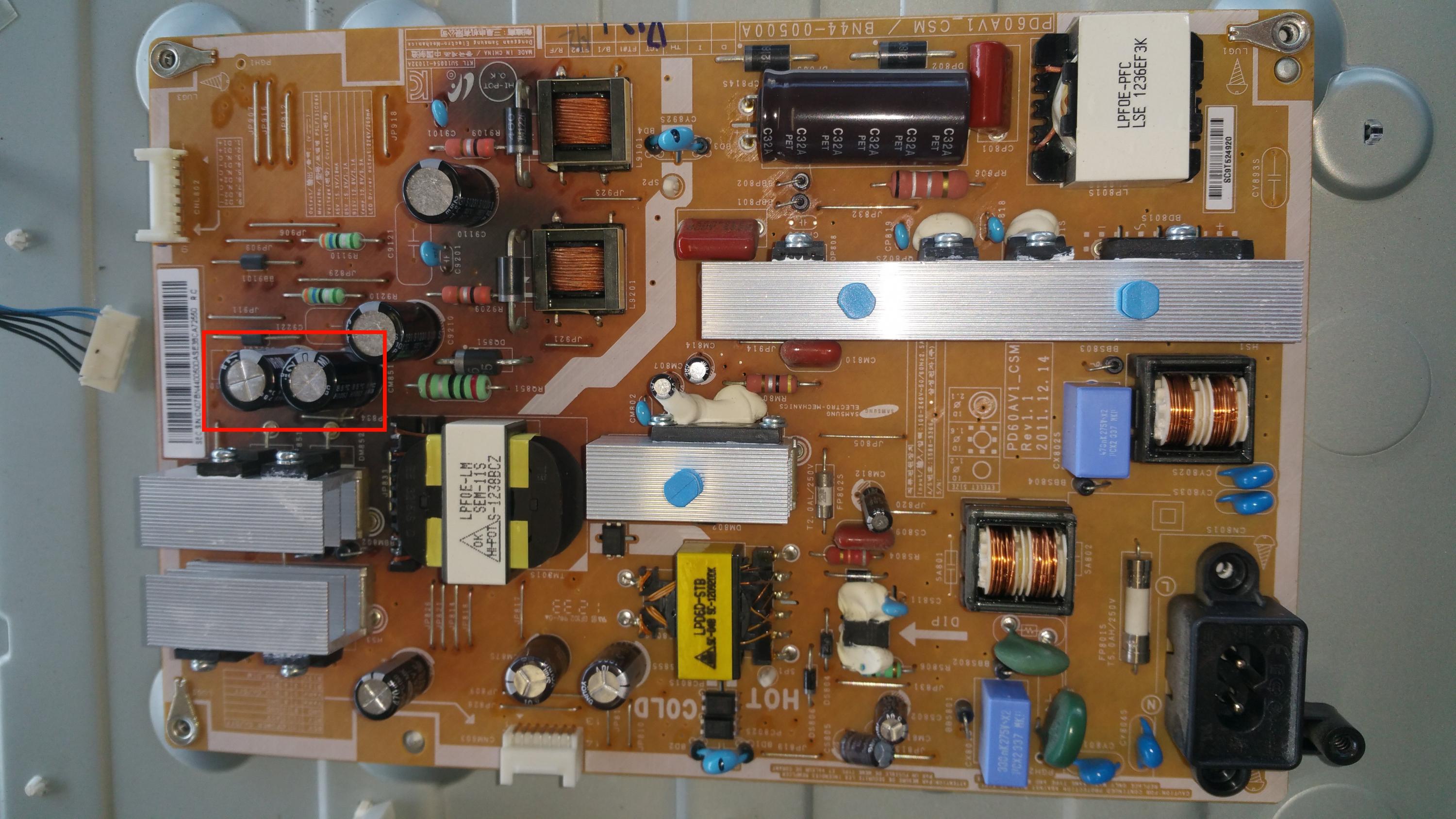

    I just got in a couple nice Samsungs.. Same series, one's a 55" one's a 60"
    The both will give a backlight but nothing on the display panel..
    I have replaced the Main Board on the 55 but no luck. I have a new TCON board coming..
    But on the 60", there is an added twist..

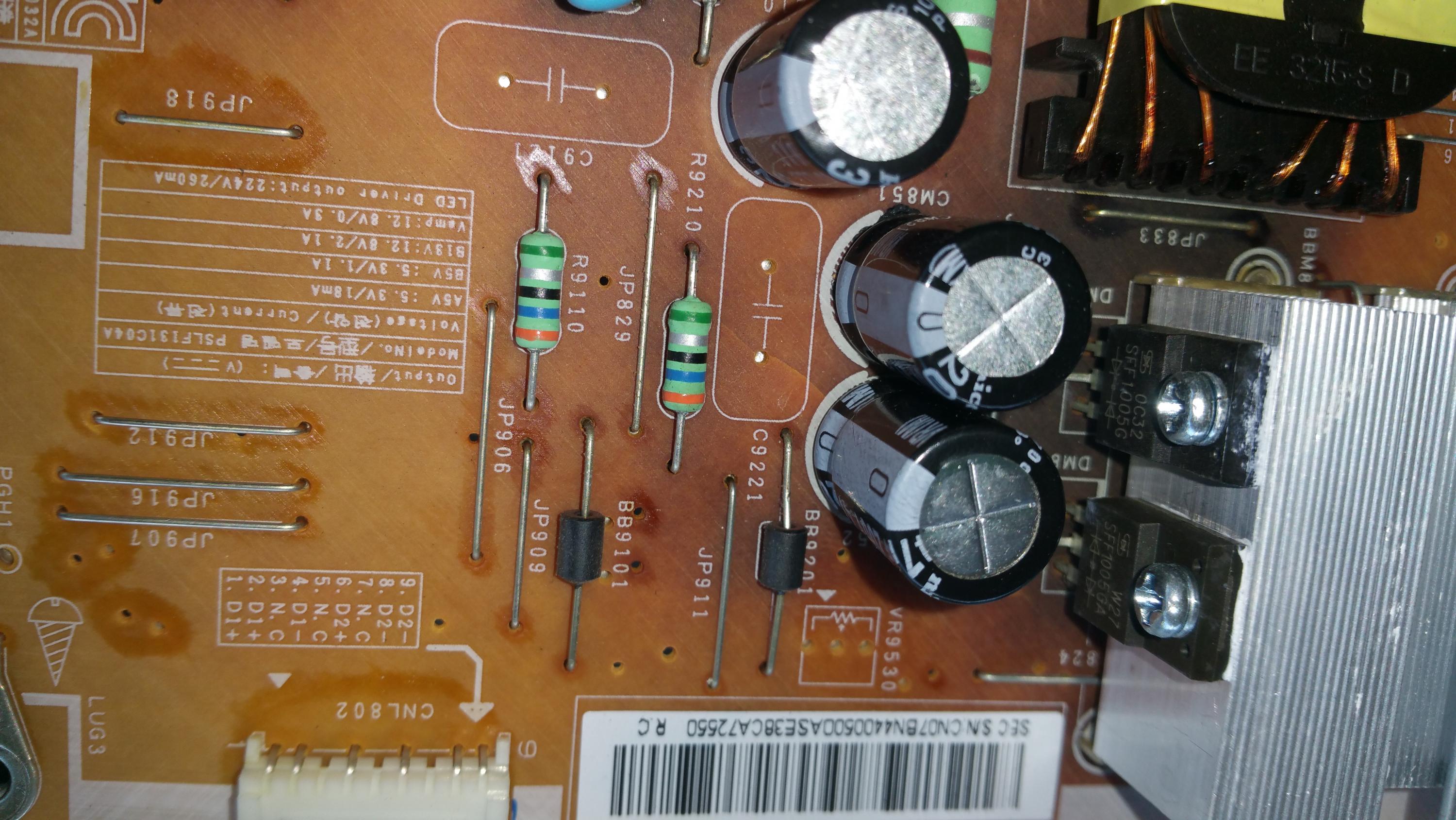

    The Power PCB had 2 blown caps (marked in red) plus a couple blackend charred areas... While pulling out the old caps, I kinda cracked the pcb, but the crack doesn't appear to have gone all the way thru the board..
    I have had instances where a bad power PCB would produce the kind of symptom I am seeing, but it's somewhat unusual.. Usually when I get a back light but no display it's usually a TCON/MAIN issue..
    Any suggestions on how to confirm??

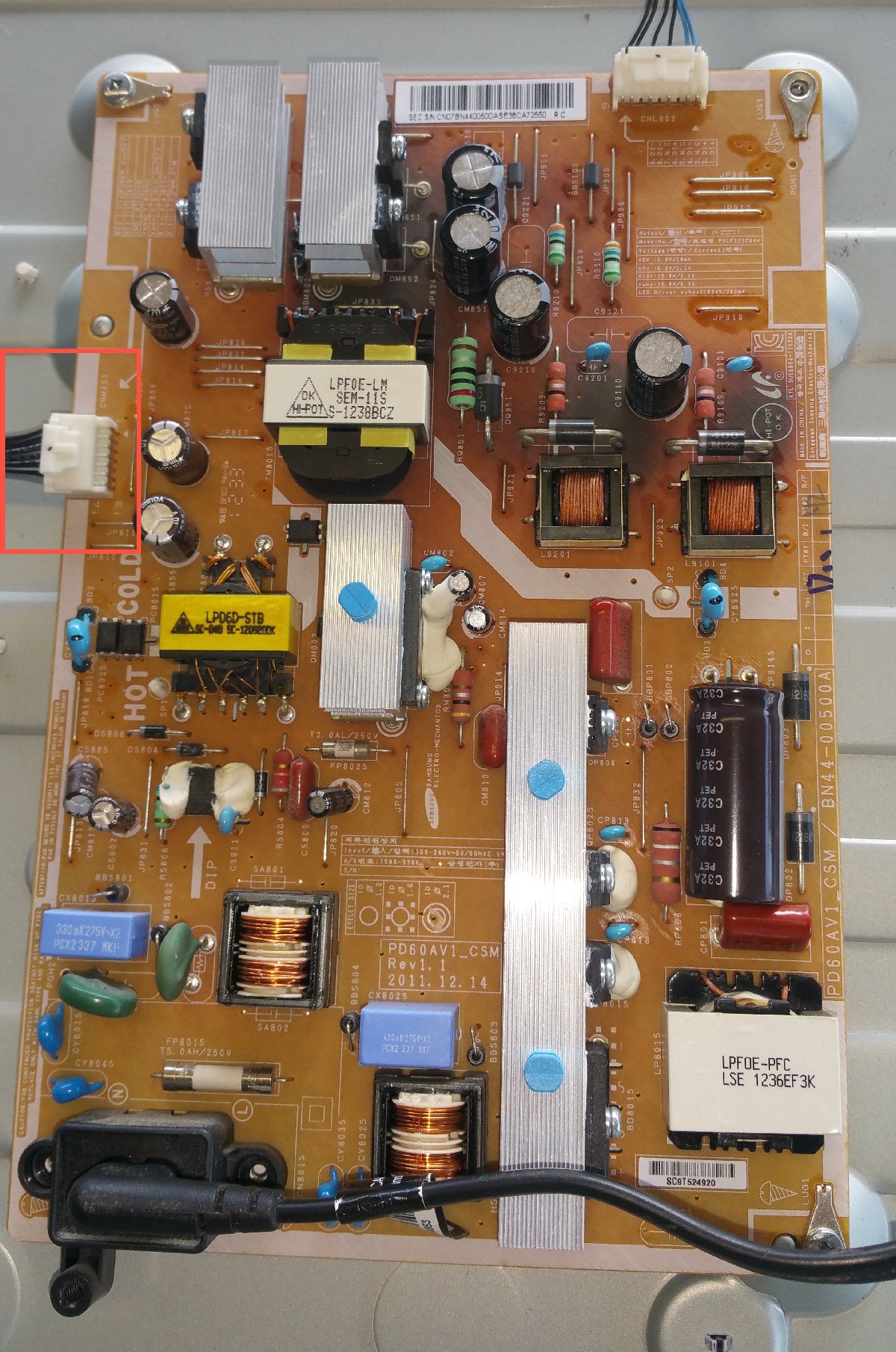

    Another weird thing is, when the TV is turned off, but plugged in, I pull the marked connector and the backlights come on...
    That would seem to indicate some kind of short in the Power PCB???

      No that's not weird at all. These TV power supplies are designed with pull up resistors so the back lights will come on when you disconnect connector that goes from the power supply to the main board.
      I would check the usual stuff like 12v to the tcon board and removing one panel output ribbon cable at a time

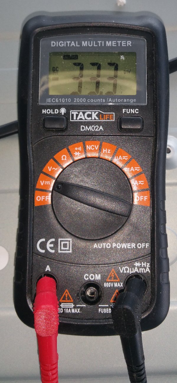

            With the NEG Probe on chassis GND, I get -12.65V on either side of the TCON fuse...

              You have your multimeter probes swapped. Anyway, your readings show the Tcon fuse is good.

                  black in middle red on right i think

                    My black lead is in com.
                    • Michale32086
                      • Nov 2011
                      • 1453
                      Re: Samsung UN60EH600 UN55EH6000 Identical Problem
                      I'm a idjut...
                      Thanx...
                      That explains a lot of weird readings I got lately..

                            OK 12.66V on both sides of the TCON fuse..
