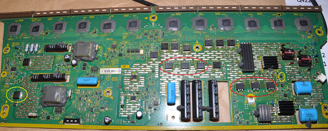

    Looked up a service manual on the net and identified the 7 blinks code as SN-Board failure. Since I had no idea what a SN Board is, I started the search that lead me here, among other places. I read all about it and learned about the "screws that screwed up" my TV. (More info HERE)
    So, I started by opening the back of the TV and cleaning the dust found inside. After a brief visual inspection, I found no culprit for the POP sound, so I started with the multi-meter.
    The obvious (for me) point to start was the power source (P-Board). One blown fuse (4A) and two transistors shorted. So far, everything seemed to be coherent with other SN-Board failures found over the internet.
    Next, I started to measure things on the SN Board (or YSUS board). After taking it out of the TV chassis I found the solder under the screws to be burnt exactly like others with the same problem showed it in pictures all over the net.
    I did all the possible checks to ensure buffers are OK, no shorts found on the connectors, connectors with ground, no short on C842, etc.
    Found 6 parts shorted (Q401, Q402, Q403, Q421, Q422 and Q423) and some SMD diodes near the buffers also shorted that I later learned they are supposed to show as shorted.
    I ordered a repair kit with the risk of getting fake parts because my electronics skills are not that advanced to find in-production equivalents for the shorted and discontinued parts on my board.
    The kit arrived and it was time for my temperature controlled soldering iron to go into action...
    Since the 6 transistors are used in parallel (3 by 3), I re-checked every one of them after taking out from the board, just in case one of them survived.
    No luck, 5 of them were still shorted and I found the POP source in Q423 that was physically cracked and showed an infinite resistance across all pins.
    Since the recommendations were to also replace the driver circuitry IC502 and Q531 (and they were included in my kit), I found the courage to try and replace IC502 with my very unfit soldering iron and without a proper magnifying glass or light. I have no idea how to test the original IC502 so replacement was kinda mandatory. Q531 on the other hand seems to be in working order when measured on-board with the multi meter. Checked all the pins of the SMD IC502 and they show no shorts, all connections are according with the schematics (my eyes seem to be in decent shape, despite my not so young age ).
    After replacing the above mentioned 6 transistors and one IC, I checked all of the gate resistors for the broken parts. They all show the correct value of 7.5 ohms. i also checked the resistors around the IC and found them all to be the correct value.
    And now, finally, MY DILEMMA: No other parts show short or weird readings (except maybe Q661 which I will change today because it shows a strange leakage between the gate and collector). Should I replace all the other parts that came in the kit (19 total parts) or just the ones I was able to find broken?

        The six mosfets (30F131 and RJP30H2?) that you've already replaced are already the most likely to fail due to the "fake" parts issue you mentioned. I'm thinking that the remaining parts are mostly resistors, diodes and some smaller mosfets, which are probably fine. With that being said, when those large mosfets short out, they do put a strain on surrounding devices and I would say go ahead and install the remaining parts in the kit if your soldering skills are up to the task.

                  Took it apart again, measured everything that I could and found this:
                  -the 6 transistors are shorted again (Q401, Q402, Q403, Q421, Q422 & Q423)
                  - Q423 again is cracked open
                  - D421 shorted (a DAF30A)
                  - power supply blew the same way (2xR6015ANX and one 4A fuse)

                      Remove Q423 and recheck DAF30.
                      DAF30 , RF1501 etc read short because of the shorted FET. You probably had fake parts even though the tv turned on for a while.
                      Dont buy repair kits , the 30F131/RJP30H2A etc are all fakes , even the RJP64G3 can be fake.
                      95% of all these boards you need to replace the 6 fets and the 2 small ic's and the 2xR6015ANX + fuse.
                      Replace all the FETS for FGD4536TM , there are also fakes on ebay so check the reviews of the seller.
                      Do NOT buy 30F131/RJP30H2A and re-use the old RJP63G4.

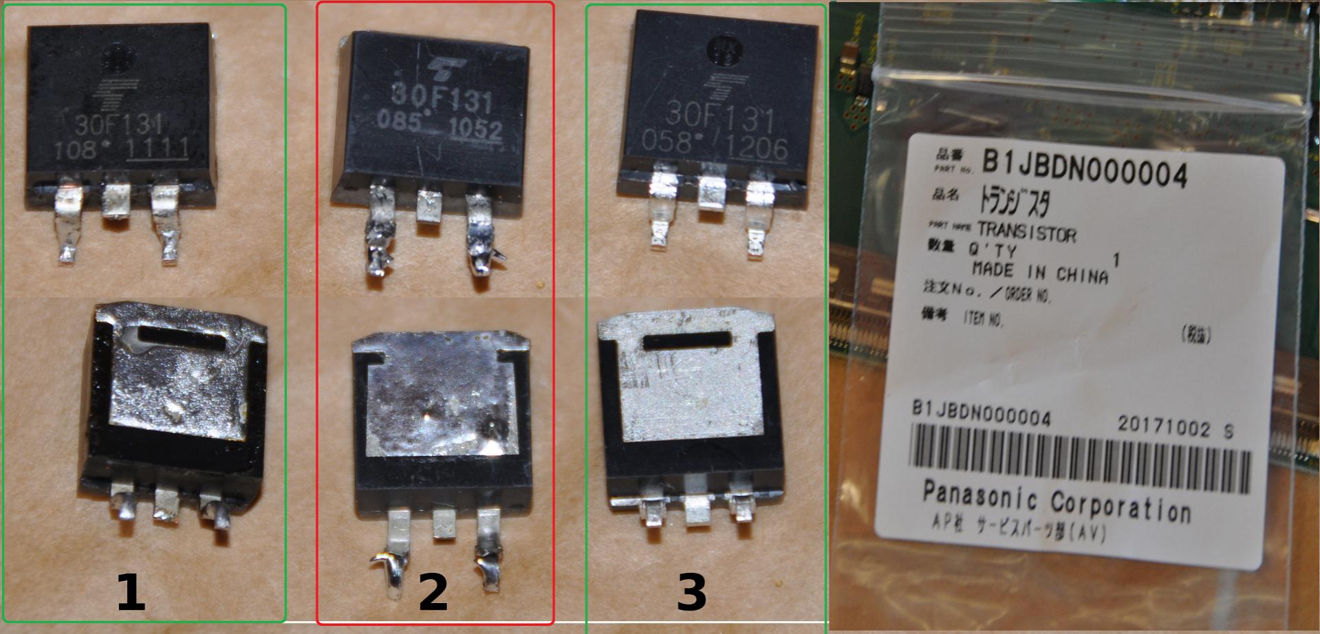

                              Sort'of OffTopic until the parts from Flea-Bay arrive from the recommended vendor:
                              I managed to borrow one original 30F131 from a Panasonic authorized repair shop (borrow because the guy said he would not sell them for any amount) and take a picture for other people to see...
                              1: original part from my TV
                              2: Kit part (shitty fake)
                              3: Panasonic original replacement part
                              As you can see, the original part and the spare have the same Toshiba logo while the fake one has a different logo. Numbering and layout are different between them.
                              Also, the under-side is different, in the originals we can find a segment of plastic, while in the fake one the whole underside is copper.
                              I also measured the spare I borrowed with my DMM on diode mode and found that it shows NOTHING in either combination of G / E / C. This was a bit strange for me but the owner said that my DMM does not provide enough voltage for the part to start conducting in any way and this is normal.
                              PS: out of the three 30F131 fakes I had on my board on Q401-403, they all show different measurements: Q401 is fully open, Q402 is fully shorted and Q403 shows almost OK values for a normal transistor, but not a FET

                                Quick update: I found out that the P board did not blow this time, I just assumed it blew in my previous post but now I have checked both R6015ANX and the fuse, they are OK.
                                Indeed Moreno83, you were right, the diodes on the SN board check out OK after removing the FETs.
                                Further checks revealed no other component shorted or open, including driver transistors & IC's.
                                Managed to get my hands on 6 GT30F131's from the guy I mentioned in my previous post (after a lot of persuasion and some significant amount of cash) and I placed them in Q40X and Q42X places. Reinstalled the original RJP63G4.

                                  People dont always believe me when i say they use fake parts. But i repaired alot of these models and i have been there using fake parts.

                                    It's alive! And looking good.
                                    Now, it's still a question of how long will it run for, since my last "record" was about 1 hour.
                                    I am running still with 1 part from the kit, the one under the heatsink, I think it was a DG302, the original is shorted.

                                        How do you mean 1 part from the kit? It is best to use only genuine parts....
