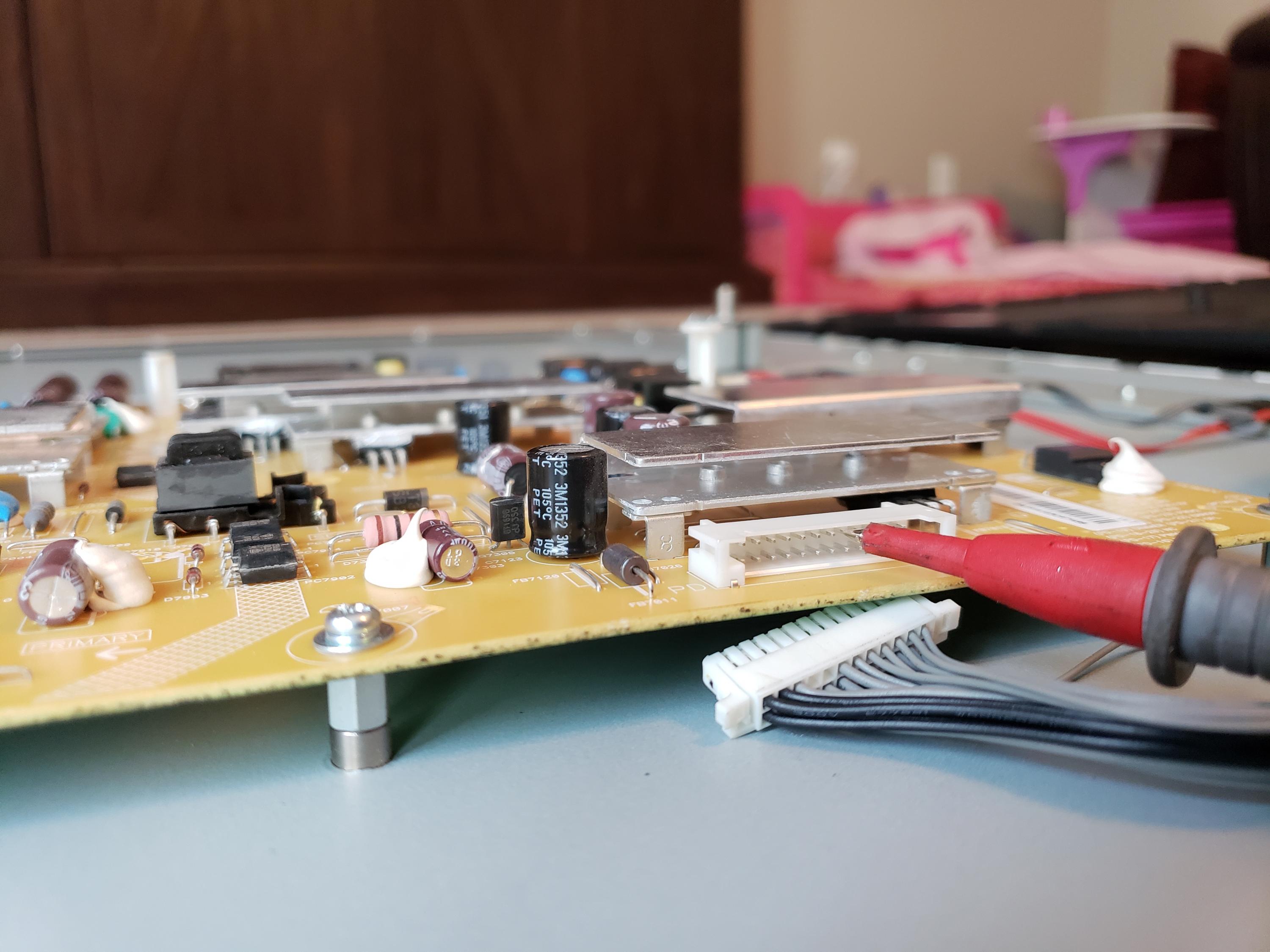

    I have a Sharp LC-60EQ10U that does not turn on. Minutes after plugging it in. The power light blinks 3 slow and 1 fast. I have replaced the power board, and still the same issue. Anything I'm missing or do I need to replace the main board? I'm not too tech savvy, just looked like a pretty basic fix. Any help is appreciated.

          Yeah I watched that video. Is the power board the only cause of this code? I plan to test the new power board asap and see if it's doing what it's supposed to. Just curious what the other issue(s) could be.

            I went to test the board and I am having trouble determining which pin is what. As the pins dont seem to be in any specific order counting them (maybe I'm just overlooking something). I have located the PS ON pin, and it reads 5 volts. I am unable to figure out which pin to jump it too though. As the video lists it as 5VSB, and I do not have that pin. If someone could guide me on which pin to jumper it to, and how the pins are counted itd be much appreciated. I will attach pictures of the labeling. And which pin is the PS ON.

              Here is the labeling and pin location.
                Re: Sharp LC-60EQ10U no display code 3-1
                https://www.badcaps.net/forum/attach...3&d=1522413928
                The exposed pins you can see from the top side of the board are the ODD number pins, the EVEN number pin (you can see where pin 1 is as marked on the board) you will have to access them from the bottom side of the board or from the back side of the connector using probe with skinny tips.

                  I have the same TV and the same issue too. I tested all the pins and was able to pin point 2 pins whose volts did not match with what was listed.
                  Pin 1 & 2 shows 12V on the board but when I tested it Pin 1 only gave me a little more 7V and Pin 2 was 0V.
                  So, does that mean the issue is with both Power and Main boards ?

                    Sorry, correction Pin 1 gave me a little more than 7V and Pin 2 as 0V

                      PNL-12V Pin 1 and pin 2 of the connector PD are electrically connected together so pin 2 should also show the same reading as pin 1.
                      The 7V PNL-12V output is more likely due to common fails switched 12V LDO regulator IC Q7120 (KIA378R12PI).

                        Is this regulator located on the power board ? If yes, installing a new power board will fix this issue ?

                          Yes it is on the power supply board, just look for that part I give the info about.
                          That should fix the PNL-12V power supply problem, but I do not what else is wrong with your TV beside the bad PNL-12V, you have to have good power supply first to know if there are other problems with other boards or not.
                          Do you have tools and know how to solder?

                                    I ended up getting a used power board from ebay and it worked like a charm. Thank you for all your help.
