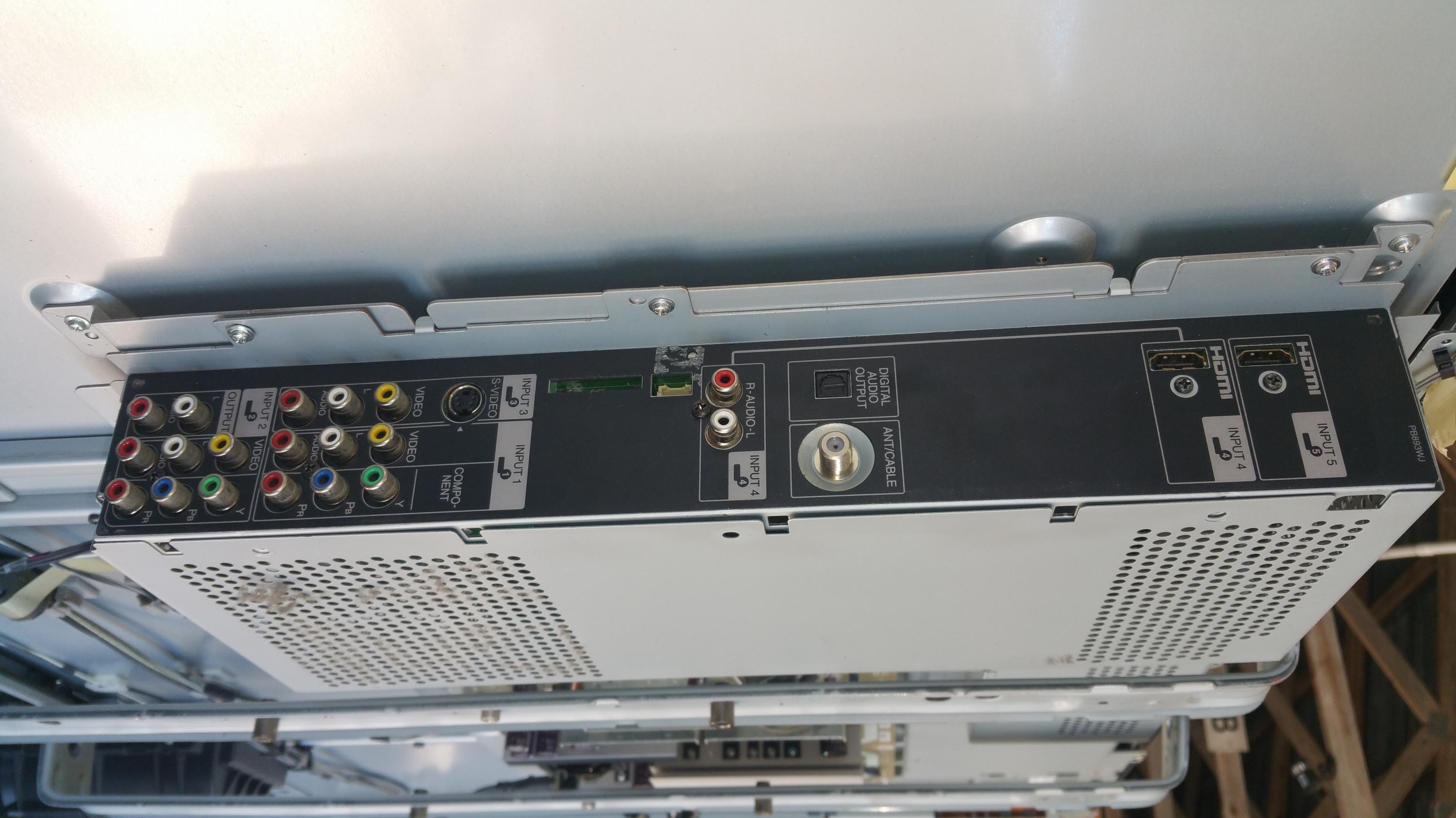

                              • Michale32086
                                • Nov 2011
                                • 1453
                                Re: Sharp Aquos LC-52D62U "an incompatible video signal has been received"

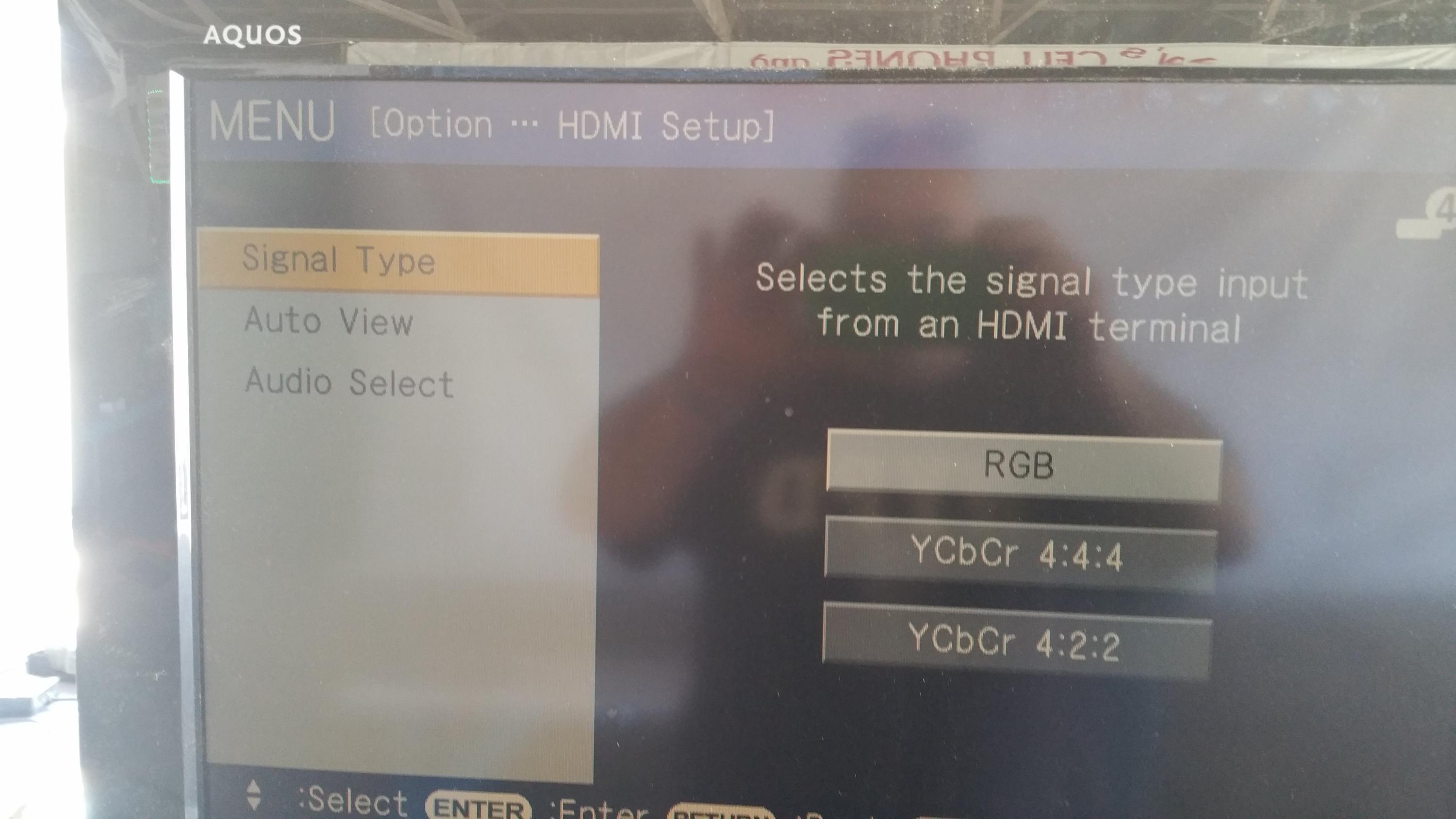

                                OK I have it on INPUT #4 HDMI.... I get sound, but no video..
                                Under the menu settings/option there is an HDMI setup option that looks like this:
                                • Michale32086
                                    ensure that the label has not been set to pc as that will cause problems.
                                    • Michale32086
                                      • Nov 2011
                                      • 1453
                                      OK Progress... of sorts..
                                      Up in comment #16 there is a pic of HDMI Setup...
                                      In that, the SIGNAL TYPE is ghosted...
                                      I changed the label from INPUT 4 to HDMI and I was able to select SIGNAL TYPE..
                                      The GOOD news, I didn't get the INCOMPATIBLE SIGNAL error message..
                                      The BAD news is, I didn't get any kind of display at all..
                                      That happened if I selected RGB and either YCbCr option...
