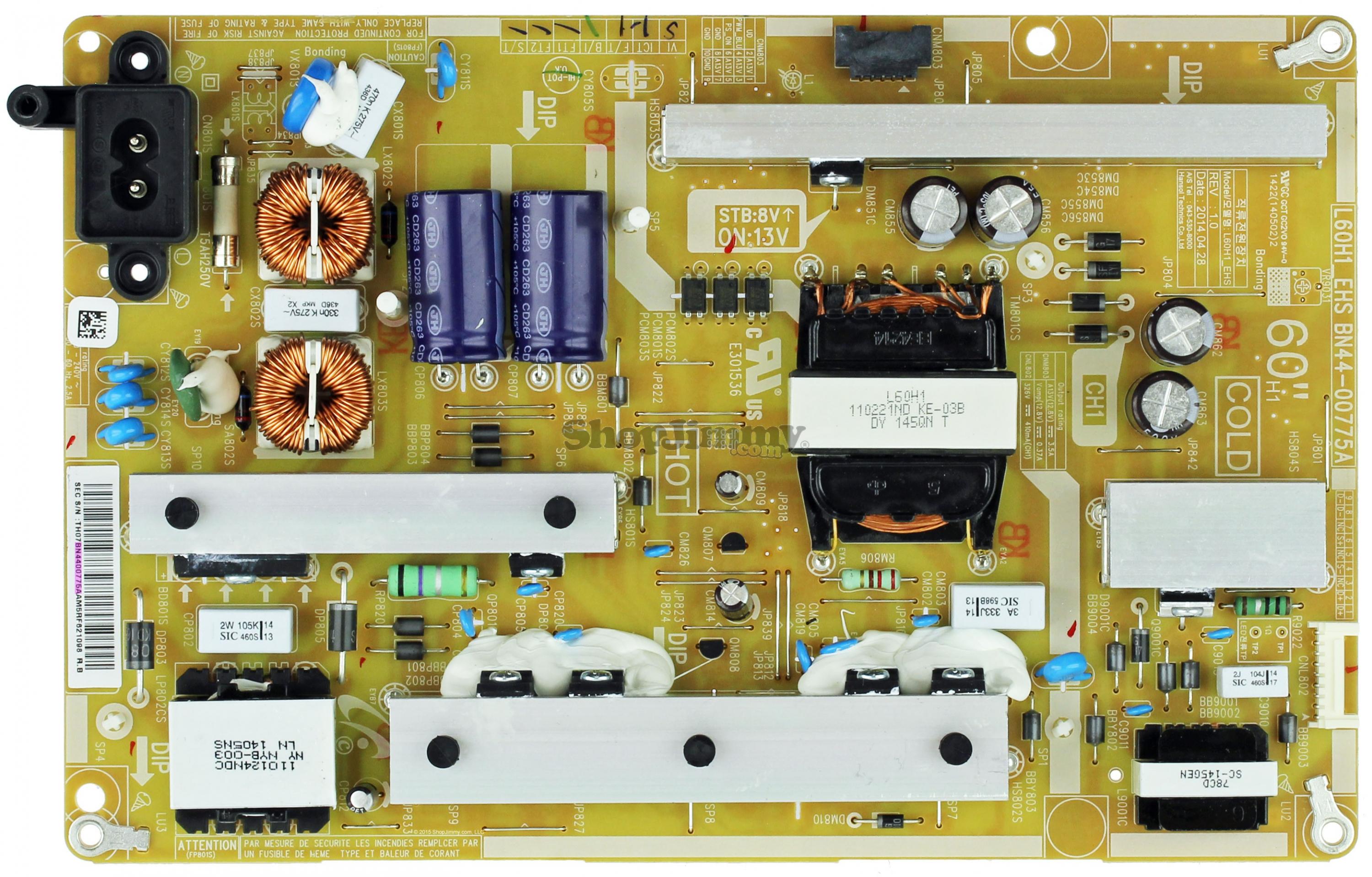

    I have a problem with this tv, It's not powering on. I've had a look over the circuit board there is a brown burn mark near a blue capacitor and I can hear a ticking noise coming from around the lower right of the black heatsink.
    underneath the pcb is an insulation sheet which has been heat damaged. The blue cap 27K 1KV is connected to an ST package
    ST e3 6
    14DNM5
    DN
    64DJR 436
    I cant find any datasheet for this, any help would be greatly appreciated

      They accepted an offer £43.98. I made a mistake there are two points on the insulator affected by heat
      The worst was from an AOD5N40 MOSFET TO-252 of which I found a replacement
      what value capacitor is 27K 1KV is it 2700pF?
      Do you have any recommendations when replacing this new powerboard should I use insulation tape or Thermal Pads.
        Re: Samsung UE55HU6900U Stuck on Standby
        That MOSFET Q9101C is for the Voltage booster circuit to provide boosted Voltage for the backlights, it is driven by LED controller IC9101.
        That C9101 is 27pf 1000V is the snubber cap for Q9101C which is connected between the Source and the Drain pin of the MOSFET.
        So is the MOSFET tested OK? Check the RESISTANCE between S and D pin to see waht you get. It got hot may be due to bad IC9101.
        Is the cap C9101 tested bad?

          Okay I tested both meter ohm's set at 200
          should I remove the C9101 capacitor there are no polarity markings
          Q9101C - ST e3 614DNM5 DN 64DJR 436
          114.9
          06.2
          Q9102C - AOD5N40 MOSFET TO-252
          No reading except unconnected middle pin to drain
          00.4 ohm

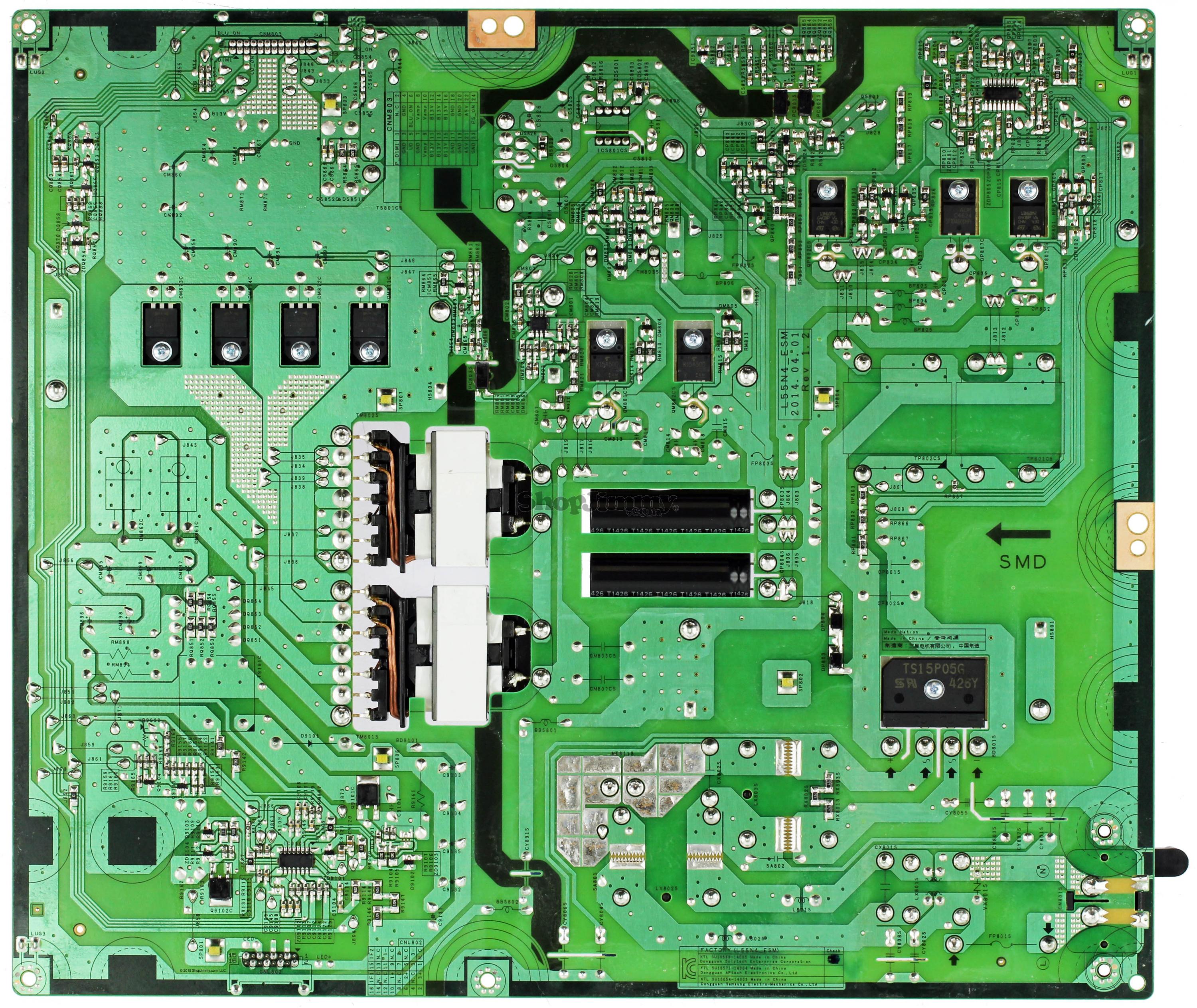

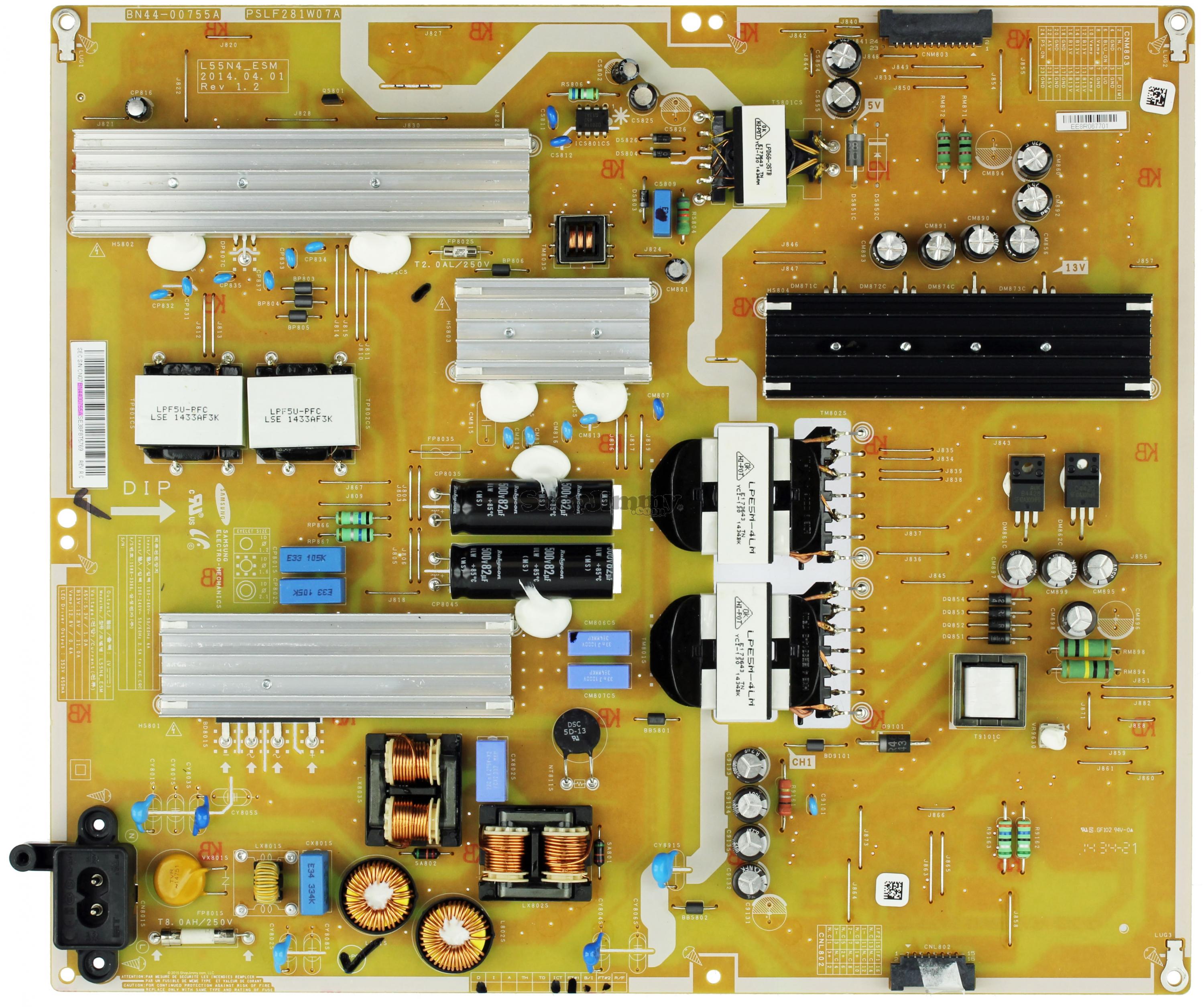

            I uploaded the wrong pictures of the board in post 4, I uploaded 775 instead of the 755.
            Here the pictures of the 755A.
            Pictures provided by shopjimmy.
