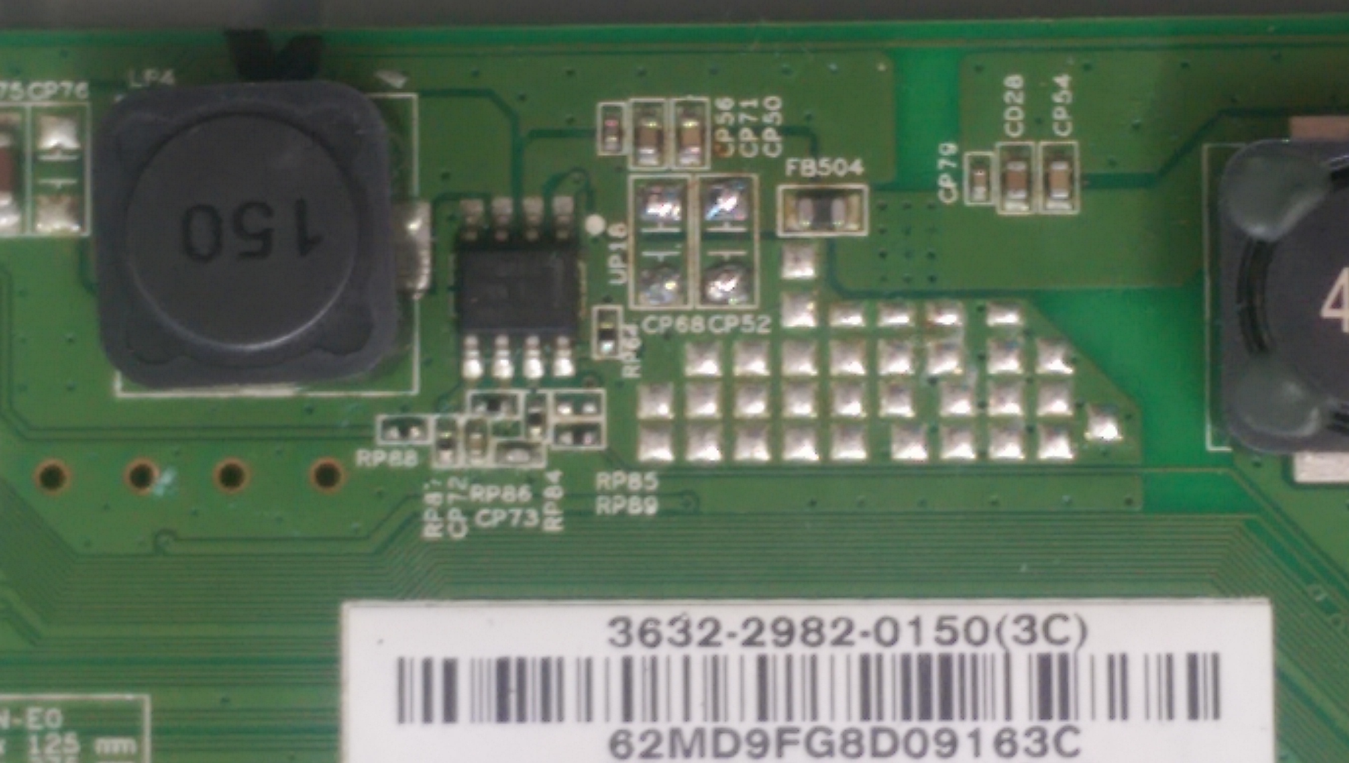

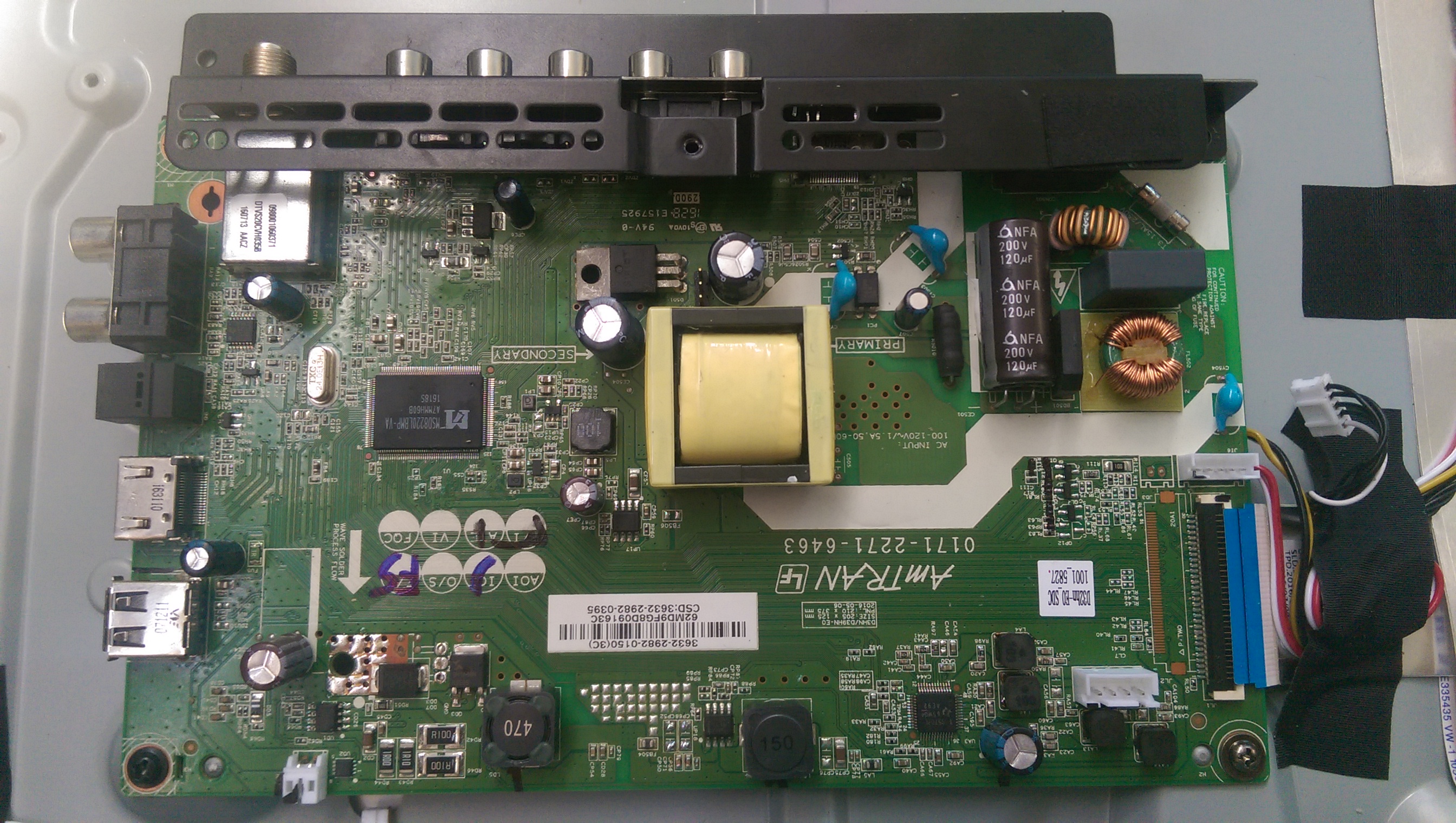

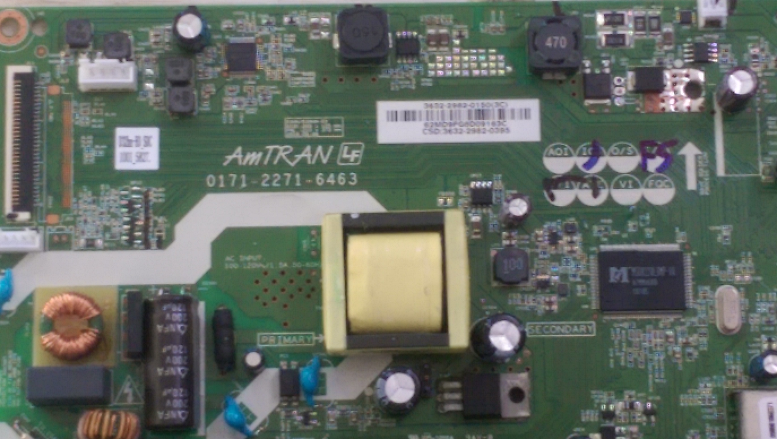

    Hello my tv vizio model E32HN-E0, card number 0171-2271-6463, sticker 3632-2982-0150 does not turn on, when reviewing I observe capacitors in short, no CP52 and CP68. Can someone with a diagrana give me the correct values of the capacitors?
    If it is not too much to ask, someone could give me a schematic of this Tv
    Thank you

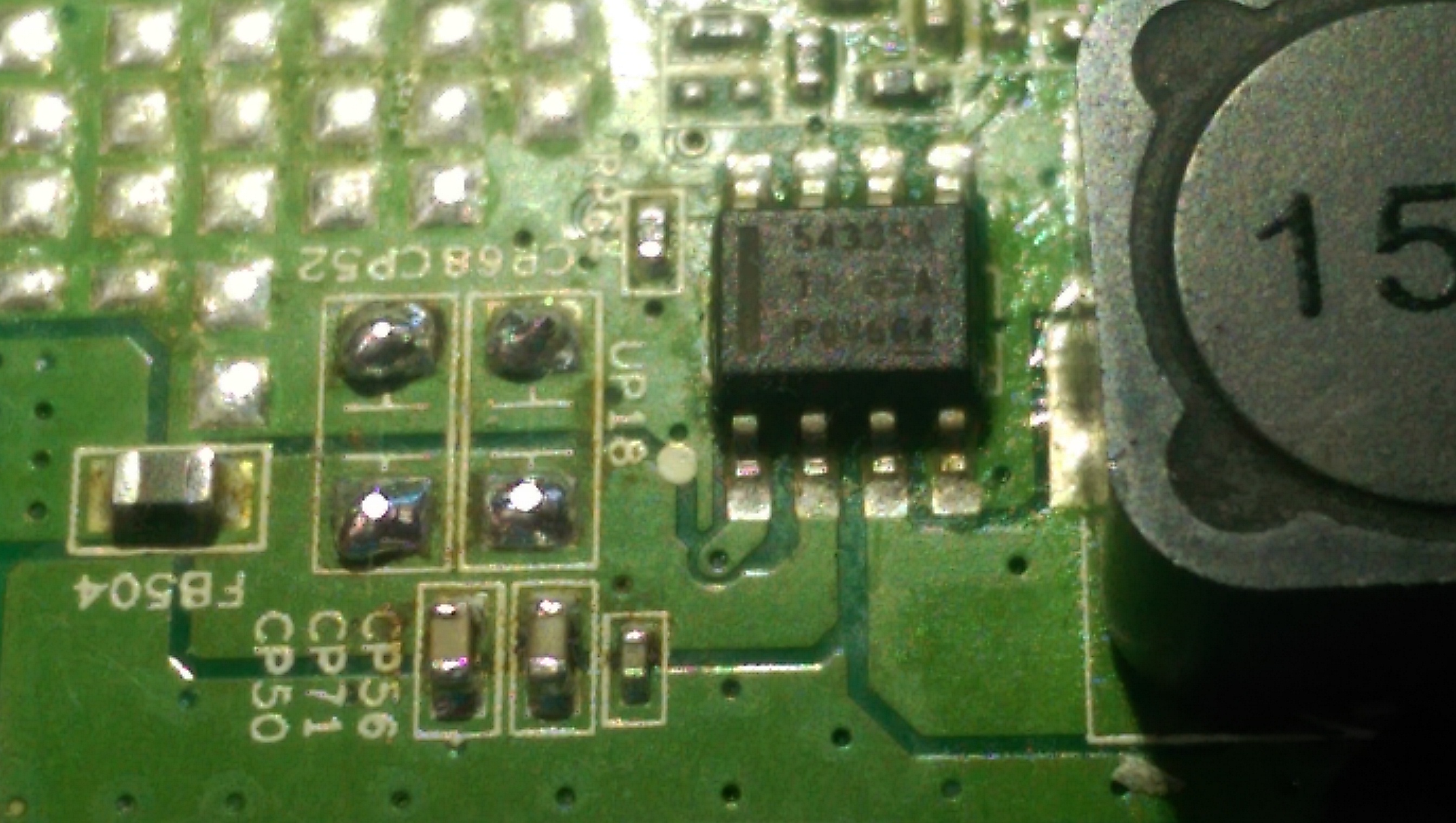

    So did someone remove those two caps before you get to work on this TV?

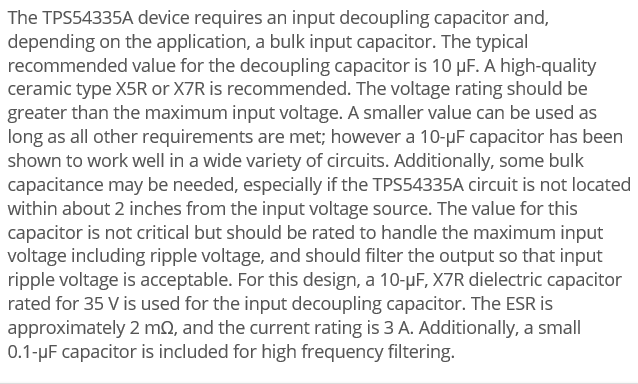

      Re: Vizio D32HN-E0 caps in short Help.
      This may help
        Hi, i removed them and put two capacitors of 15 mf 50v and it did not work ....
          Hi Dskall, i will test with 10 mf, 35V.......thanks for your info
            Did removing capacitors remove the short? Getting voltage on input pin 2 and out pin 3?
              Yes , is correct.
                These capacitors energize the tps54335, I will test and report
                  Hi Dskall, Tv turn on perfectly with caps 10 mf, 25v, thanks for your help.
