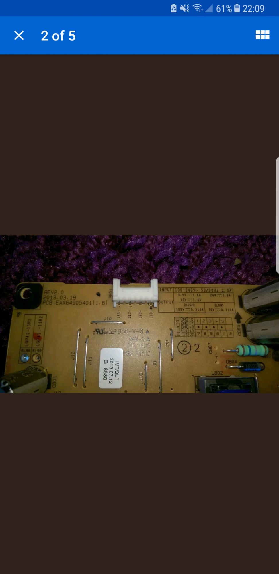

    I have a LG 42la620v tv with a back light issue. The set powers up as normal displaying the splash screen with the back light working properly but the back light cuts out after a second and the power led flashes three times. The logic board is functioning a picture can be seen and functionality confirmed by holding a flashlight up to the screen.
    I have measured voltages from the PSU and the 3.5 12 and 24v rails all measure correctly and have little to no ripple or transients as measured with a scope. The model of the PSU is EAX64905401(1.7) I can post pictures if needed.
    Additionally the PWR_ON and DRV_ON pins both read 3.5v when the set is initialing and running. The PDIM1 and PDIM2 pins both read ~1.2V They are something to do with brightness control. Im not sure what the appropriate reading is for these pins I don't think that an analogue voltage reference would be used for back light control.
    The led driver outputs ~35v for a split second during startup then immediately drops off to nothing this behavior is repeated regardless of whether or not the back light is connected.
    I an unable to isolate the cause of the fault either the back light or back light driver is defective. Im unsure as to how to test the back light I tried hooking it up across my bench psu but coud not reach the necessary voltage. It would be helpful if someone with some experience with these sets could shed some light on my situation.

                        I got a schematic from:
                        The driver uses the BD9483f IC if anyone knows about it.
                        All Caps tested good on the psu so ill go into more depth with it tomorrow with the schematic.
                        I can buy a good psu board on ebay I can also get a new driver ic if i can isolate it as the cause of the fault.

                              Can I see good clear straight shot pictures of the whole top and bottom side of the board?
                              You TV has two LED strings, so we need to verify the Voltage of Anode and the Cathode of both LED strings.
                              1) TV OFF, set your meter to higher than 200VDC scale, then keep the black probe of the meter on the chassis.
                              2) Keep the red probe of the meter on pin 1 (LED 1) of connector P801.
                              3) Turn on the TV while keeping an eye on the meter to see how high the Voltage goes up to, record that number, then wait 10 seconds to see how low it goes down to and then turn the TV off.
                              4) Repeat stepS #2 and #3 on pin 3 (LED+), PIN 5 (LED -), and PIN 7 (LED +).
                                Re: LG 42la620v Backlight Issue
                                Im getting roughly 35 to 50 volts on both led strings the refresh rate of my meter isnt very fast so there is variation between readings. This happens regardless of whether I have the leds plugged into there connector.
                                I know that between 70 and 105 vdc @ 0.313A is nominal for this board.

                                    Any pics? what are the numbers on your inverter board if you have one, can't seem to find much on this model, hardly see any parts or pictures.
                                      So both boost converters are not working at all then.
                                      I need good clear pictures of the whole top and bottom side of the board.
                                      Did you look up the spec sheet of the LED driver IC yet to see if it has the VCC and the Enable signal to turn on the IC?
                                      "The led driver outputs ~35v for a split second during startup then immediately drops off to nothing this behavior is repeated regardless of whether or not the back light is connected."
                                      This does not make sense to me, it should show the input Voltage at the LED connector if the Boost converters are not working, I do not expect it to show 0V
