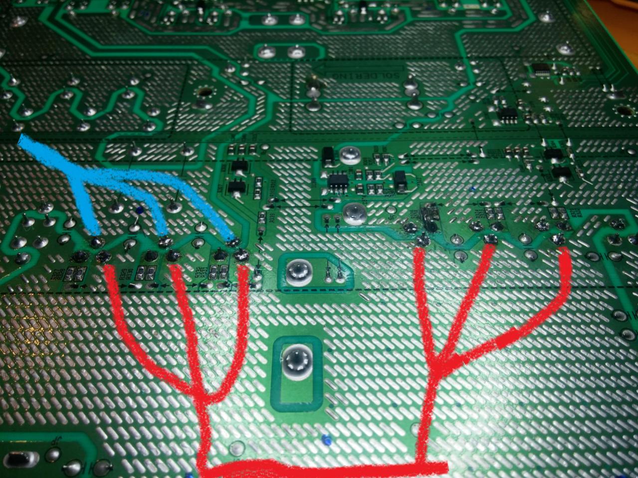

I did notice something that may agree with your second theory mentioned of why the 3 transistors shorted with good gate resistors. If you look at the attached picture the 3 transistors on the left and 3 right are reversed. The red side is common to both but from different pins and feeds the panel ribbon connector, the blue on the left comes right from the fuse after going through a copper coil. Anyways I'm out of town tomorrow so Sunday afternoon will be the big test. If you or anyone have anymore thought it would be greatly appreciated. I will keep you posted when I get back. Thanks for all your help.Comment

If your gate resistors are bad, your driver ICs are almost certainly bad. These would need to be replaced.
The driver IC provides the gate of the MOSFET or IGBT (most often IGBT), which is a small capacitor, with the many amps of pulse current needed to switch the transistor on and off.
The ICs cannot take much overstress and sometimes if the IGBT fails it will pulse the full Vs supply into the gate driver and resistor, destroying both.
It is not a matter of timing, more a matter that when the driver ICs go bad, then they can short to the +15V/+17V supply. This has the side effect of keeping the IGBT switched on all the time, which means if the other transistor in the set switches on at the same time, you're gonna have a bad time...

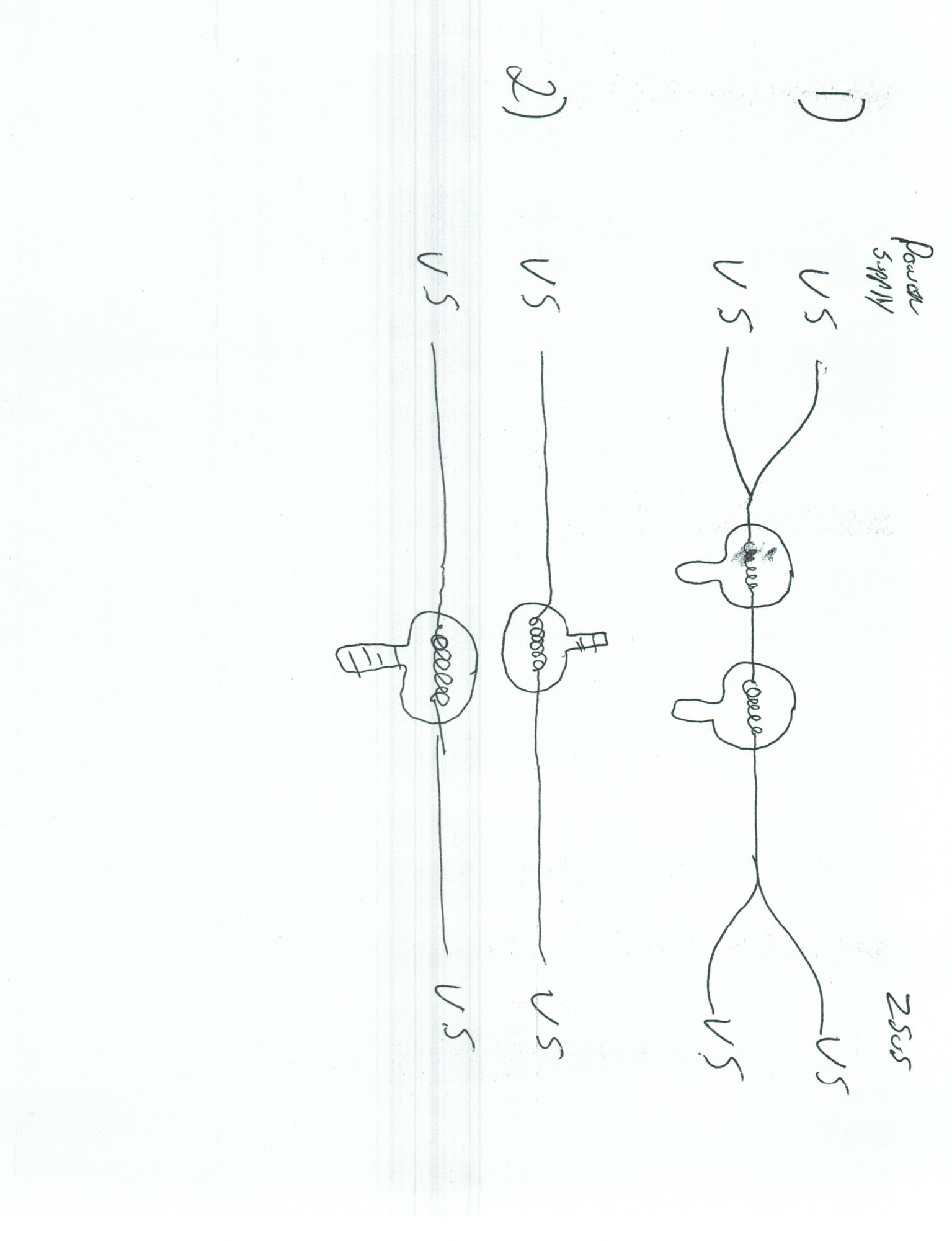

One thing you can do is a "bulb test". After the board is repaired - after you have replaced all of the transistors - cut both Vs (not Va) wires going to the z-sus board and put two 120V 100W incandescent (NOT ENERGY SAVING OR LED) bulbs in series with the Z-sus board.
If the bulbs light up bright and stay lit up there is a fault. It is possible some parts will fail, but the bulbs will limit the failure energy, so many fewer parts will be damaged, sometimes none. If the bulbs light up bright then dim, and the picture appears (It will be poor, and maldischarged, but there should be some image) then everything is ok. Then you can remove the bulbs, join the wires back together and enjoy your TV. Make sure to heatshrink the connection you had to break. You do not want it to arc against the chassis and cause damage.Last edited by tom66; 02-24-2018, 07:50 AM.Please do not PM me with questions! Questions via PM will not be answered. Post on the forums instead!

Hi Tom, Thanks for the reply. If only two of the gate resistors in parallel controling one transistors failed and all the others are ok do you think the IC 's are bad or could it be just from the transistor shorting ?
I did ohm out the ic to ground and across the pins and all had open or high readings, would this be an indication they are good ? Mind you I could only find one will Will's help

I'm assuming you put one bulb is series on each of the Vs lines ?Comment

Board is in the TV ready to be tested. All shorted transistors have been replaced, the two blown gate resistors also have been replaced and I have made a bulb testing box. Just need to confirm that one bulb goes in series on each Vs wire.Comment

Vs lines in parallel, cut BOTH, tie both wires together, then tie each end to bulb.
You basically want to interrupt the Vs from the power supply and make sure all current for Vs flows through the wires.Please do not PM me with questions! Questions via PM will not be answered. Post on the forums instead!

Success !!
Huge thank you to Tom66 & Will62 for there time and patience. If you were a little closerwould be on me. Just to conclude it was the 4 shorted transistors and the two gate resisters in parallel feeding one of the shorted transistors. Thanks again
