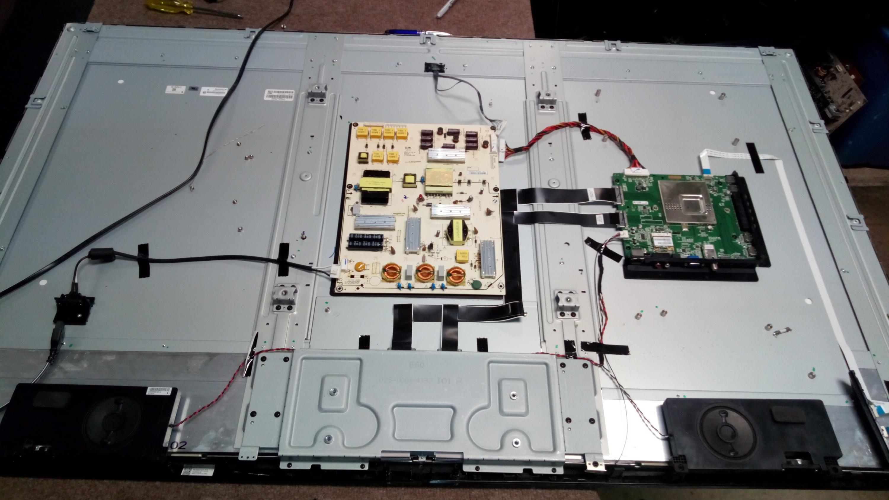

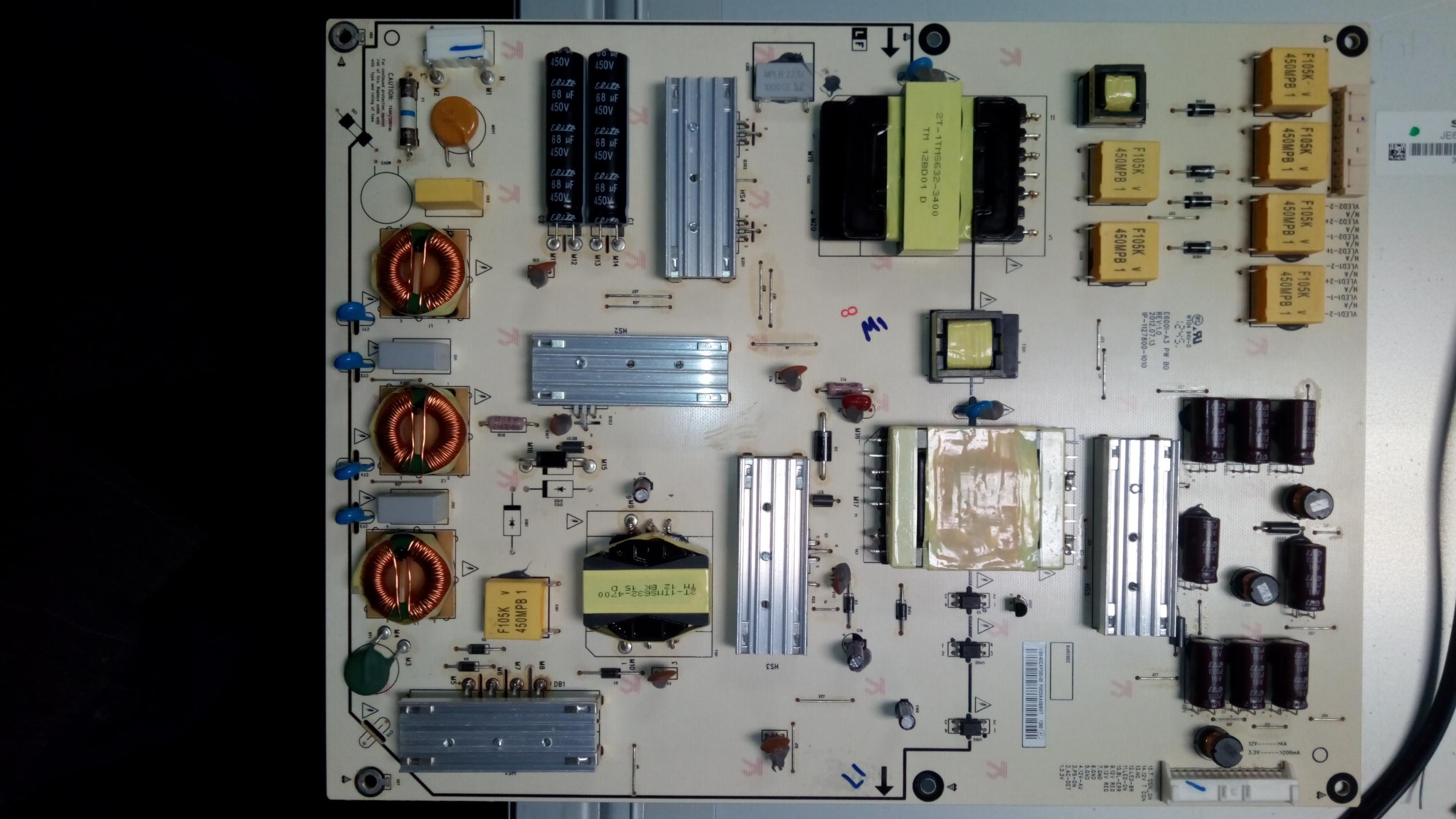

    You will get more uploading good clear straight shot pictures of the whole top and bottom side of the power supply board and also pictures of the whole backside of the TV showing all the boards.

      Here you go. I thought I had attached them, but obviously not.

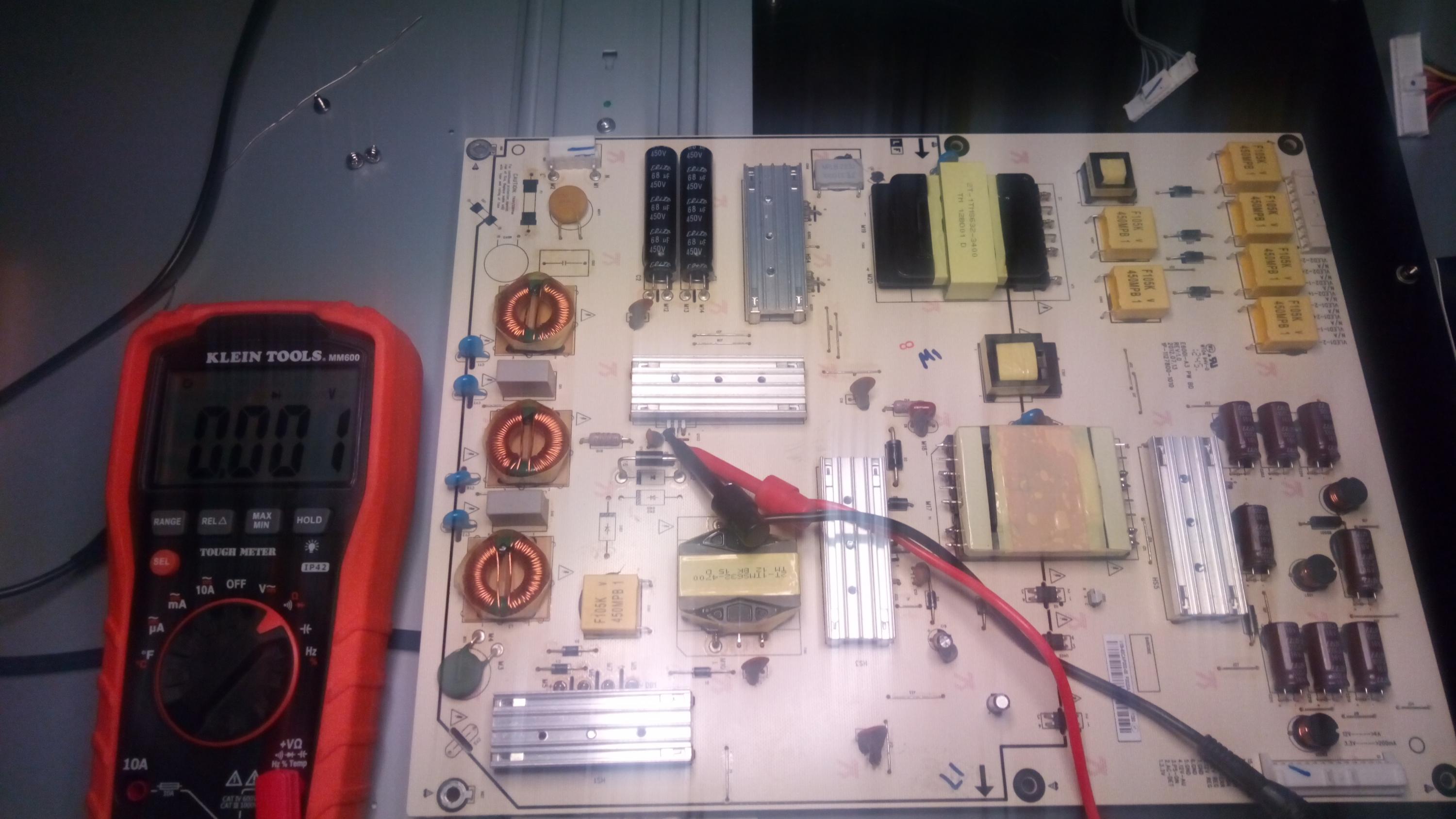

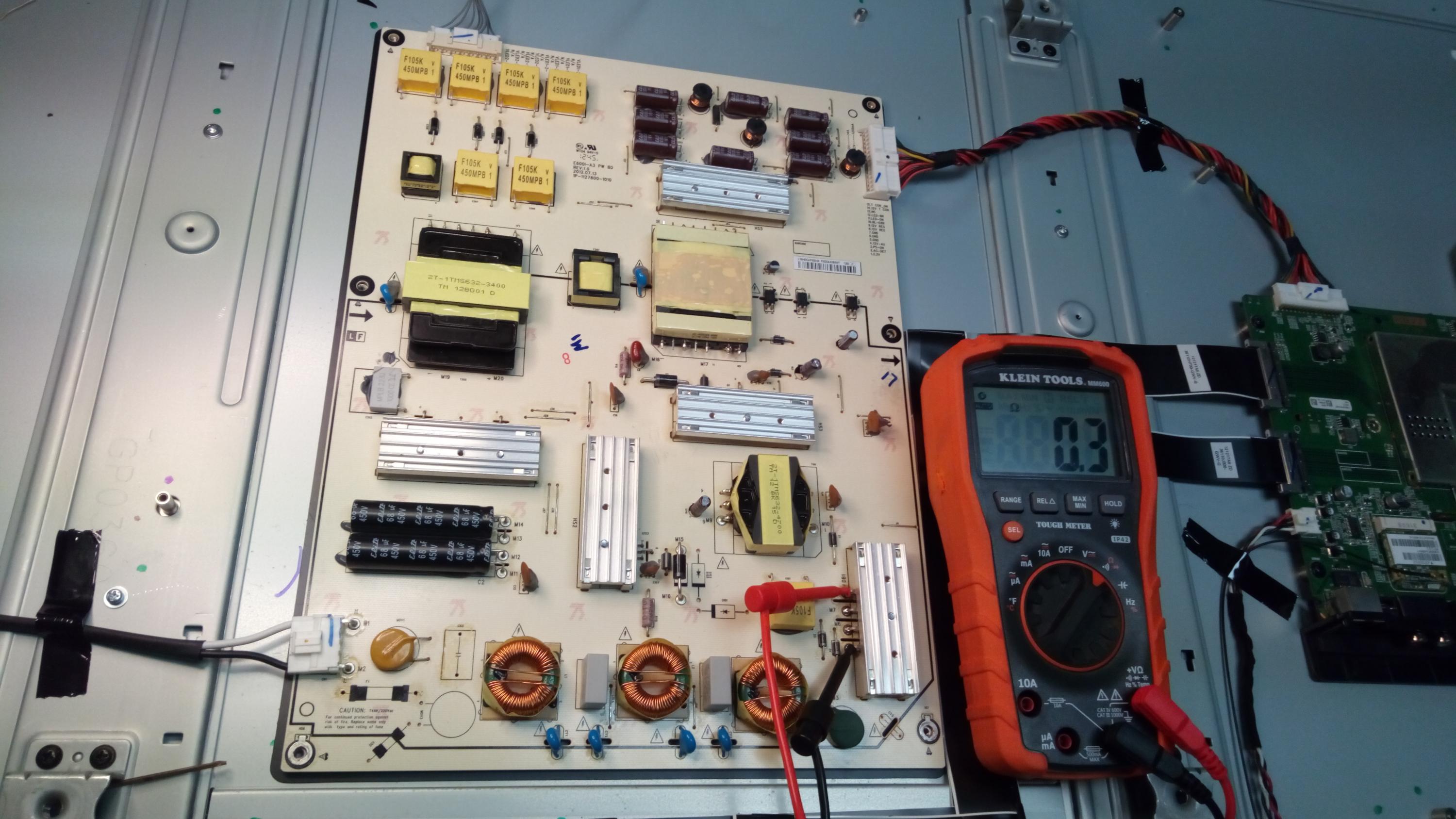

          Check the RESISTANCE between the two outter pins of the Bridge, and then between the two inner pins of the bridge, report what resistance you get, make sure to report if it is in Ohm, K Ohm, or M Ohm.

            I am posting pictures as they speak better than words.

              Remember, out of circuit, the rectifier tests correct accoirding to the datasheet.
                Re: Vizio E601i-A3 Blown fuse on powerboard
                The outer pins represent the output of the bridge rectifier. Since you're saying it's good and your meter shows .3 ohms, then that should tell you that there's a short somewhere beyond that bridge. Try checking some of the components connected to the "+" pin of the bridge for a short.
                  That is why I have you check the outer pins and the inner pins, sure enough, you do have shorted circuit due to shorted load..

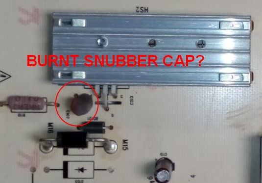

                    I cannot really tell from the pictures if those two snubber caps are burnt or not but they look like they have top section burn mark.
                    Check the resistance of those two caps.
                    I can also be shorted MOSFET which are mounted on the heatsink next to the cap that you also need to test the resistance between S and D pins.
                      The cap measures good with the esr meter. There is a grey colored adhesive applied to the cap, I am assuming to support it. The reading between the S and D pins is a dead short.

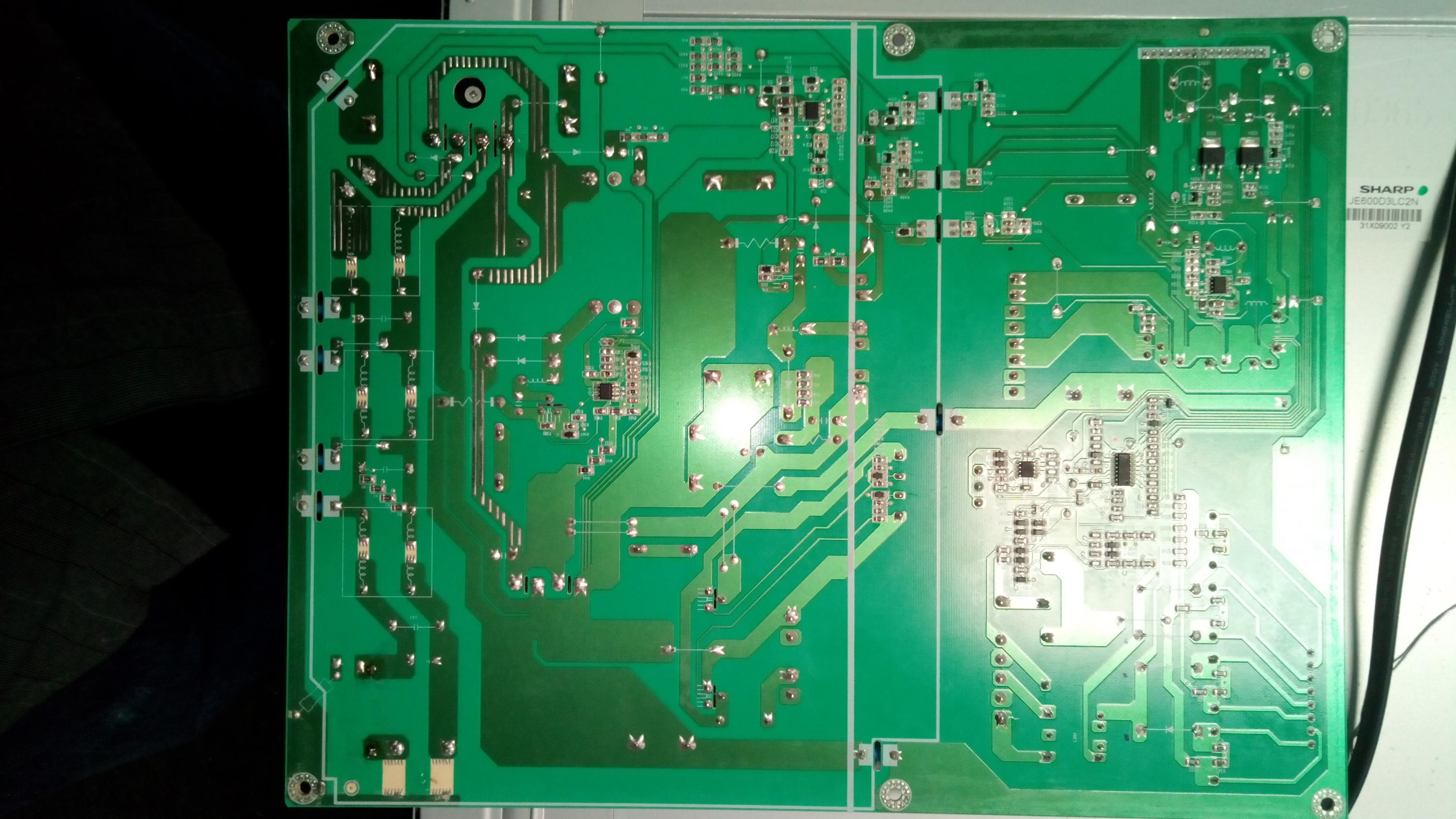

                              on the underside of the power supply on the hot side of the psu there are some black ics soldered to the psu can you read the part umber on them?
                                U101

                                  yes im sure thats the ic thats advisable to change at the same time im sure budm will confirm its the pfc ic
                                    FAN7930C spec sheet. Replace the IC at the same time otherwise youi can take a chance of blowing the new MOSFET if the IC is damaged when the MOSFET shorted out.
                                    You will have to verify that any component between the Gate drive output pin of the IC and the Gate pin of the MOSFET are not damaged.
                                    Also need to verify if the Resistor (usually less than 1 Ohm) between Source pin and the hot side circuit GDN is still good or not.
