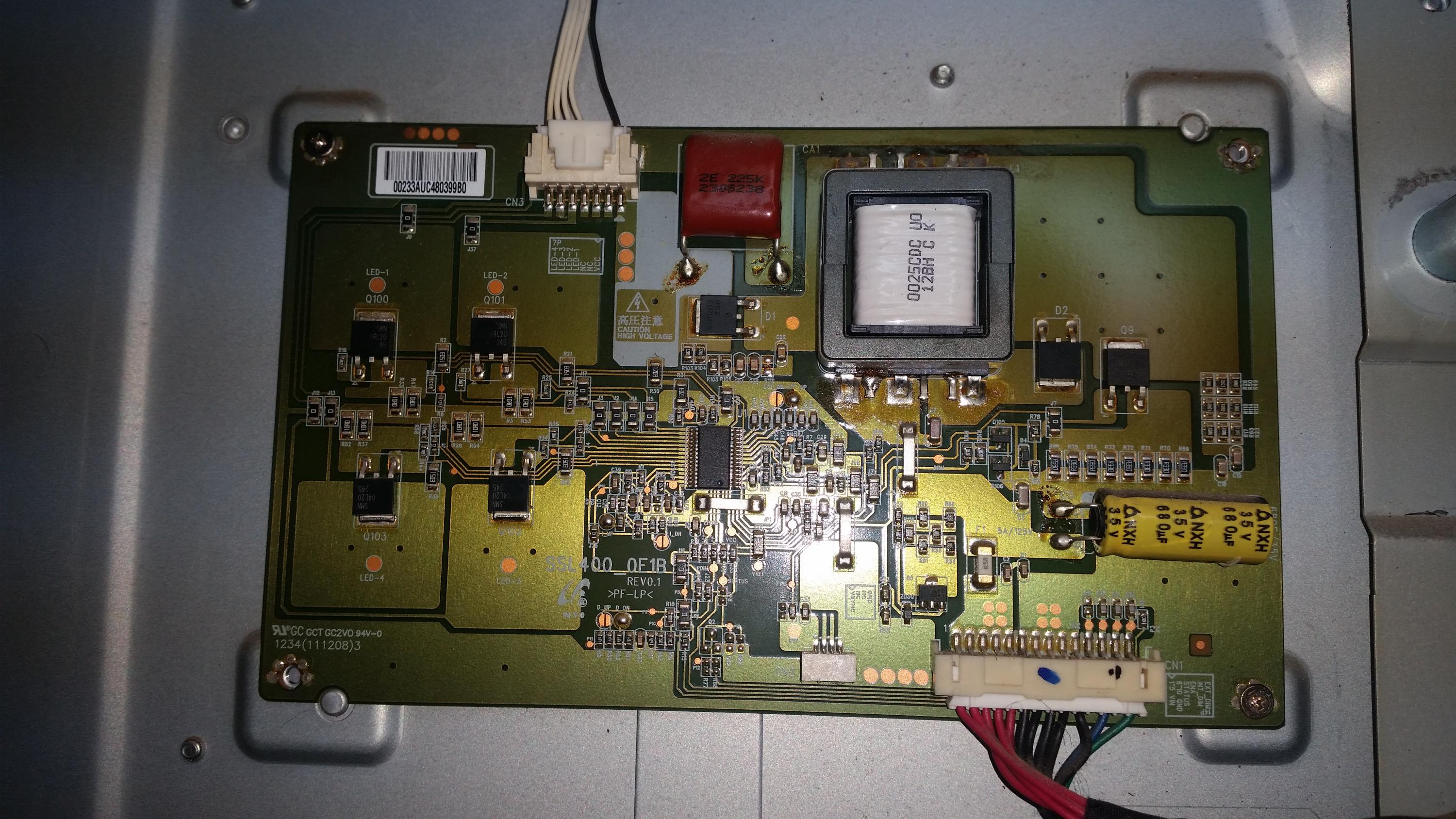

    So I have on the bench now a Toshiba 40HL933G
    It has four chains of LEDs in parallel.
    The fault is the Power supply comes up OK (5V 12V 24V)
    PS_ON goes to 3.3V
    INV_ON_OFF goes to 3.3V
    BRIGHT_ADJ goes to 3.3V
    The back lights flash on very briefly and go out. BRIGHT_ADJ goes to 2.9V
    Pressing the standby button repeats the process
    When I test the LED chains with a back light tester they all illuminate but I see I have three chains with almost the same voltage 78.4V - 78.7V and the other chain is 84.9V
    I would have expected they would all be the same or at least much closer than that.
    Would such a large voltage difference on one chain cause the LED driver IC (in this case SSL110SN) to detect a fault condition on the LEDs and shut down hence the back lights flash briefly?

    Re: Toshiba 40HL933G - LED Back Light voltages - should all chains be the same?
    They are not connected directly in parallel, each string has its own PWM controlled MOSFET's (Q100 ~ 104) for maintaining constant current for each string. The Anode of all 4 string are tied to the same output of the Voltage boost converter circuit.
    What is the LCD panel model number?
          https://www.badcaps.net/forum/attach...3&d=1518445891
          1) Turn the TV off, and then leave the black probe of the meter on the chassis.
          2) Put red probe on the test pad LED-1 of the LED driver board.
          3) Turn on the TV while watching the meter to see how high the Voltage goes up to and then wait 5 seconds to see how low it goes down to.
          4) Repeat 1, 2, and 3 step again but with test pads LED -2, LED-3, and LED -4.
          Report what you have on all four test points.
            Bit hard to measure as my Fluke DMM can't react fast enough to the peak voltage even with auto range switched off. I can read the low voltage quite accurately
            On the DMM it looks like
            LED1 1.49V -13.6V - 0V
            LED2 1.86V - 14.9V - 0V
            LED3 1.68V - 6.8V - 0V
            LED4 0.85V - 4.6V - 0V
            However on the analog scale on the Fluke I can see the peak voltage goes higher than those readings
            On my scope it looks like
            LEDS1, 2 & 3 1.8V - 30V - 0V with a square wave on the 30V which has a high % on duty cycle
            LED4 0.8V - 30V - 0V with a square wave on the 30V which has a low % on duty cycle
            Rich

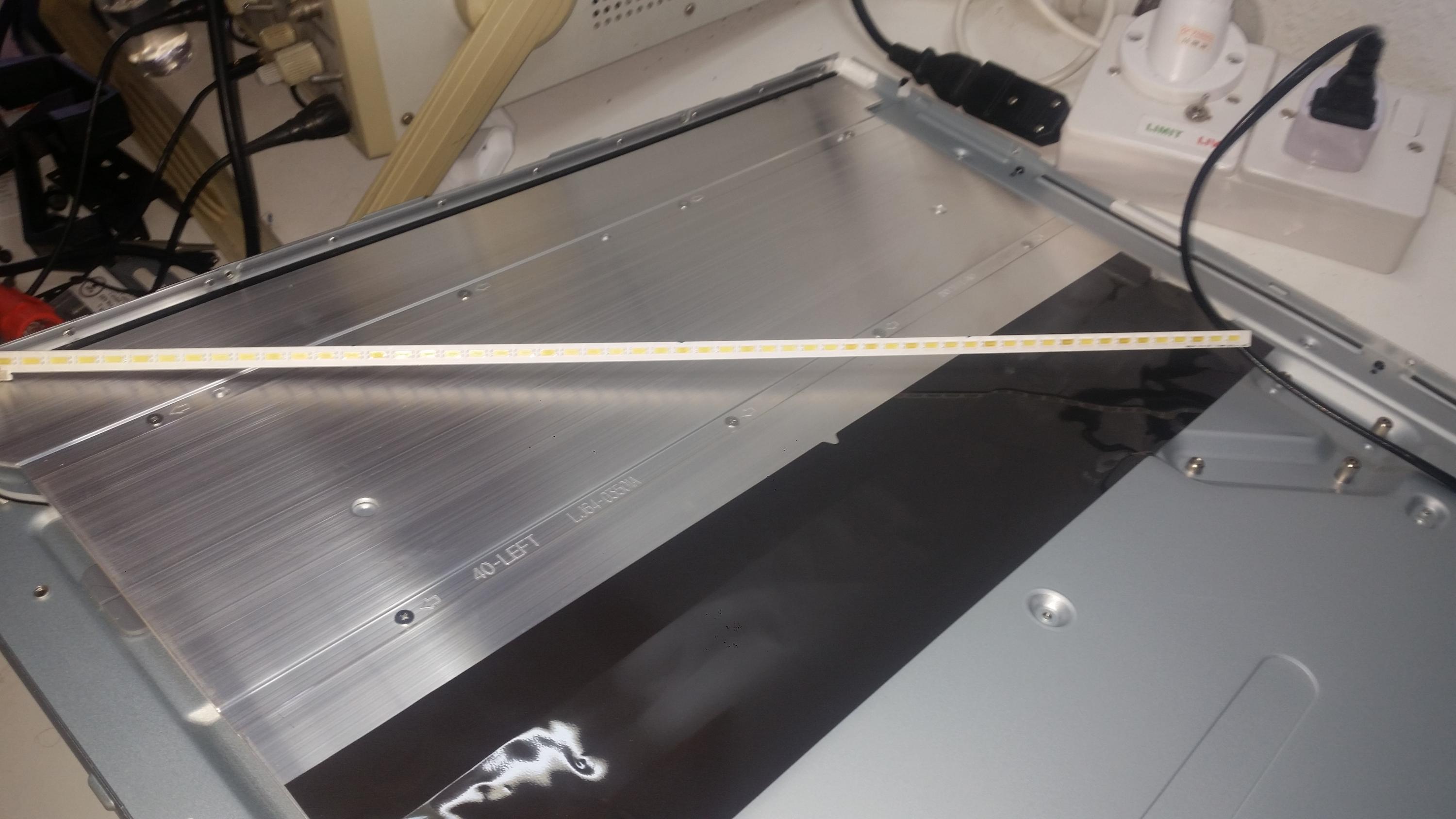

                  OK I got it apart without breaking anything
                  The LEDs are on a single strip down one side, there are 14 LEDs per segment
                  Alol segments light up and interestingly they all read the same voltage on the backlight tester 78.5V for a short while but then the top segment went back to approx 85V
                  I also don't like the look how some LEDs look a bit 'burnt' and they don't all come on at the same brightness until the current ramps up.
                  As there are the same number of LEDs in each segment it would seem I do have a problem with the LED strip. Can anyone tell me the part number, there is no writing on the strip just a funny little square symbol

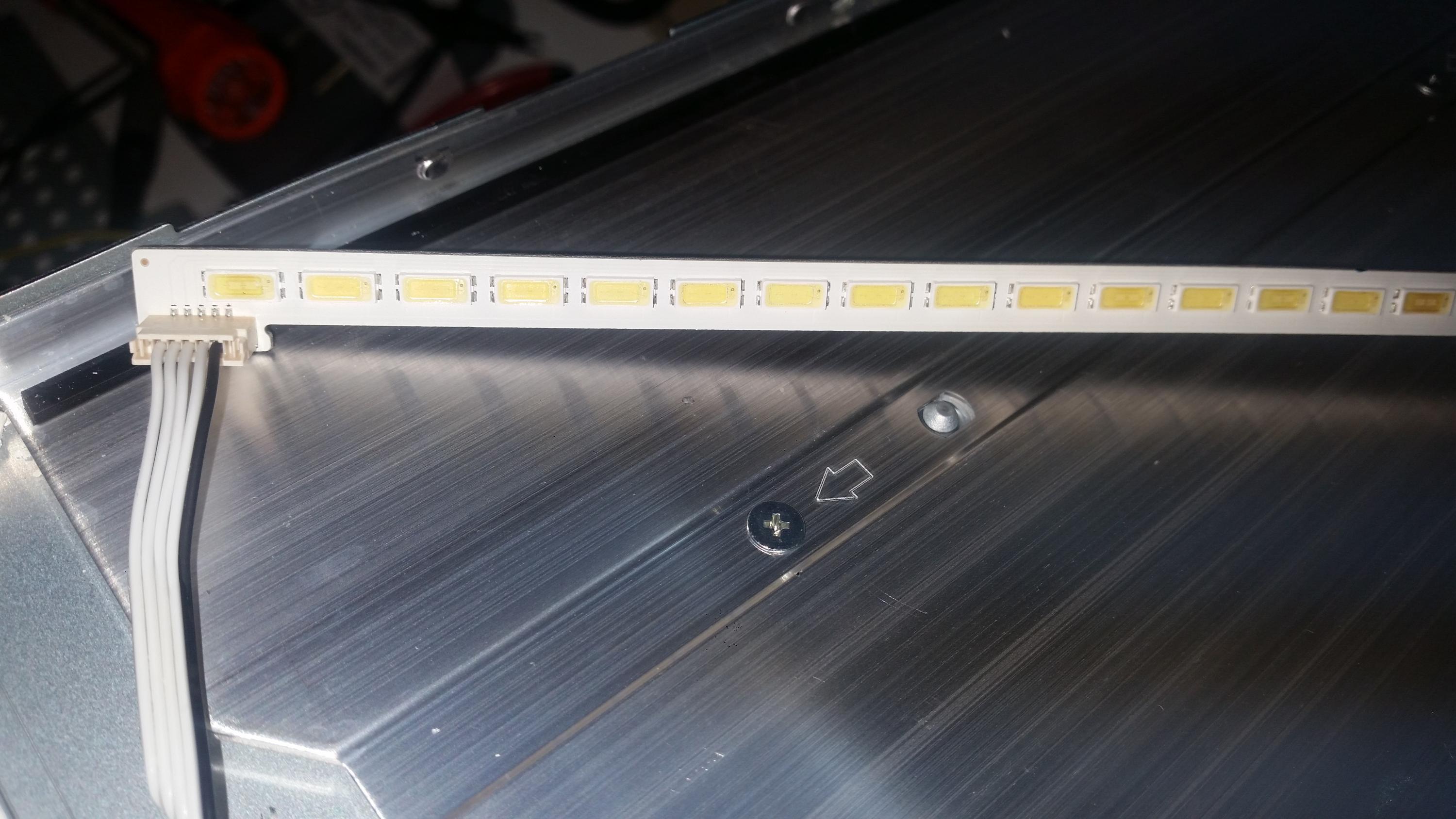

                    The part number is on the aluminium in photo 2.
                    https://www.aliexpress.com/item/orig...728500735.html
