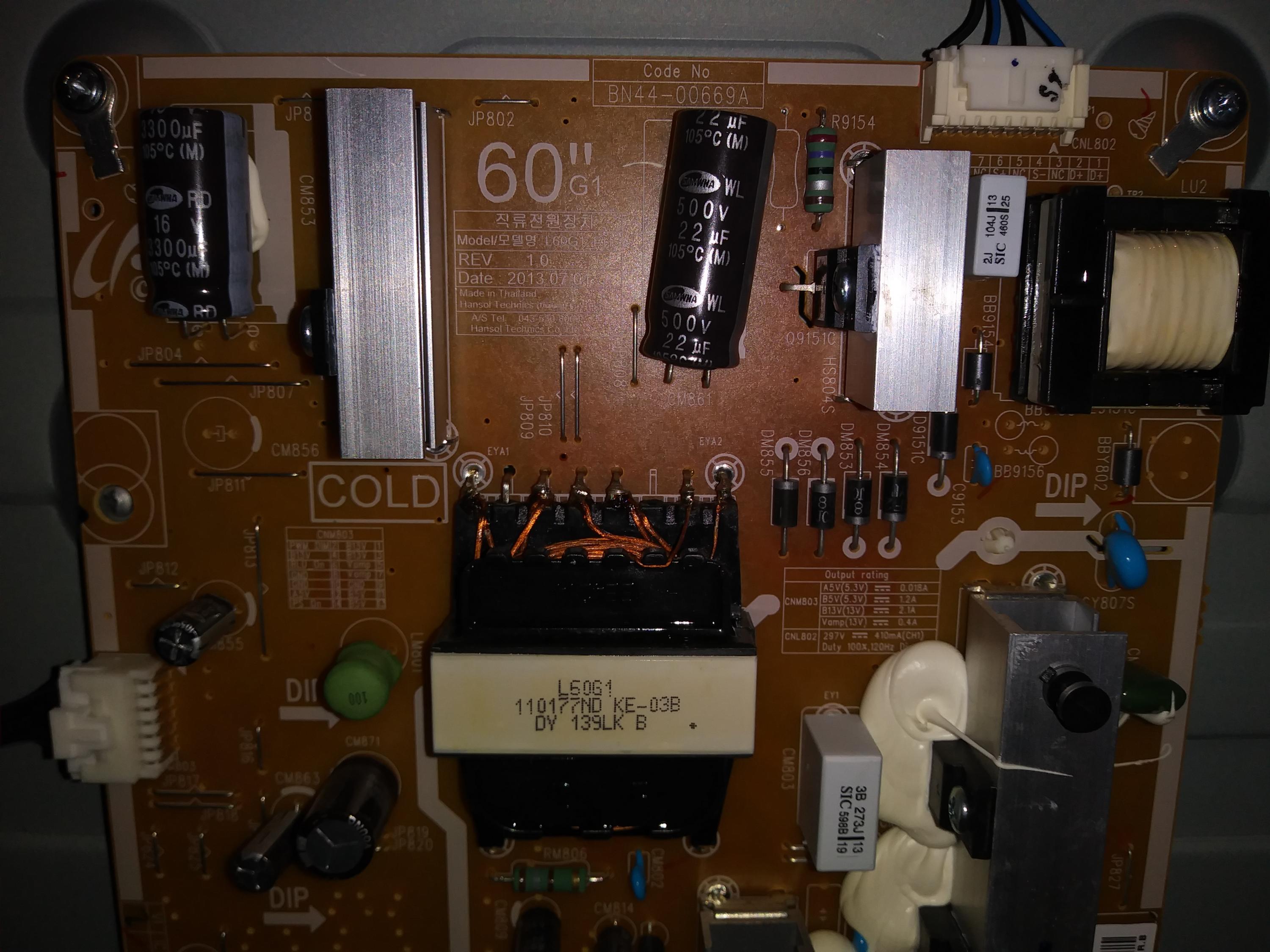

    Samsung UN60FH6003 black screen, has image
    I have a Samsung UN60FH6003 that the backlights are not functioning. When I turn it on there is no attempt at the lights coming on, just a black screen. I can see the image with a flashlight. Also, when I turn it on the Standby light blinks 6 times.
    I haven't been able to inspect or take voltages yet, but by reading a few threads on here about other Samsung LEDs, I gather that it's quite possibly a bad electrolytic or film capacitor, and not necessarily a burned out LED.
    It has the BN44-00669A power supply board in it. Attached is a picture of this model. By looking at this picture, what things would I need to check first? I will upload pictures of my actual board as soon as I open the tv up.
    Thanks.

    Re: Samsung UN60FH6003 black screen, has image
    Disconnect the power supply connector to the main board and see if the back lights come up. This model should have pull up resistors in the power supply to allow the backlights to function without the main board Connected

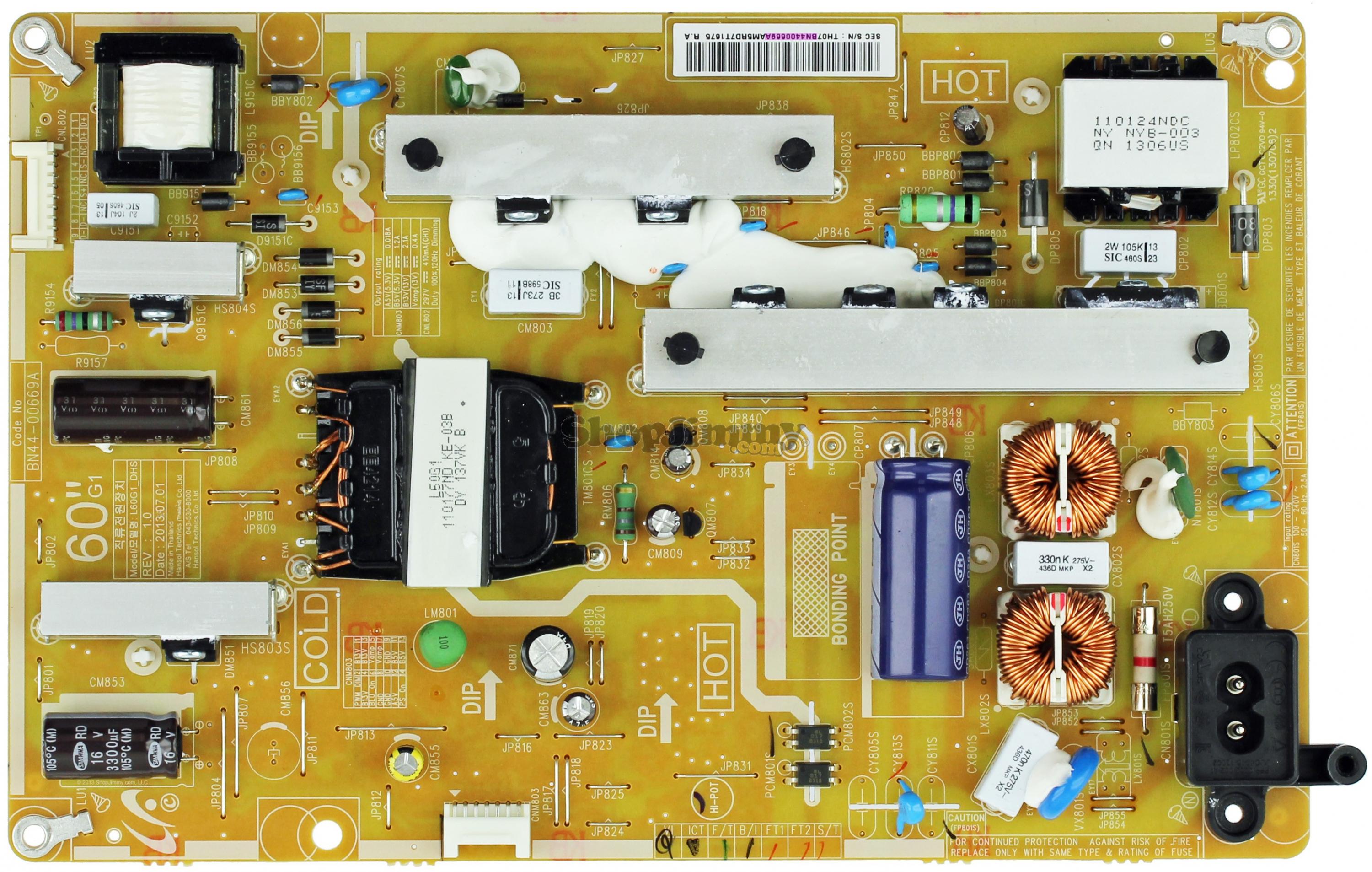

                          http://assets.shopjimmy.com/media/ca...69a-bottom.jpg
                          Look at the bottom side of the board yourself and see how the pins are tied together.
                          But what is your point? I also ready told you that you have OVER 400v FEEDING the Anode of the first LED string and you are not getting Voltages on the Cathode return of the LED string. I am not going to waste my time on this thread any more. You have open circuit so find out where that is.
