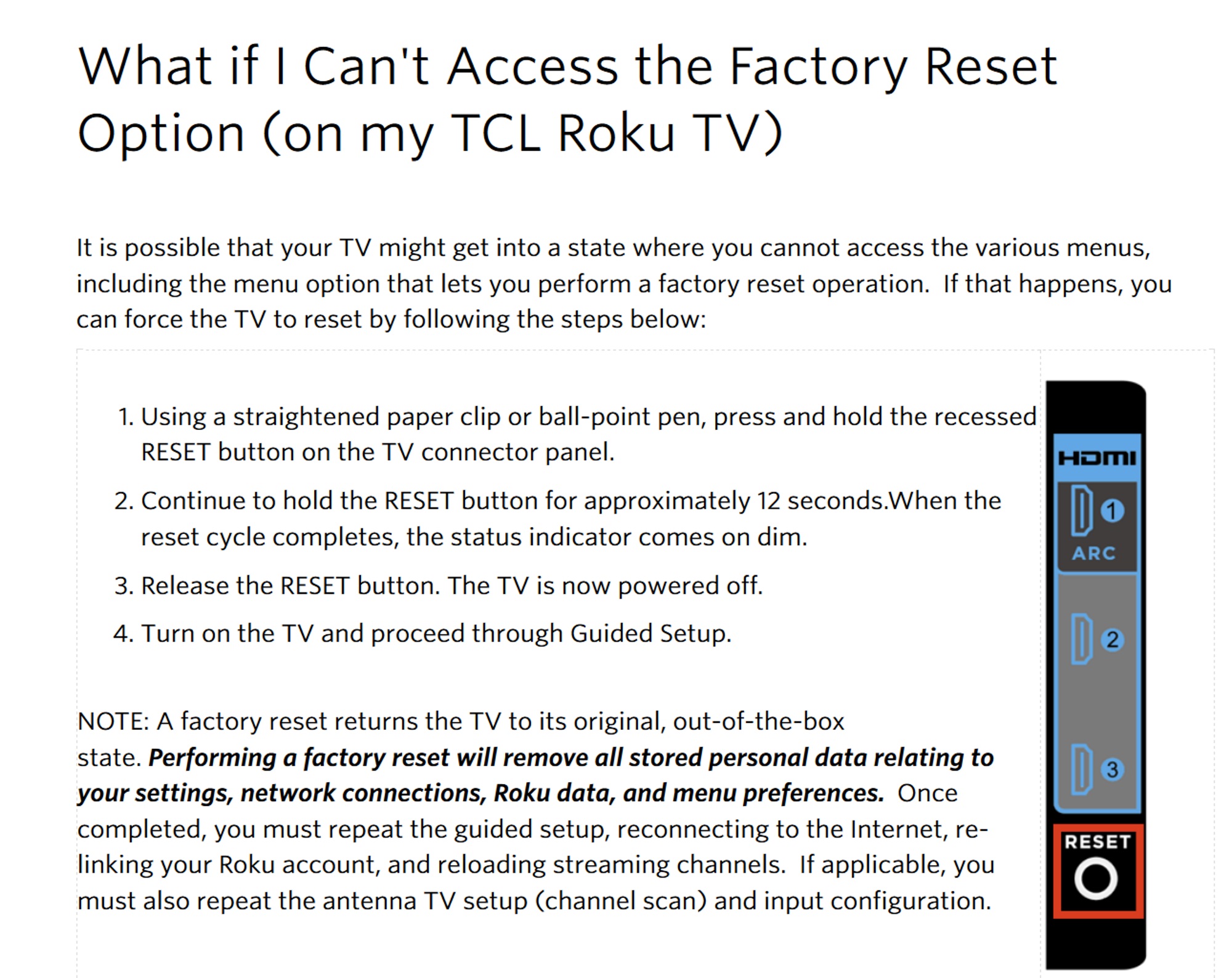

          Re: TCL LCD TV Orange Haze
          Possibly problems with a recent firmware update. You can try a factory reset.
