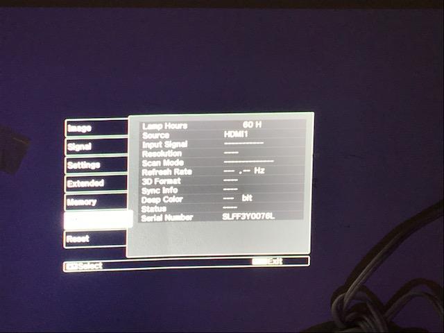

    I have just picked this projector up, for $20.
    It starts up, shows no error lights. Menu shows on screen, blue screen is on.

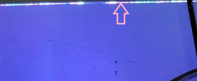

    When I play a movie, the sound is on and a small line at the top is the video signal.
    I can see a double image, like in a 3D, side by side view only.
    Anybody has any experience with projectors?
    I did not open it up yet. I don't have the remote for it.
    I believe that this is a 3LCD type projector.
    Any help, would be appreciated.

    I have tested, the HDMI, Component, composite and VGA inputs and none of them show any image. It will show the same line on top.
    When I placed a picture on a USB stick, it showed a beautiful image.
    I'm guessing, that maybe there is some vertical, or horizontal sync issue.
    I will have to open it up, and see what is inside.

            In that tiny horizontal line, the video plays OK.
            It must be something, that is common to all video sources.

                    This projector, is an LCD based projector. It has three tiny LCDs, for the three colors, red blue and green.
                    My issue is, that on all the signals, I have the same issue, 99% of the image is gone. Only that tiny top line is a good image.
                    Another weird thing is, that in that tiny band the image is doubled, side by side.
                    It is very clear and sharp, and shows the right image that should be there.

                          It seems like, the USB ports and the Menu system, bypasses the video section.
                          Something that is common to all the inputs may be causing the problem, but without a SM and proprietary parts, will be almost impossible.
                          It could be the ST FLi32626H?

                                  Re: Epson Powerlite 3020e video issue
                                  There is a factory reset, and I have reset it a couple of times already. No change though.
                                  Last night, I have programmed my Logitech Harmony Touch and I have tried it, but did not react to any of the commands.

                                    It is fixed.
                                    I have programmed my Logitech Harmony Touch remote, reassigned the signal from the hub(RF) to the remote(IR) and the remote worked right away, with the projector.
                                    I have hit 3D Format on the remote, went two steps down with the remote(blindly, no image) and hit OK. I had an image!!
                                    It was 3D top and bottom, but at least it was an image. Side by side worked as well, but Auto and 2D went back to the thin top bar.
                                    I still have a hard time, getting white instead of yellow, that I'm getting now.
