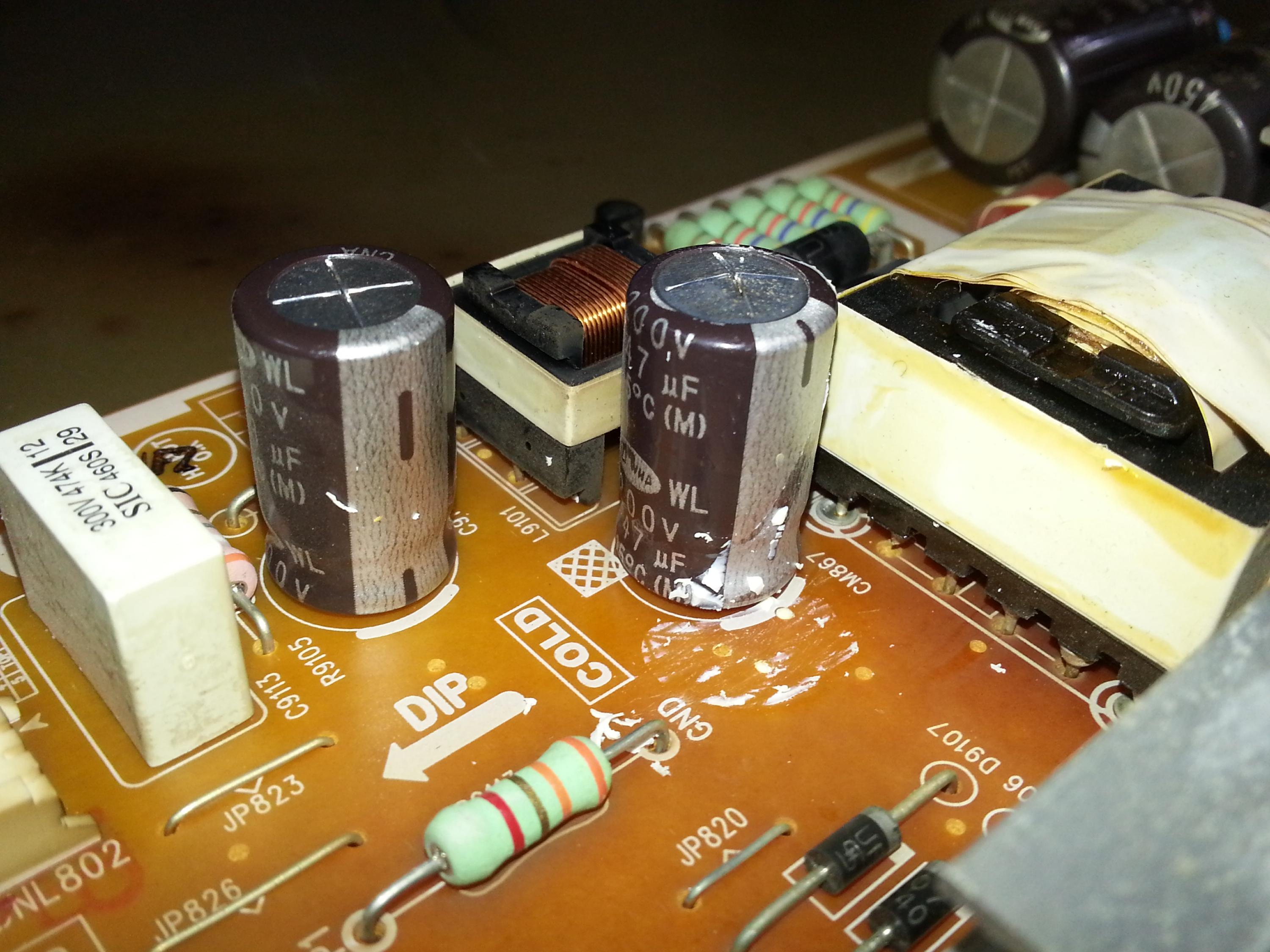

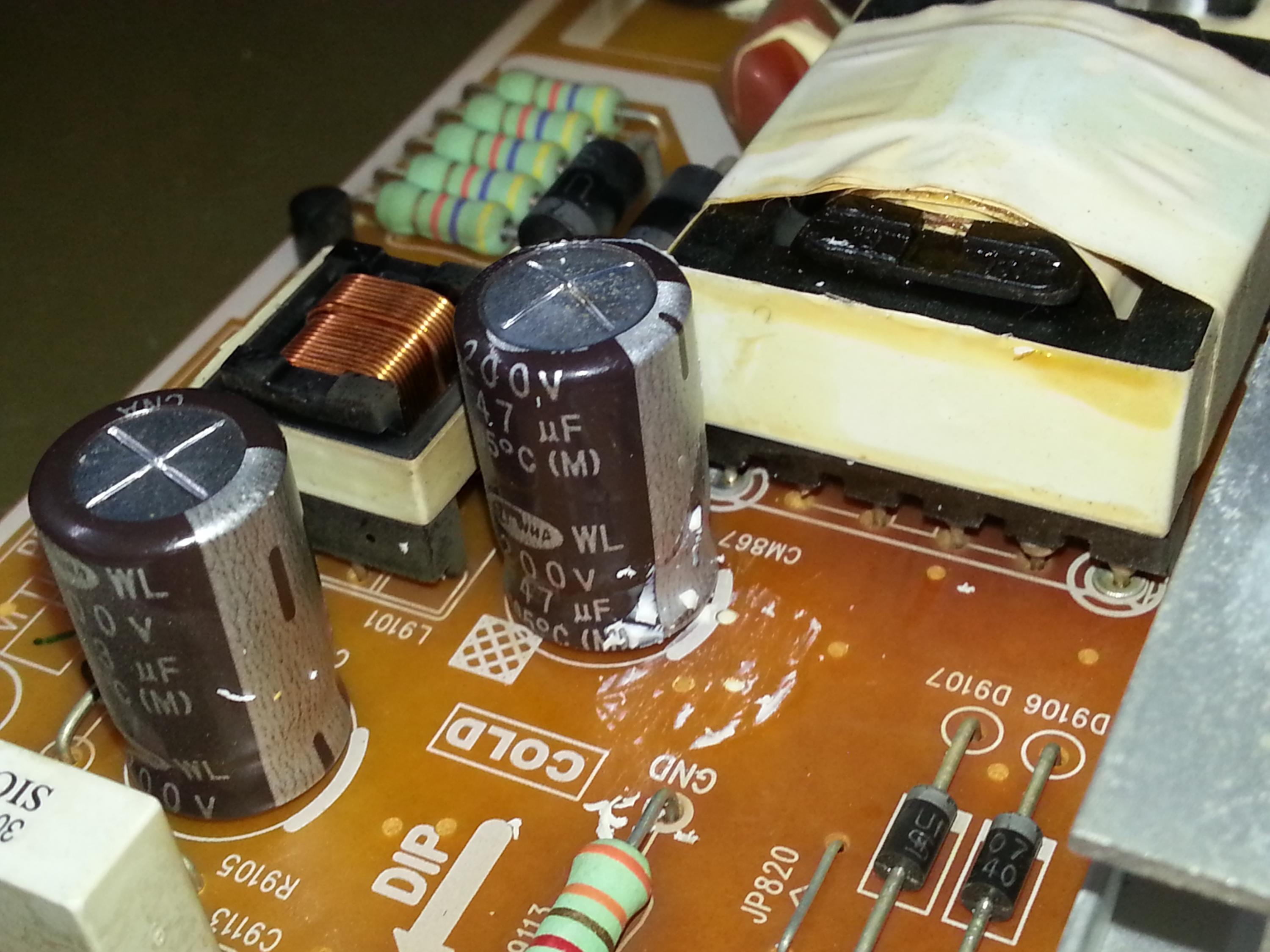

      Barely a week after I fixed the last one, another one came in with the same exact issue, though this one broke the rule of not showing visible signs, since the cap WAS bulging, making the task much easier.
      I can imagine all of these tellies came from the same generation and have approximately the same number of on hours, which might explain why everybody who bought them experienced failures at roughly the same time.....just a hunch.

        I have the same problem in my BN44-00493B, capacitor defect

          The 40" EH series have the same issue as well. Different power supply but exactly the same failure. I've fixed several. Some with bulged capacitors and others that weren't so obvious. I don't have the numbers handy but just a heads up to everyone.
            Re: Samsung UE32EH5000 backlight issue fix
            I would go higher in voltage like 200 to 250 or so, same uf as previous cap just higher voltage.

                    It should be possible to check caps with a scope without removing them. You should see large spikes instead of relatively flat DC.

                      Iam glad Ive found this post, because it seems like this is my issue too. My capacitor is just slightly bulged, and I can measure 235-255V on backlight connector (160V when I disconenct the main board). The backlight in my case always blink on power up, and even tho I havent tested the LEDs, I can see that all of them blink. I really hope that the only problem is just this cap.

                        +1 you guys are time and effort savers! Replaced cm867 with a 120μF/200V which was available and works fine. No external leak or bulge and positive leg cut as in the first pictures.
