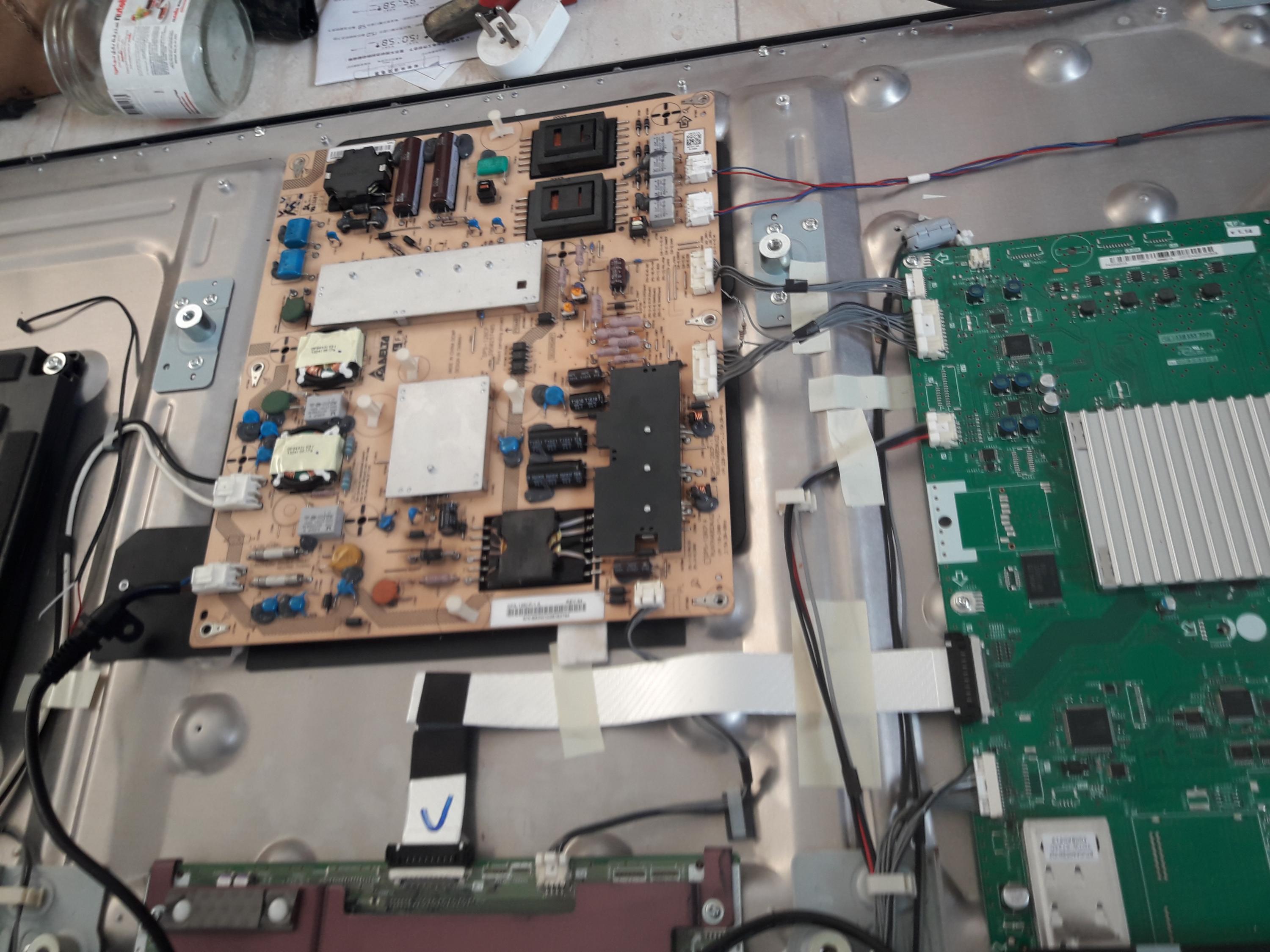

      • Ihandyrepair
        4 red flash led 65X950G boot Sony and android logo but then black
        by Ihandyrepair
        HI guys
        I got here a Sony 65X950G - I tried to find any repairs guides for this model but not many online
        here is the issue
        I have Sony and android logo. but then 4 led red flash lights front of the tv
        I have 3.3v ref. 12v reg then T con 12v when I press the power on button
        but then I get black screen and 4 red flash light at the front LED
        but I get 3 led flash on the LED driver board.
        I check that few X900F or C YouTube repairs, seems that if you have 4 led red flash it could be due of LED black light error
        so I tried...
