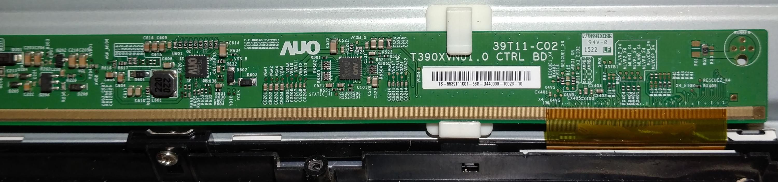

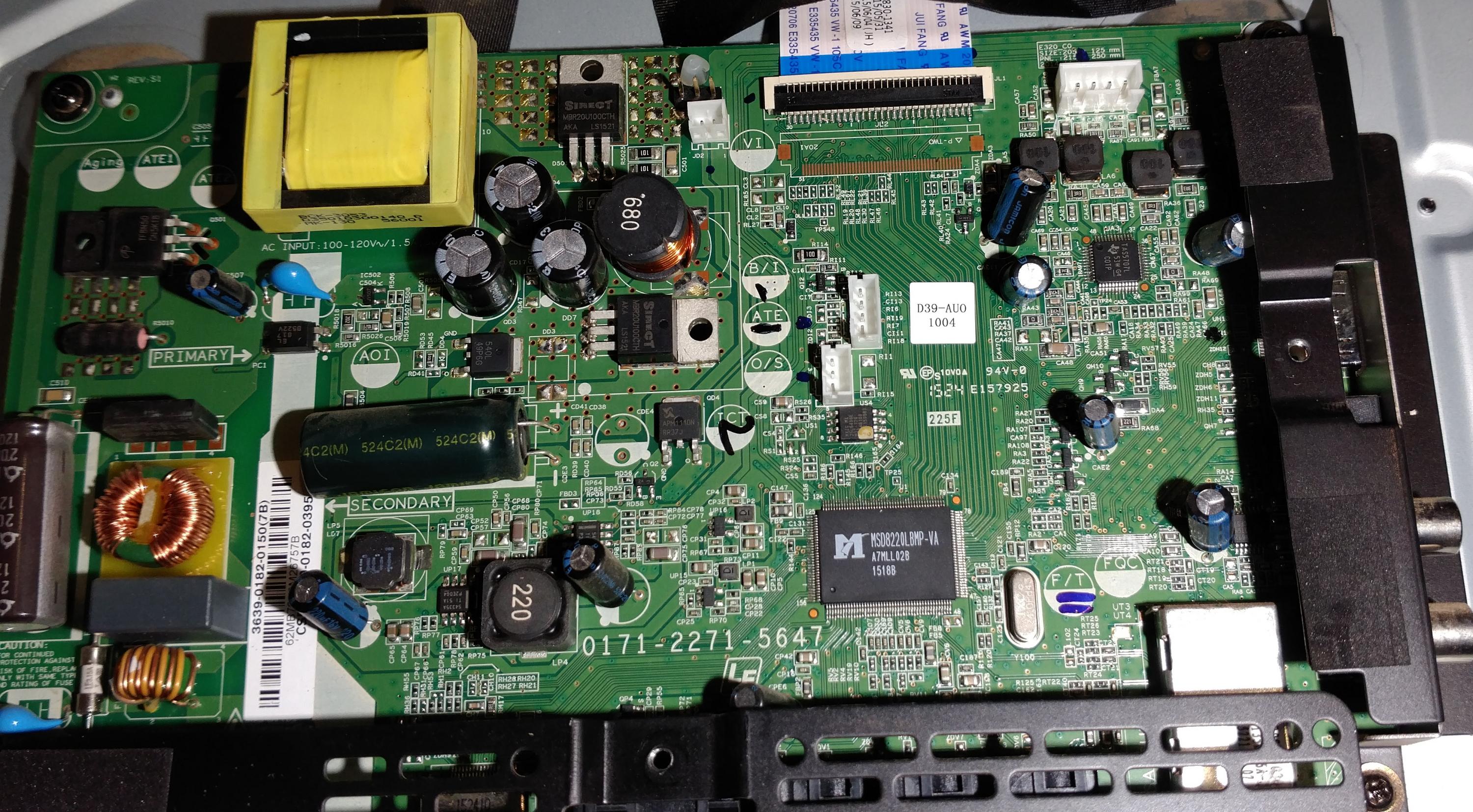

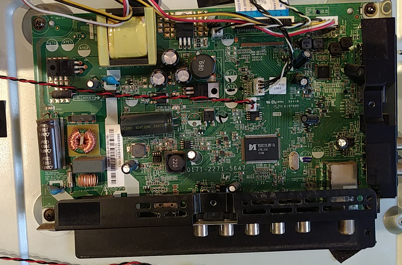

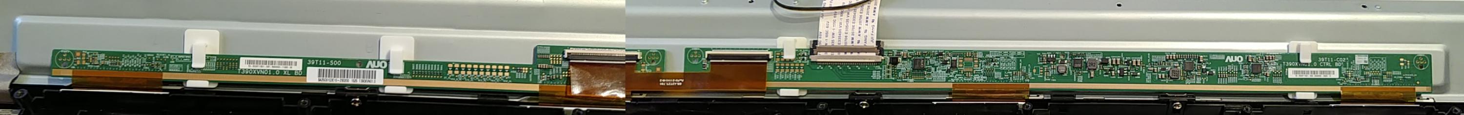

    The photos I've attached are of the single main board, and I stitched together photos of the electronics on the panel.

    You need to move those wires out off the way so we can clearly see the LVDS cable and the connector pins, there should be switched 12VDC feeding some of power line pins of that LVDS cable.

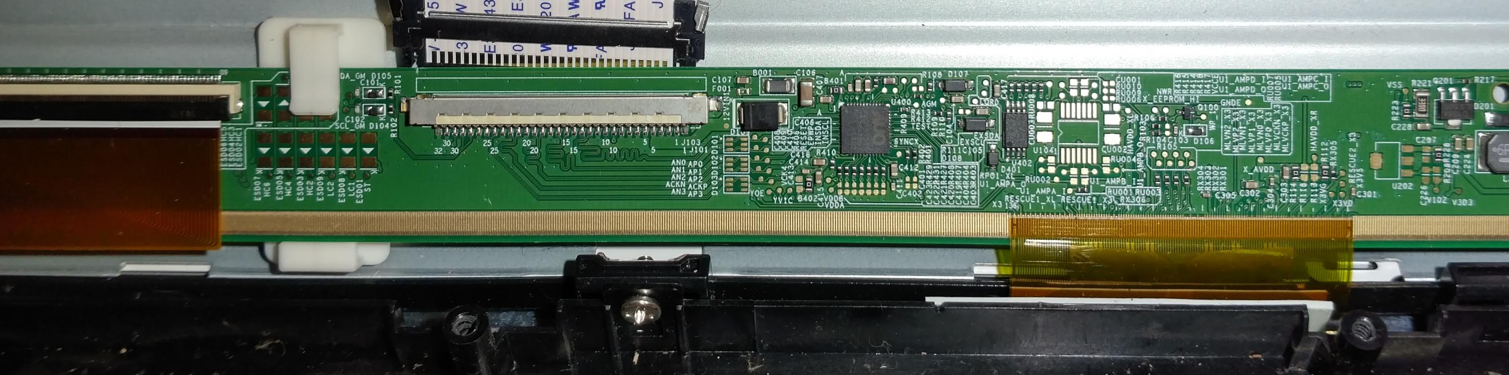

    You need to zoom in where the LVDS connector is, the picture is not clear enough to see the fuse.

      Sorry about that. I had the camera resolution at 2 mp.
      Brain wasn't working too well leaving the wires in the way.
      Hope these have a good balance of shadows and glare
