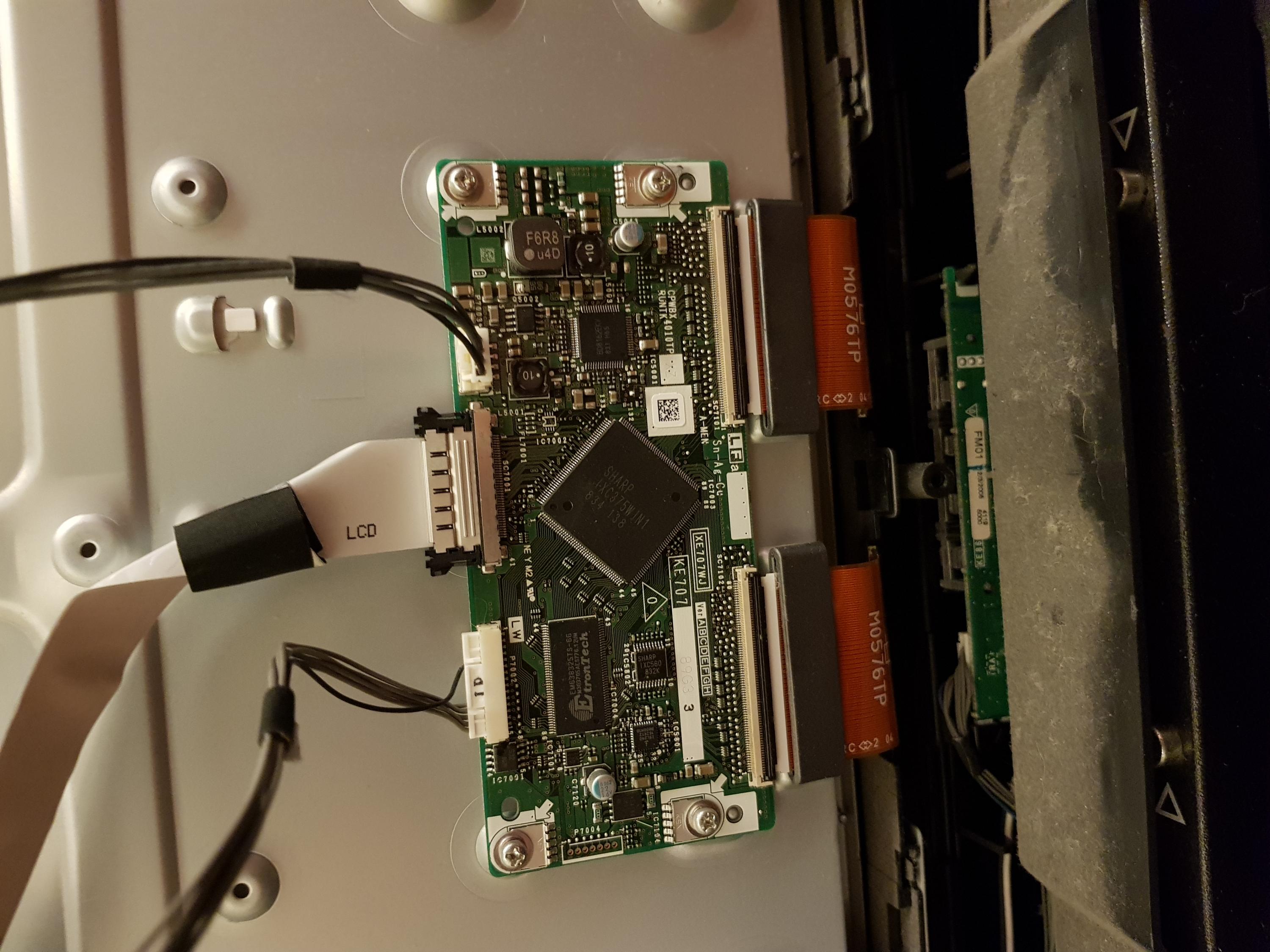

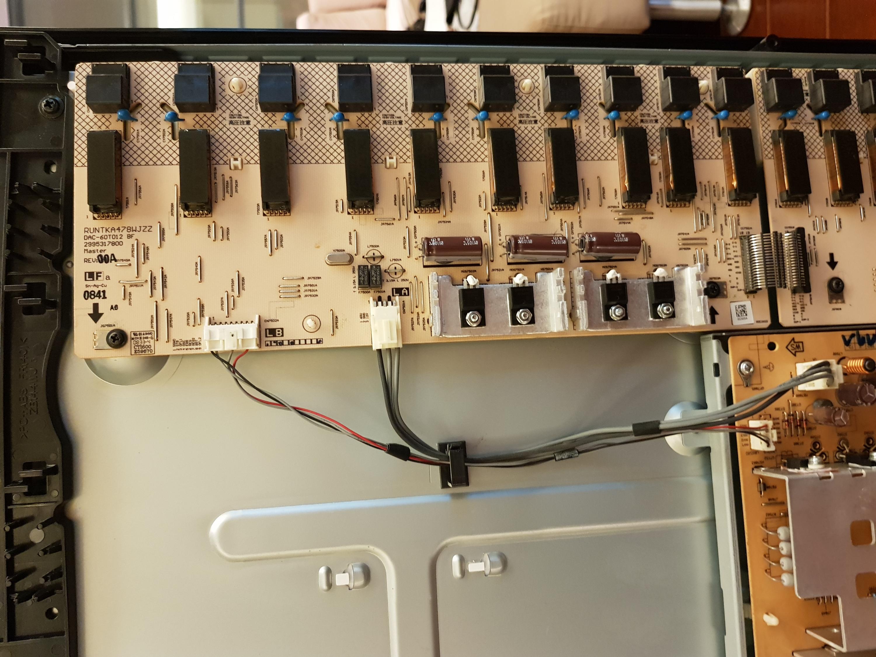

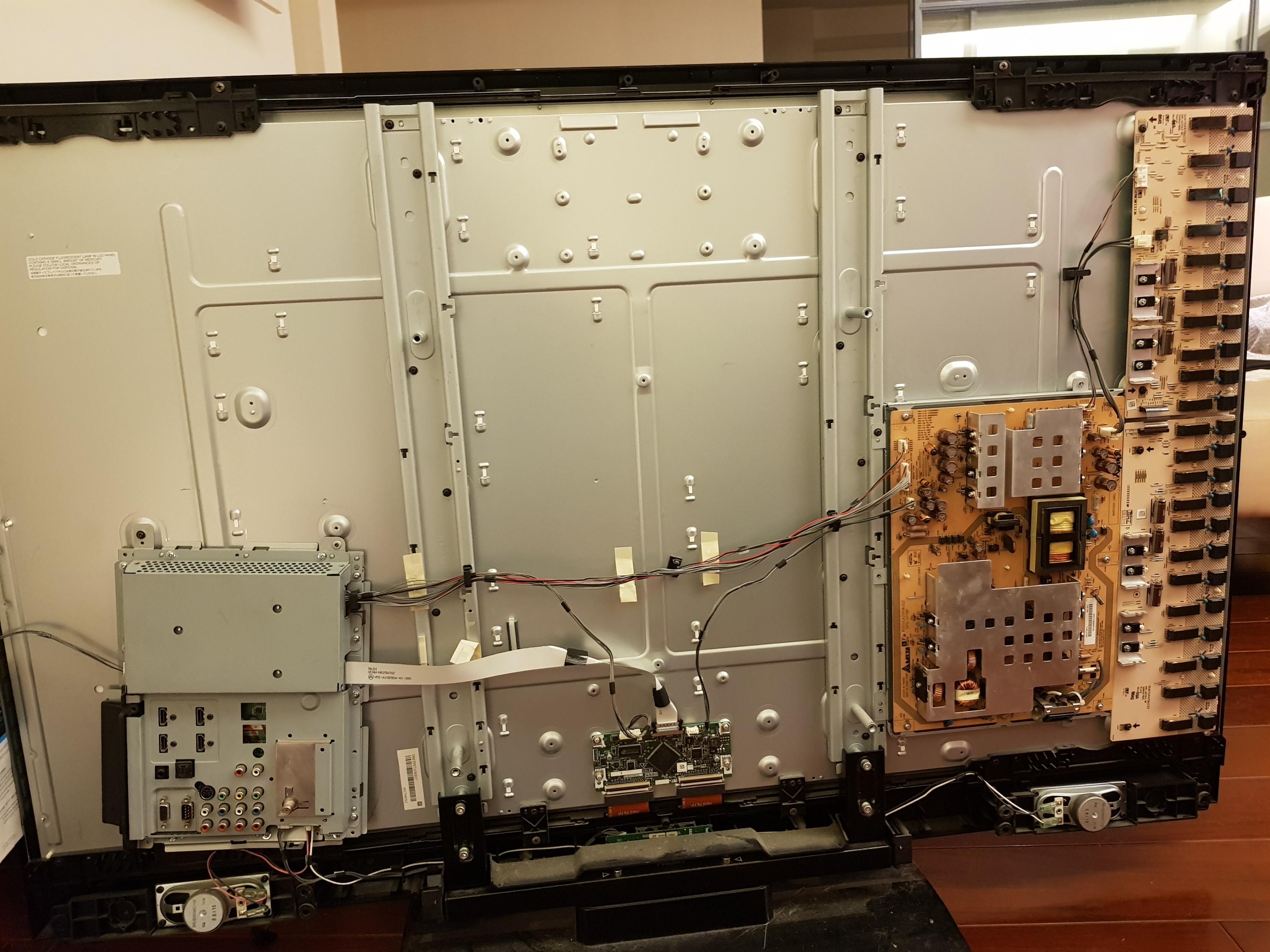

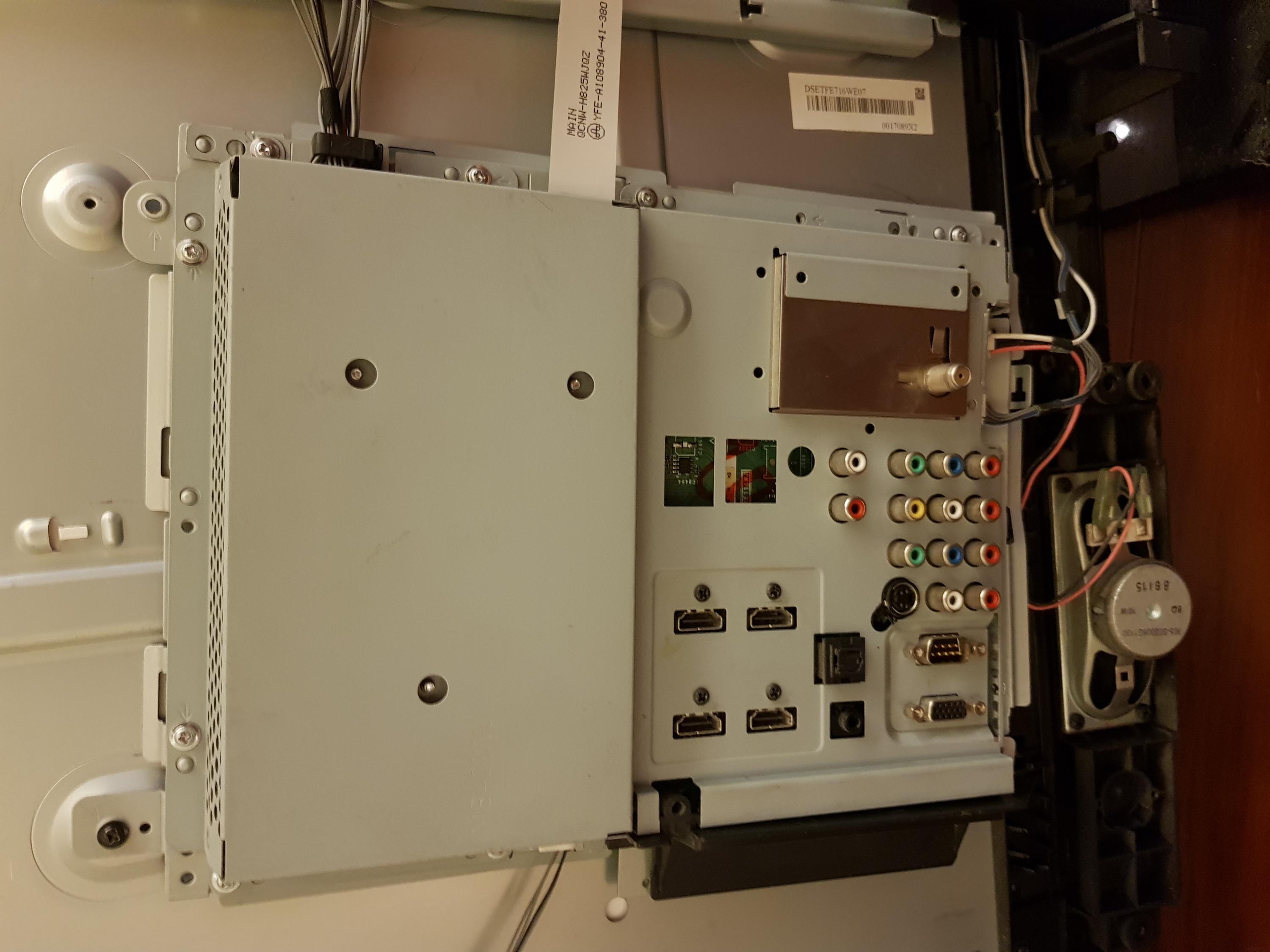

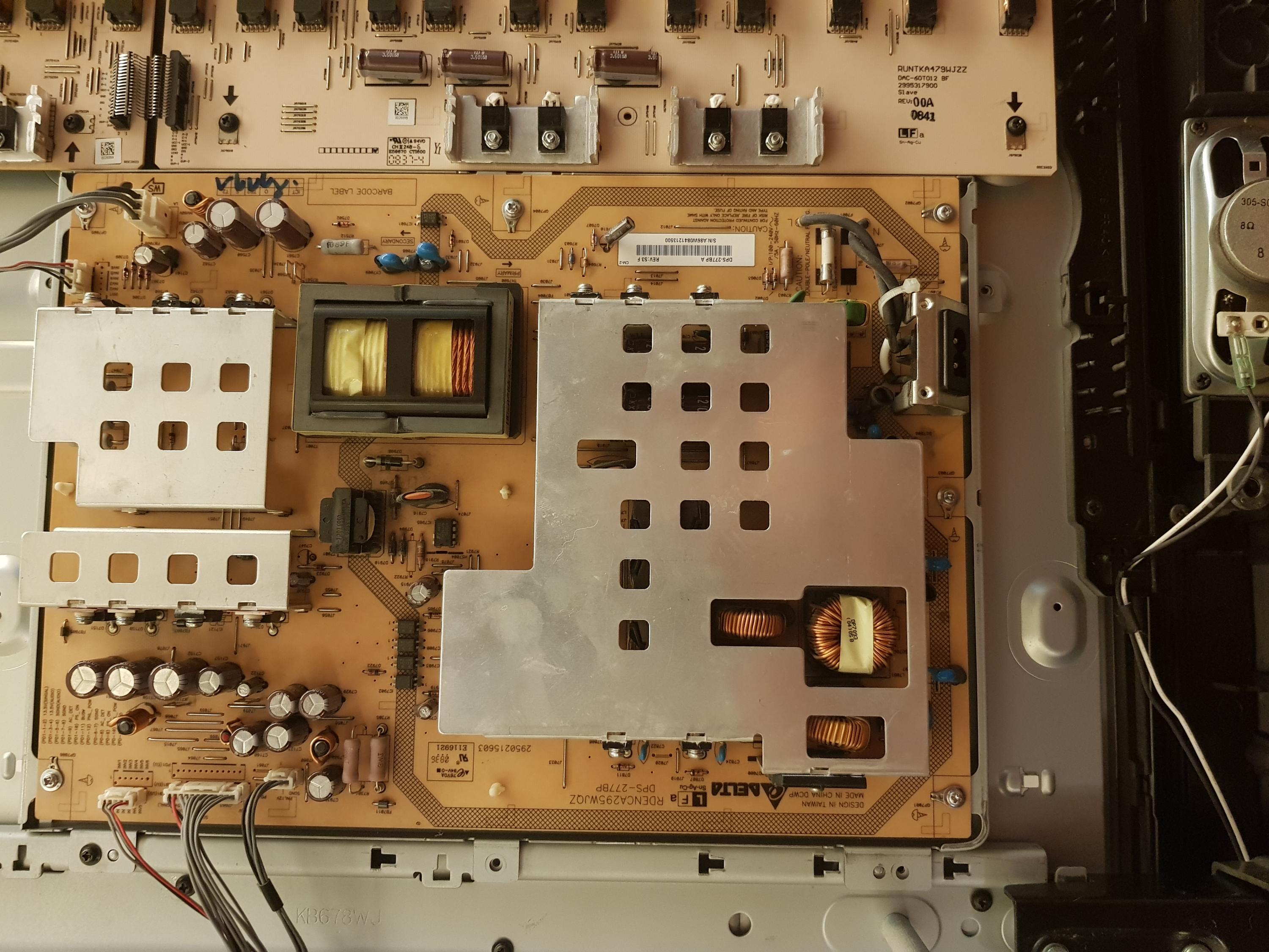

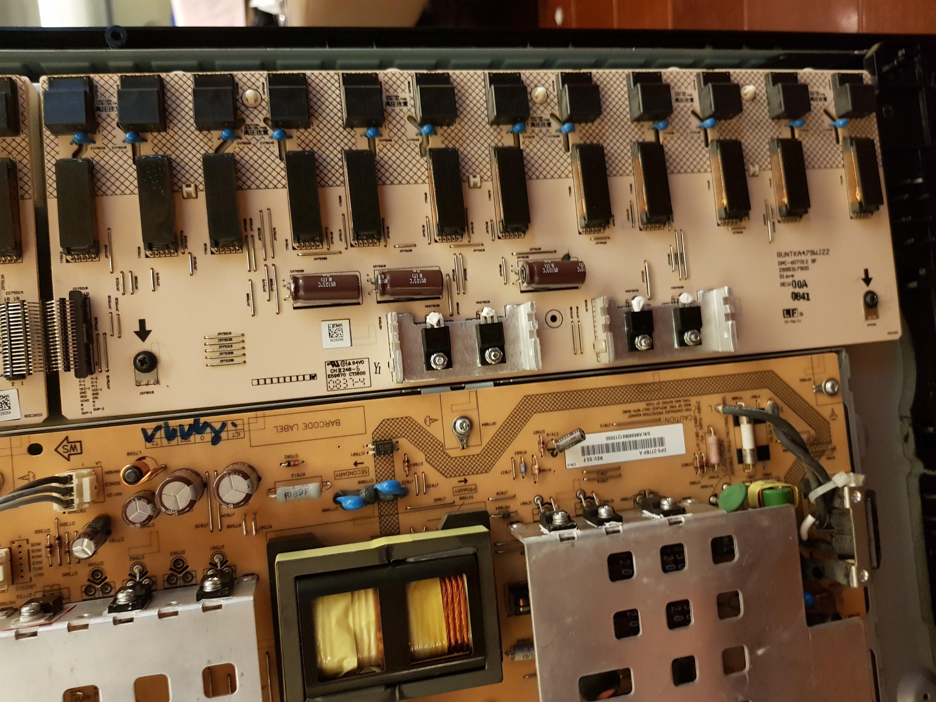

    I'm attaching pictures of the set with the back cover removed.

    There are pin names for each one of those white connectors on the power supply board, you need to report the DC Voltage readings of the pins of those connectors, you MUST put down the pin names and follow by the Voltage reading so we easily see what they are.

      Looks like it's CCFL-based...
      That means a bad CCFL bulb, bad inverter transformer, bad CCFL connection or bad caps (doesn't look likely, in comparison to the preceding-3)

          budm - Please see voltages with unit plugged in and power light flashing (after screen goes dark)
          LB1(US)
          Pin 1: INV1 = 0V
          Pin 2: INV2 = 0V
          Pin 3: INV3 = 0V
          Pin 4: INV4 = 0V
          Pin 5: INV5 = 0V
          PD(US)
          Pin 1: 13.5V (SIGNAL) = 0V
          Pin 2, 3: 13.5V (AUDIO) = 0V
          Pin 4, 5: SGND (AUDIO) = 0V
          Pin 6, 7: SGND = 0V
          PIN 8: AC_DET = 3V
          Pin 9: PS_ON = 0V
          Pin 10: PNL_POW = 0V
          Pin 11: SGND = 0V
          Pin 12: BU5V = 5V
          PL
          Pin 1: PNL12V = 0V
          Pin 2: PNL12V = 0V
          Pin 3: SNGD = 0V
          Pin 4: SNGD = 0V
          LR1
          Pin 1: INV60V = 0v
          Pin 2: SGND = 0v
          Pin 3: INV12V = .144v
          LB2(US)
          Pin 1: INV1 = 0V
          Pin 2: INV2 = 0V
          Pin 3: INV3 = 0V
          Pin 4: INV4 = 0V
          Pin 5: INV5 = 0V
          Voltages with Volume down and Input buttons pressed (force on) and screen lit
          LB1(US)
          Pin 1: INV1 = 0V
          Pin 2: INV2 = 3.2V
          Pin 3: INV3 = 0V
          Pin 4: INV4 = 3V
          Pin 5: INV5 = 3.4V
          PD(US)
          Pin 1: 13.5V (SIGNAL) = 13V
          Pin 2, 3: 13.5V (AUDIO) = 13V
          Pin 6, 7: SGND = 0V
          PIN 8: AC_DET = 3V
          Pin 9: PS_ON = 3V
          Pin 10: PNL_POW = 3.3V
          Pin 11: SGND = 0V
          Pin 12: BU5V = 5V
          PL
          Pin 1: PNL12V = 12V
          Pin 2: PNL12V = 12V
          Pin 3: SNGD = 0V
          Pin 4: SNGD = 0V
          LR1
          Pin 1: INV60V = 61v
          Pin 2: SGND = 0v
          Pin 1: INV12V = 11.86v

          RJARRRPCGP - Please see voltages above on INV 1 and INV 3.
          I agree as all the caps physical condition looks OK.

            Found LB1 and LB2 (US) Pin1 short to ground even with all connectors unplugged.
            Does anyone have a schematic for RDENCA295WJQZ DPS-277BPA? This is the power board on my set.

                  service manual for the set is available as I worked on a 42 in unit before xmas... I am not at my internet so I don't know where I found it but its around in the usual places.
                  as far as the power board, most are not available anywhere as the manufacturer doesn't include them in their service manual.

                    budwich - I found a copy of the service manual online. I've sent an email to Delta customer service to see if they will provide a schematic.
