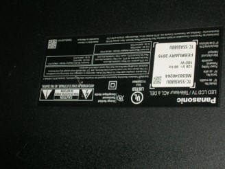

    Hi Guys,
    I have the same model build date is Feb 2015. My symptoms are a steady blink from the power light and nothing else. One blink 3 seconds one blink. I have the back off and it has 5V standby power but not the 16V to the main board. When I plug it in here is a black relay that clicks the backlight LEDs flash a couple of times and then clicks again which is when the power light starts flashing again. I am assuming this is a protection relay. When it clicks the first time (I assume on) I get the 16V at the jumper that says SRV 16V. I did disconnect the T-con board and the protection relay still clicked on and off. I am not sure if disconnecting the T-con board isolates the LEDs as the original poster had LED issues causing a similar problem. I hope this is enough to get started and someone is willing to help. Can someone help me isolate this problem?
    My skills are mostly self taught and I have been repairing old audio amplifiers and receivers stuff like Marantz Sansui etc so this is all solid state stuff. I have little or no experience with LCD TVs. I certainly do have a multimeter, solder station, Chinese component tester etc.

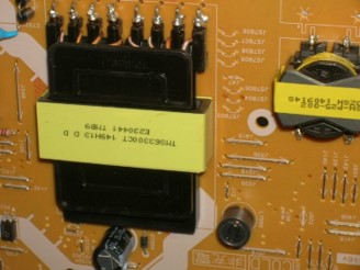

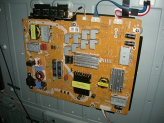

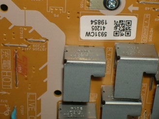

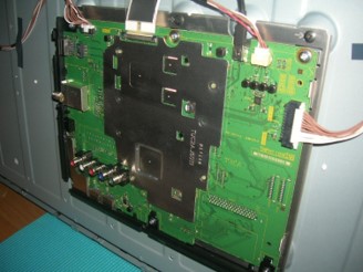

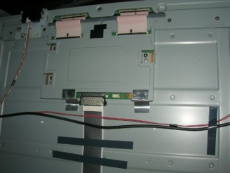

    It would appear to me that the symptoms you describe would be a Failed or failing backlights issue. You need to post pictures of the backside of your TV with the cover removed so we could see how the boards are connected to each other. Without them you would not get much response as we would be guessing as we do not have the TV in front of us. The pictures MUST be clear focused pictures and also close up shots of the connectors and labels of the PSU and main Bds.
      Re: Panasonic tc-55as680u in Protection?

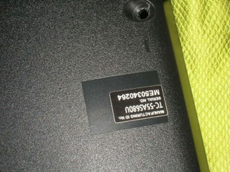

      Here are some pictures....
