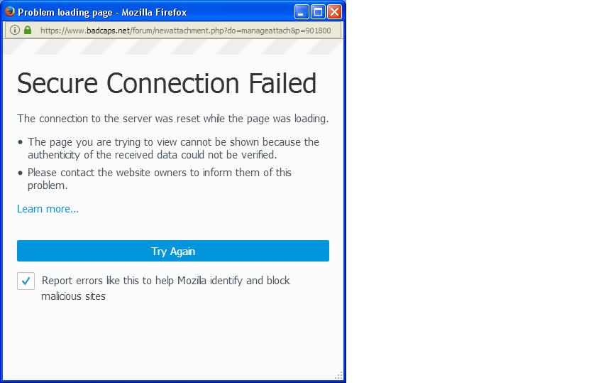

          Whenever I try and upload a file larger than a couple megs I get this error
          Sorry I can't upload the file.
          A while back some people asked them to change something with the security on the site, ever since then I can't upload anythng larger than a couple meg file or picture
          Also my isp "upgraded" my service a while ago. That could also be the problem, faster speed but it don't fucking work any better!
