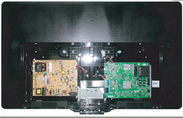

    Dear, i have philips Philips 42pfl3606h/58 and motherboard is dead,
    i buy from ebay motherboard 715G4609-M3A-000-005X (42pfl3606h/12)
    motherboard from my lcd tv is 715G4609-M3A-000-005b (42pfl3606h/12)
    tv turn on , there is backlight and sound, but no picture, when i plug off two ribbon cables there is no any changes , i think on this lcd that tcon is on motherboard,
    please can you give me some advices for next steps. is possible that is mainboard from ebay not ok, or maybe something else.
    Thanks!
    Re: Philips 42pfl3606h/58
    "i think on this lcd that tcon is on motherboard" You think? We need pictures of the whole back side of the TV showing all the boards so we can see what we are dealing with.
    • hepeek
      • 3
      • bosnia
      There is photo from backside ?
