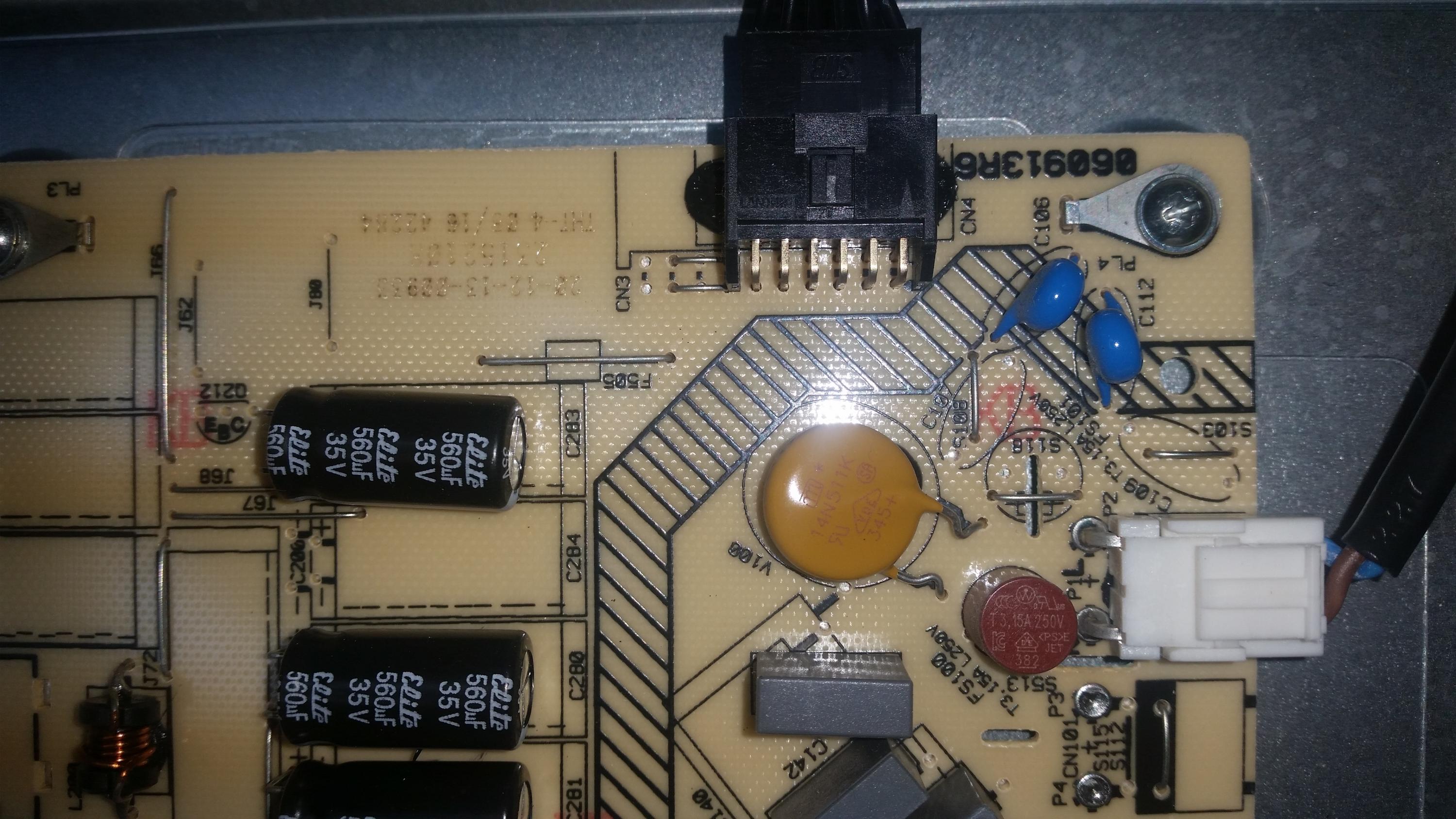

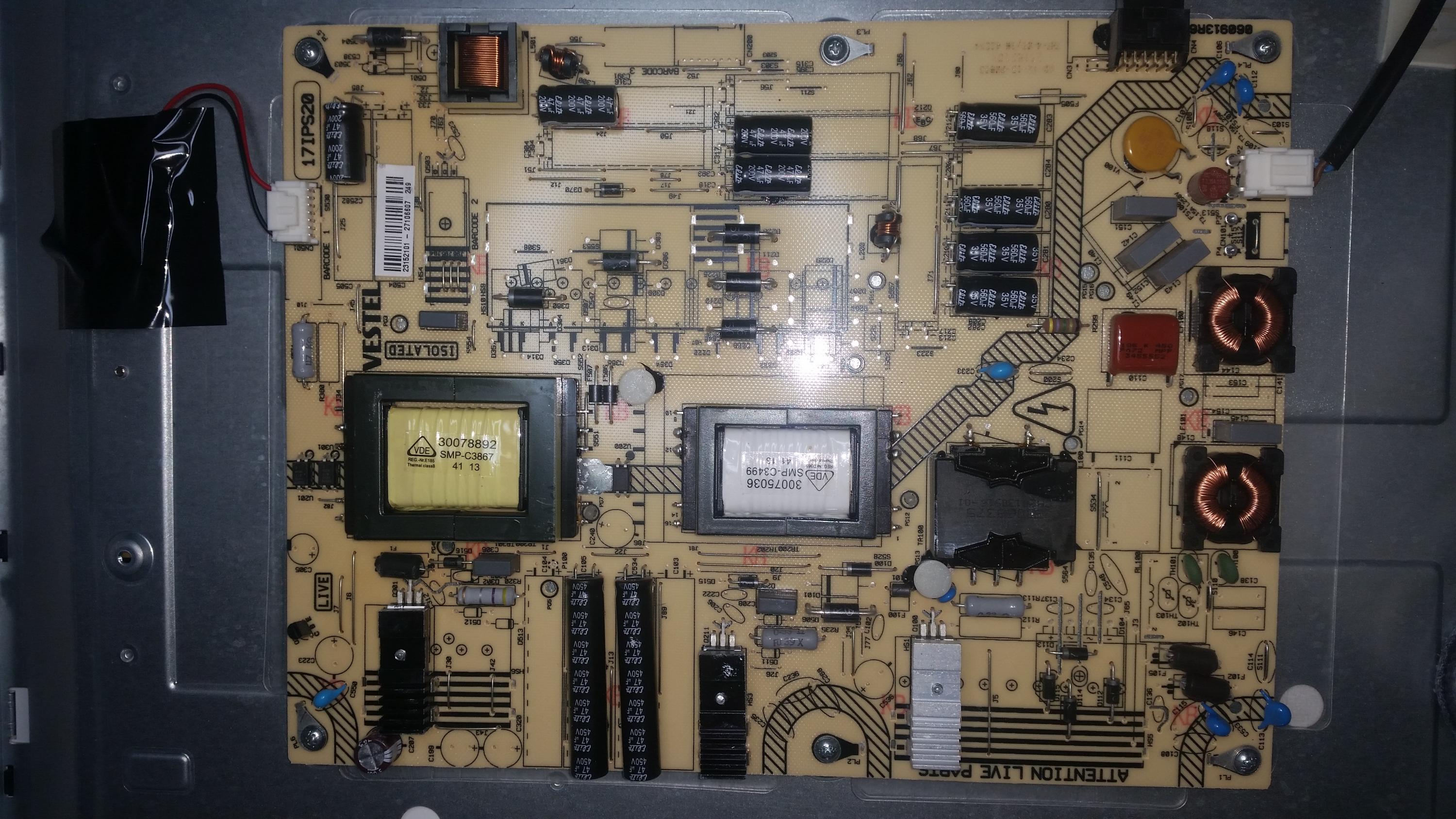

    The PSU is Vestel. The pins on the output connector are unmarked (checked both sides of the PCB) but checking the voltage on the various banks of Electrolytics on the secondary I can see I have stable +12V and +116V supplies. There is just about zero volts on the connector the the LED back lights
    Anyone got a schematic of the PSU or at least a pin out for the output connector so I know what voltages and signals I should have, STBY, BL_ON etc

    Oh after posting I googled the model of the Vestel PSU 17IPS20 and just found a video on you tube regards no back lights. https://www.youtube.com/watch?v=uPI1QBE0CxI

      Schematics. Check that they match your power supply.
        Re: Selecline 39182 Sound but no Picture
        Thanks for the schematics, it looks like I have an OC LED. Maybe I've just been lucky I've not had a bad LED before

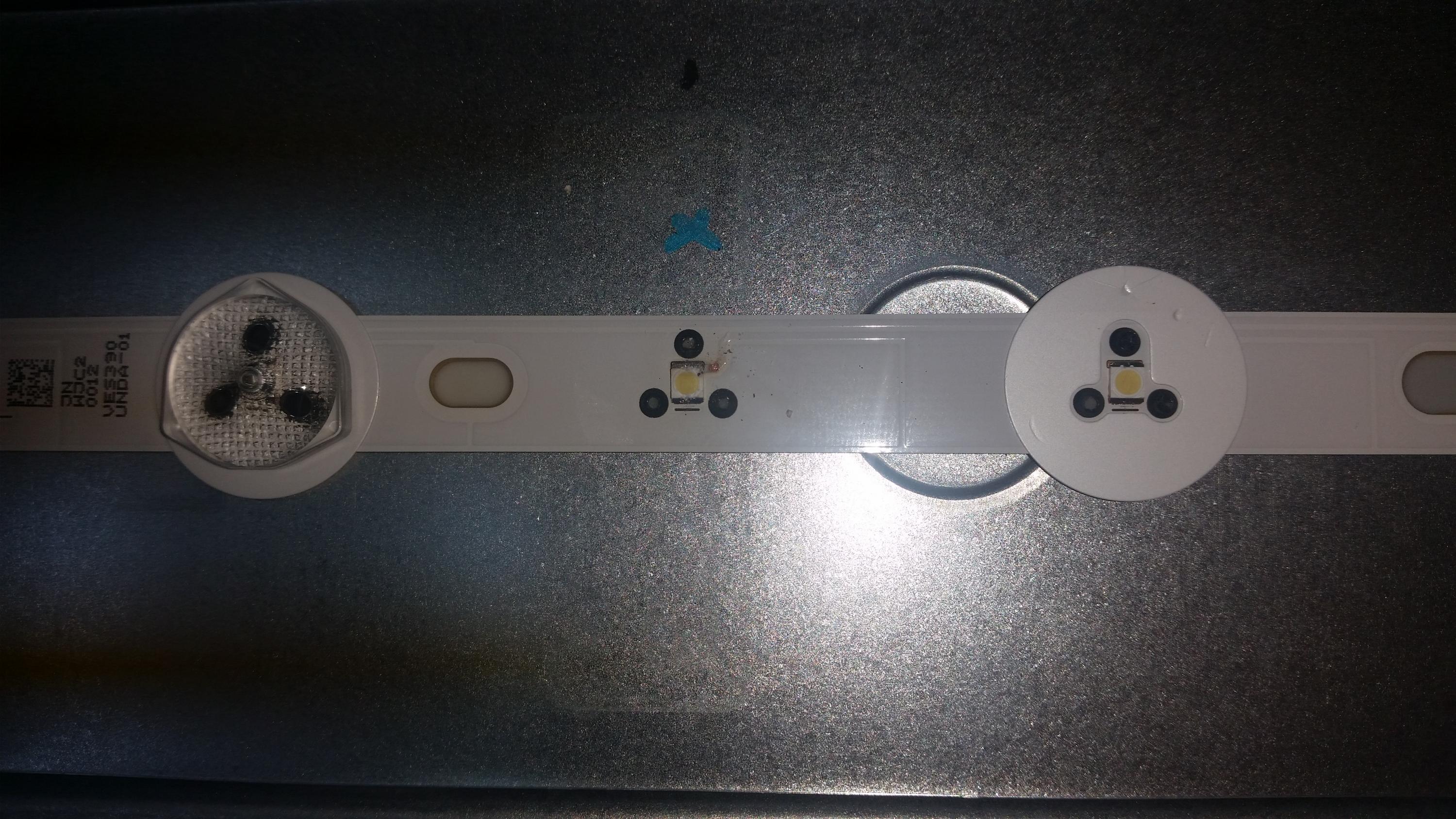

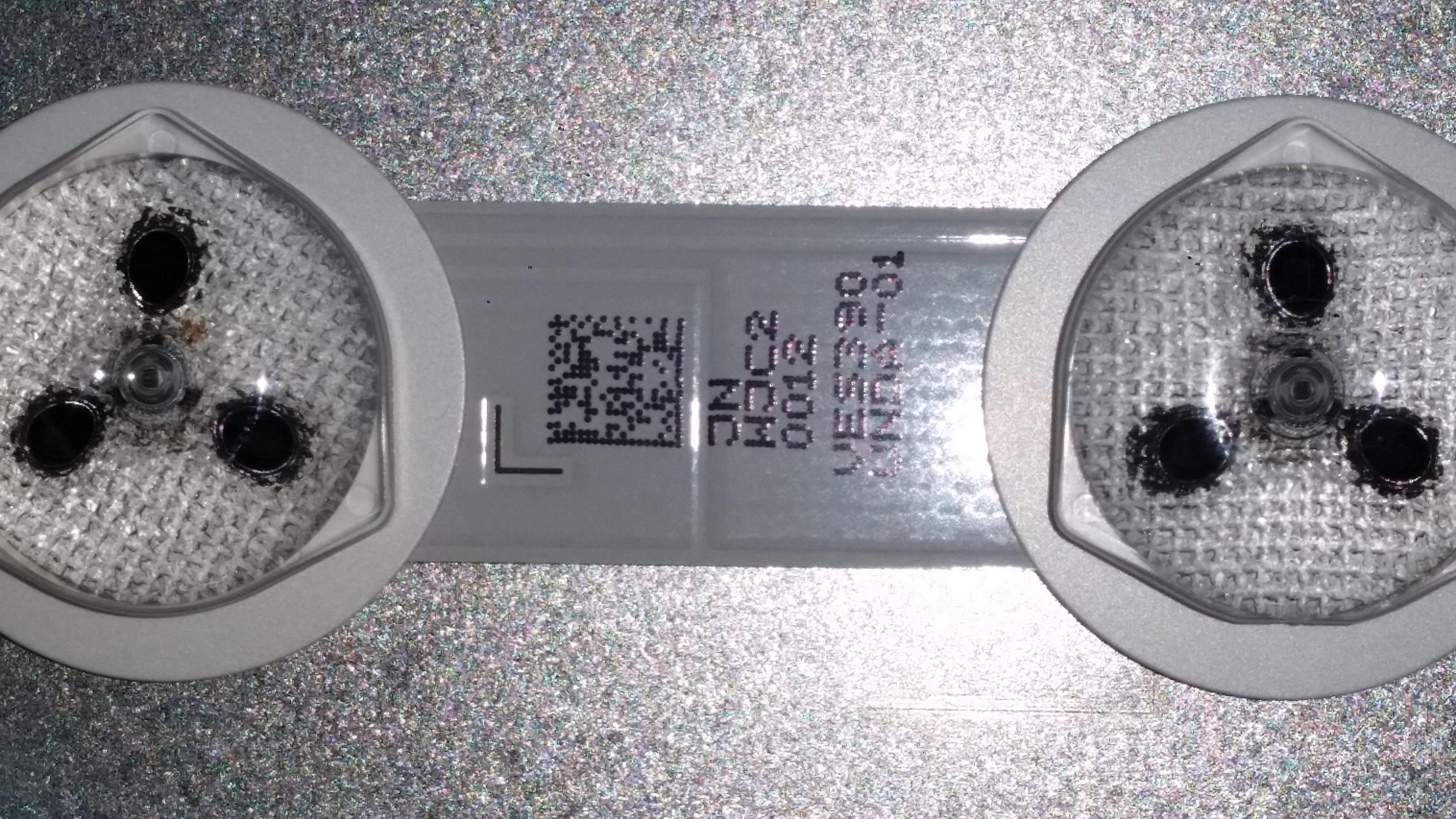

            OK so I used the same technique as the video and got to the LED strips. Using my bench PSU set to about 70mA I tested each of the five strips. Four worked fine, the centre one lights up very dim, but with one LED out.
            The LED that does not illuminate reads OC on my meter diode test, testing the one next to it, the LED illuminates with about 2.4V forward drop
            It looked like I had a bad copper track next to the defective LED but I tested continuity from the adjacent LED bead and it's fine.
            So I know the problem - what sort of LED beads are these? I took some pics there is a part number on the strip. There are 9 led beads per strip

              forgot pics

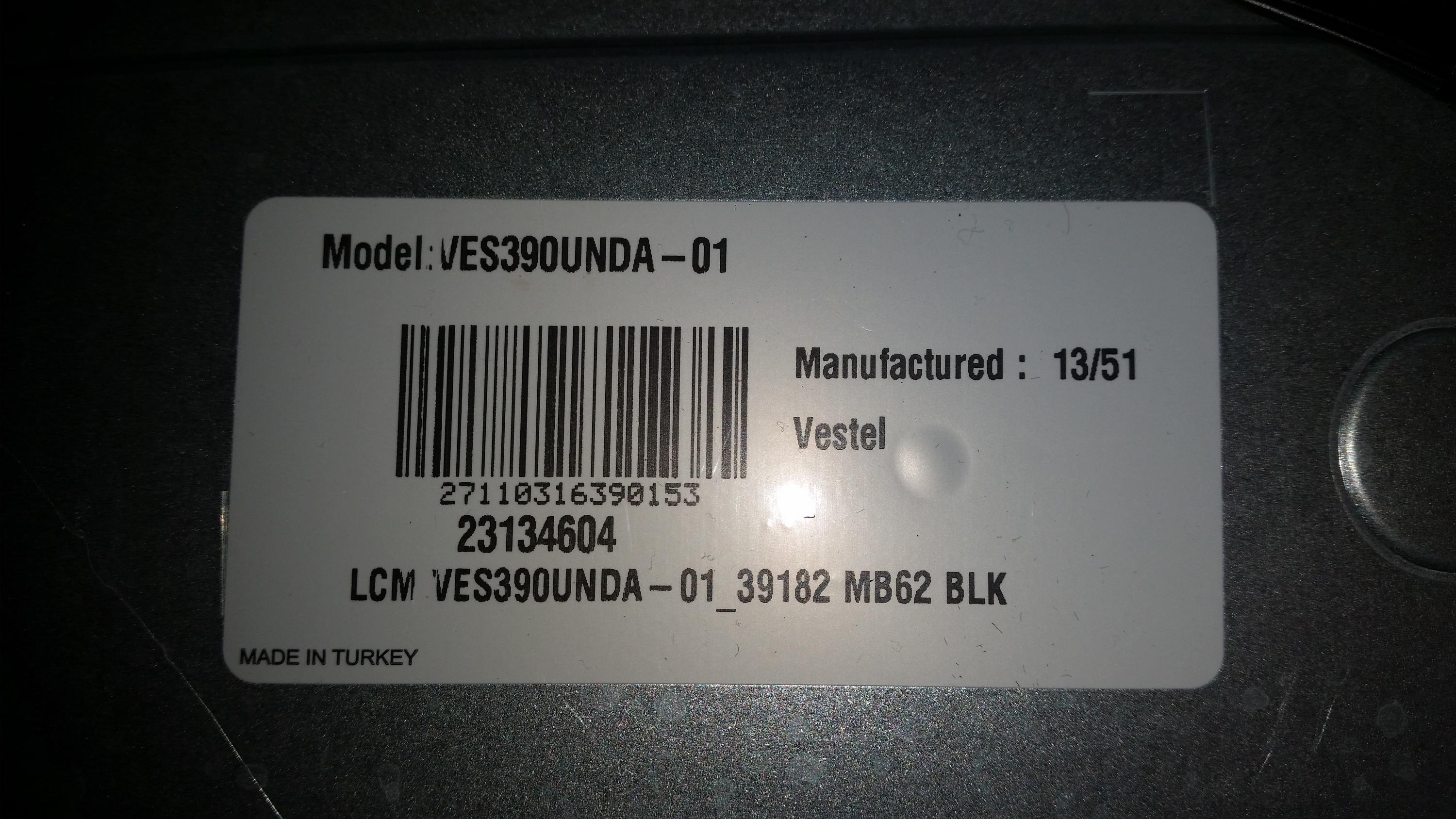

                VES390 UNDA-01 is the part number you are looking for.
                Do a search for flocko on this site using the search above who may be able to offer you suitable replacements
                  if you can remove a led and measure the physical package size of the led, also on the bottom of the led we would need to know if the anode pad is the large or small one.

                      I removed the faulty LED. The big tab is the Anode
                      I think the difference between UNDA and UNDC may be te polarity of the large tab? This listing has the polarity illustration UNDC = large tab Cathode maybe

                        maybe these if 3v and the smd package size matches

                                  Looks like 45 leds in series and the capacitor alongside the led connector is rated at 200 volts. If the voltage was say 170V then with 45 leds = 3.78V per led so not likely to be 6V leds but more like 3 volt leds.

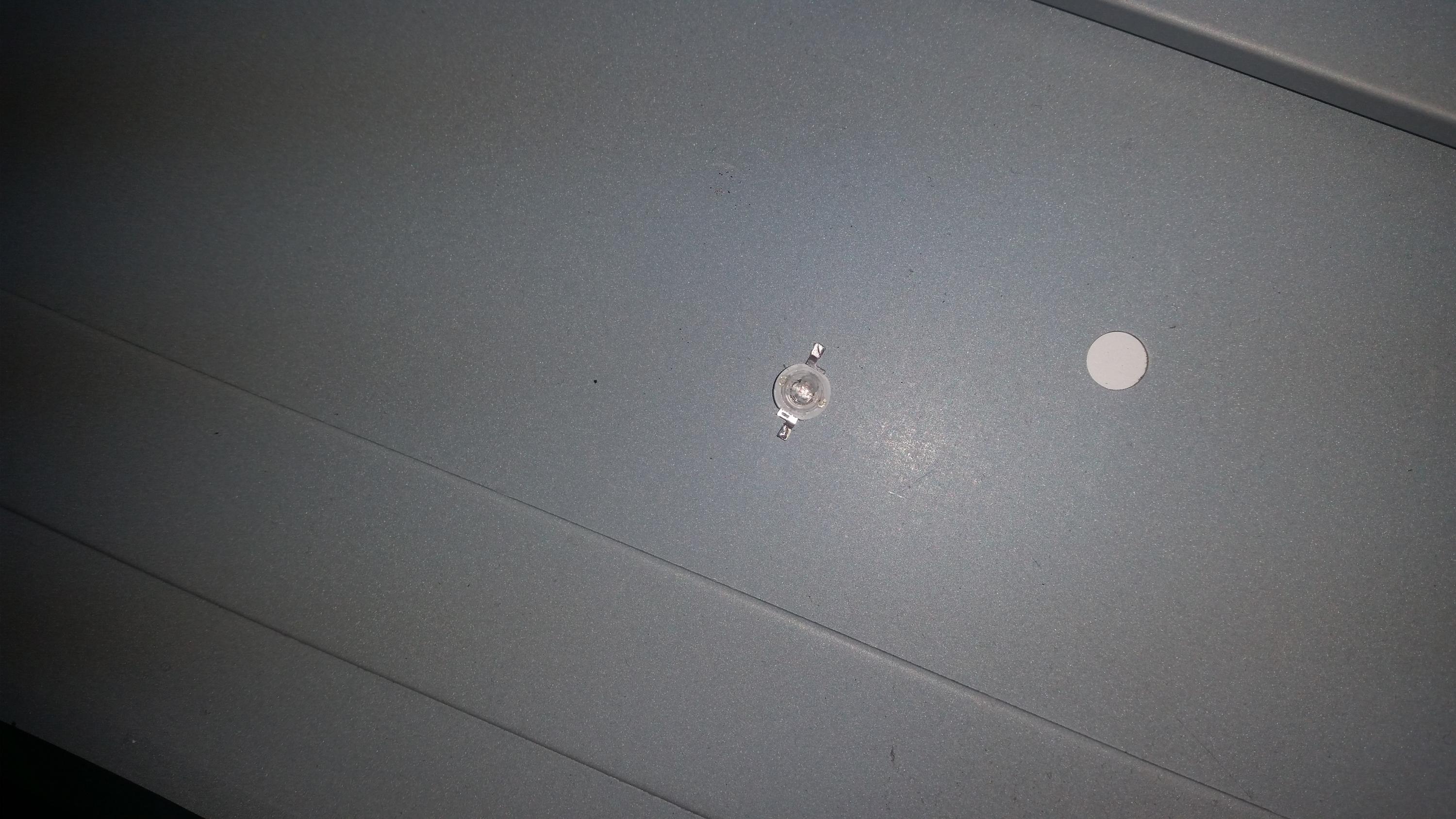

                                    I had a white 1W LED bead in my stock of salvaged bits (came off a broken 'magic crystal ball' disco light)
                                    Anyway I stuck that down to the strip with some heat conductive glue about a centimeter below the position of the bad LED, removed the bad LED and wired my bead to the LED strip using a couple of short leads then glued the diffuser back on top of it with clear epoxy.
                                    It's been working fine now for about a week and you can't see any visible difference on the screen.
                                    See Pic of the type of bead I used .
