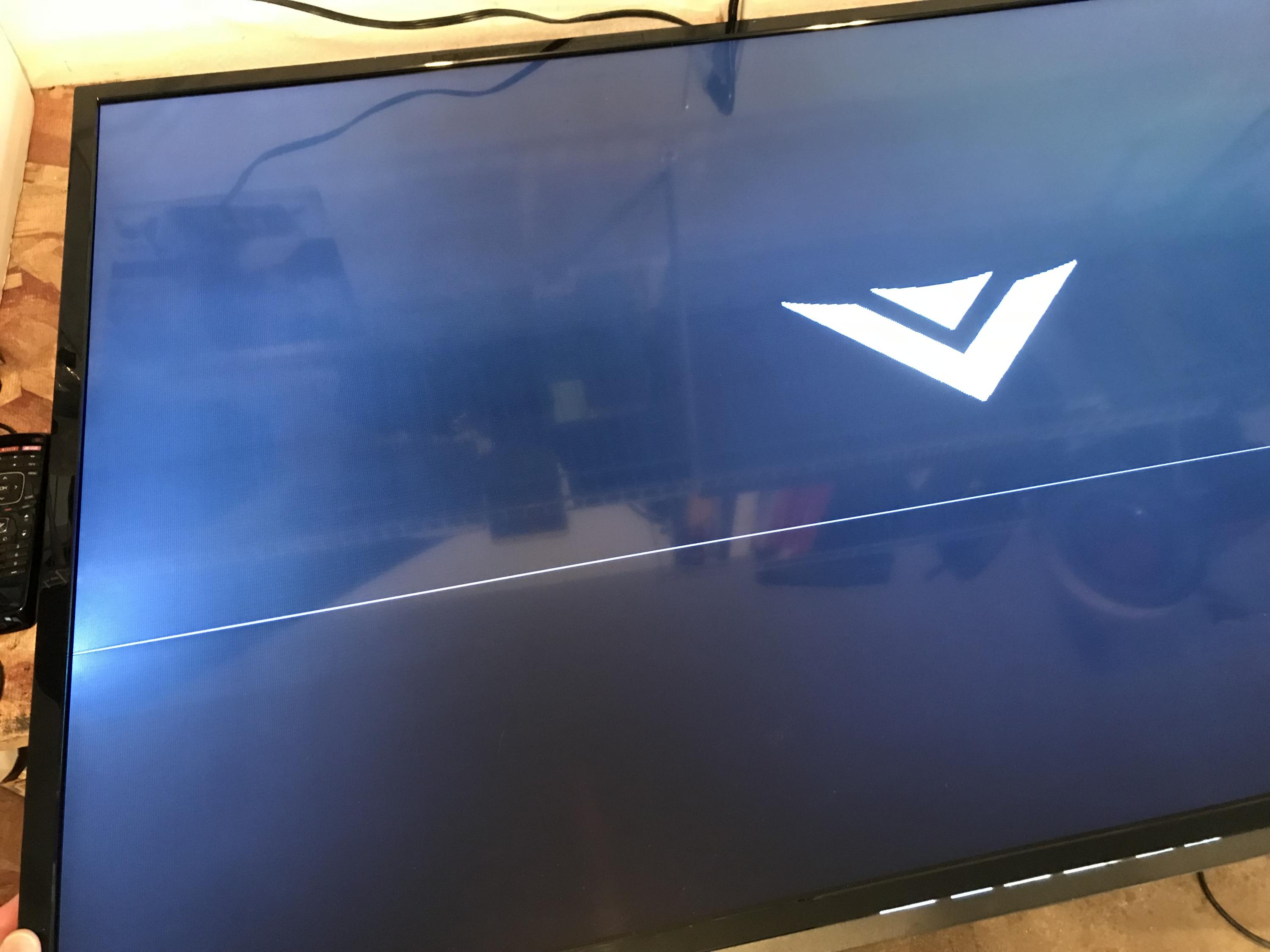

    So I picked up a Vizio E601i-A3 for a REALLY low price today on Craig's. The advertisement for it showed what looks a LOT like T-Con board funk as the colors are off and there is some very odd funk going on. This is a very large screen and I'd love to use it at home. The images on Craig's did not show a horizontal line. Now that I have it home and on my work bench it has a line in it as pictured in the attachment.
    Is the panel on this TV wasted? Is there any kind of remedy for this? The T-Con boards are cheap on eBay and I'm hearing of a recall on this TV anyway.
    I've got $25.00 invested so far - is this TV worth spending any more time and money on?

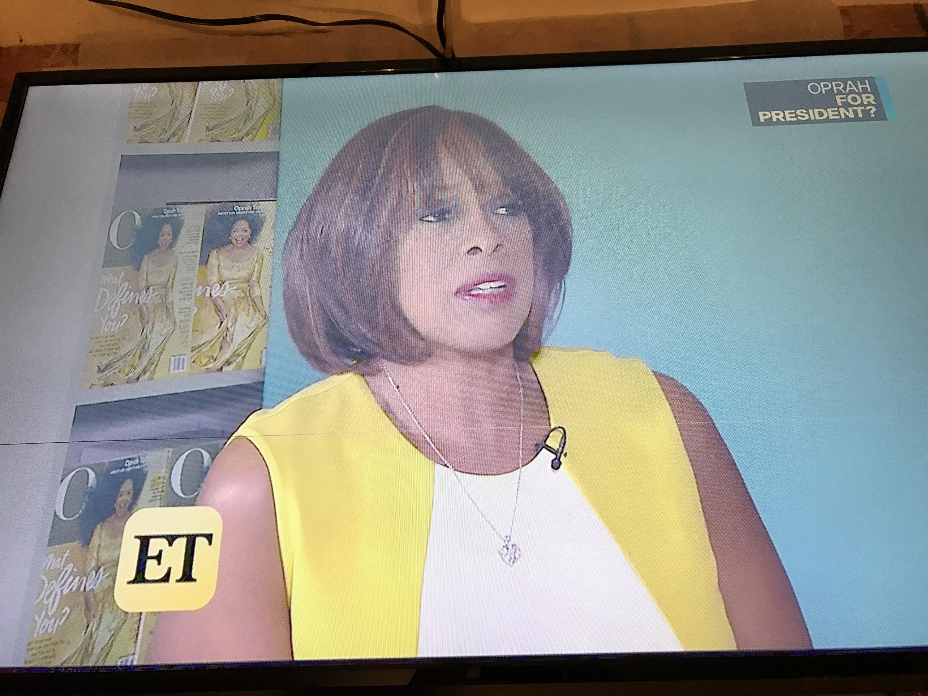

    put a better display on it... a test pattern of some sort. Then post a picture of the display so it can be determined which side the line is coming from. IF you are lucky, its a "simple surgery" of removing the side tabs on the side that is bad and you may get the set back to "normal"... basically looking like it should.

      I see that black like coming from the left side (facing tv) probably a failed gate driver on that side.

          So when I turn the TV on and the logo displays the left hand side is washed out right at the beginning of the panel. It still needs the t-con as the rest of the video looks horrible. For $20.00 a t-con is a cheap deal. As of now I'll do the t-con while I research tab bonding repair/workarounds.

            It is a sharp panel. E701 uses boards as gates. E601 uses just tabs. Same failures. And some have been knownn to swap tcons between the two.
