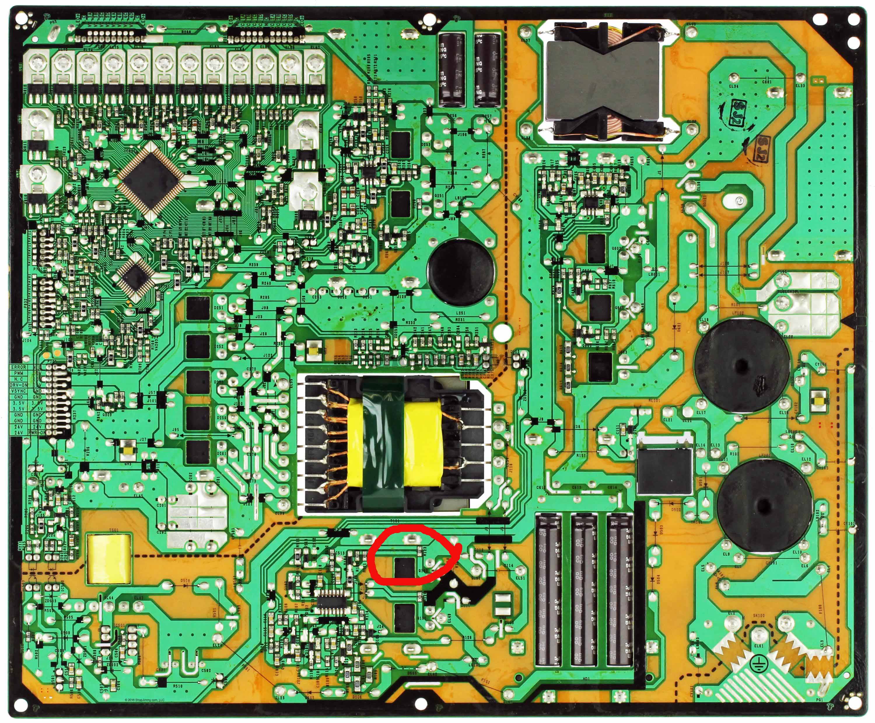

    Hi, please help me to find the r123 resistor value on back of the power board LG 47lw4500
    Power Board LGP4247-11SLPB
    PCB P/N:EAX62865401/8 11 REV1.0
    LG P/N:EAY62169801

      Re: help to find resistor value lg 47lw4500
      should be the same as r120 .

        Unfortunately, the value of r120 is unclear
          Just remove and check its resistance then. What is wrong with R123?
            That circuit migt be very similar to this one, If it is... R120 would be 10K
              The 10k resistor was wrong
                How did you figure out that 10K is wrong value? That is the typical value used between Gate and Source pin of the MOSFET.
