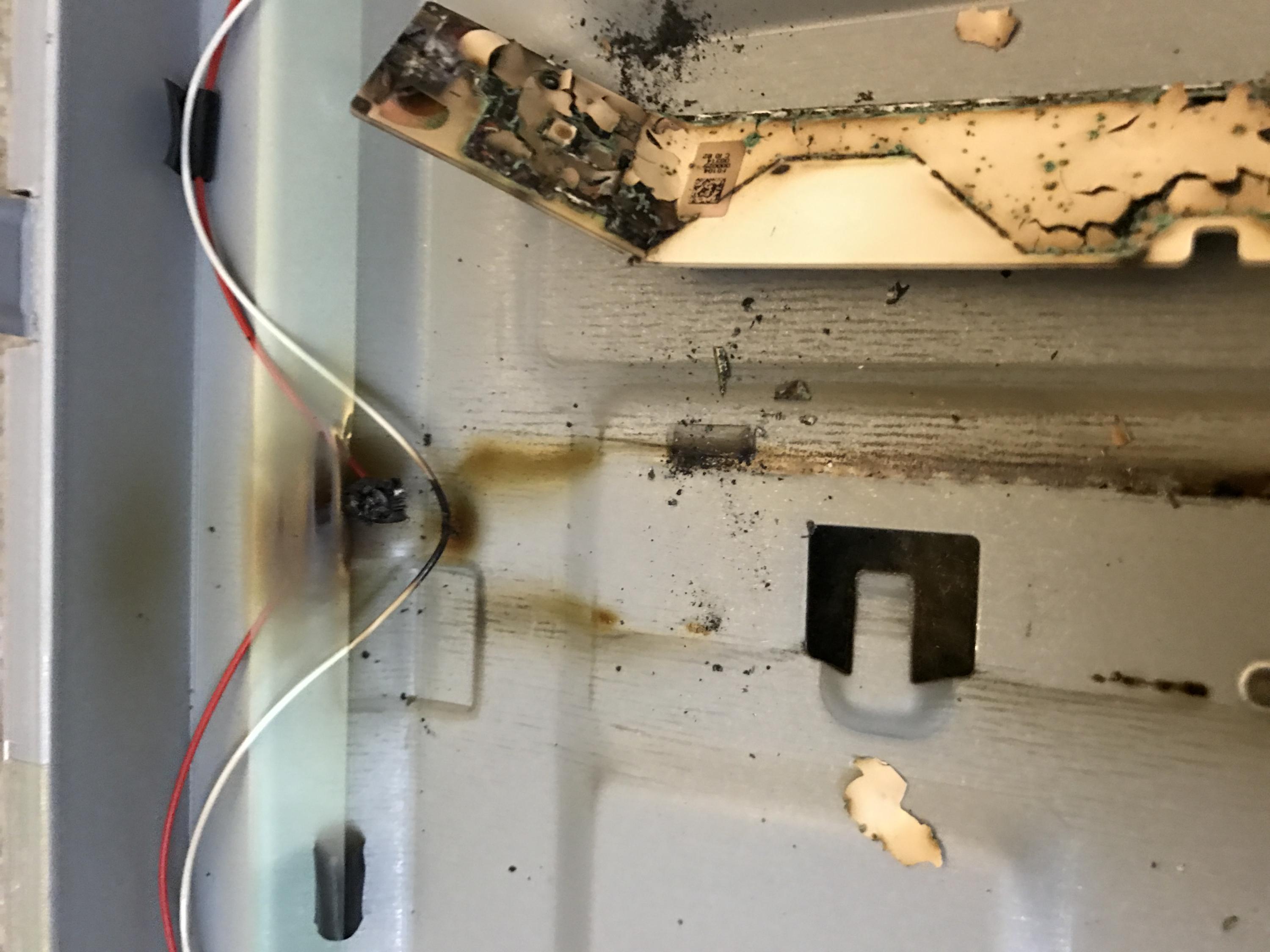

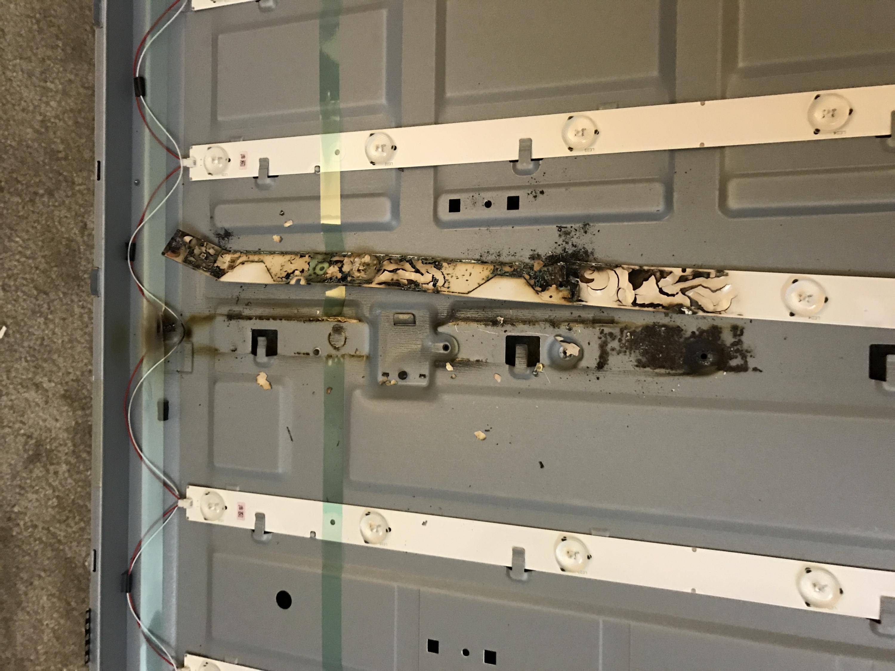

    TV symptom was no backlight, everything else worked great. Seemingly the backlights are a common failure on these I decided to open it up and give it a shot on replacing the LED strips. I open it up and look at the horror of what I found underneath (See attached pics).

          Problem? What's the problem?? Lol. Well this is what happens when LED strips are driven to the brink. When they get there make sure you turn the backlight level down and also make sure you get a new wiring harness with those strips.
          Most likely one shorted or open circuit the other ones went too bright in a shorted as well. That's pretty bad so that they got that hot they caught fire

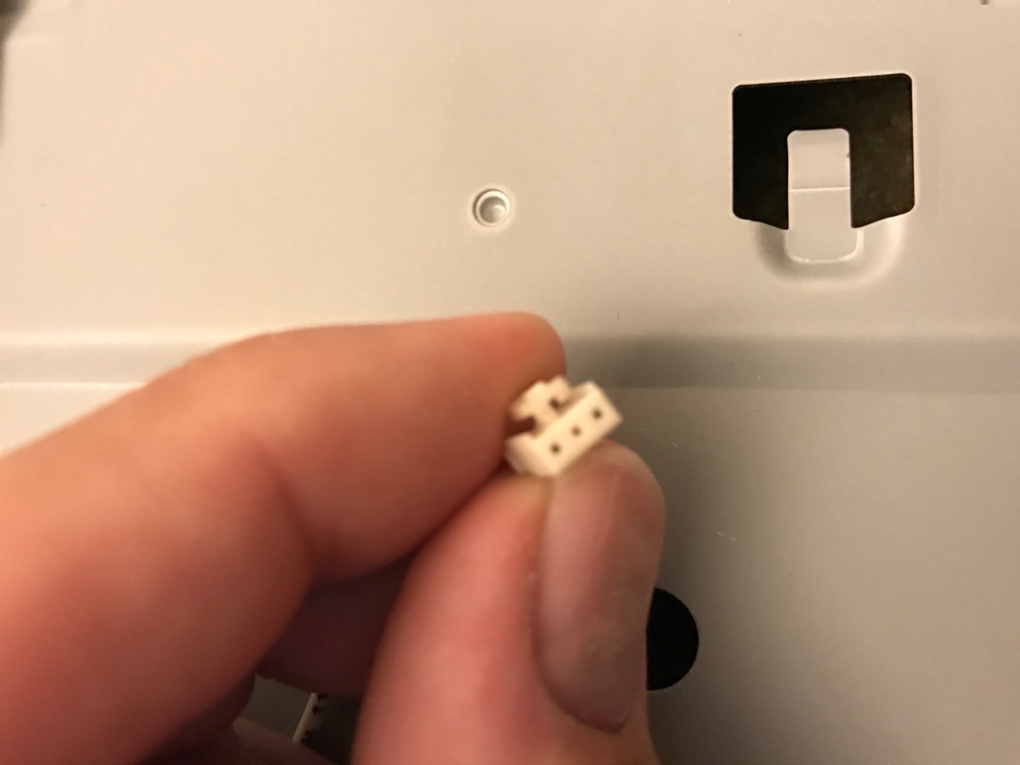

            Any leads on getting a new harness I can't find one anywhere. I managed to find the strips and most everything else on the TV but not that wiring harness. I really need one of those little connectors as the old one melted and im not quite sure how I'm gonna solder bare wire onto those small wires.

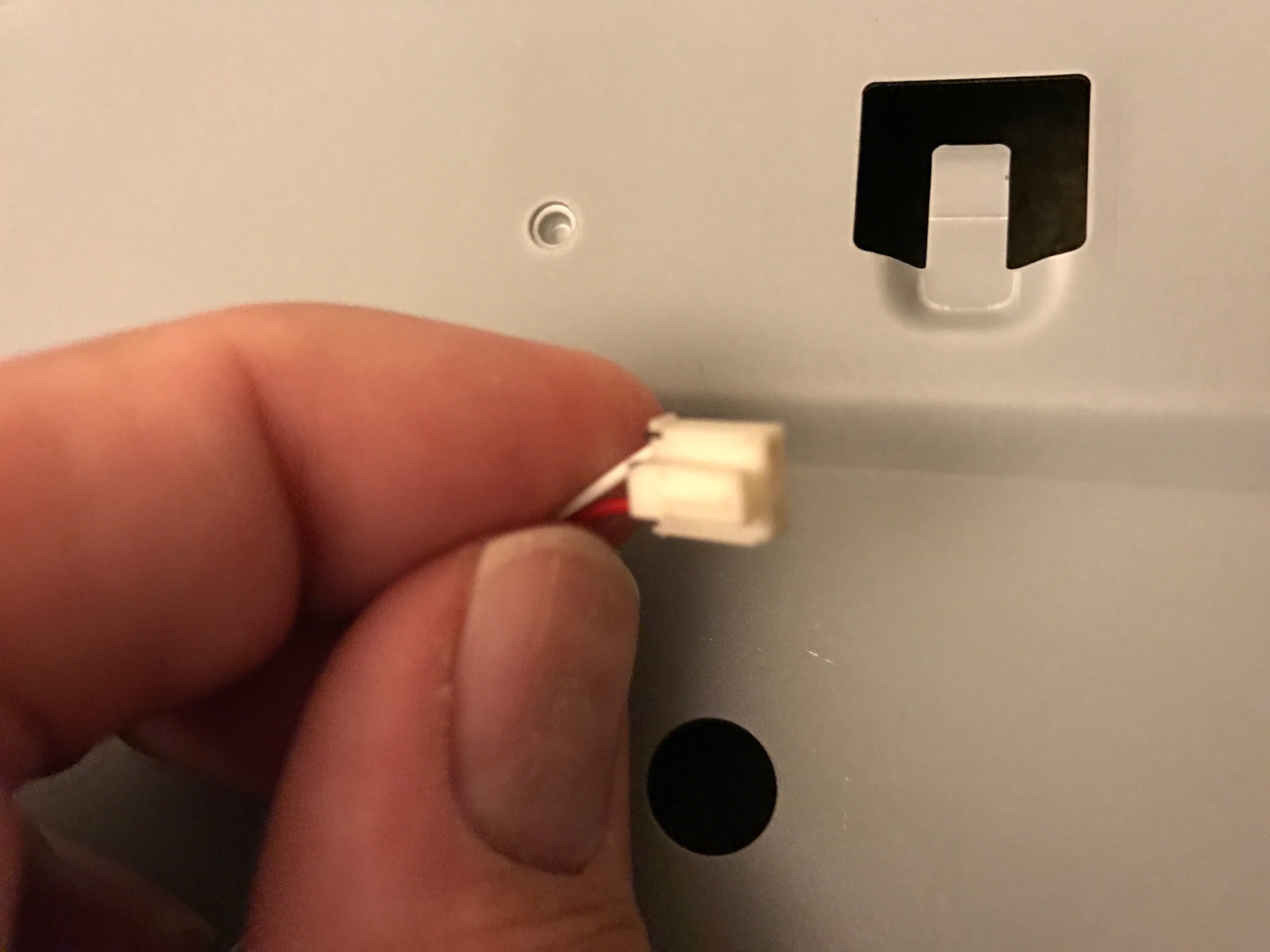

              I might have a harness here you hould hack and spice into your existing harness. Show a close up pic of the LED connector.
              Are you in the US?

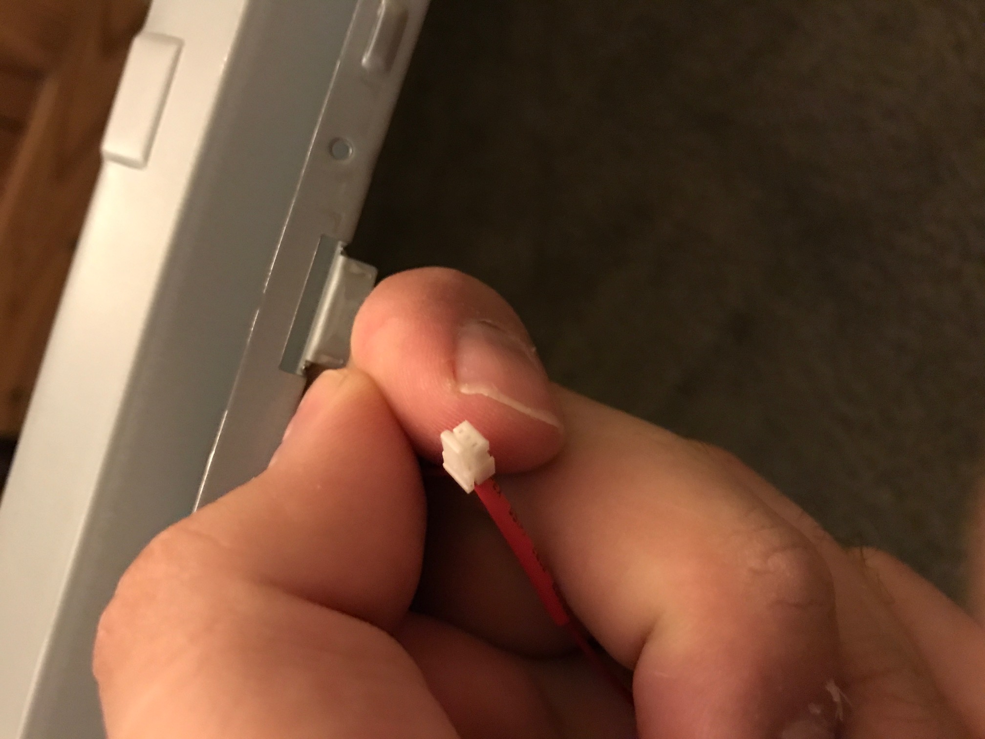

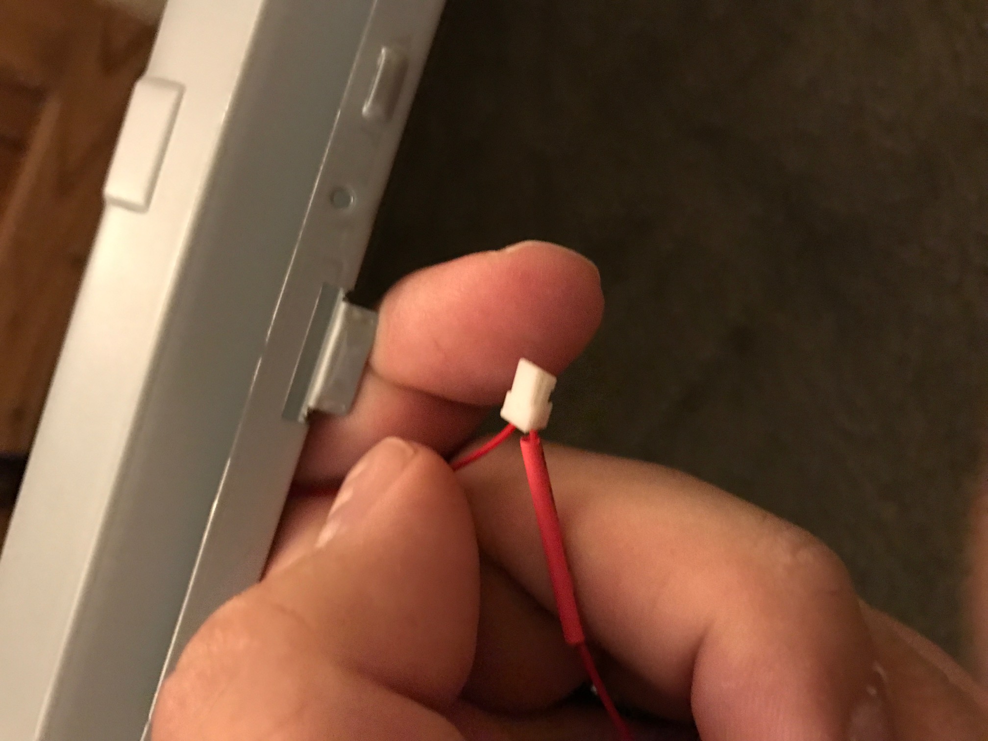

                ya im the US, here are some pictures. The first is the side that goes into the power supply and the second set are the ones that plug into the LEDs

                    Well I checked all my harnesses and they are all two pin, even though yours only use 2 wires you have a spot for a 3rd center pin so mine are narrower so they probably won't fit. Sorry I tried. Hopefully the ones you get may have a wire harness on them.

                        had the exact same problem....replaced 3 bad strips...one almost started a fire..you can put 21v to the strip to check if they work..theres a + and a - sign on the strip you can probe...the problem i had after was the plastic screen that the led sits on was black in the corner from smoke...couldint get it all off..

                          Well boys I got the lights in today and they work find but I somehow cracked the LCD when putting it back on RIP me. On the somewhat bright side only one other strip was bad and 2 other strips only had 1 LED out a piece, so 7 good working ones.
