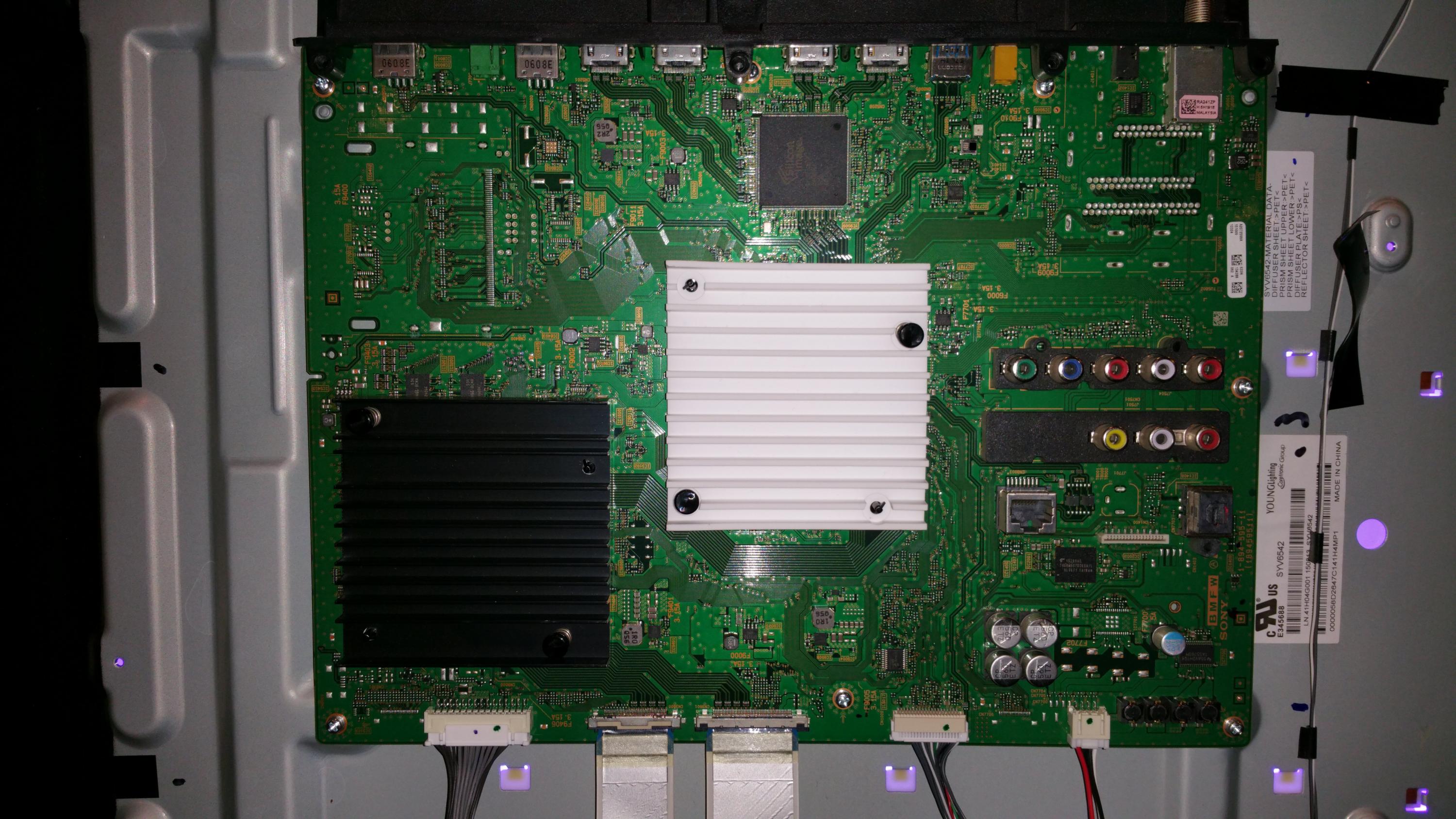

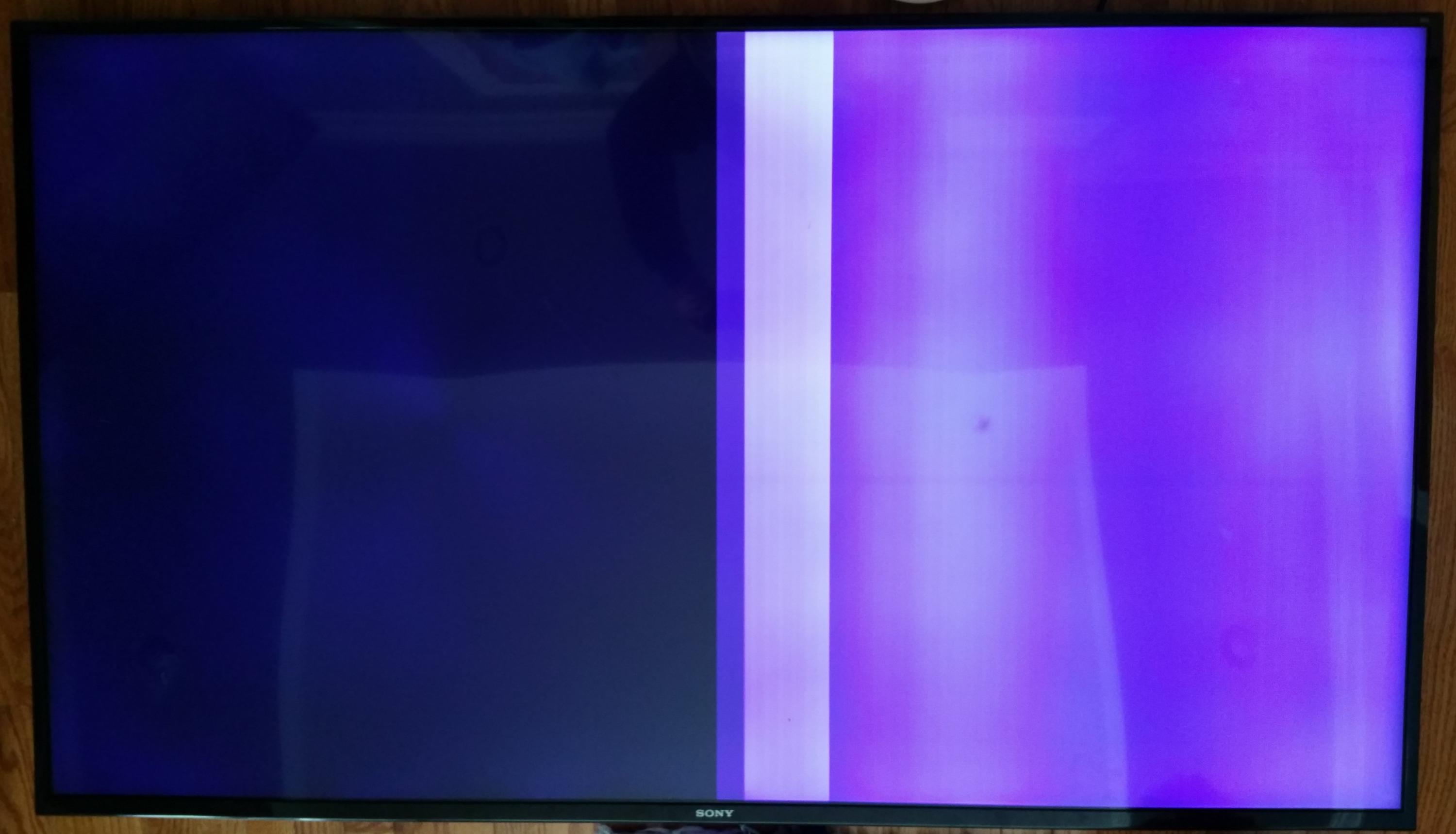

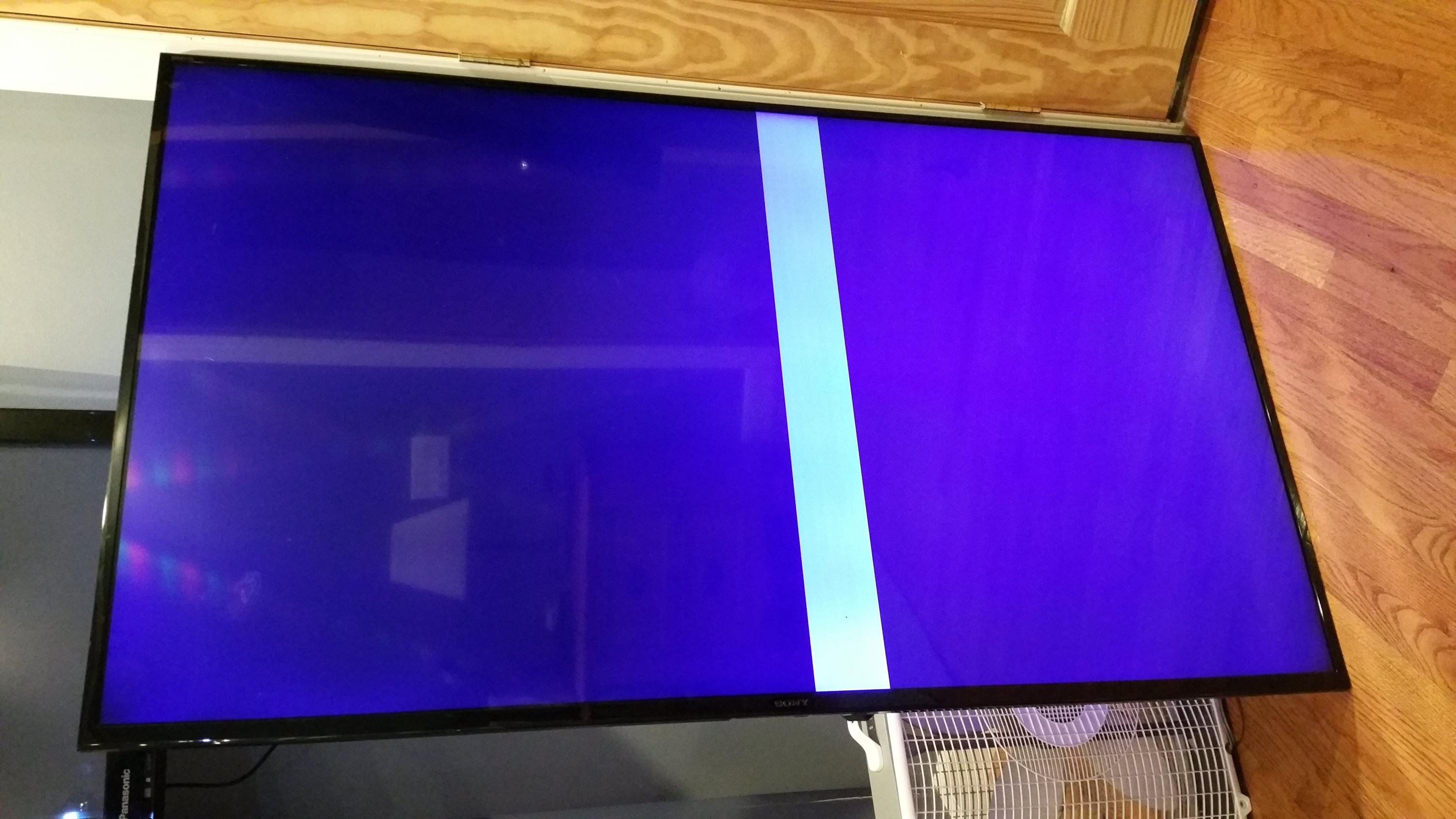

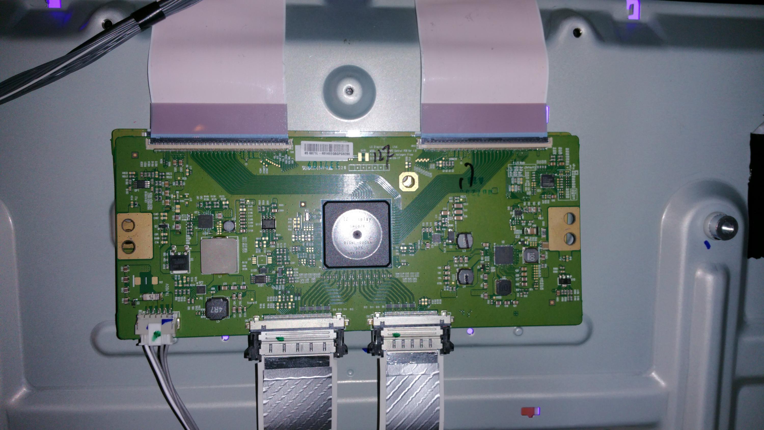

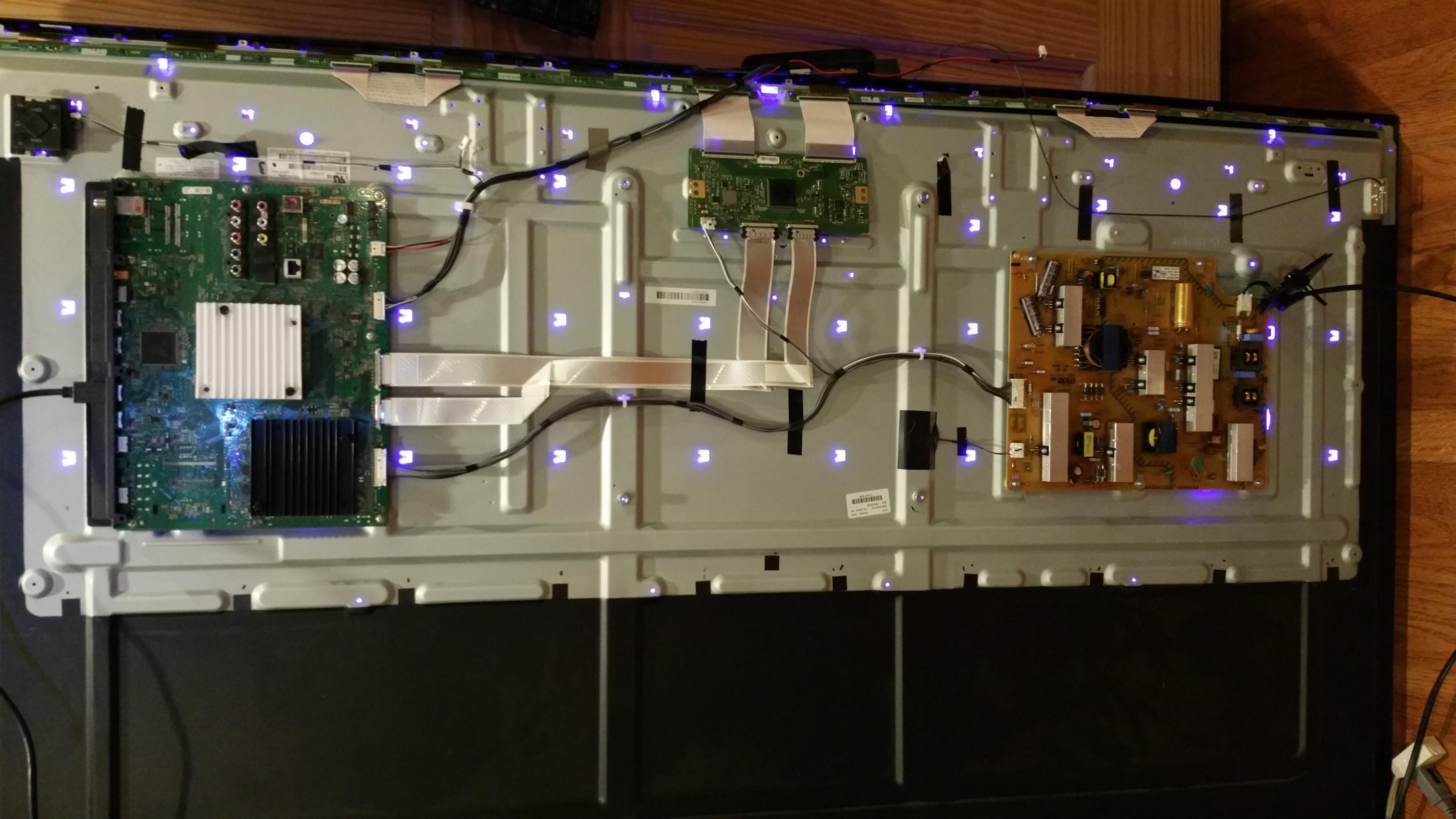

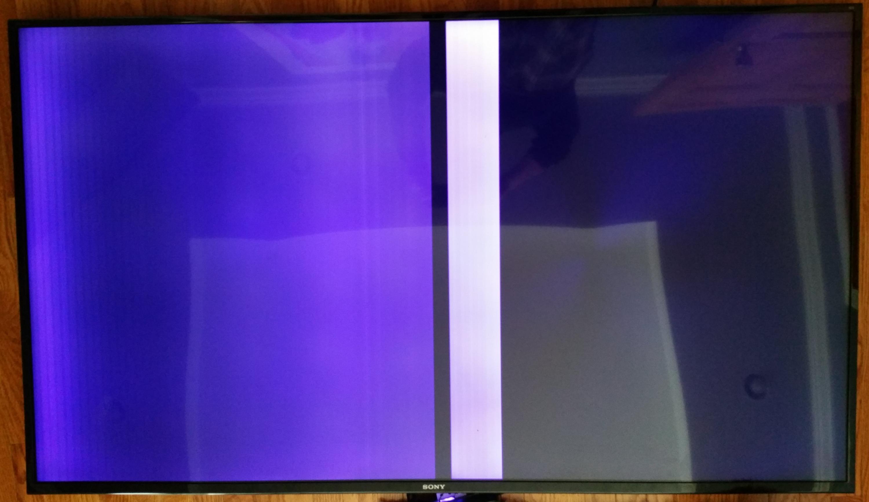

    I was given this 65" Sony 4k tv that is less than 2 years old. When I first got it, the picture did display on all settings, but had an overall blue tint to it and a 4" wide blue vertical bar through it. After pulling & cleaning ribbon cables and reseating them, the picture no longer displays. The panel just shows blue and the vertical blue bar is still there. Sound works and remote functions also seem to work.
    Thoughts?

    IF I didn't know better, I would say that's the old... "blue screen of death" ... aka microsoft operating system locked up... :-)
    Probably try and see if you can find some factory reset sequence.

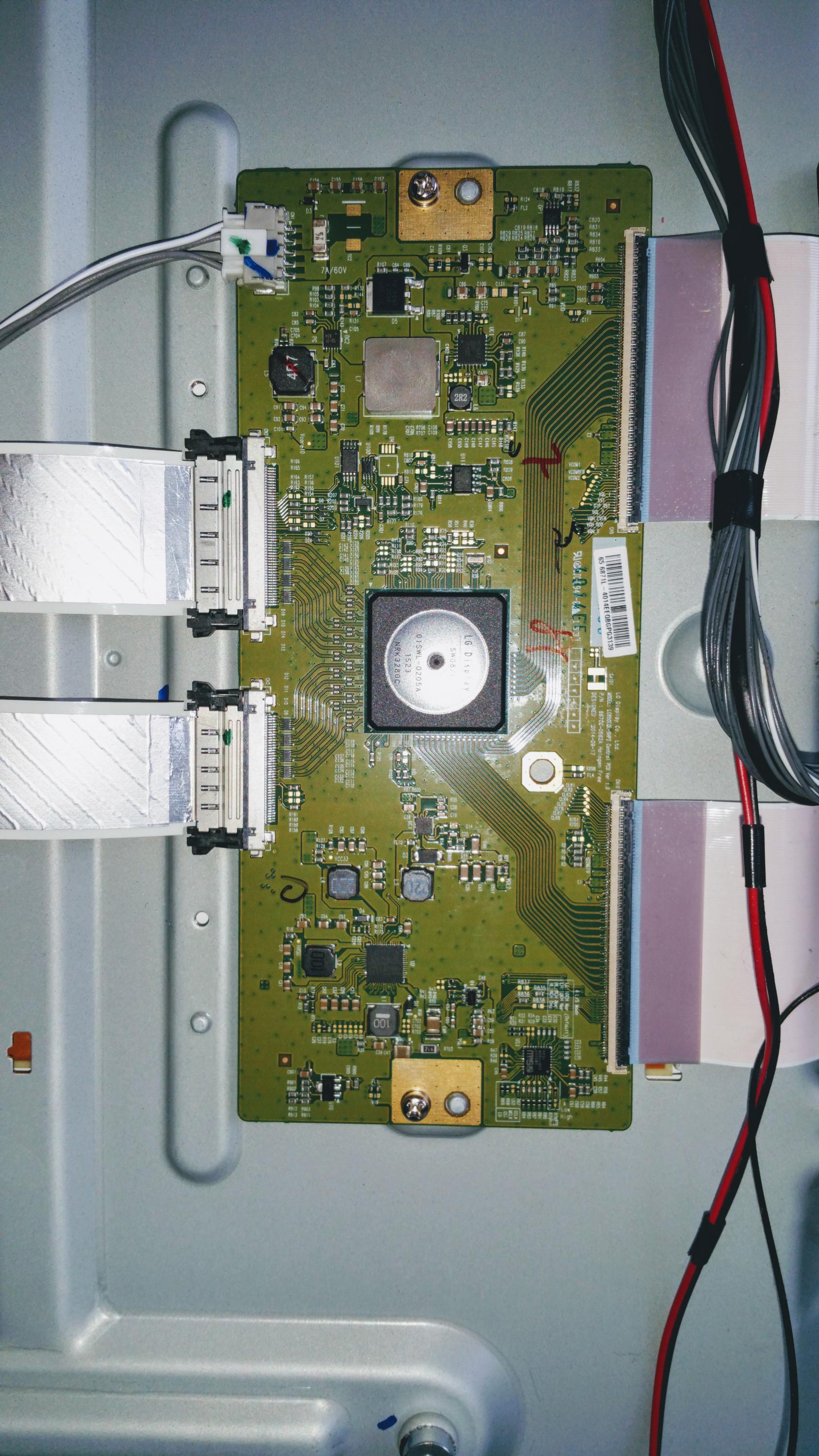

      You have 3 chances: make a better picture of tcon at sunlight, or clean away that pencil marking on the board model that someone have stupidly covered, find all the test points (ex. VCC18, VCC33, VDD) and test them in voltage an report, also the main fuse.

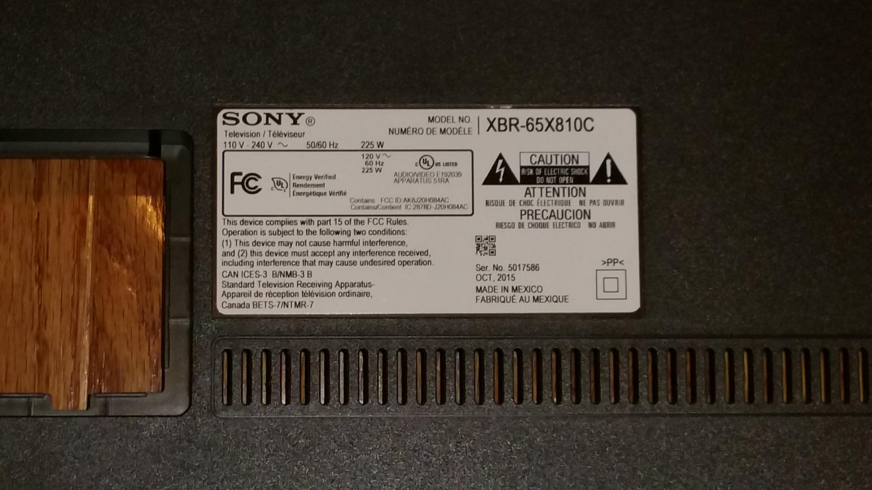

      LAstly i think the model number is not correct, i think it begins with KDL-----

        Updates and things I should have added in my OP:
        This is a replacement TCON from Ebay since that was my first thought and they are relatively cheap. I'm assuming that the markings on the board are QC.
        Main fuse is good. TCON fuse is good.
        All pb/tcon voltages that should be 12v are 12.6vdc. Logic voltages are all at 3.4v except TCON_ON which reads 2.8v
        Model number is correct. Attached a couple more pics.

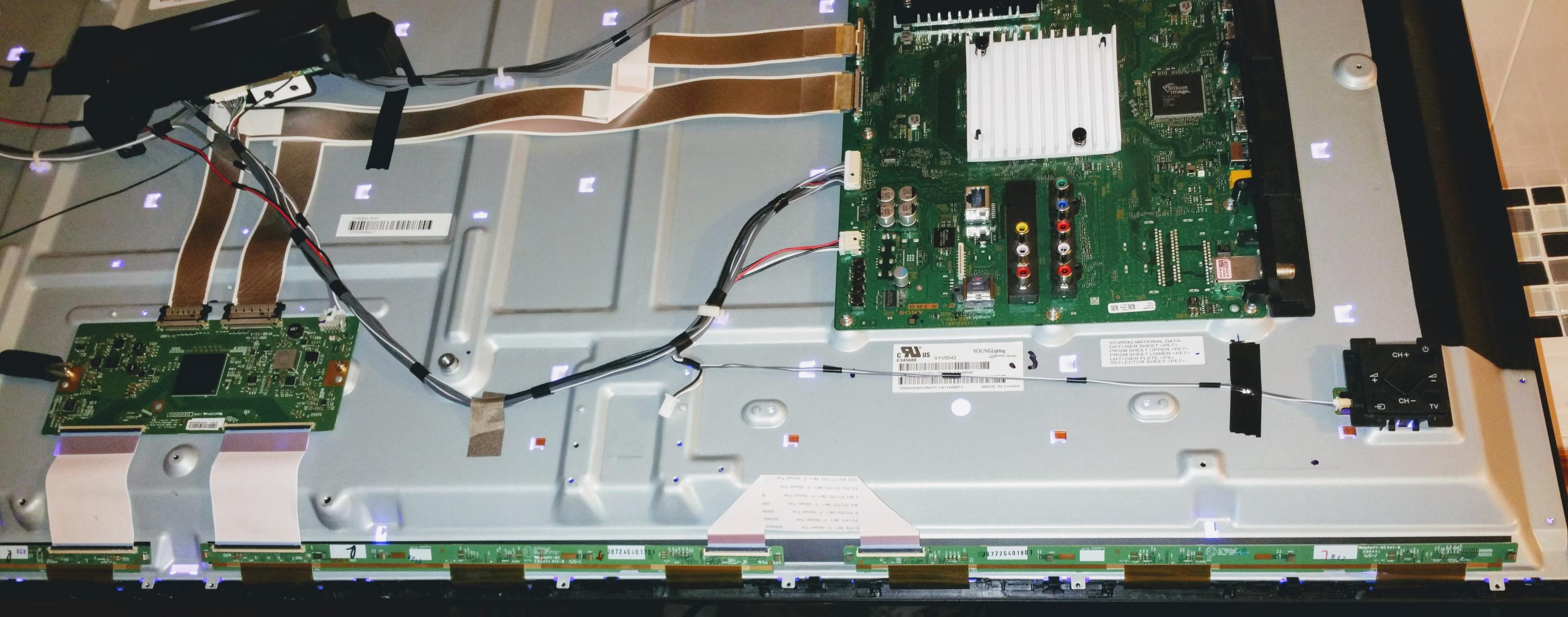

                This is a quirky model I'm dealing with the 75" version. Did you remove the cables from the main board to the tcon and and have the TV powered up at any time? Is power light flashing green and yellow at all?

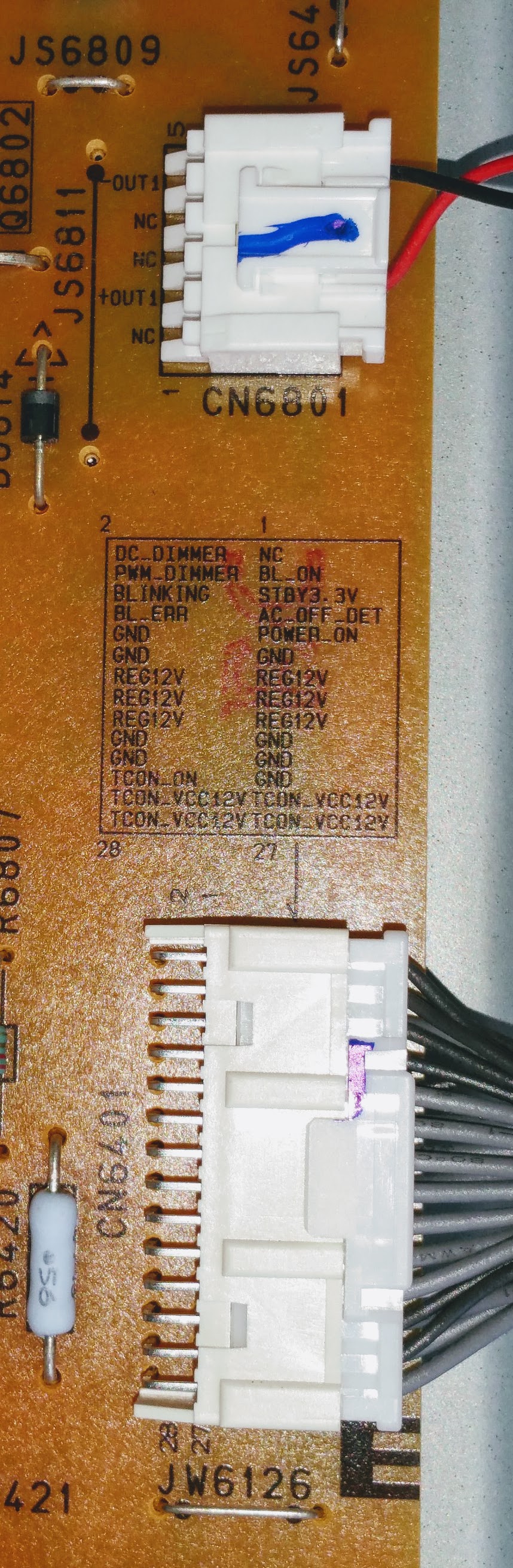

                  Sorry. By QC I meant that the markings on the board are probably from quality control at the manufacturer. As for pb, I just meant power board.

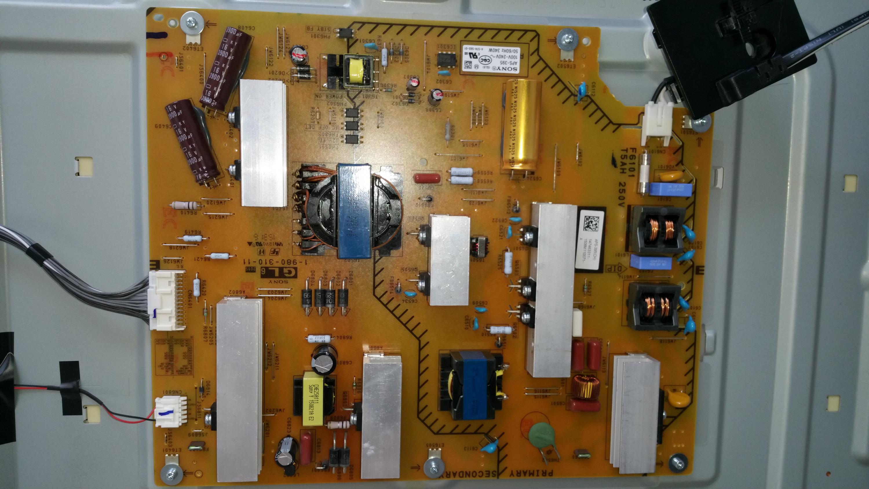

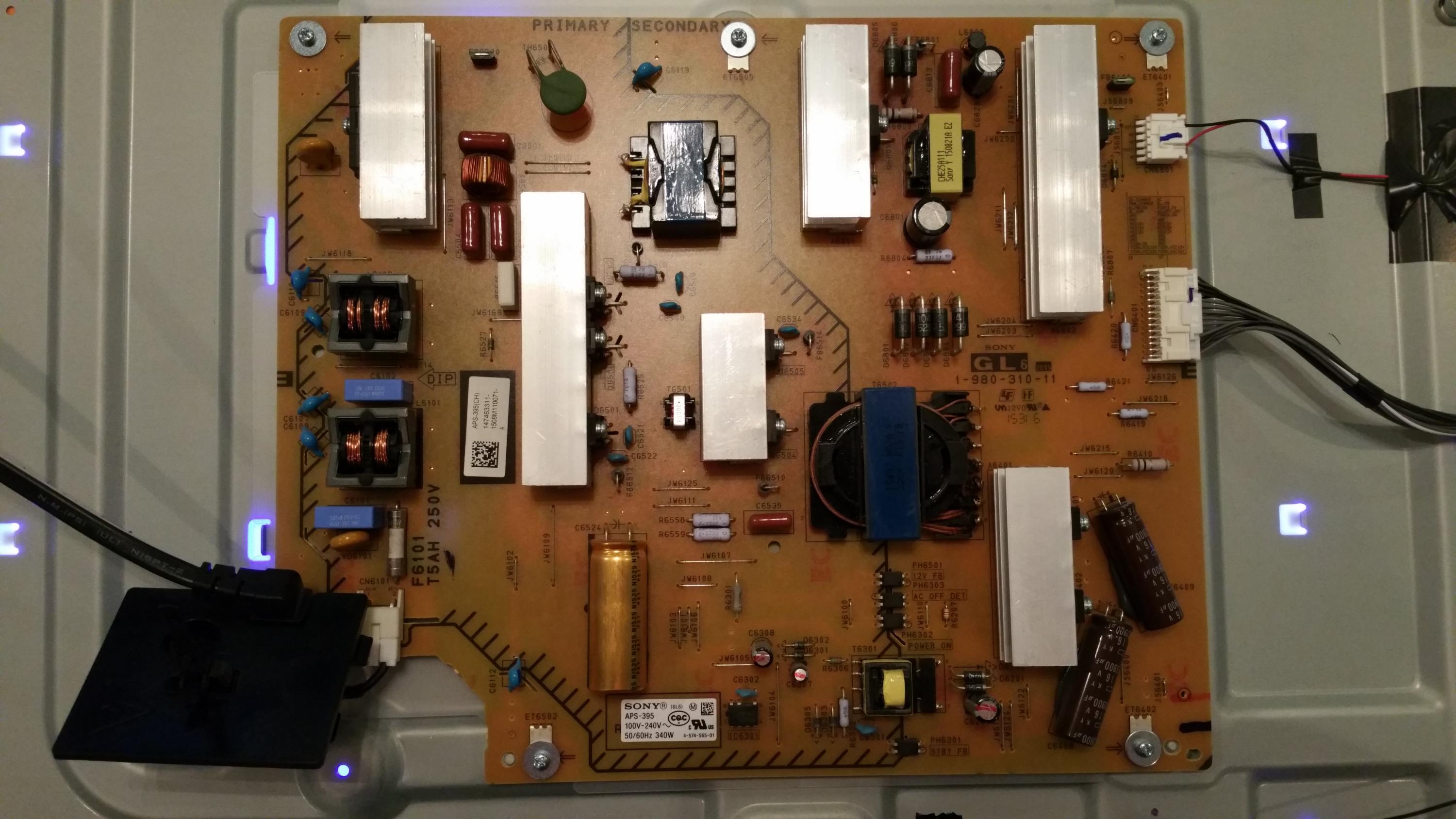

                  All the output voltages coming from the power board at CN6401 appear to be correct.
                  All 12VREG are at 12.6V and all other voltages at that connector are at 3.4v except TCON_ON which is 2.8V

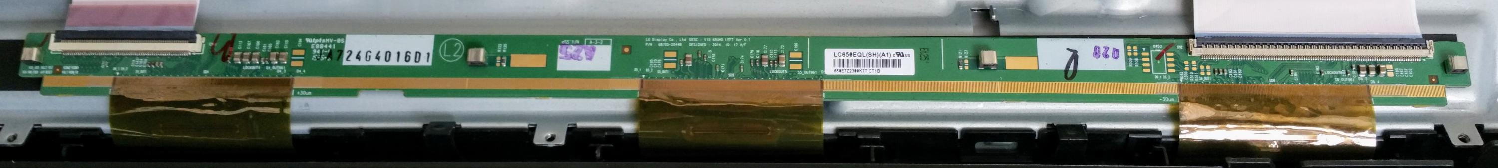

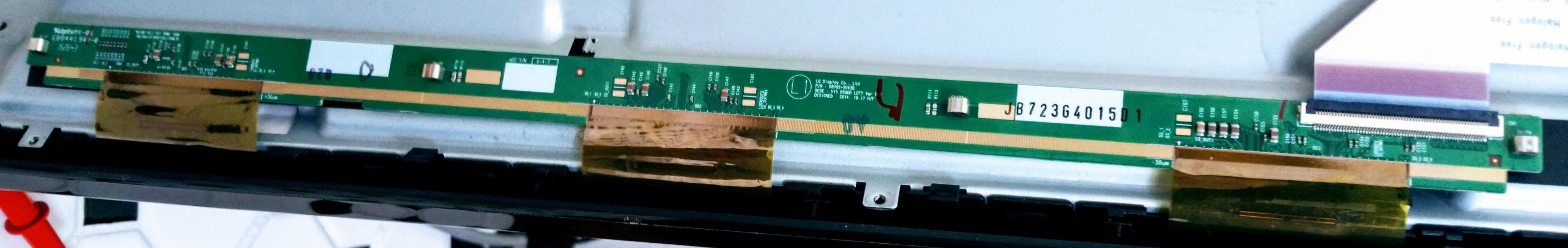

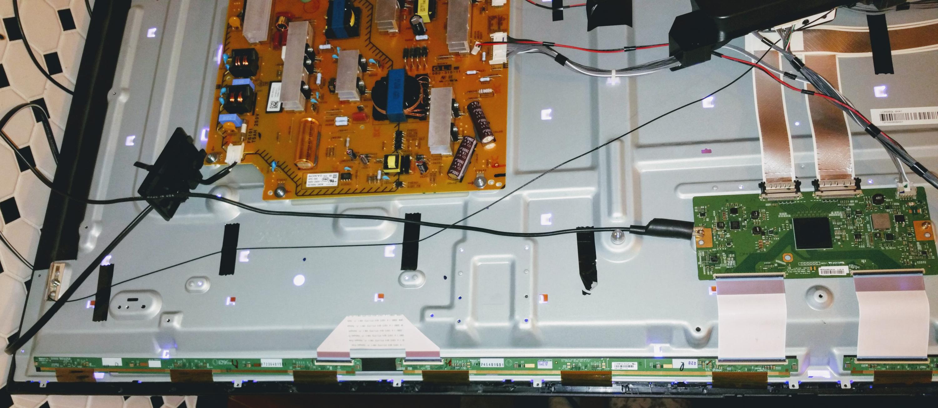

                        how is the side tab bond cables coonected to the bottom edge boards?
                        further please provide a bit more on your "disconnected the tcon to panel" testing. With one side disconnected, please post a picture of the display. Repeat the test with other side... again with a picture. There is something strange IF when you disconnect the tcon and the panel hasn't changed its "response".

                          I'll get some pics of the edge boards and of the screen with each side of the tcon disconnected tomorrow.

                            i am assuming "bottom" but they could be along the top depending on configuration which isn't obvious from your pictures of the back/cards.... but you get the idea.

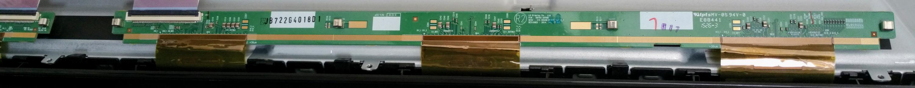

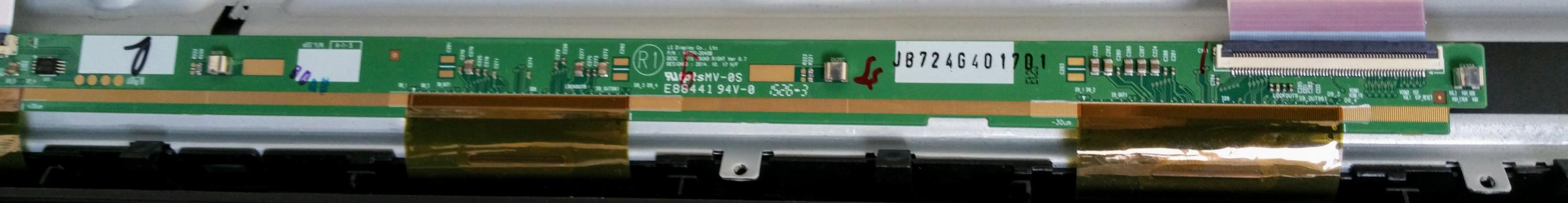

                              • toddw65
                                • Jan 2014
                                • 108
                                Re: Sony XBR-65X810C Bad Panel?

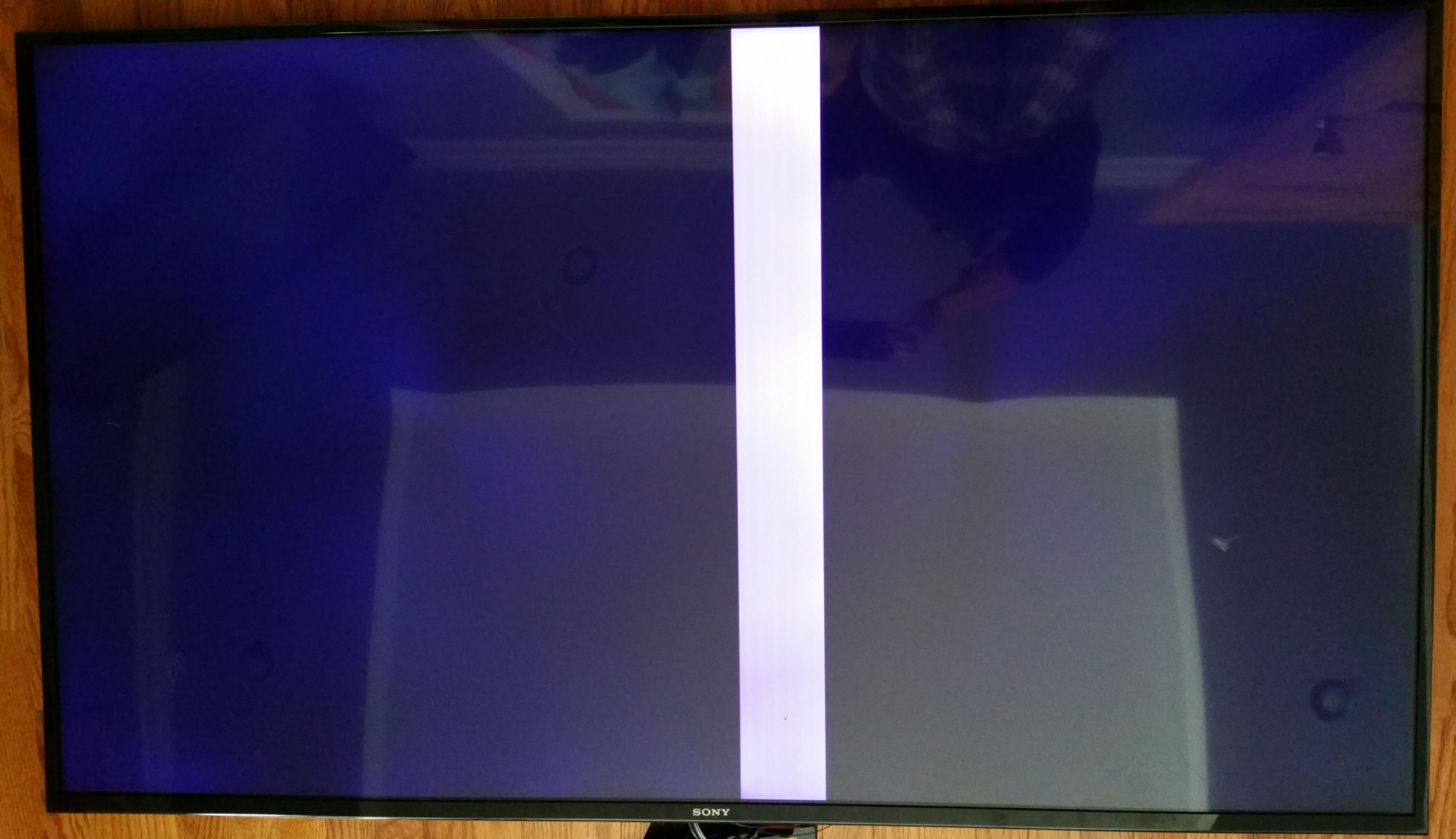

                                Ok. Got a chance to get some screen pics with the tcon ribbons to edge cards both connected vs connected one at a time. Also adding some pics of the panel edge boards. Also was able to get voltage reading from the tcon with neither ribbon connected, both connected and one at a time. Now I need to find & check the test points on the edge boards. Man those are tiny.
                                Code:
                                	TCON Cable Connected
                                	Neither	Both	Left	Right
                                VDD	0	16.37	16.36	16.37
                                D5	12.66	16.4	16.36	16.38
                                VCORE10	0	1.04	1.04	1.04
                                VCC18	1.77	1.8	1.76	1.77
                                VCOM1	0	6.12	6.11	6.11
                                VCOM2	0	6.12	6.11	6.11
                                VCC33	0.71	3.28	3.28	3.28
                                VGL1	0	-5	-4.98	-4.98
                                VGL2	0	-9.91	-9.9	-9.9
                                HVDD	7.92	7.92	7.91	7.92
                                VGH	0	28	28	28.1
                                • budwich
                                  • Jul 2015
                                  • 3097
                                  it would be nice if you would have "titled" your picture with a bit of description so we know what we are looking at. Can you actual do that now in words.
                                  my guess right now is your voltages to your backlights (leds) is not right... maybe.
                                  further, I hope you aren't disconnecting / connecting cables with the power on.
                                  certainly the white line off center is cause for "despair". With the tcon disconnected from one side, I am not how anything can happen on that side besides either black or all white... maybe its a sony thing.
                                  I was hoping that to see a disconnectable cable on the edge boards either going between bottom boards or between the bottom and side... but I don't know what I am looking at in those pictures. :-(

                                    This is interesting. I would say either your tcon is not interpreting signals from mainboard or mainboard is bad. Most likely tcon. However, that line in the screen is bad panel, gate driver. Try pressing on gate driver where it imbexs into panel and see if that line goes away.

                                      Sorry about the previous pics sans description. I was trying to get the detail of the edge boards and didn't think to get the overall picture. Here's a couple of pics with a wider view that should help.

                                        Hi, the tcon voltages are surely all in order, the strange thing in Sony tvs, like freakaftr8 thread, is that with panel disconnected tcon is "disabled". For the last pictures of video i guess n.1 is with no panel connected, n.2 right half connected, n.3 left half.
                                        I don't agree with budwich, is surely not a backlight problem.
                                        I don't agree with freakaftr8 when he says bad side driver for that vertical band, vertical things are pertinence of source drivers (the horizontal tabs). Or it can be corrosion,
                                        for instance my thought is bad panel for visibly corrosion on the central right tab visible on the second "panel's board" picture (that white substance)
                                        MORAL: "never wash tvs like a car"..
