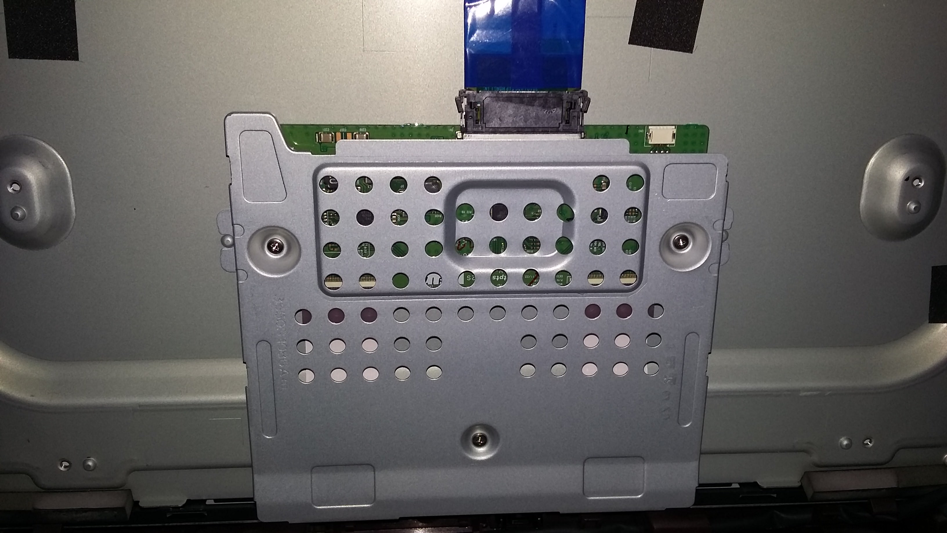

    We need to pictures of the whole backside of the TV showing all the board.
    At this point you need to find out if you are getting the 12VDC at both end of the SMD fuse on the T-CON board or not.
    You do have meter and know how to use it, right?

      Hello budm, thanks for the message. No, sorry I am not familiar with any of that. I wouldn't mind taking off the back panel and taking some pictures if that would help. One of my friends deal with electronics and might have that, what equipment specifically should I be looking for?
        Re: LG 47LS4500 backlight and sound, but no display
        You cannot do much without the meter, but still need to see the pictures to see if the T-CON is integrated with the LCD panel or not.
          Here's some additional pictures. Let me know if you want any close up pictures on anything:

                          We need to see if your tcon is getting 12v or not. Also need to do some fuse checks. With your meter, what happens when you touch the 2 probes together ?

                            Hello freak, thanks for replying. If you mean touching the red and black ends from the Fluke meter together it makes a continuous beep.
                            If you can tell me or highlight on my pictures where I need to put the testing ends on which parts I will do it.

                              You will have to remove that cover on the bottom middle board and look for a fuse labeled F something. Fuse will be located where the flat ribbon cable plugs into the tcon board. This will be the board that we're focusing on right now
                              Also I noticed the screen on your fluke meter has a pressure point does it still show a display?

                                Okay here's what I see:
                                EDIT: Yes the meter display does work and the meter itself functions fine. Tested it on some items at work.

                                  Check the resistance of that white fuse right next to the left side of the top connector.
                                  NO POWER to the TV!

                                    Use your red and black probe on each side that fuse with the TV unplugged

                                      Okay can do, just need to know where to properly place the red and black probes to properly check.
                                      EDIT: Guessing you mean putting one on each of the gold ends. Did that, and no beep. However, if I place each of the probes on both sides of each of the single gold ends, it does beep.

                                        Ok...
                                        Well the fuse is bad. There's your problem. Either find a way to replace fuse Or replace the board by the part number on the board
