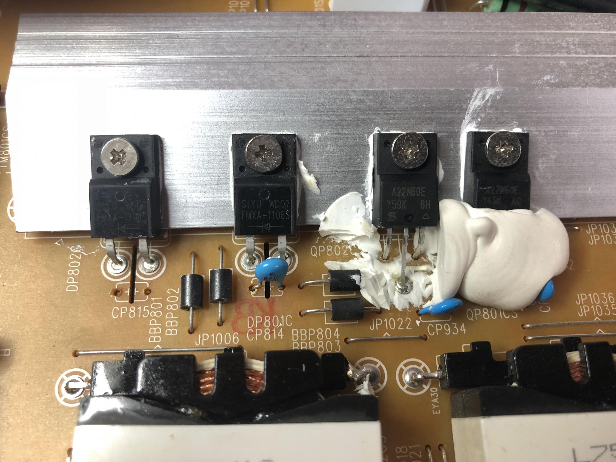

      BTW, I also replaced QP802. It was shorted when removed from board. I forgot to say that on my first post. CP814 is in front of DP801C and next to QP802 (the one I replaced).
      Adding a photo of my board on next post.

        Re: BN44-00780A Blown Fuse - Troubleshooting
        Photos attached
          Ok Budm.
          I made a mistake of forgetting to put all blue caps back. If you see my picture I was missing CP815. However, I put it back and still same problem. Only 170V on Filter cap and no relay clicking.
