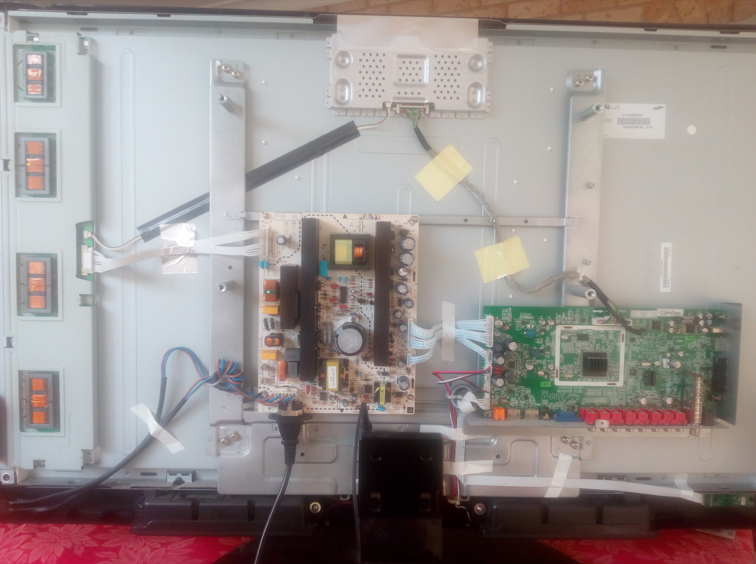

    This set when plugged in displayed a blue (on) led on front panel whereas standby is red. The PSU gives all correct voltages but no Blon or PWM signal is coming from main. Have been able to force backlights on with main disconnected so all OK except for main where I suspected eeprom problem. So I replaced ic I identified as eeprom with a new blank one to see what would happen - hoping to get a red led on front but absolutely no change still came on with blue led and no response from any button on set or on remote. Why?

    Pics and sm. I picked out N805 as eeprom.

      I believe you will need to program eeprom.

        Yes dskall I was hoping it may self load from somewhere!! Getting the firmware is the problem I at least hoped it would go to red led.

          Don't think there is backup to load from. Did you try freezing old chip?

            Tried that while eeprom in set no result.

              Looks like 803 or 806 is main eeprom. 805 is hdmi. If you have oscilloscope you can check clocks and data. You have pin outs of chips which is big help

                when you froze the eeprom was the tv pluged in or unpluged?

                  Thanks dskall you have just ruined my day!!! Made an assumption on age of set and as the ic spec showed eeprom use. Of course these sets have Sanyo logo come up first and it may well be in separate ic. The 64bit flash memory is now obvious to me and changes everything. Will try freeze on it. R_J for me set off, freeze ic, immediately turn set on.

                    No UNPLUG tv - freeze ic - THEN plug in tv and turn on. The micro reads the eeprom when the tv is pluged in so it knows what to do. If you try freezing it after its pluged in it has already read the info and if it was bad at that point freezing wont change it.

                      Thanks R_J and to explain with off I mean not in standby but with no power at all going to PSU. This set has a master on/off. I have seen posts re unplugging sets but if no power in the electrical cord when switched off at pp that should be OK? Really for all sets and particularly Chinese el cheapos I think leaving them in standby all the time is just asking for trouble - whe not in use I turn off at pp (use pp remote control) and over the years have never had to fix one of my own sets. My current 50" TCL now 3years old going well.

                        Well I think I've been switching between sets too much and not retaining and checking info enough. Went off service manual for this set but N803 (16 pin ic) is not incorporated in this particular model. Instead we have N806 an 8pin EN25B32 ic in its space. These sets come on with a red Sanyo logo on screen a few seconds before usual screen so would not be surprised if 2 eeprom used N805 and N806. The HDMI ports 3 off look to have their own ICS NA04 NA05 NA06 just to confuse us. Thought I read somewhere that a service menu input could put flash memory back to original but ........will keep looking and meantime put original N805 back. Freezing only resulted in no blue light and nothing at all until a few minutes later after turn off then on when again the blue led lit all voltages good but no backlight and no reaction from remote or set buttons.
