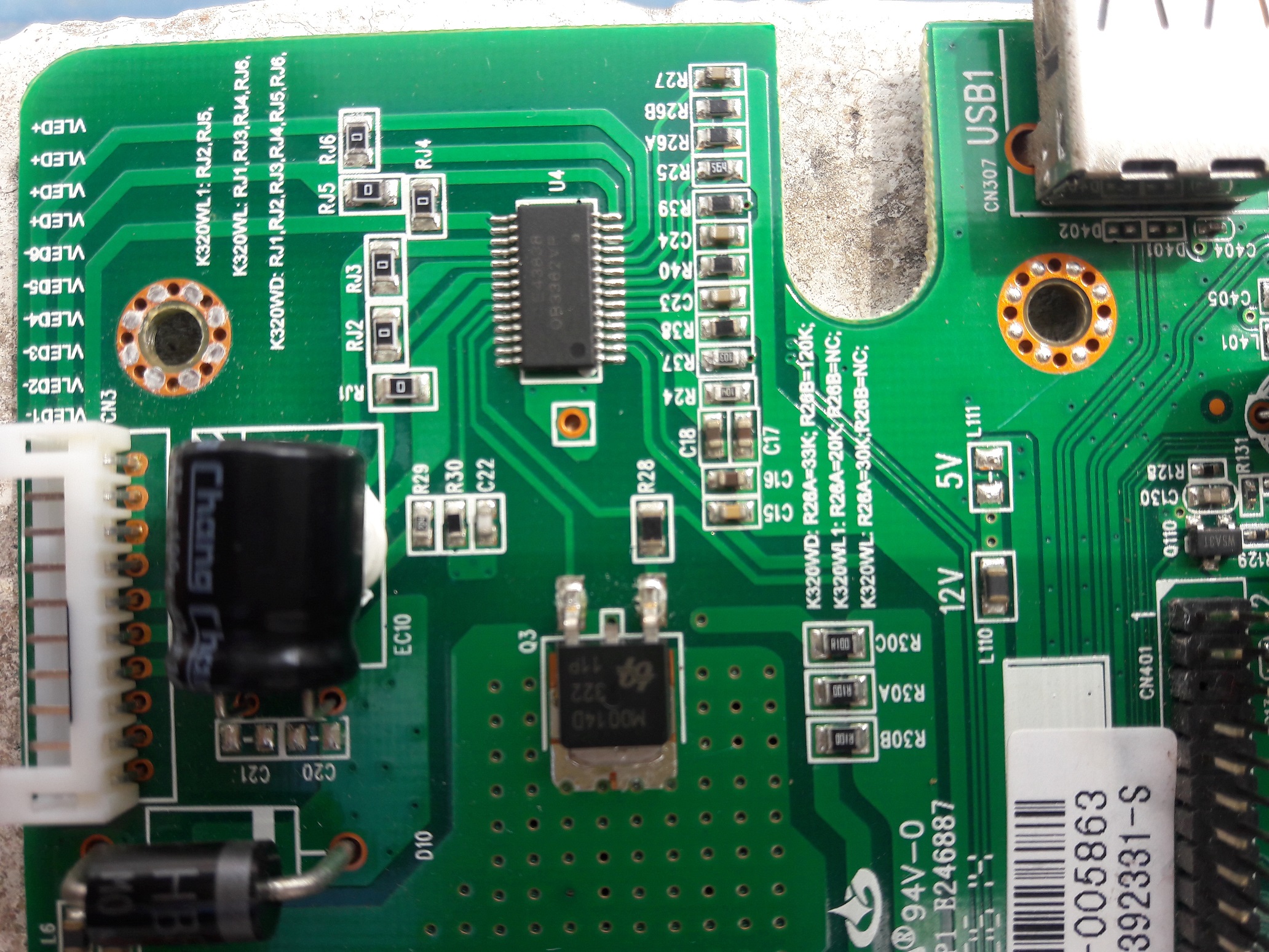

    The issue just pop-up while running normally... all of a sudden display went off... but still sound works... used a flash light and could see picture so Panel / TCON status is Good also I open the Panel and tested each LED and all Good. so issue should be with in LED driver.

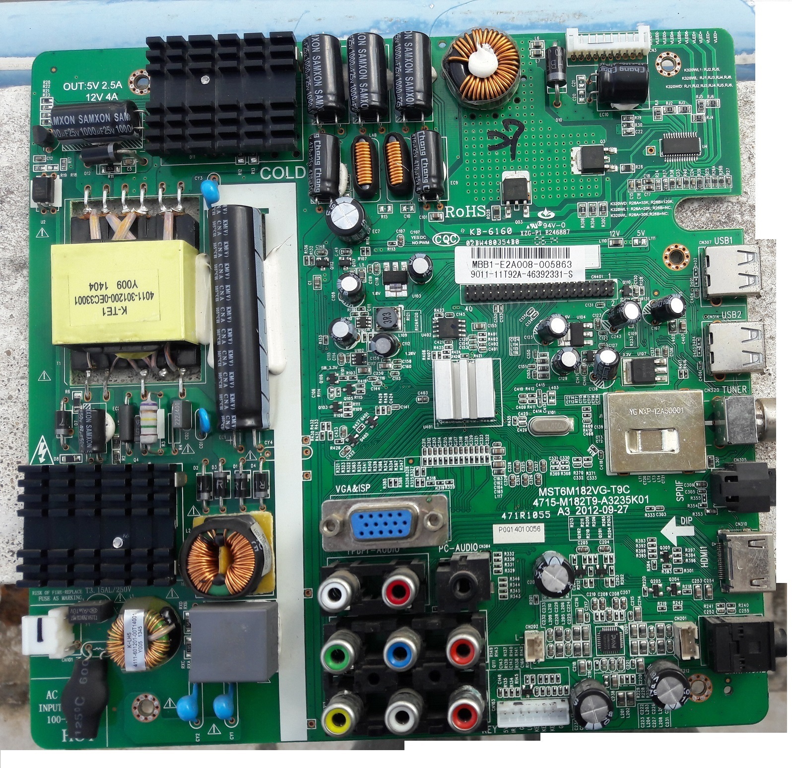

    Philips 32PFL1335 (LG panel K320WD2)

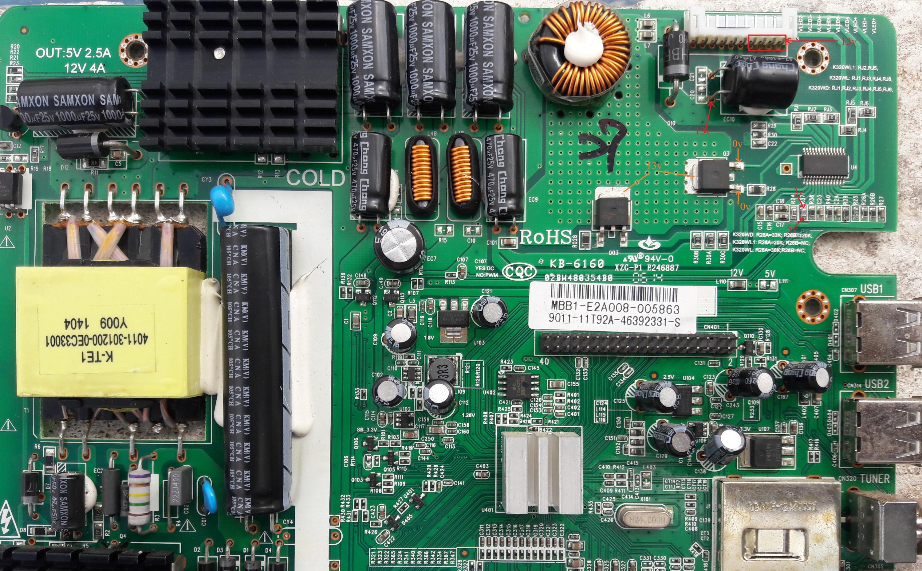

    I have attached the picture of boards and SCH from chinese version.
    DMM reading
    Vin - 5v
    EN - 3.3v
    VLED+ 13v
    Gate - 0v
    CS - 0v
    EC10 - 13v
    D10 - 13v
    Q3 - Source - 13v
    Q3 - Gate - 0v
    Q3 - drain - 0v
    can someone help please.
    Re: Philips 32PFL1335 No LED Backlight
    1) TV OFF, leaving all the connectors in place.
    2) Put the DC Volt meter probes on the two legs of the cap EC10.
    3) Turn on the TV and look at the meter to see how high the Voltage jumps up to before it goes back down to 13V.

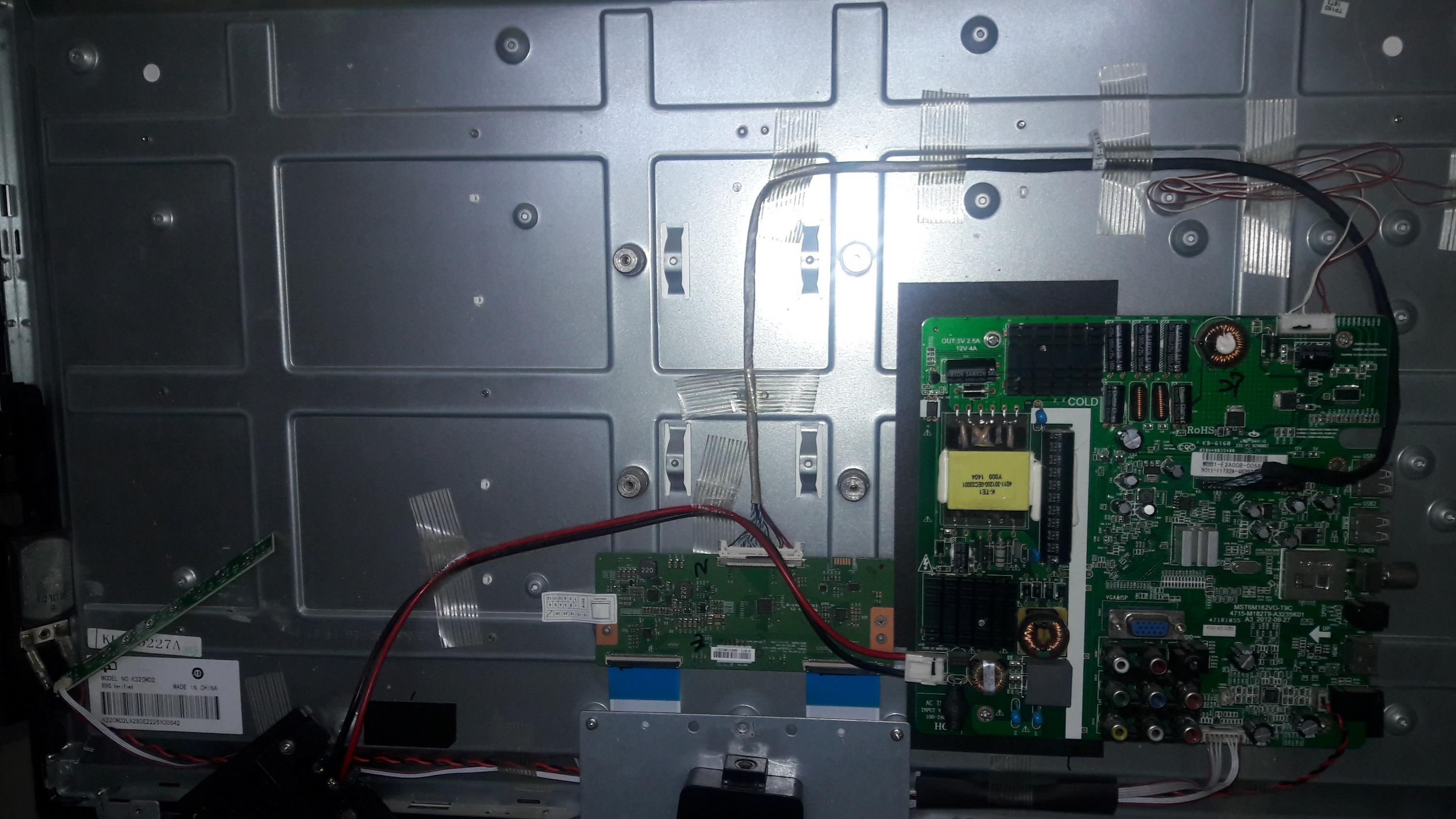

    4) We also need the pictures of the whole back side of the TV showing all the boards and how they are connected together.
      EC10 reading jumps upto 15v and back to 13v. Full read picture attached.

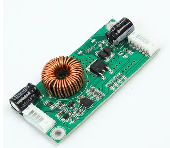

        i'm thinking to add LED driver board...any recommendation please...
