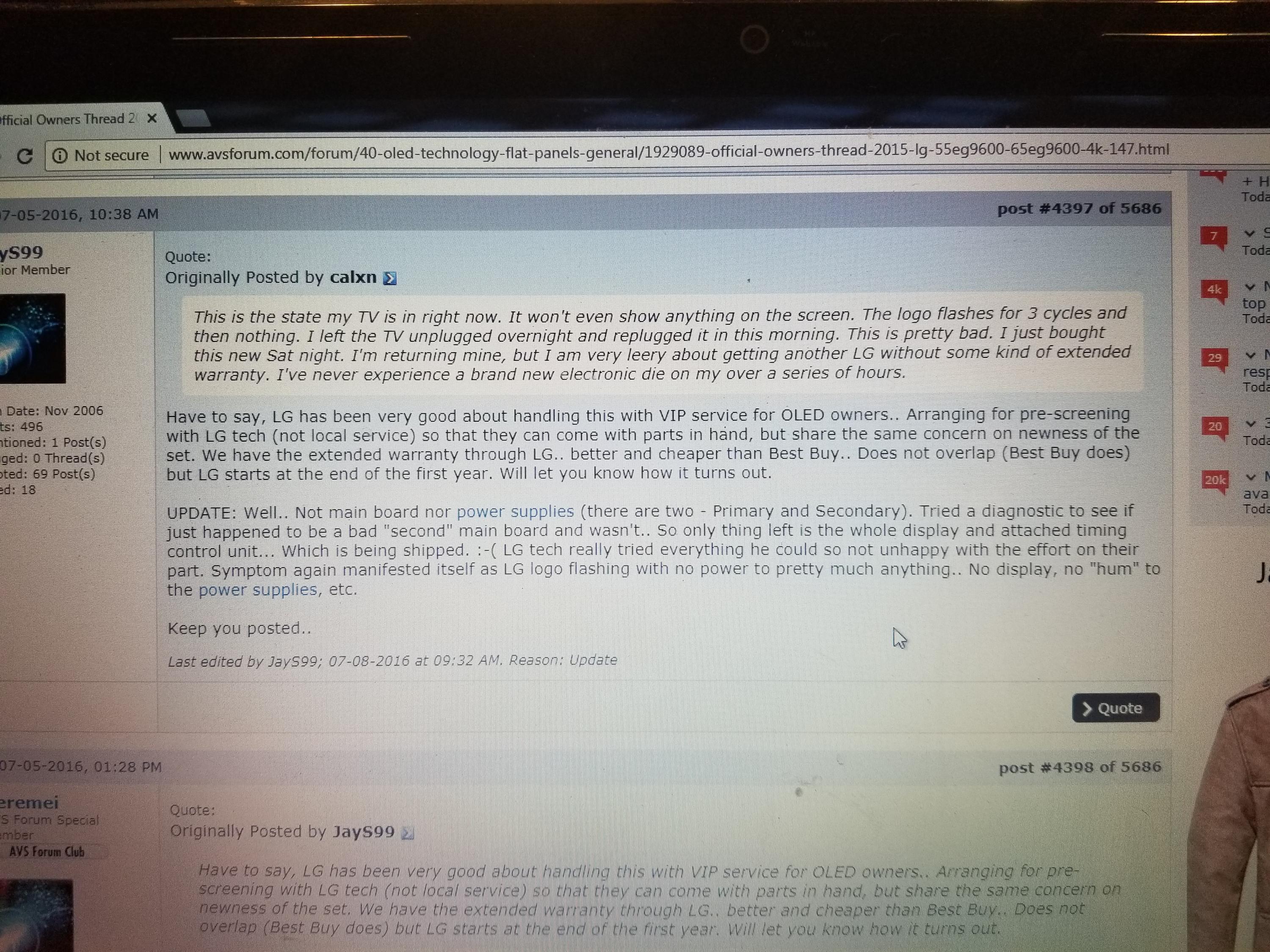

                                    Interesting read from someone else that had an issue with this set over on AVS.
                                    According to this guy apparently even replacing the main did not straighten the problem out even for a second when it had a failed panel.
                                    But I2C serial communications don't come up at all Even if the tcon board was reporting a problem with the panel the main board doesn't have any voltages to register this.
                                    Funny how the guy mention that LG is going to show up with a USB boot and load. And also two main boards and no even attempt to power up
                                      Re: Just picked up a 55 inch LG 4k OLED for $50!
                                      Judging by what I'm reading, nothing fixes this issue. Even when an LG tech comes to your home and replaces every board, (twice) and even the panel.. wtf?
