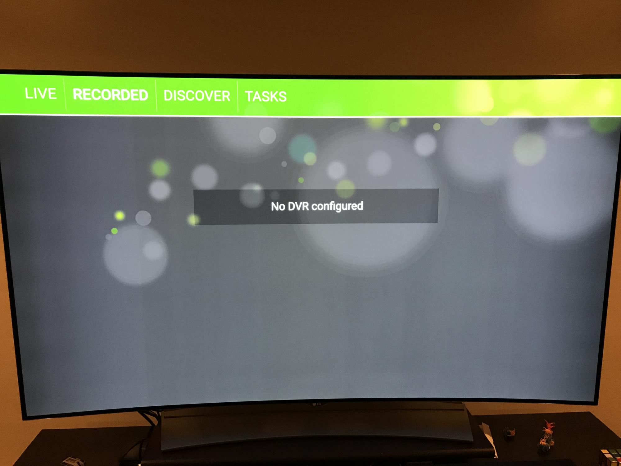

                    Can you provide a picture of what you are seeing on the screen?
                      Re: Just picked up a 55 inch LG 4k OLED for $50!
                      I've attached an image of the screen as it stands right now. Aside from those circles in the background, that gray is supposed to be fairly uniform. The white splotching is much worse than earlier and cover significantly more area. Also notice the rectangle in the bottom? No clue what that would have come from.
                      On a good note--the regular old menu "return to factory settings" did the trick on getting my software quirks out. Haven't done a long test to see if the video shuts off, but at the very least I can turn the TV on and navigate like a normal person again.
                        Try setting to ISF expert 2 mode, turn brightness to 44.
                        My set actually has that same banding clouding issue when the brightness is turned up. Who knows it might be just something with these UA/UB tcons. Although I can't personally vouch for how the TV looked before the tcon replacement since I didn't have a chance to see.
                          thanks, seems to help some. it was definitely too bright before

                            UA-to-UB Upgrade complete! The mainboard was the issue. That $20 untested mainboard was a good gamble--it works like a charm. Certainly better than the $120 "fully tested and functional" mainboard.
                            While I was in there, I swapped out the T-con for another, just to see if I got any improvements. It has less clouding, but similar dark streaks on the side, and that image retention square is still there and I still can't figure what it'd be from. It's a bit distracting during lighter gray scenes, but passable.
                                          Well this is a pleasant surprise. The streaks and spots have gone away. There's some minor vertical banding but it's much less distracting.
