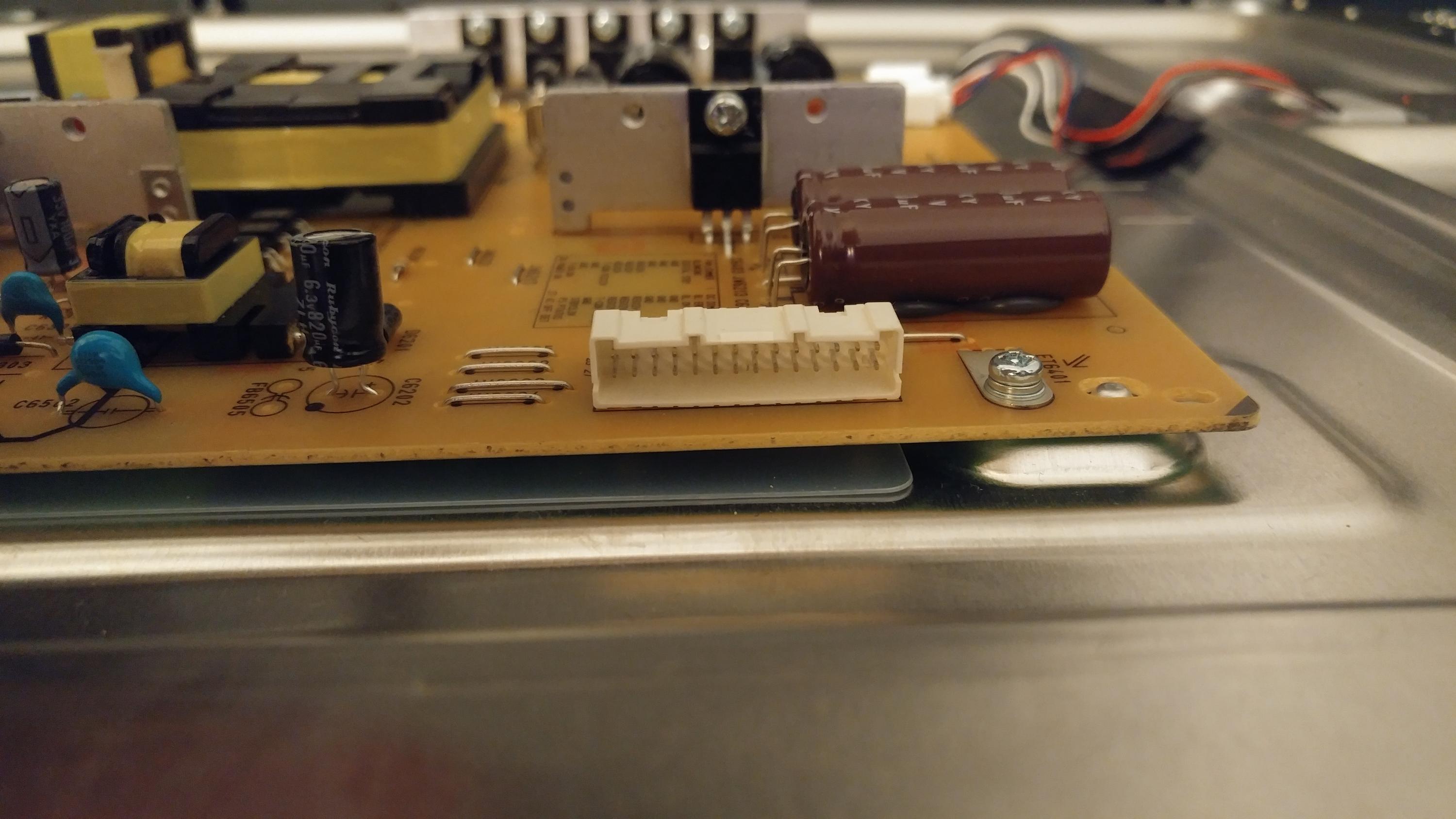

    I'm trying to diagnose my LEDTV's no power issue. For reference, the TV is not powering on, no standby lights or blink codes, no relay clicking, just nothing. The PS has 3.3v standby voltage and my bridge rectifier is reading in spec.
    I'm following the standby voltage (3.3v) but the mainboard is evidently not sending any signal back to my powersupply to enable the rest of the pins because the rest of my 12v rails don't have any power. If I use a jumper across "POWER ON" and "AC OFF DET", the 12v pins all get a solid 12.5v.
    Testing continuity, I find the 3.3v arrives at the mainboard but when I test the correlating via to see voltage, I get nothing(0.002vdc). So there is continuity to the bottom of the pcb but nearly zero voltage. Shouldn't I be able to see 3.3v on the via?
    Something I noticed though was when I unplugged the cable running between the power supply and the main board and ran a lead directly between the 3.3v pin socket on the cable to the male pin on the mb socket, I was able to read 3.3 volts on the via! It confuses me because my meter shows continuity through the cable to the via, but the voltage is getting lost somewhere. So, either the male or female socket/plug may be bad?
    I can't figure out the next step without being able to follow the 3.3v rail to see why nothing is coming back from the mainboard. I want to eliminate the power supply completely. All the caps look fine, the fuse is fine, nothing appears damaged or shows signs of ever getting hot, no smells, nothing obvious.
    I've looked at the service manual but it is a little difficult to follow. The procedural methodology seems like it should make sense but it has me frazzled.
    I'm trying learn something here and prevent adding to the floating garbage island. I can't see any reason why this piece of technology should be wasted.
    If you have any suggestions, I'd appreciate them. Should I be looking into the power supply further or does my assertion of the fault being at the mainboard seem accurate?
    Here are a couple reference photos of the boards(not my photos but this is my exact board revision/model).

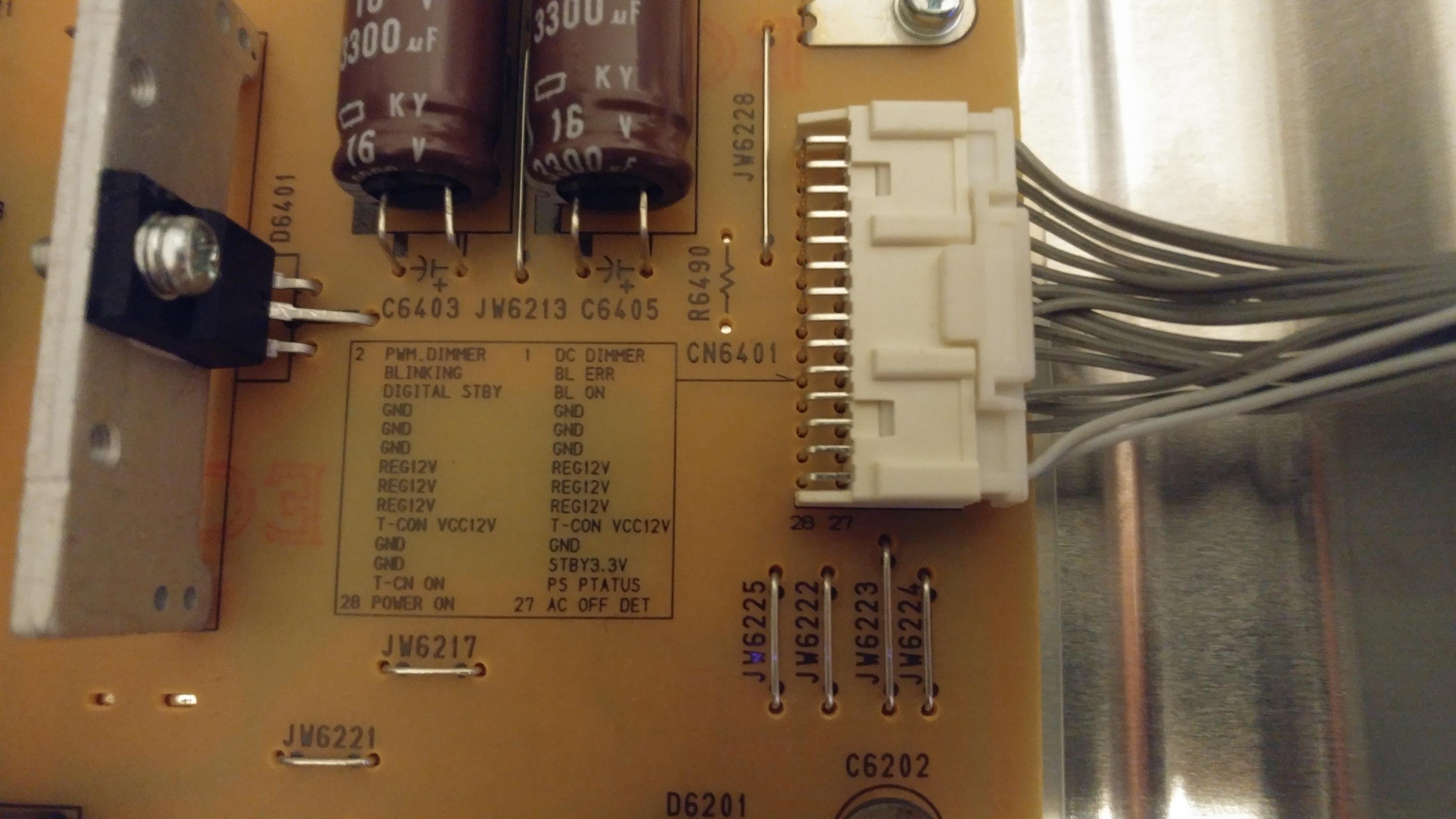

    Post a close up shot of the connector and pin Nos. to the Maun Bd. On the PSU photo it is the top right section. I may be able to guide you into doing a PSU 'self-test'.

      Is this what you need?

        Additionally - Is there a way to test my LEDs using the PSU alone? I'd like to eliminate them being an issue while I'm testing the PSU.
        I've read using a 10k resistor between the 3.3v Standby and Power ON and another 10k between the 3.3v and BL ON should turn them on, but I didn't get anything.
        • Andrew F. Ali
          • Jan 2014
          • 2450
          • Trinidad & Tobago
          Re: Sony KDL-55W802A - No Power. Help?
          SELF-TEST Procedure:
          1. Unplug TV from the ac.
          2. Disconnect connector CN6401 from the Main Bd. and the Backlight connector.
          3. Solder/connect a 1Kohm resistor across pin 23: stby 3.3V and pin 28: power on. (Be careful not to short to other pins)
          4. Plug in to ac.
          5. Measure voltages on pins 13 to 18,to confirm you have 12V.
          6. Leaving the 1st 1Kohm resistor in place, Solder/connect a 2nd 1Kohm resistor across pin 23: stby 3.3V and pin 26: Tcn on. Be careful not to short to other pins)
          7. Measure voltage on pins 19 and 20 to confirm 12V.
          8. Connect a 3rd 1Kohm resistor across pin 23: stby 3.3V and pin 5: BL on. Be careful not to short to other pins)
          9. Reconnect the Backlights connector.
          10.Plug in to the ac.
          11 Observe if Backlights come ON.
          Let's assume you have ALL your 12V correctly and the Backlights do come on and stay on. Then we can safely say the PSU is GOOD.

              I just completed this test.
              Jumping 3.3v and Power ON enabled all voltage correctly, both T-CNVcc12v pins have 12v. I jumped T-CN ON to 3.3V, BL ON to 3.3 with 1k resistors and voltage is traveling to them but I have no backlights.
              Does AC OFF DET need to be signaled? Shouldn't there be the equivalent of "Power Good"? Does GND need to be signaled?
              I appreciate your help so far. I'm hoping I'm just missing a step to enable the LEDs. I assume they work in "sections" I should be seing at least partial LEDs lit if there was an issue, wouldn't I?
