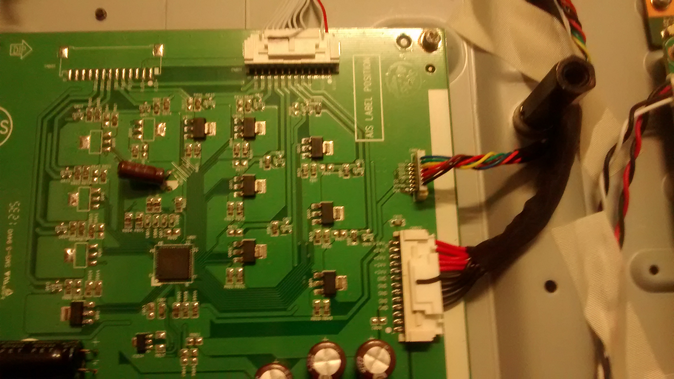

    looking at the LED driver board i see 42v on the two LED+ pins and 11v on all the others (i dont understand how this LED board works. used to seeing vled+ and vled- on other boards)
    but the board is getting the right power (24v) from the psu....

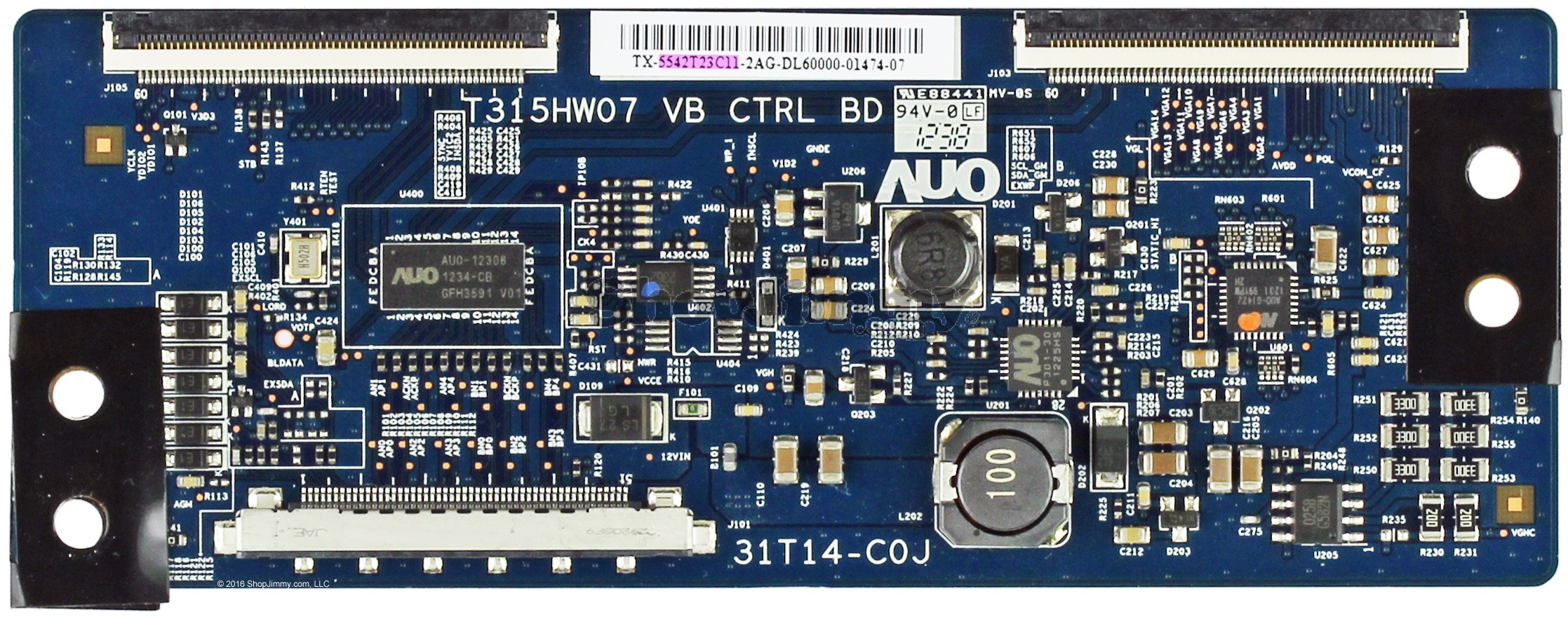

    Re: VIZIO E420i-A1 no backlight
    https://www.badcaps.net/forum/attach...0&d=1511742089

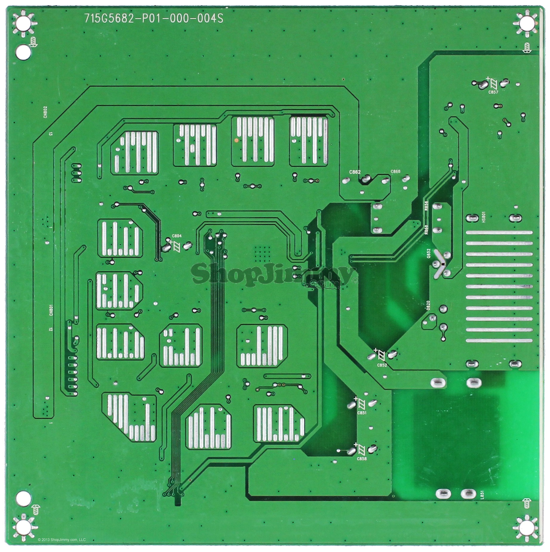

    You have 8 strings of LED thus 8 SMD PWM controlled MOSFETs
    All 8 strings of the LED Anode are connected to the VLED+
    FB1 ~12 are the Cathode return for for each LED string which is connected to the Drain pin of the MOSFET.
    For example FB2 is connected to the Drain pin of the Q801.
    The boost converter takes the 24V and boost it to higher Voltage, 42V boosted Voltage seems low to me, but since you have LED tester that will also show the Vf of the LED string then you should find out the reading will show on the tester.
    So remove the LED connected and probe between the VLED+ and each FB pin to see what you get.

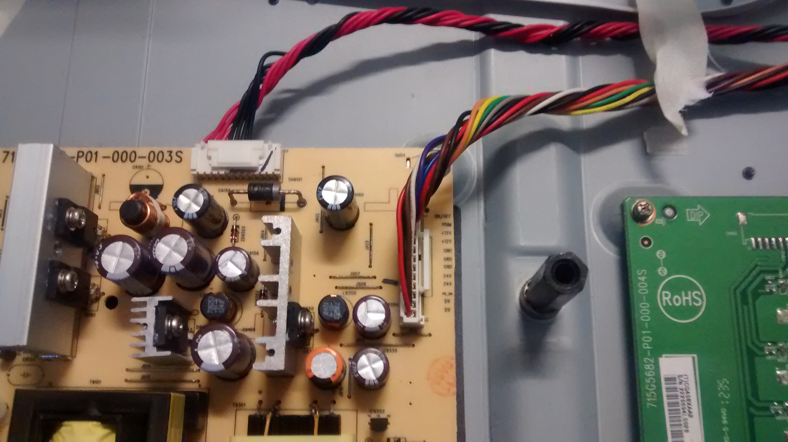

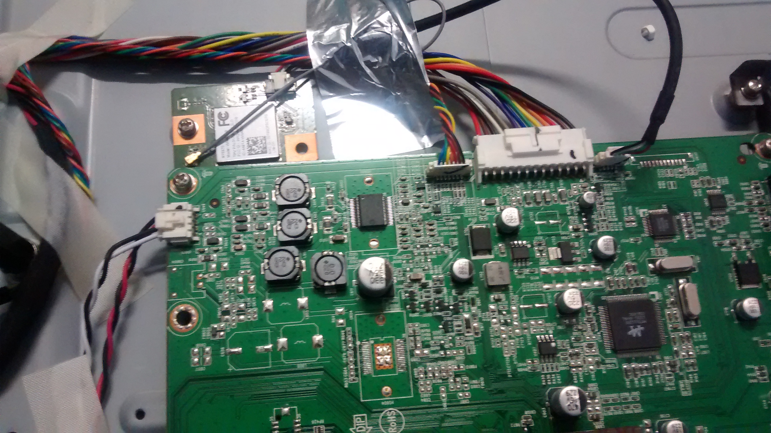

    We also need the pictures of the whole backside of the TV showing how all the boards are connected together. We need to see where the connector CN804 of that LED driver board goes to.

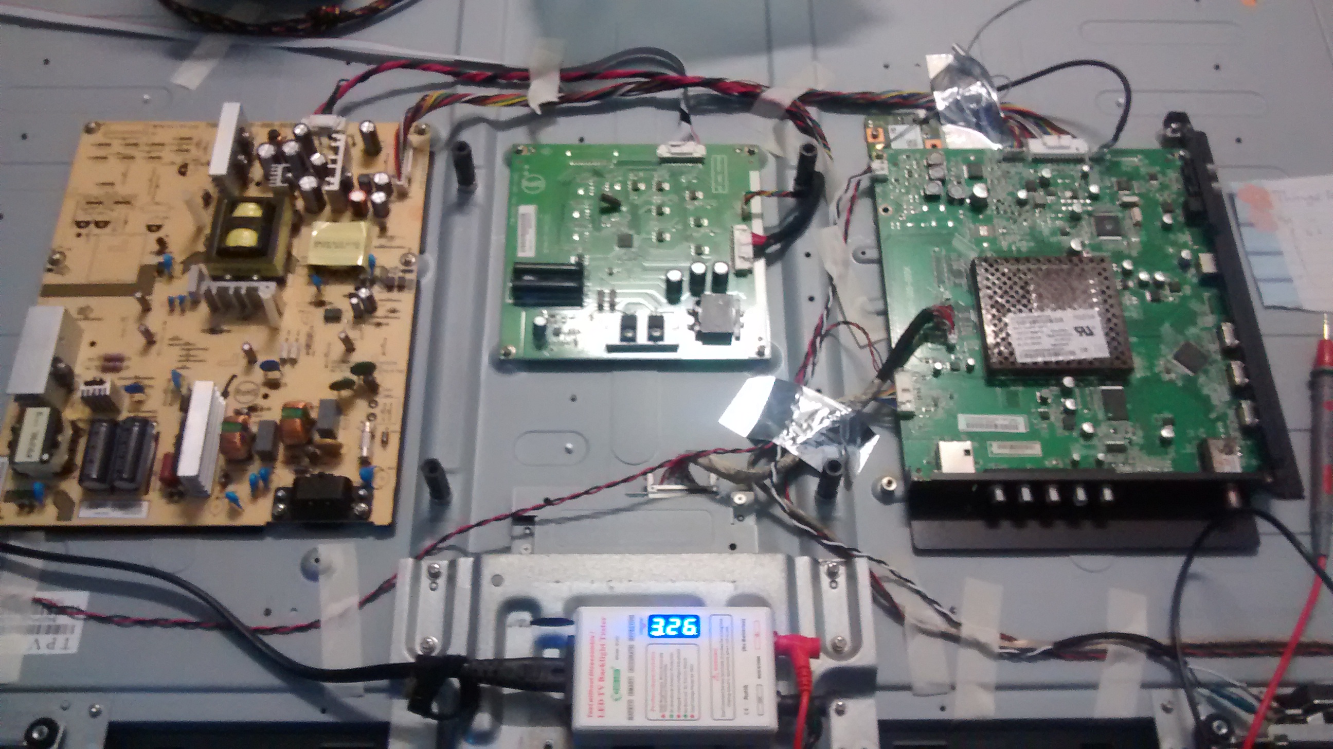

      i used my LED tester (pictured in attatchments)
      and put red probe on v+ and moved black probe from each fb1 thru fb9
      on fb9 i saw 90v and the LED's lit up
      on fb8-1 i saw around 36.5 on each
      not sure what to make of this but of course i have questions...
      what does FB stand for? and why are there 9 of them if it only has 8 strings? also why are there 2 v+ ? are they the same line actually? i got same result whether using one v+ or the other
      hope this helps
      thanks!
        FB = FeedBack.
        There are only 8 SMD MOSFETs for 8 strings of LEDs.
        FB9 does not have any connection and no MOSFET Q808 is installed for FB9 as you can see where the trace for FB9 goes.
        The two V+ are tied together as you can verify by checking the resistance between the two pins.
        So the Vf of the LED string is about 36V, then I expect the boosted Voltage to be higher than 42V range.
        There are two lytics caps laying on its side on that LED driver board, what are the Voltage rating as printed on the body?
        At this point it does not look like you have LEDs problem.
        BTW, what is the LCD panel model number as shown on the sticker on the LCD panel?

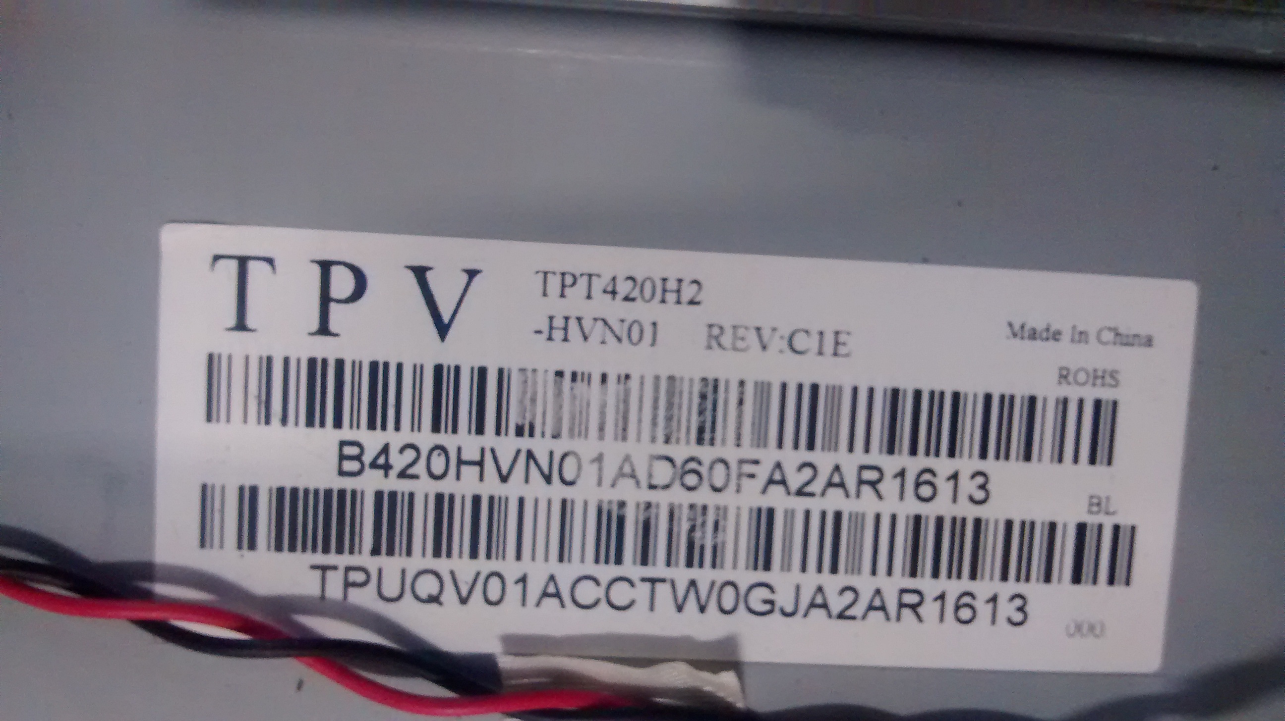

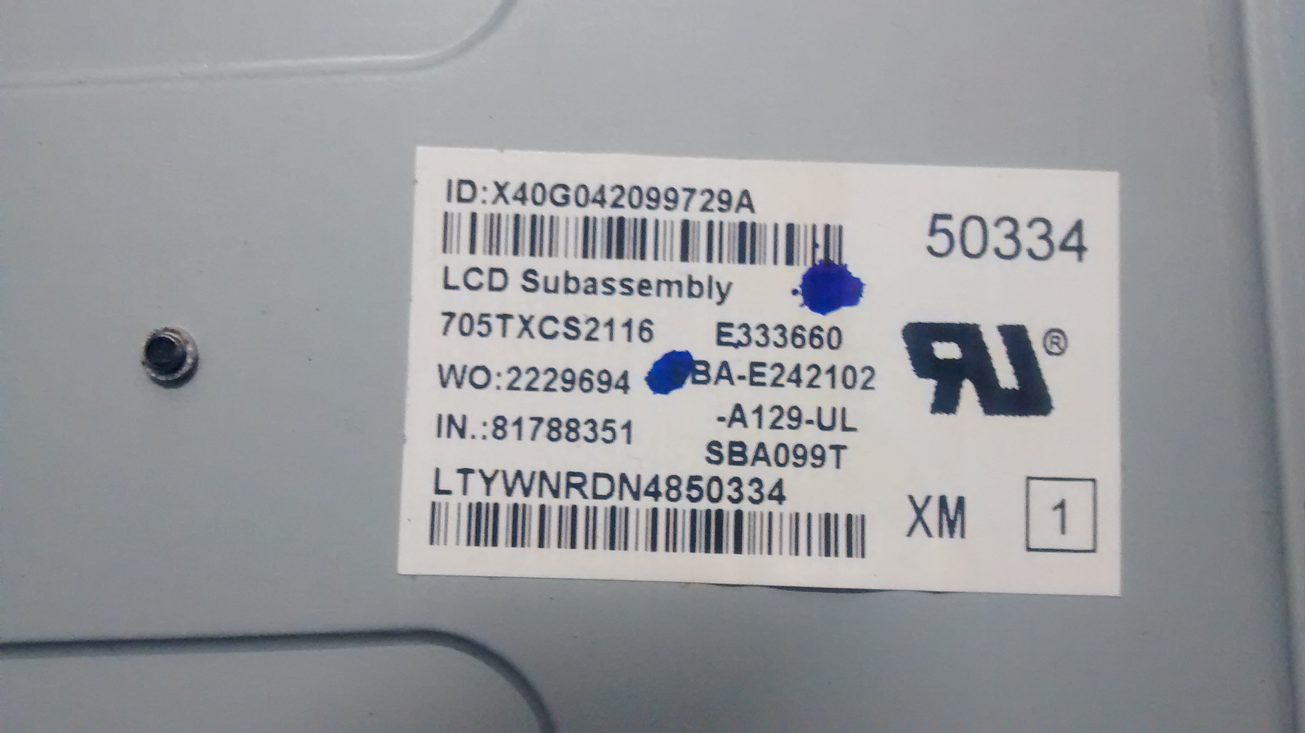

          edit: i added pictures of the panel stickers:

              I found the info about your LEDs strips.
              http://www.shopjimmy.com/tpv-tpt420h...ps-1-board.htm
              LED strips for your LCD panel TPT420H2-HVN01
              The panel has 8 LONG LED strips, 8 SHORT LED strips.
              LONG strip has 7 LED + SHORT strip has 7 LEDs so one LED string has 13 LEDs.
              So it has 8 strings of LEDs.
              13 LEDs x 3V = 39V fully driven (300~400Ma typical) (you are getting 36V because the LEDs are driven at may be only 50mA so the Vf is lower than 39V).
              My thinking now is that 42V at VLED+ is too low.
              The complete boards set is about $50~60, the LED driver board is $19.

                im confused. if the strips want 39v why does my LED tester stop at 36? not entirely sure how my LED tester works
                i tried disconnecting the the small connector from the led board, and it didnt change anything. that connector goes to the mainboard. there is only one cable going to the TCON and its from the mainboard, and i tried disconnecting that as well, still no change

                  The Vf of the LED will be less than 3V at 50mA of current flowing through the LED using the LED tester. The LEDs in the TV is driven at 200~300mA or more, lots more than you tester.
                  If you look at the LED spec Vf VS If chart you will see why that is.
