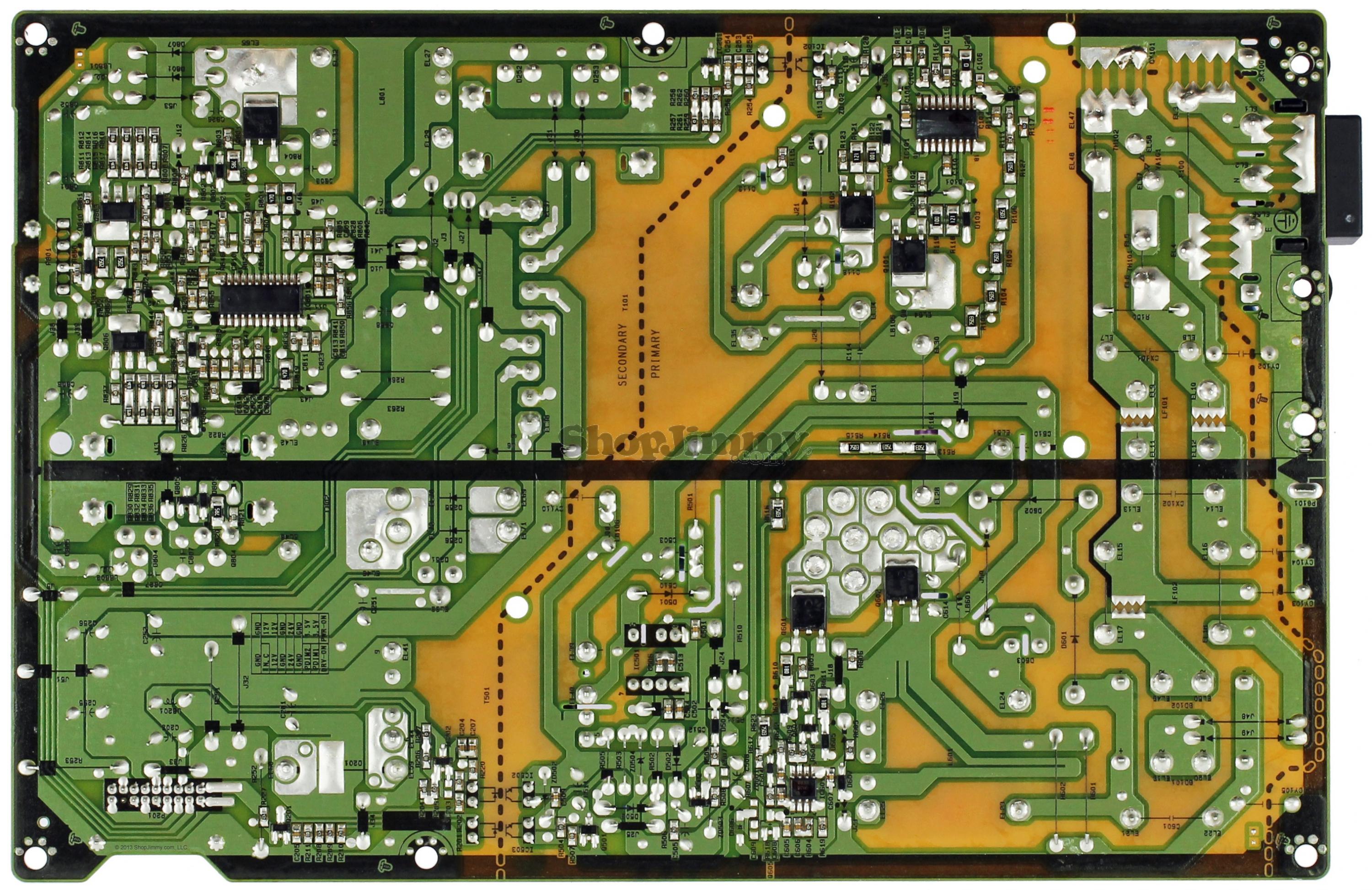

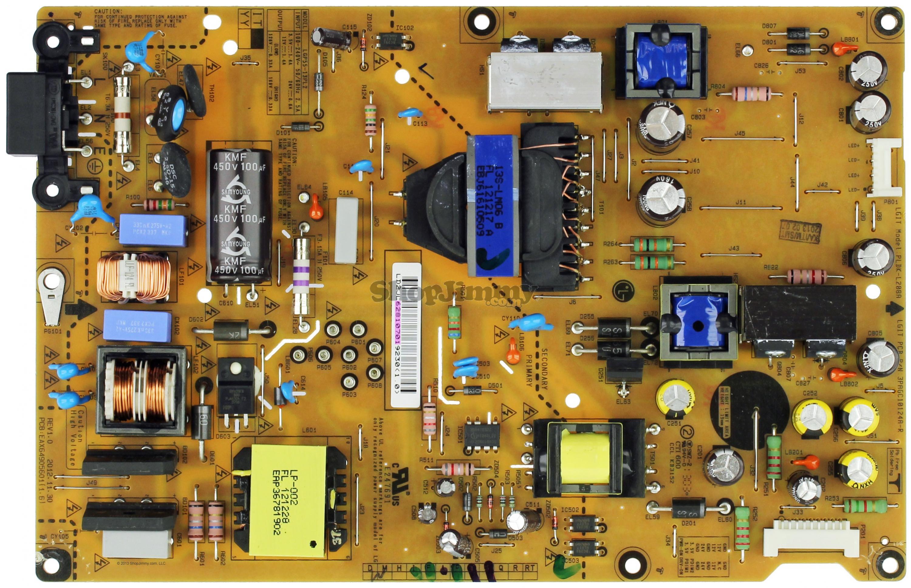

                    Can we see the whole pictures of all the LED strips instead of partial pictures?
                    Also need straight shot pictures of the bottom side of that power supply/LED driver board.

                        can you also remove the power supply and take a picture of the underside of it so we can see the traces etc

                          This looks to be your board:
                          http://www.shopjimmy.com/lg-eay62810...upply-unit.htm
                          LG EAY62810701 (3PAGC10124A-R) Power Supply / LED Board.
                          Pictures provided by shopjimmy.
