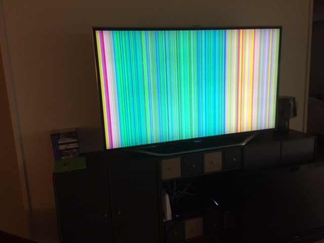

    Hi All
    This huge TV had its mainboard replaced in June 2017 ( HDMI input failed ) - the mainboard was new, not a used replacement from Ebay or similar. Worked great since then.
    Now, the owner sent me this picture ( see attachment ).
    And of course the TV runs wothout any issues after moving it to my place
    Anyone with any clue what the most probable issue could be ?

    Re: SAMSUNG UE65ES8005 with colored horisontal lines
    FYI it is the mainboard. TV started failing after 3-4 hours use, rebooting and displaying the horisontal lines.
    FFreeze spray on main processor and the issue goes away.
    Another mainboard..............
      Check PSU ripple, can be the main culprit..
        Thanks - but I already checked PSU, all voltages are corret, and ripple seems OK.
          what is de BN 94...... number of the mainboard?
            Bn94-6197r
