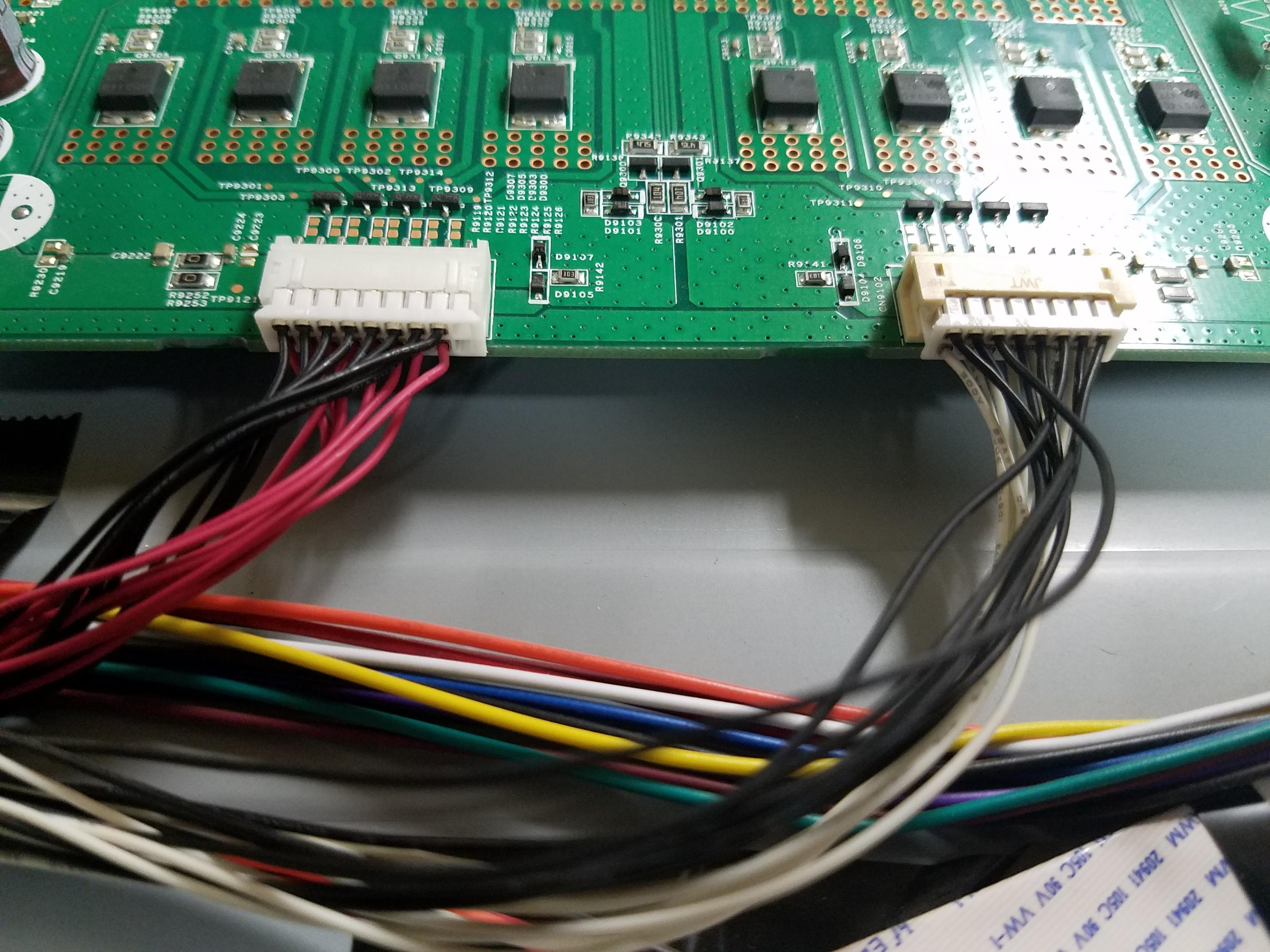

    Started inspecting a d65u-d2 for losing picture while watching. Using a flash light I was able to determine a backlight issue. It could take 5 minutes or all day. Once it does it you can get it to repeat fairly quickly. Every time you shut off the tv and turn it back on the lights come back on atleast for a minute. Since I knew it was a lighting issue I started testing at the inverter board. All voltages into the inverter board tested the same when the backlight were on or off. Voltages out did vary. With or with out the back lights on the White and Red pairs of wires all tested around 24 volts. With the back lights on the black wires vary between 3 volts and .5 volts. With the backlights off all but one carries 6.8 volts. The 3rd black wire in from the left on the left connector continously varries voltage.
    I suspect bad led strips. I believe the led is getting warm and shorting out. Any opinions?

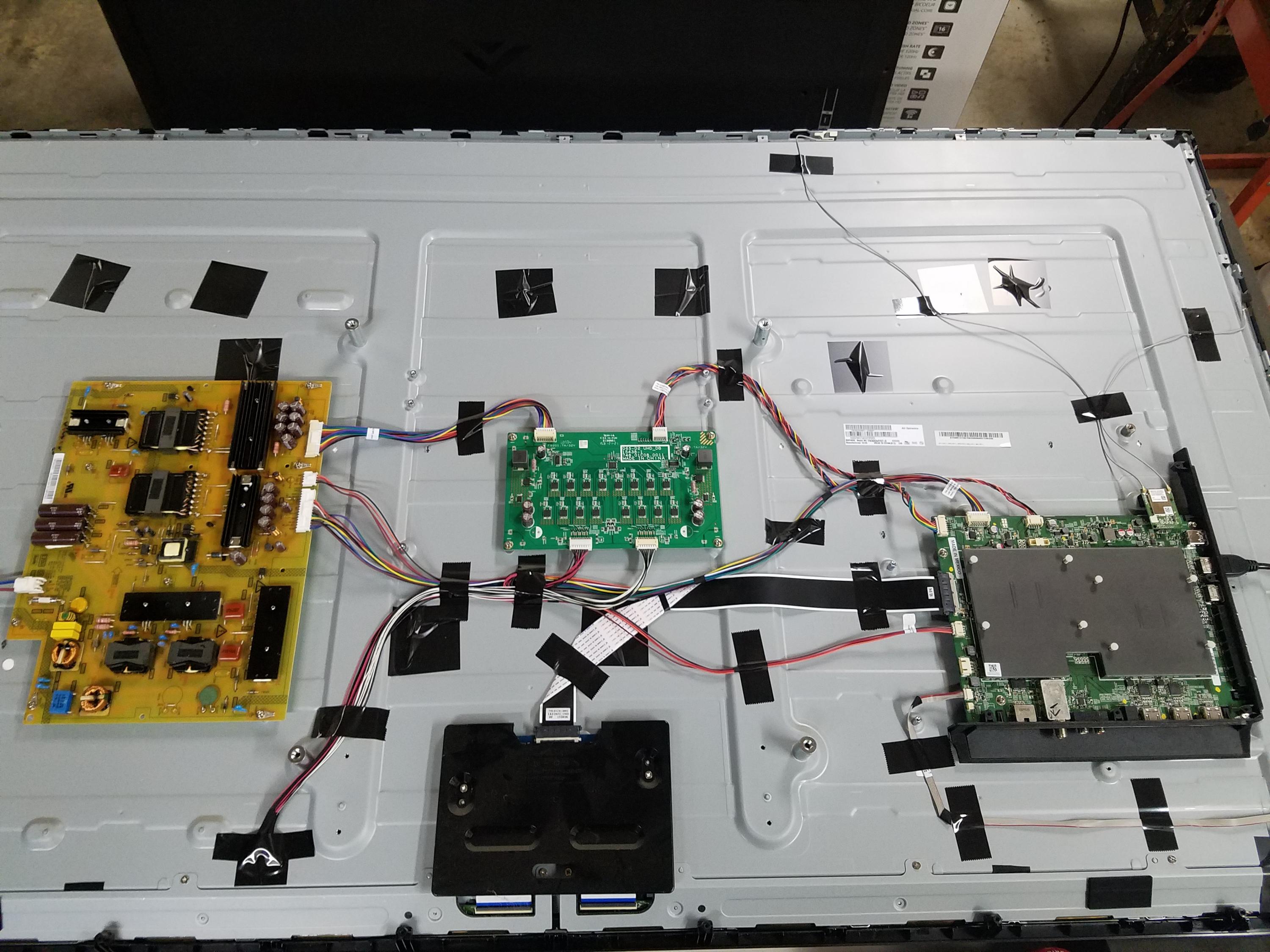

              Have one with backlight only staying on if turned down really low (like 30%) much brighter will cause the backlight to shutdown.
              Ran a youtube white screen test and 1 dead row of LED was visible.

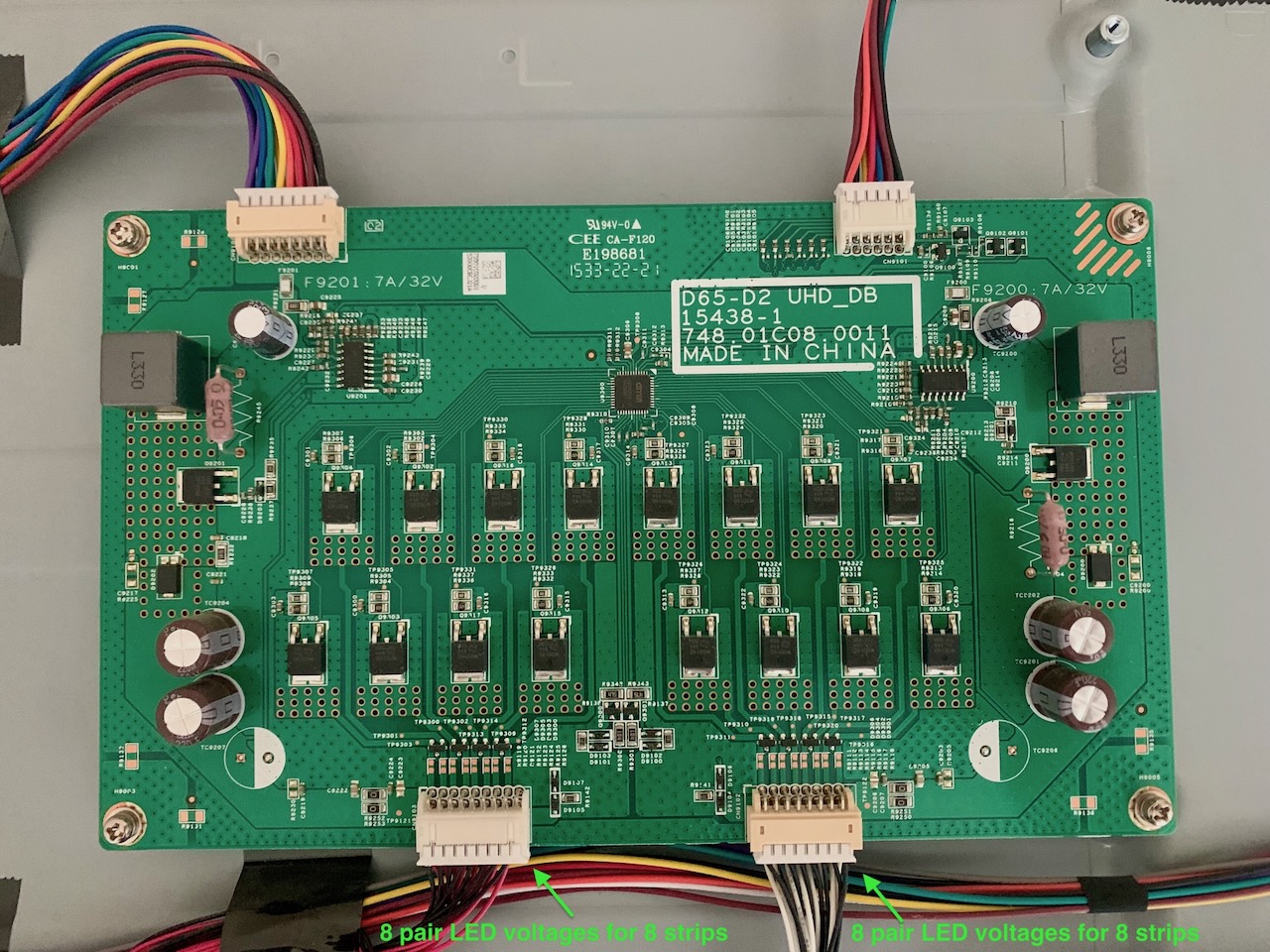

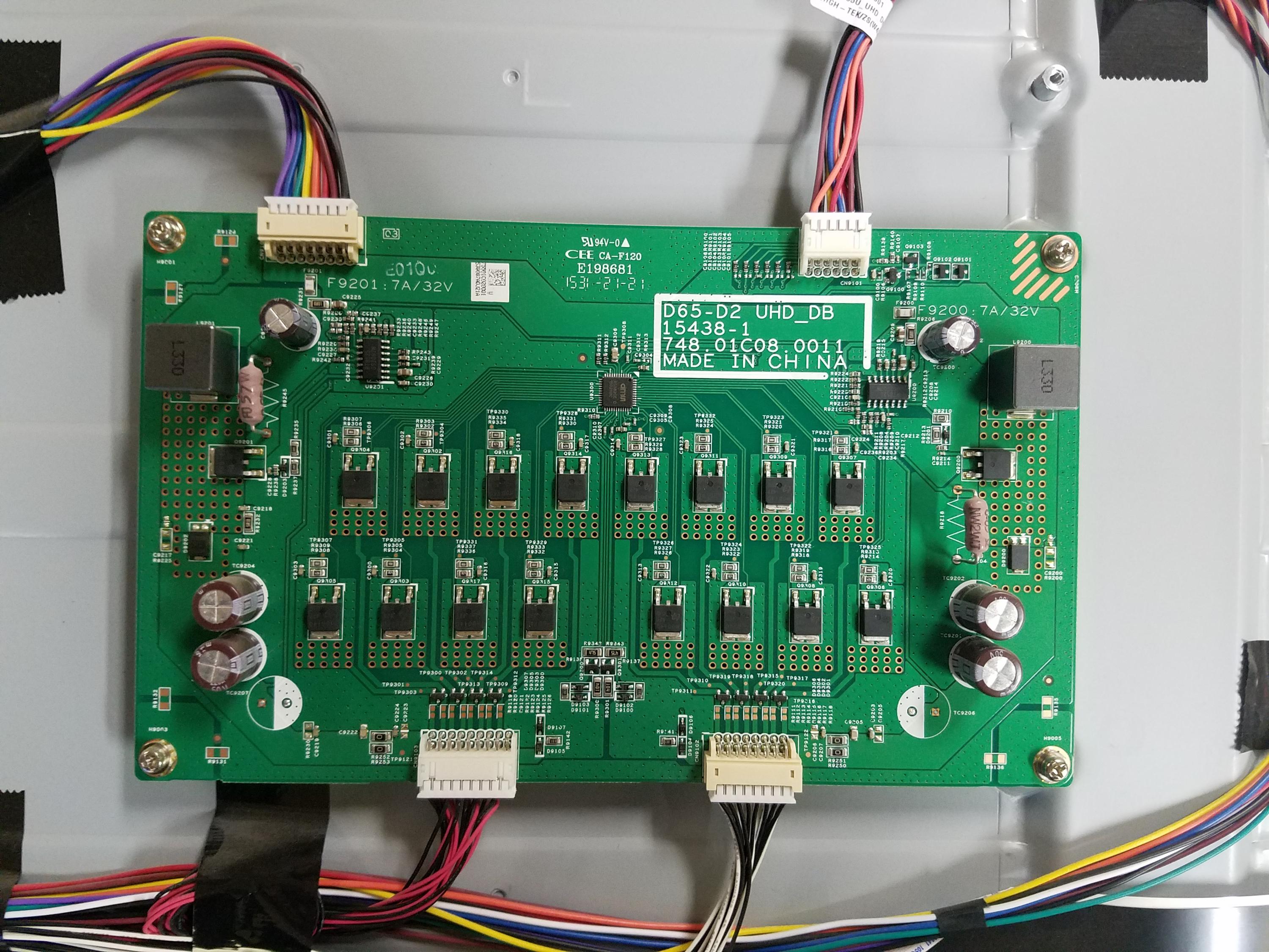

              This TV has 16 LED strips (8x 3V LED each strip). Have a LED driver board that supply voltage to all 16 strips independently with 2 connectors. Each connector responsible for 8 strips and 1/2 of the screen. Can use a LED tester to confirm bad LED strip and not the driver board at these connectors.
              LED driver board will also allow TV to run with 1/2 screen of backlights. Useful for debugging.
              Replaced all 16 strips (new strips were slightly brighter and I suppose will last longer than keeping the old strips that are still good)
