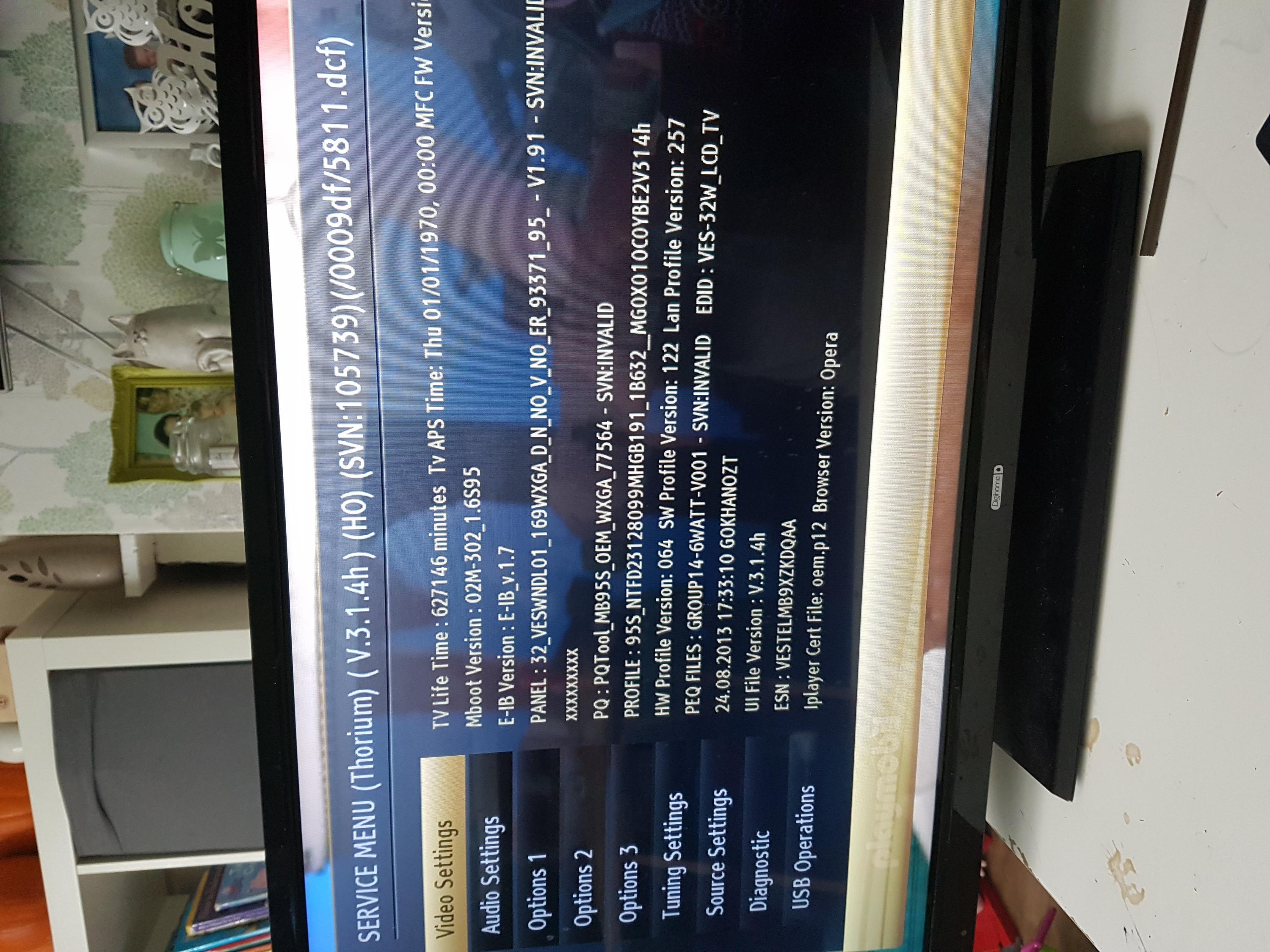

    Can anybody find the firmware for this set? I've attached a photo from the service menu with the relevant details! Thanks! I've flashed the wrong firmware attempting to fix it and now the picture is messed up upside down and unusable!

    whats the actual make and model number of the tv it maybe easier to find the firmware that way

      its a DIGIHOME 32180sm.. mainboard is 17mb95s-1 ( vestel)... Panel number is VES315WNDL-01

        hi i could not find any firmware for this tv but i did ask on another forum although this is for a toshiba set it should still work ok on your tv as its the exact mainboard and exact panel number so try at your own risk if you want heres the link

          just wondered if you have managed too try this firmware if so did it work?
