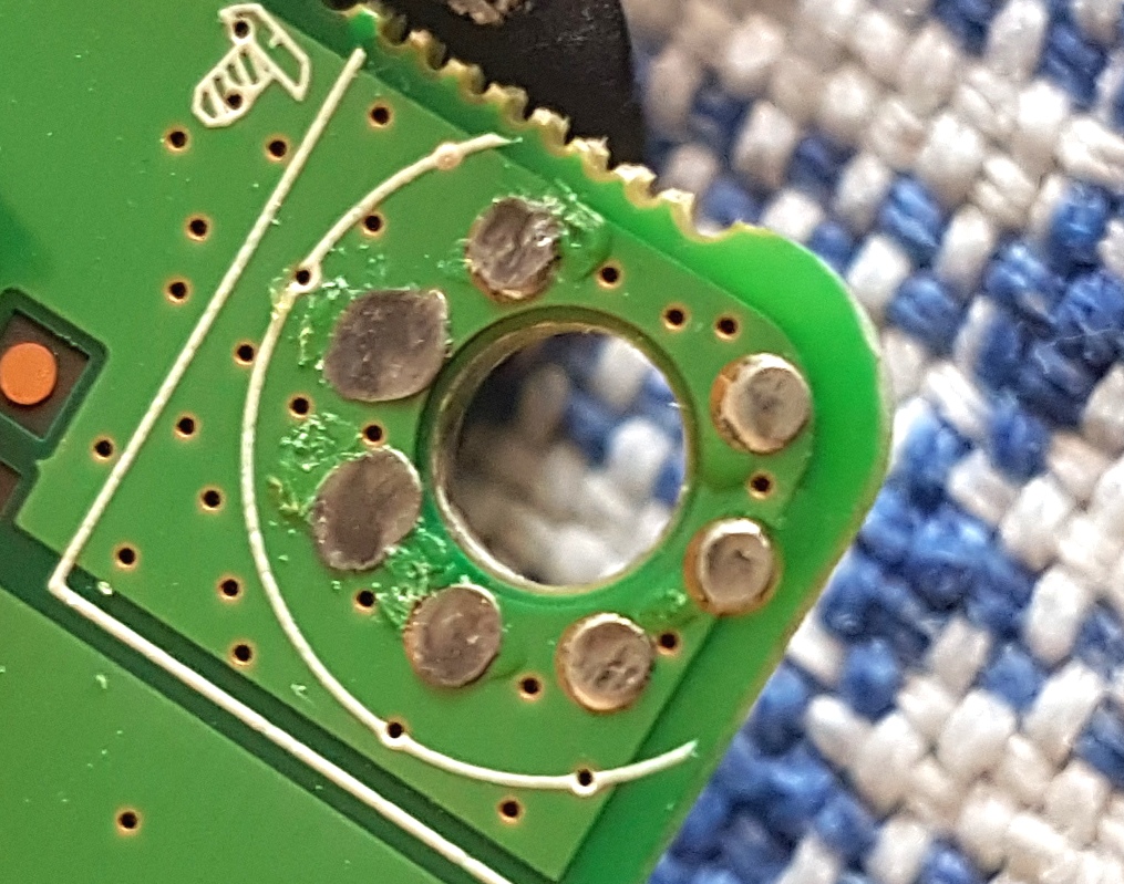

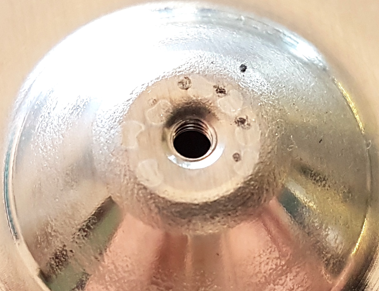

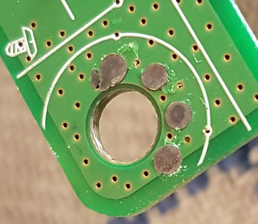

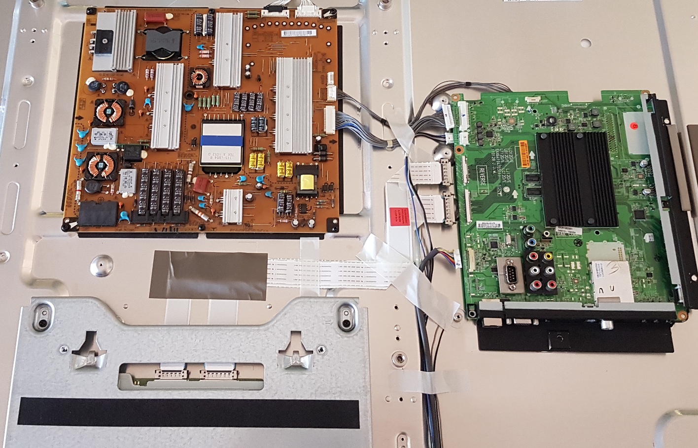

    I was given this TV (55lv5500) that powers on, light goes from red to solid white.
    No picture and no sound.
    I got it apart and was removing the mainboard to start further testing and a possible reflow of the processor, and noticed the screws that mount the board to the chassis were very loose.
    Does anyone know if these mounts are the main earth point for the board and will these making bad contact possibly be the cause of my syptoms?
    Perhaps a clean and refit the board securely before I start pulling my hair out?
    I have not tested any voltages etc as yet, just thought this might be worth trying first.
    I have attached all relevant pictures, and pictures of the mounting points in question.
    Thanks to all in advance. Bout to head out to dinner so will check the thread when I get home.

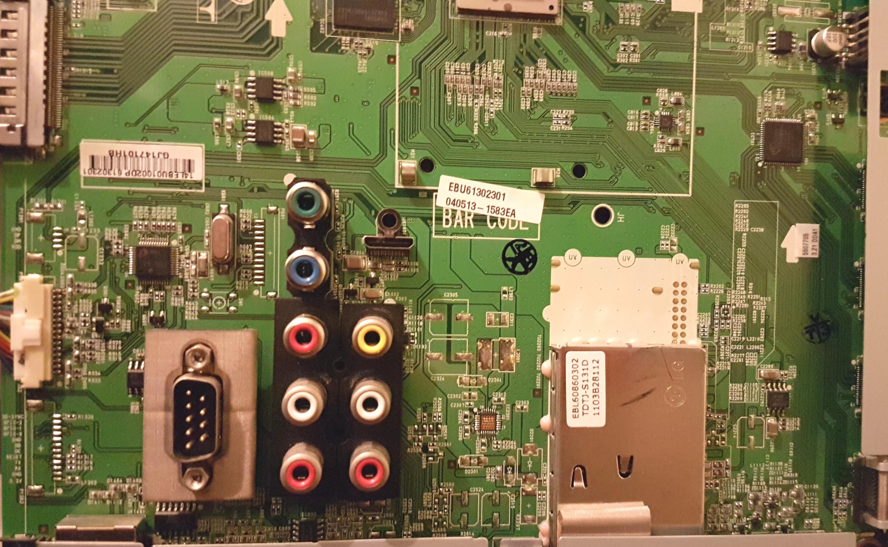

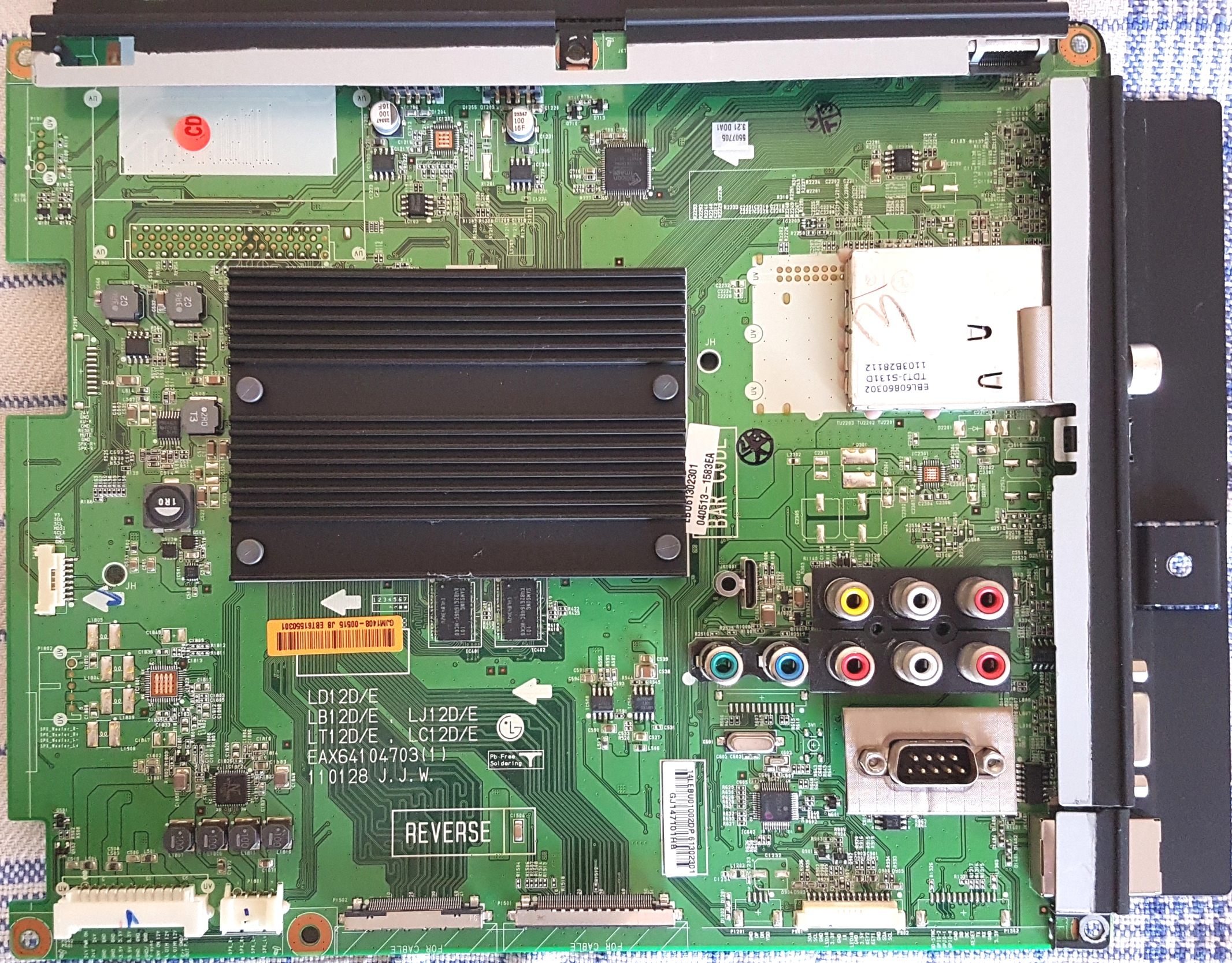

                              Can you take a really good image top and bottom, include any numbers, labels , PCB number etc
                              • Cibby600

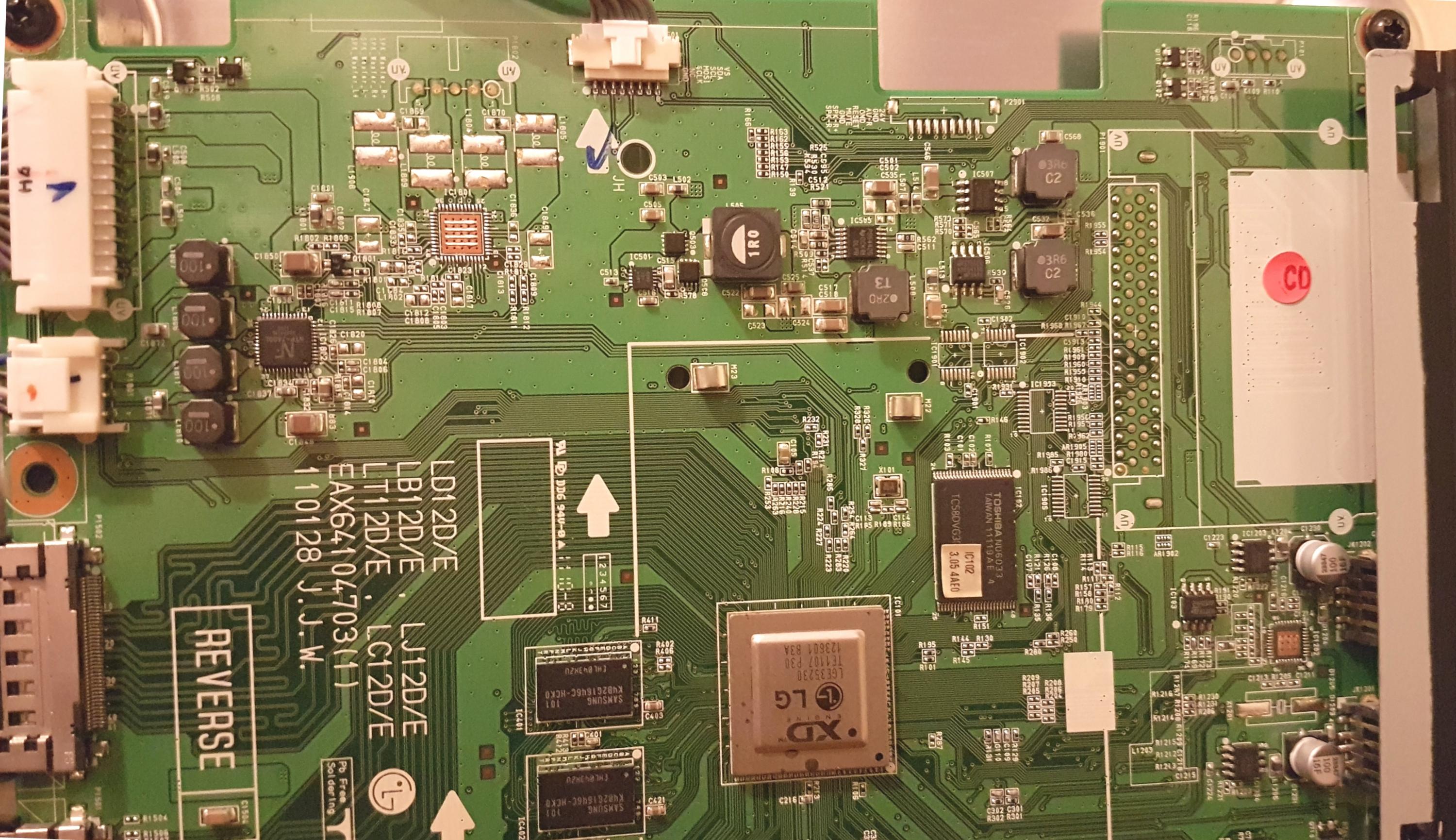

                                  If the chip overheats in seconds for sure it is faulty, very common. For reflowing i would recommend using a usual cooking plate as a preheater, cover any connectors or sensitive components with alu foil and start gradually rise the temp. when the pcb reaches 150' you can reflow at 230-240 for 2-3 minutes. Dont forget rma 218 quality paste. Reballing is another story, if you dont have a new (or known working) chip , all that job is pointless, reflowing will do just fine.
                                  • Cibby600
                                    • Oct 2017
                                    • 24

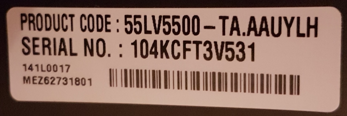

                                    Re: Lg 55lv5500 - ta
                                    Have attached pics of top and bottom halves of the board and a sticker that was on it before it shriveled up whilst I was attempting to reflow the processor.
                                    And the serial off the back of the TV for good measure! lol
                                    Cheers.
                                    • Cibby600
                                      • Oct 2017
                                      • 24
                                      Have tried twice now with a heat gun and temp probe for my multimeter. Second time got to 235c for just over a minute.
                                      I think either the chip is toat or something else is wrong.
                                      Still powers on, light goes from red to solid white. Nothing else happens. No picture and I THINK still no sound.

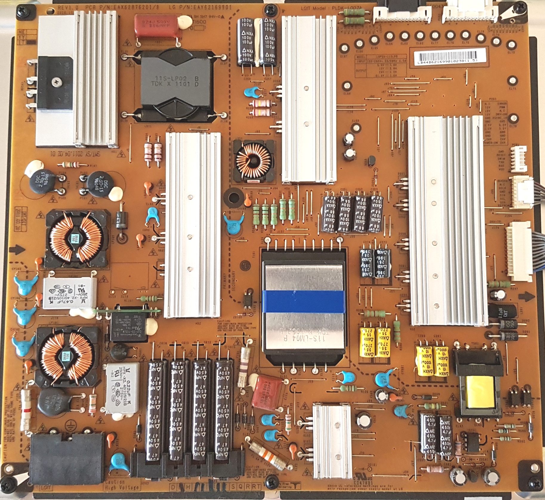

                                        i'm a little curious, you stated that the stby light changes states when you press the power button. what are the voltages on the connector that goes from the ps to the main, in stby and when you power it up. also list pin numbers and pin description, so it is easy to read.
                                        at this point, you have not confirmed that it is a main issue.
