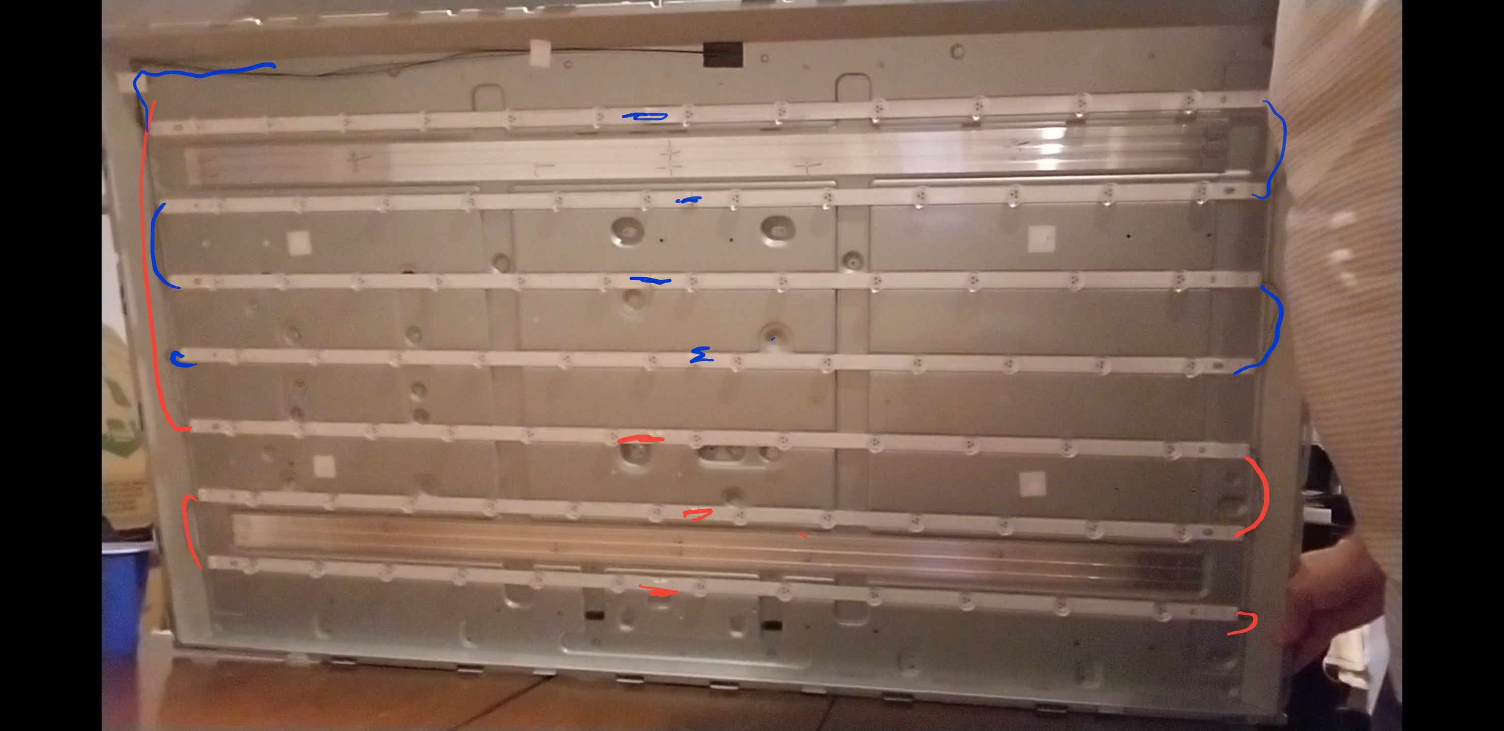

    Hey all.
    Pulled this thing out of the trash room in my apartment building the other day, and it's no backlight, so that was pretty straightforward.
    Went to ripping it down today to see how many strips I would need to buy/how many LEDs were bad etc, and turns out, none of them. Suddenly, as if by pure magic, they all turned on and stayed lit long enough to take a picture, SUCCESS! Right?
    By the time I got it back together, turned it back on, still working, but as soon as I hooked it up to a source to play on it (SNES Classic ) the backlight promptly died again.
    It still fully flashes every time I toggle power, no surprise there.
    What do you guys think?
    Leaky near failing LEDs causing power cut off, or bad board that's failing under load?
    Can't for the life of me nail it down.
    Thanks!

    We need good clear straight shot pictures of all the boards and pictures that show how all the boards are connected together, that will a start.
    Did you take pictures of LED strips showing how all the LED strips are connected together?

      Re: LG 55LN5750 -- Bad backlight board or strips? So confused.
      I did, thankfully hahah
      Don't have a picture of the back of my exact same model TV, but this one shares a panel, just has a different IO board, same TCON set up etc.
      https://youtu.be/gvnbaEkpnQo?t=48
      The Red linked bars are one circuit, the blue is the second, and the interconnects are shown as well.
        Quite often it's better to solder wires across all the connectors to bridge any possible poor connection.
          I'd lean towards bad LEDs only because that series / panel in all sizes seem to burn them out, in fact they get so hot the glues that holds the lenses gets toasted and then the lenses fall off too. Just picked up another LB series 2014 model which has the same strips, flashing backlight, it'll be a bad LED but normally it's total darkness not flashing so must be only one or two
