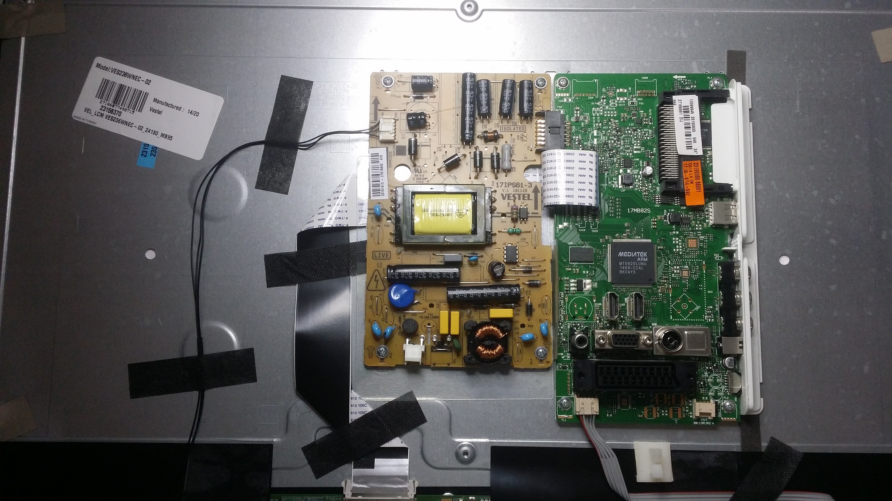

Vestel 17MB82S Only backlight
  • Andreasbest
    • Aug 2014
    • 1133
    • Hellas ( Greece )
    Hello.
    I got a 17MB82S that give me only backlight, no picture and no sound (not sure about sound as i cannot see if the screen is in HDMI,TV,Scart or USB) no OSD at all too.

    Have voltage to t-con?

      Hello.
      Really sorry for the delay, i forgot the whole tv and today i remember it!
      Yes i have voltages like 3.3v and 1v. I can write you all voltages at all pins if you want.

        Re: Vestel 17MB82S Only backlight
        Voltage to T-CON means to ask if you have 12Vdc supply voltage to the T-CON Bd. Look at the T-CON Bd. at the bottom of the TV near to where the FFC from the Main Bd. enter the T-CON Bd. There should be a fuse to measure that you have voltage on both sides.
          Yes fuse has voltage (12v) on both pins.

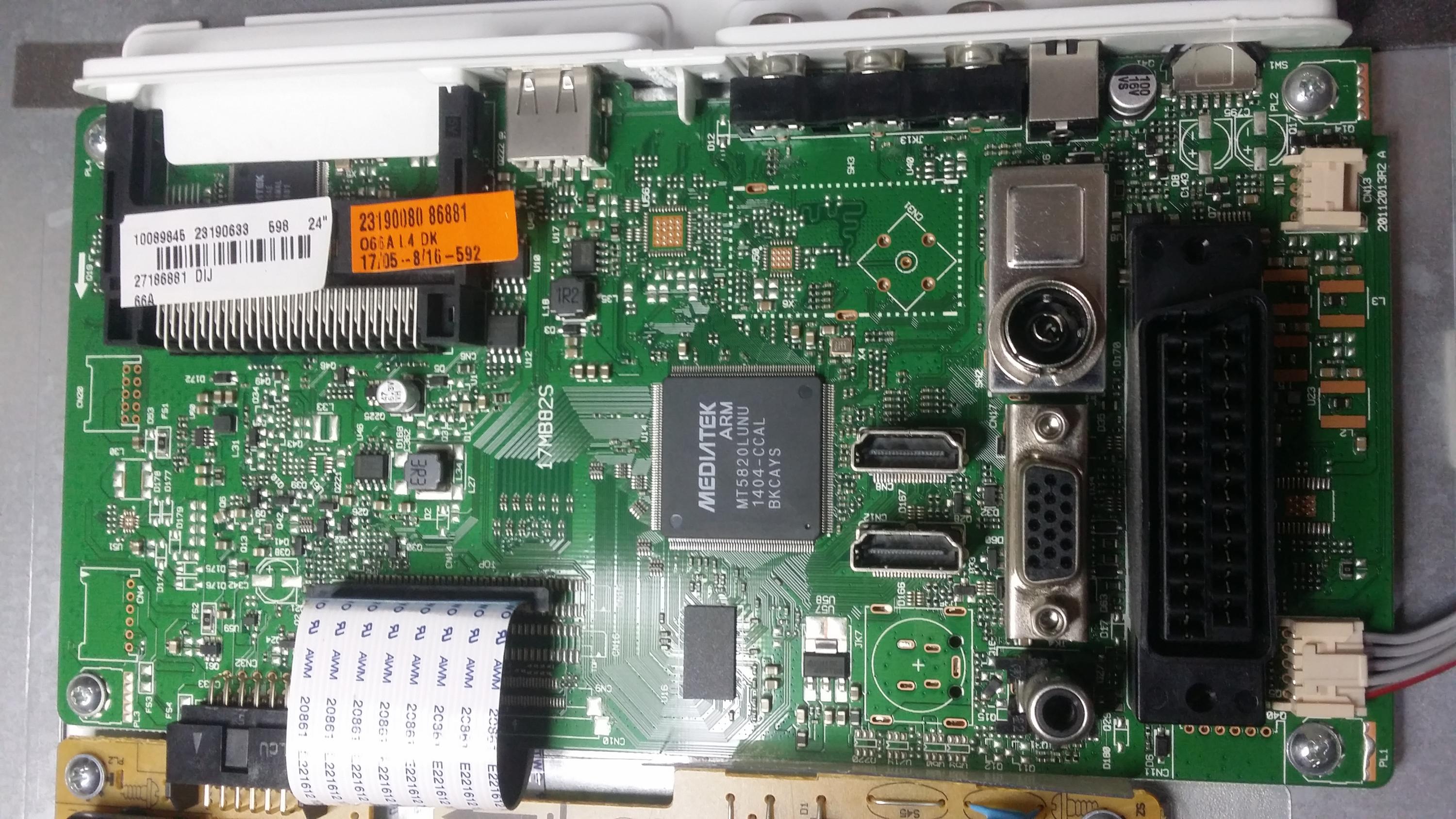

              If you have USB to RS232 cable you can check the UART debug output on the SCART port, some of the pins are connected to the TV's Linux kernel debug UART.
                So the problem is clearly in mainboard?
                  No, there's a chance the panel could be bad as well.
                    +1 - most likely faulty panel
                          17MB62 is similar, I believe
                          The UART is on pin 10 (TX) and pin 12 (RX). You may need to reverse RX and TX on your UART device. You will also need to connect to the ground of the TV, on pin 4 and 5 for instance, or the chassis.
                          Make sure to use a 3.3V or 5V UART, not a proper RS232 level device with +/-10V levels which may be fatal to the TV CPU.
