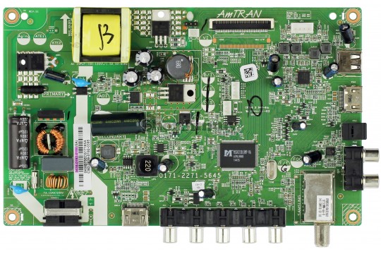

    Hi, I have a vizio d39h-co led tv with working backlights but no picture or menu. I have replaced the mainboard twice, changed Eprom, changed lvds cable. This tv has only one mainboard with power supply built on the mainboard. I checked voltages at tcon which is built on the panel all look good. The board # is AMtran 3639 0182 0150(7b)
    PLEASE HELP

    If you check the LVDS with an oscilloscope (while flicking the menu on and off all the time), it will tell you if you are getting a signal to the t-con. After that, it is replacing the T-Con, which you can't... so at the end of the day, this thing is toast, unless you repair that board.

      I have exact same problem. I also changed board twice. If you find problem please notify me and i will do likewise.--sam
