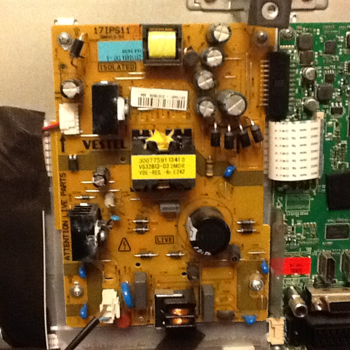

    Hello, have a dead Toshiba with a vestel 17IPS11 power board, replaced the 5 diodes, but no change. Anyone had anything extra go pop on the board?

    check more diodes and post pics please.

      Re: Toshiba 32D1333DB
      Pics
        Pics of whole layout would be nice, and what is the exact symptoms?
            It's totally dead but I have just found the transistor next to the bank of diodes is s/c so il pop it out tomorrow to see if that's it il let you know how it go's
              Well in case anyone wants an update, it was the main board causing it to be dead, so I changed it and now the s/by led is flashing red and green, somebody mentioned it might be the software as each board is slightly different, but there's no update available, unless somebody knows differently?
