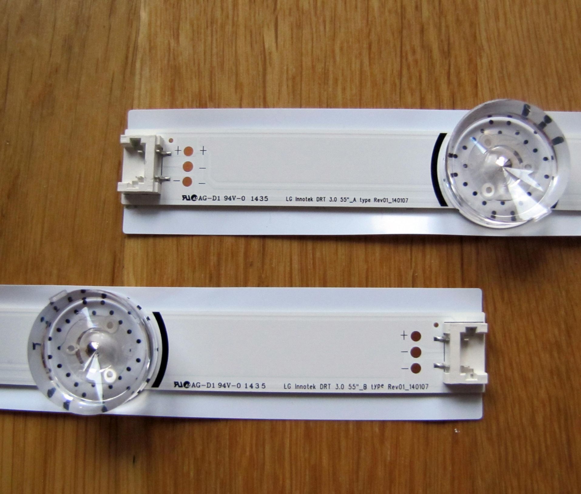

    Did 2 of these over the last 2 days
    1 was striaght forward enough
    the other one was abit more puzziling
    was intermittent
    and using a led tester the leds always worked.
    so one the last try, i started measuring the resistance between the connecting the strips..
    My advice is always do this, or just always bridge the connections
    one had high resistance, it didnt do anythign when using the tester but it would take the backlight out when powered by the tv psu.
    Also they new type leds whats going on with the glue they are using the leds just fall off if you touch them sometimes...
    mad times

    Re: Lg42bl580 bad backlights tips
    LED's fall off or the lens?
    • llonen
      • Sep 2014
      • 495
      • hampshire
      I have had a few problems with the odd lense coming off when removing strips, I find alraldite works well to replace them, if your finding the led's themselves coming off then you are probably doing something wrong lol.
        Sorry was abit tired
        the lens yeh, very bad glue on these new type of lens ..
          I think they're getting so hot the glue is affected. One of these TVs people could justifiably throw back at LG. Definitely a limited life expectancy
              The type of lens shown in the pic
              you just brush your arm past them some times they are falling off
              even on tv's with no led issues
              i think its bad glue they have used...
              Its just piss poor.
              I have one just fall off in the tv, I was wonder whats with the bright spot on the lcd lol...
              Just a another nightmare
                I have seen videos where almost all of the lens have fallen off. For whatever reason it is that type lens
                  its a pain move this particular tv today and could hear a lens that had dropped off..
                  Going to take it apart again and remove all the lens and stick them back on with stong adhesive,
                  Might go with some epoxy type stuff for this set ...
                    Yeah those are the ones I have had problems with in the past, I find a high temperature epoxy resin does the job well enough.
                      Which one are you using
                      At the end of my tether with this particular set, took apart nealry 5 times now...
