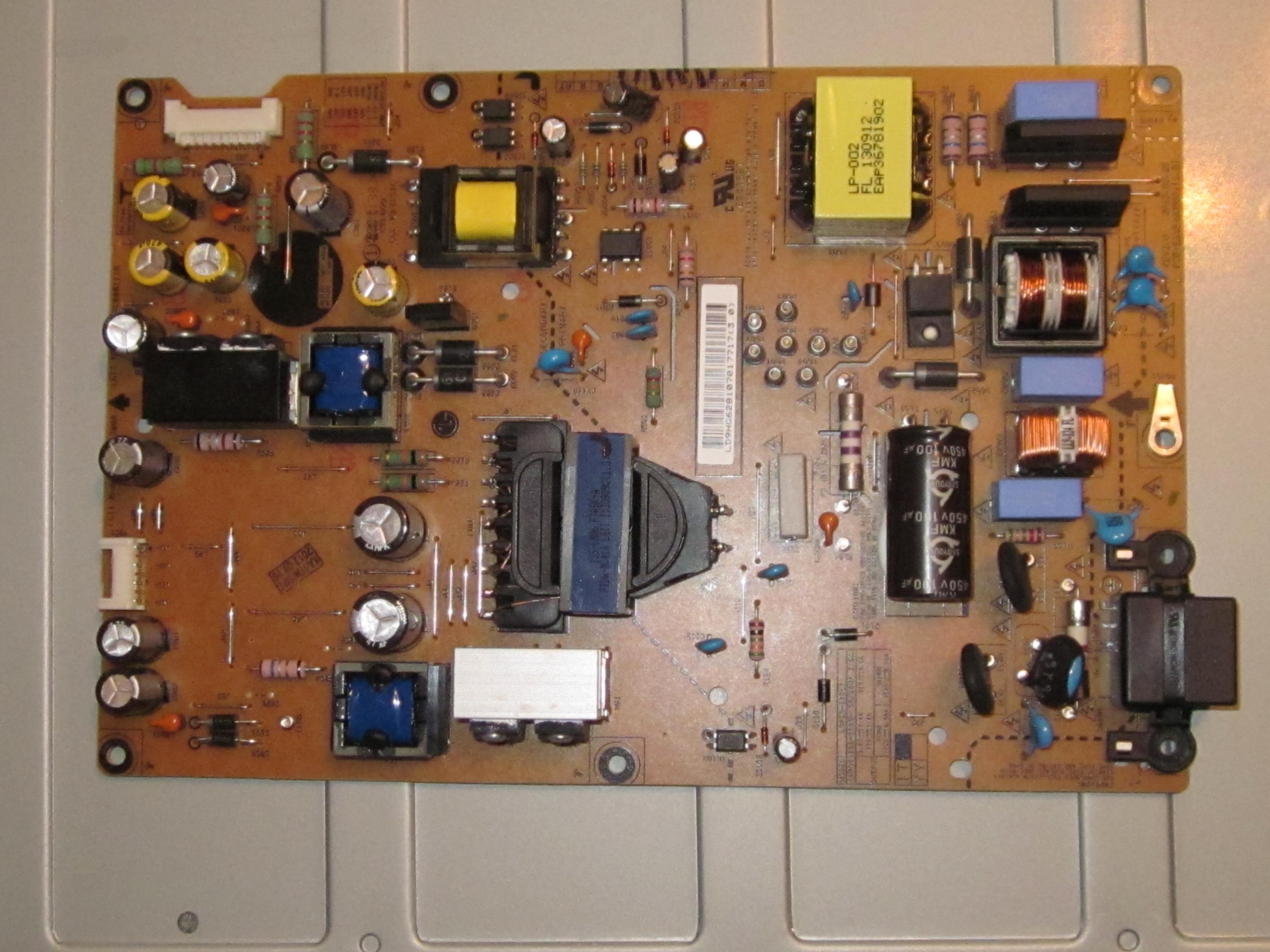

    I HATE to throw out something that is still very viable so I disassembled this monster today. Prior to disassembling, Square Trade told me to dispose of the TV in accordance with local laws and is in the process of sending a check. The power supply has no obvious cracks in any of the solder joints and no hint of any bulging caps although there are some flux globs from what was either a bad board wash or bad rework. This led me to believe there were dead LEDs in the backlight.

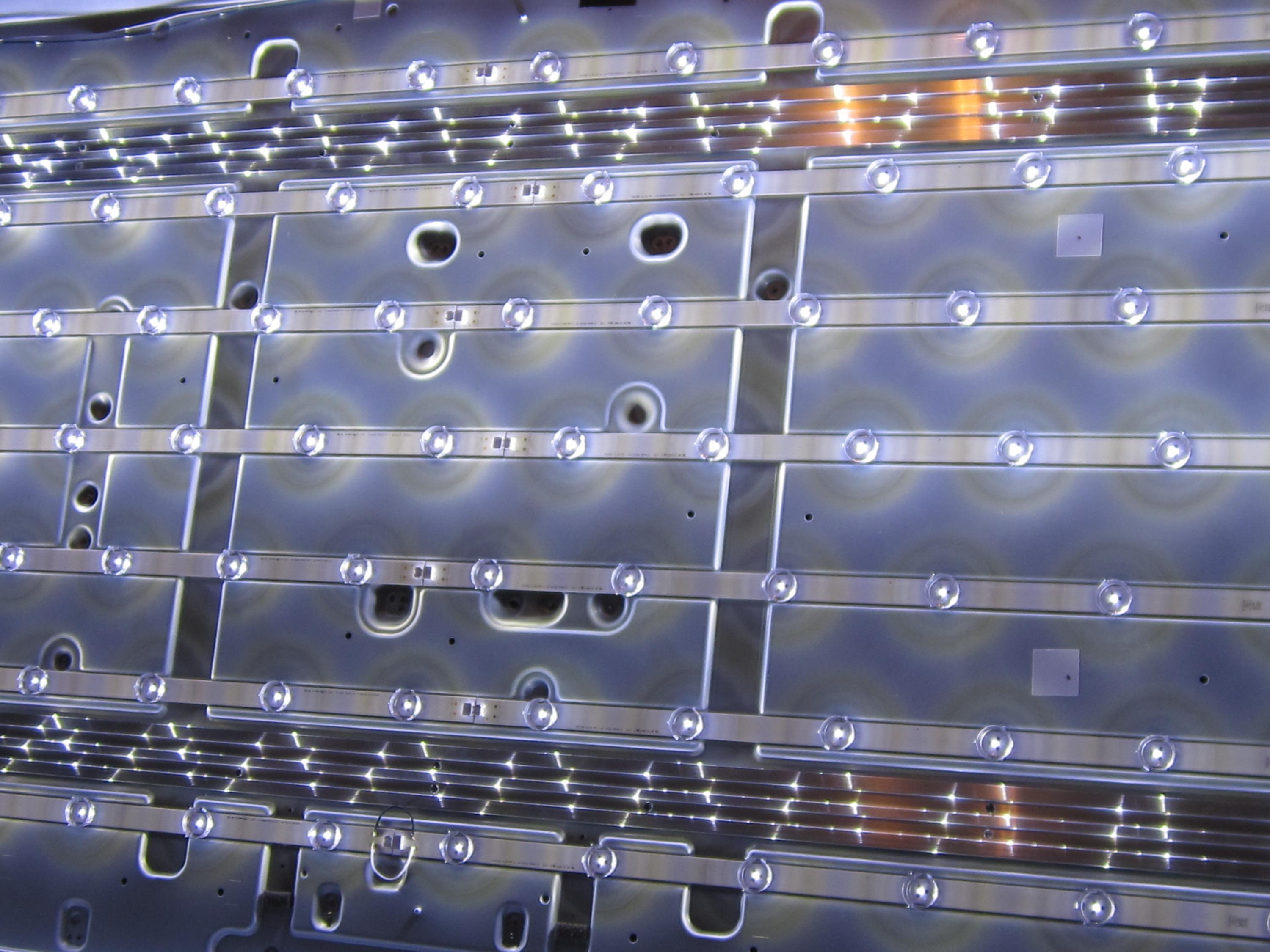

    For the faint of heart, I can confirm IT REALLY SUCKS to tear down to the LED strips on a large TV like this. None of the LEDs showed visual evidence of failure so I hooked up one of these
    http://www.ebay.com/itm/Constant-Cur...sAAOSwCEdYT7ID
    that I had left from another project to a set of sharp tipped spring loaded probes. I set the voltage to 3.3V and limited the current to 30 mA (using one of the AliExpress LEDs). I proceeded to individually check all 84 LEDs (seven rows of 12, which are split into 2 sets of six in each row). ALL LEDs illuminated. I the raised the voltage slightly and raised the current limit and checked them AGAIN - they ALL are functional.

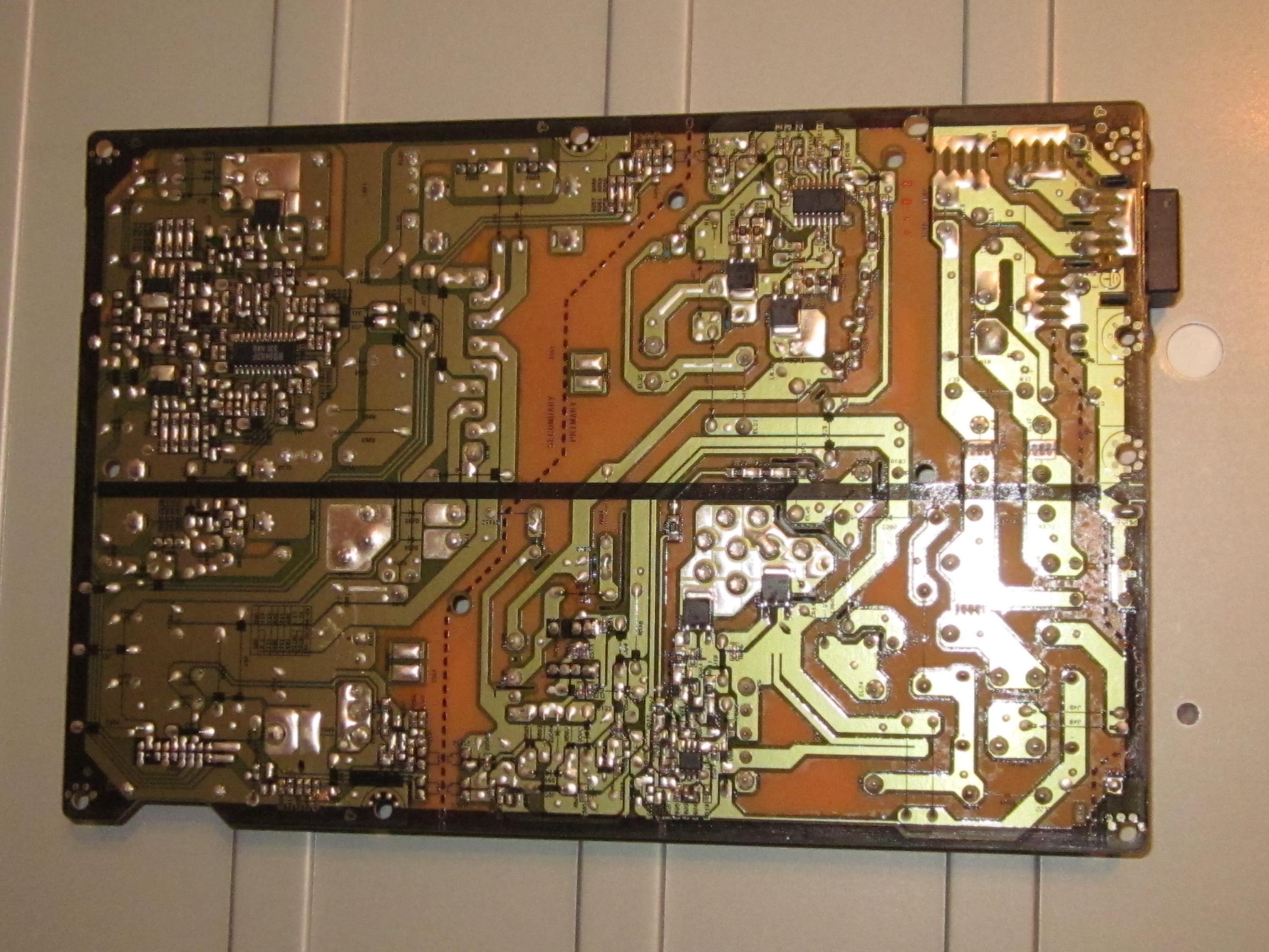

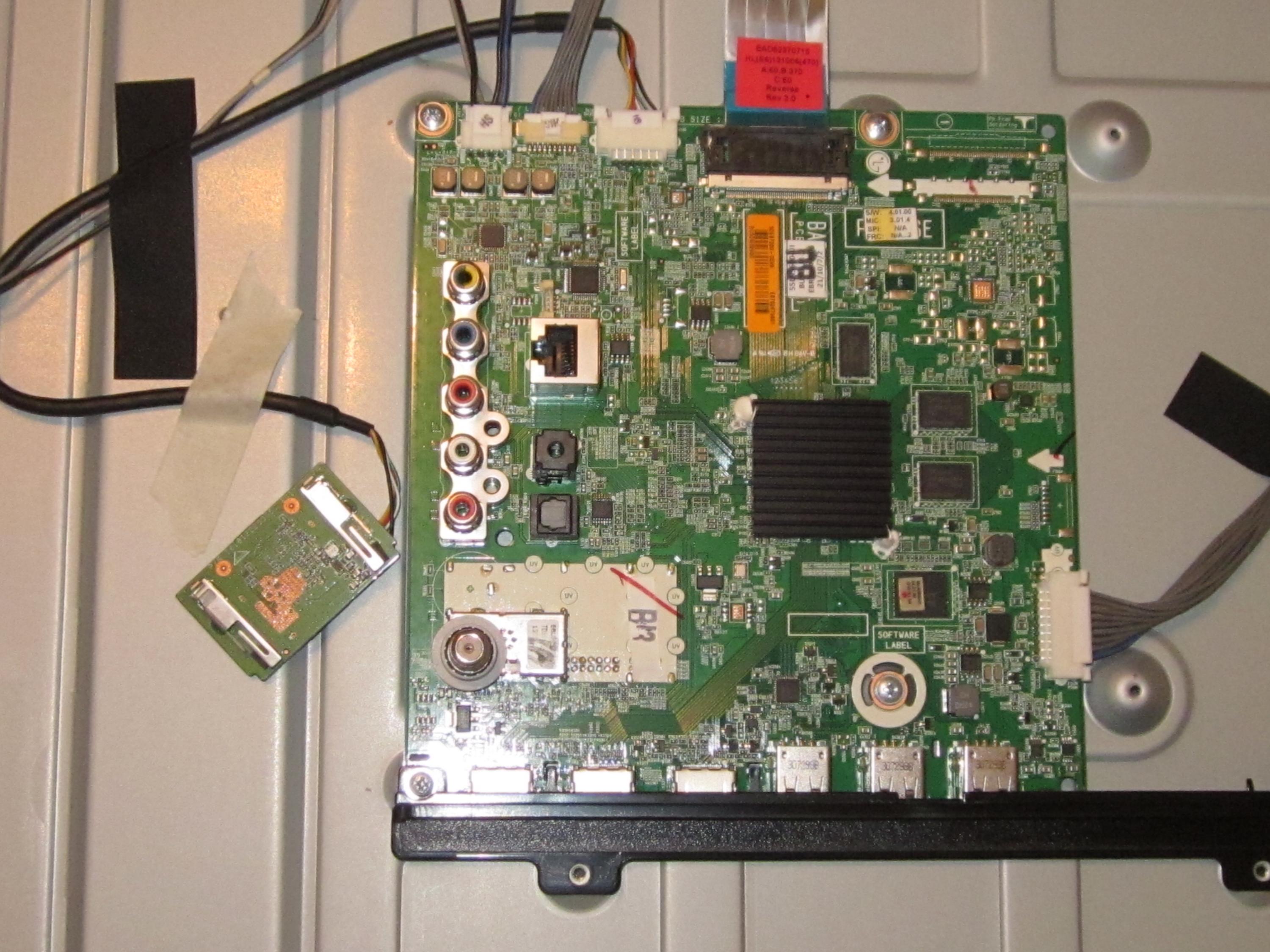

    We also need good clear pictures of your board so we can see what we are dealing with.

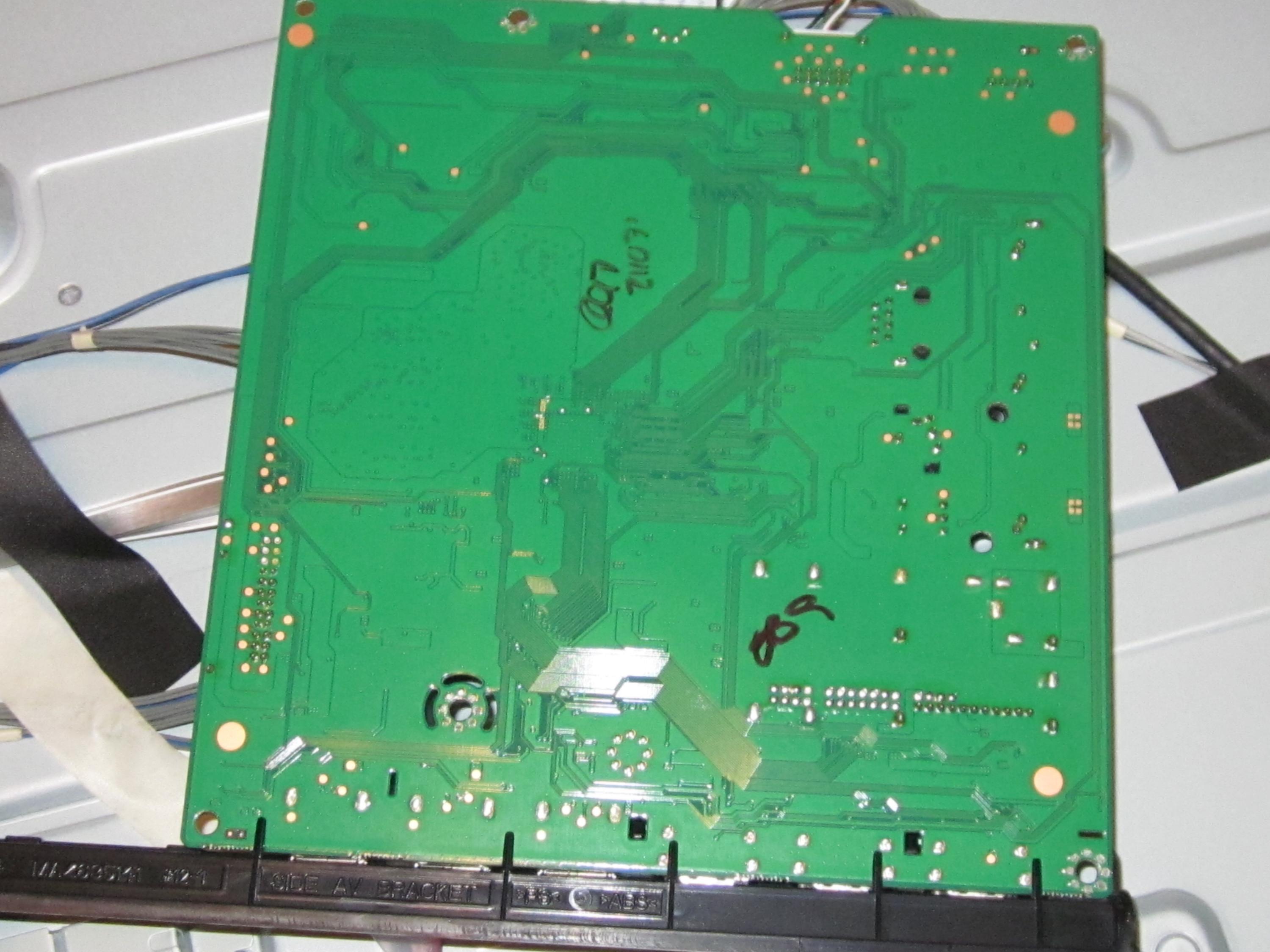

        @budm Attached are pics of the main board and power supply.
        Can I power this monster up without the TCON connected to the panel and not cause damage?
          Re: LG 55LN5600- Sound but no backlight
          you can power it up without the panel, or t-con connected, without any issues.

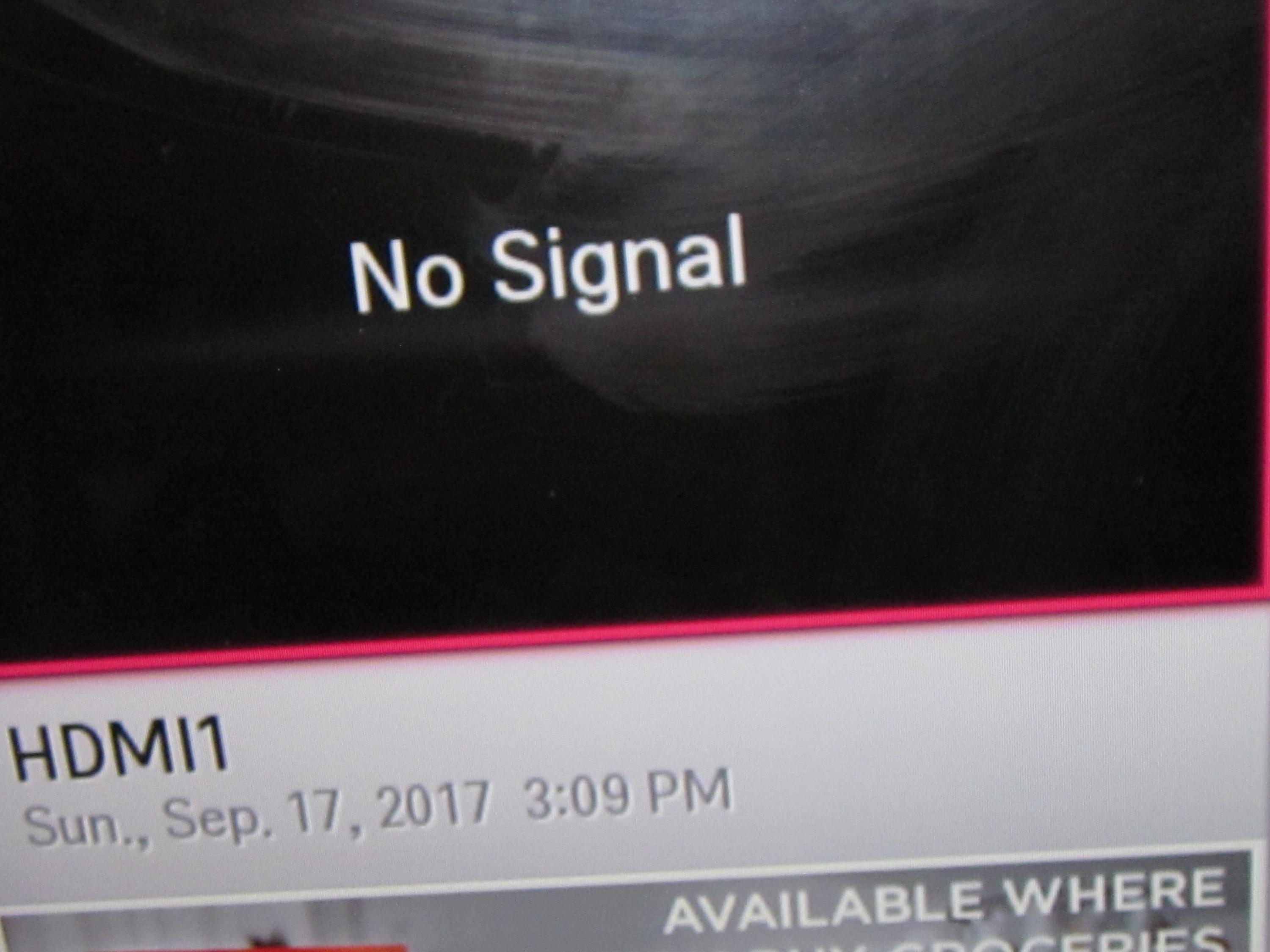

            Thanks for the responses @budm and @attainteddragon. I finally got back to this monster this afternoon. The 'PWR-ON' and 'DRV-ON' signals appear to be solid (LOW when off and constant 3.2-3.4 VDC when ON) so it's not the main board.
            It 'appeared' all LEDs were briefly coming on (flash) but just to make sure I used my cell phone in the video mode while I did so. After stepping through frame by frame, it appears the bottom rows weren't coming on. There are seven (7) rows of LEDs with each row split into halves. The top four (4) rows are wired in series (I will call them the upper LED group) and the bottom three (3) rows are wired in series (which I will call the lower LED group). Upon closer inspection, the LEDs in the lower LED group are NOT coming on. ALL LEDs in the upper LED group come on briefly.
            The connector driving the LEDs has four (4) pins - two (2) feed the upper LED group and two (2) feed the lower LED group. I disconnected the connectors feeding the upper group and lower groups. The upper cable was not long enough to reach the lower LED group but the lower cable could reach the upper LED group. I connected the lower cable to the upper LED group and the upper LED group came on briefly. So it is something with the lower LED group. I checked the continuity of the cables in the lower LED group as well as the connection between the two halves of the rows. All seemed good.
            To reiterate from my first post, I checked ALL LEDs individually with a constant current source (~100 mA, ~3.5 V) and each and every LED (upper LED group and lower LED group) illuminated when I did so one by one. As to checking the LED+ to LED- voltage, my DMM (a 20+ year old Fluke 79, no max hold) can’t react quick enough. It shows ‘OL’ for the brief instant when the LEDs blink and then settles to under 0.5 V.

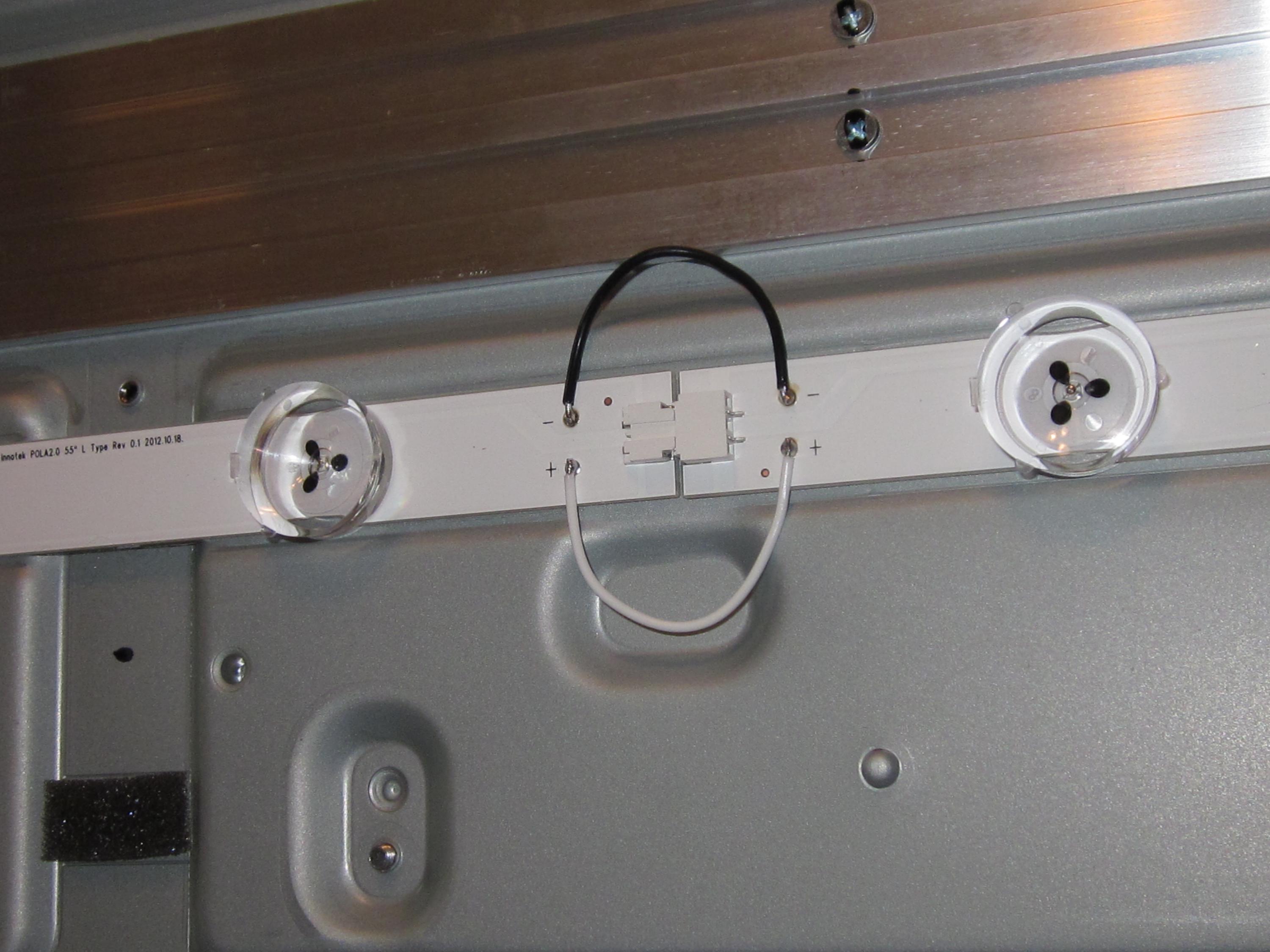

            So WTF? Went and ate dinner and came back afterwards. Swapped the left strip-to-strip cable. Powered it on – no change. Swapped the right strip-to-strip cable. Powered it on – no change. Swapped the end strip loops. Powered it on – no change. Leaned on each of the LED strip end connectors while powering on – no change. Leaned on the bottom strip-to-strip connection and powered on – SUCCESS! Tapped this connection – went out. I must press this connection for the backlight to work – consistently.
            FYI - if backlight does not come on at power on, it won't come on at any point after. You must cycle power EVERY TIME.
            Since I want to sit down and relax, I will simply solder jumper wires over this connection point (+ test point to + test point and – test point to – test point) in the morning. Hopefully I can put the screen back in without breaking.
            I will follow up with the final outcome.

                Since it was a B!TCH to handle a wobbly 4 ft x 2.5 ft LCD panel, I felt it was better to solder around the connection and know it was going to work rather than try to fix. I did NOT want to open this sucker again. I had a 31" RCA TV (circa early 1990's vintage) that had the notorious TOB (Tuner on Board) issue. I had to re-sweat the tuner joints every 3-4 years to keep it going. That sucker was almost 100 lbs...
                Seems to work like a champ!

                  Glad to see it is working.
                  Same problem with these SMD connector, poor design without good mechanical support.
                  https://www.badcaps.net/forum/showth...578#post761578
                    @budm, read your post. Same style connector and you're absolutely right. I always prefer through hole vs. SMT on connectors (in most cases) but in this case would have to worry about shorting to the the 'tub'. Amazon says that TV was first available April 9, 2013 so roughly same vintage too. Hopefully they change the strip design.
                    So if no back light, voltages check out, no obvious LEDs failures --> check strip connectors.
